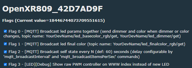

    no OTA on XR809 delayed things a little.
    Screenshot of OpenXR809 configuration with flags 0, 1, 2, and 3 enabled.
    flag 13 doesn't stick on reboot, otherwise fine.

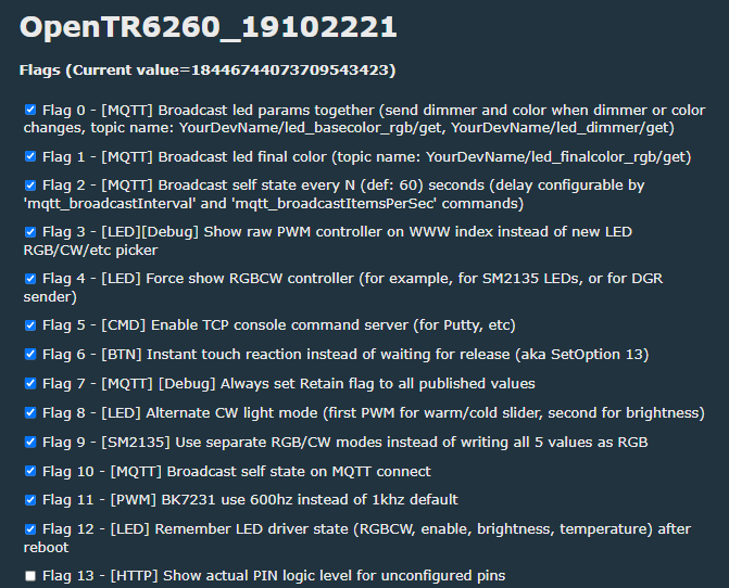

    Added after 6 [hours] 23 [minutes]:
    TR6260 also accepted the new flag value but was missing flag 13 as has been seen before. On reboot the main GUI causes a system halt. Again I assume this relates to the flag 13 thing itself rather than your fix.
    Screenshot of OpenTR6260 interface with a list of flags and descriptions.
    I don't this there's reason PR 1548 shouldn't be merged is there?
