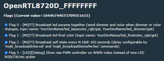

The 64-bit flags change appears to work on other tested platforms: on RTL-B/RTL8720D, all flags could be set without error and there was no hard fault, although flag 13 was still deselected after reboot [#21457513][#21459645] On TR6260, the new flag value was also accepted, but the remaining flag 13 issue was still present and the main GUI could halt on reboot, which was already seen before this PR [#21459843] For verification, the main thing to check was whether `strtoull()` works correctly on the main SDKs (ESP, BL, LN), since Beken was already confirmed OK and all current targets are 32-bit [#21457366] The WEB UI display of value 0 was also fixed separately, and the PR was merged afterward [#21459741][#21460862]

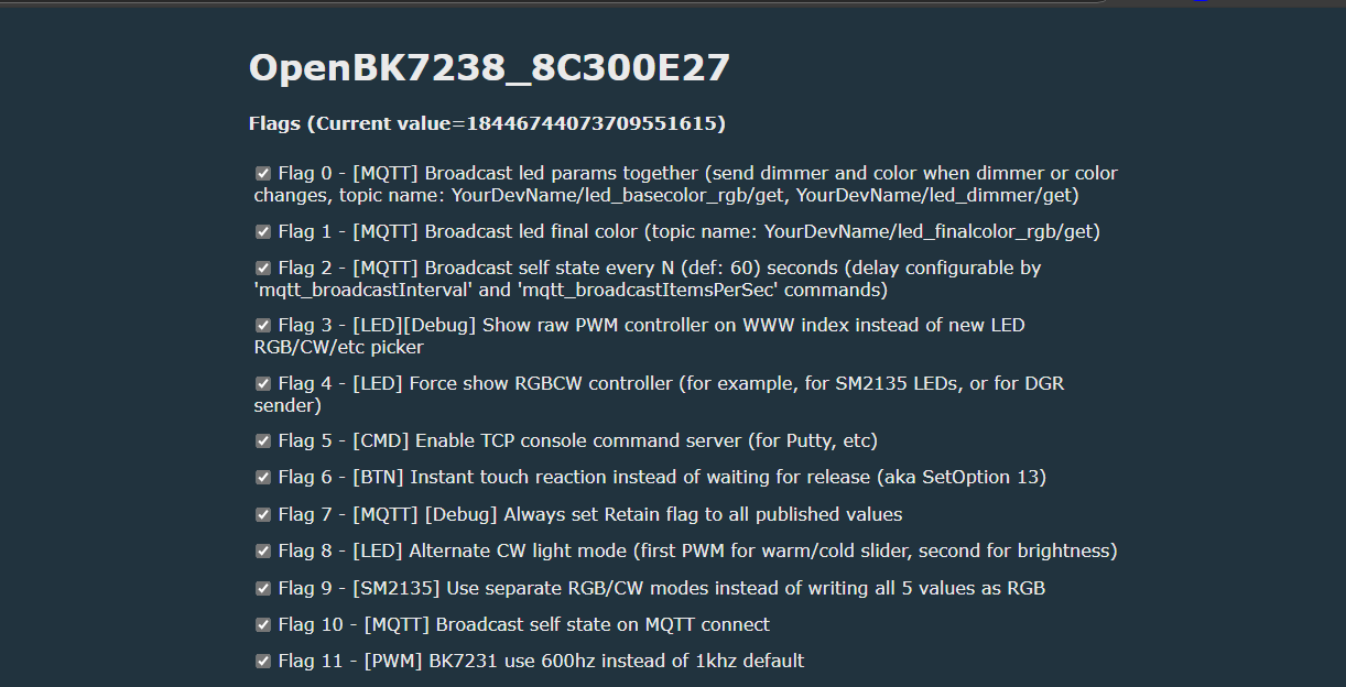

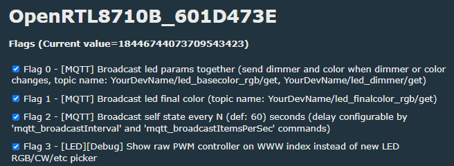

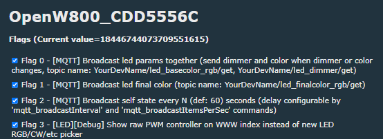

    I modified the Flags command to support 64bit. The display on WEBui is also fixed. Checked on the simulator and on BK7238. Is there anyone who can verify this on other platforms?
    test:
    flags 18446744073709551615
    Screenshot of the OpenBK7238 user interface displaying a list of flag settings.

    Flag 13 triggers hard fault on RTL8195A
    #16 21457513
    Posts: 5220
    Help: 449
    Rate: 918

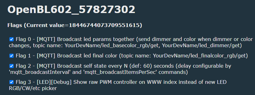

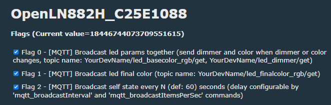

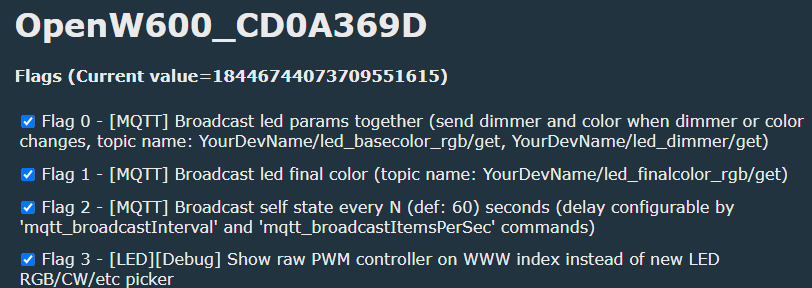

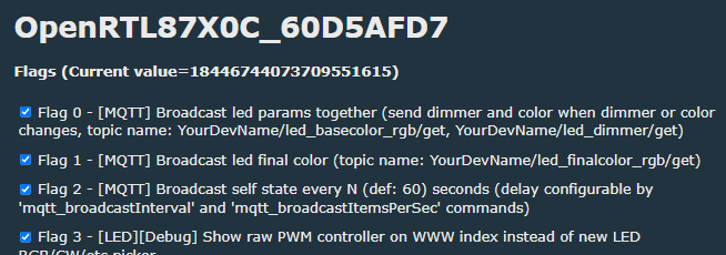

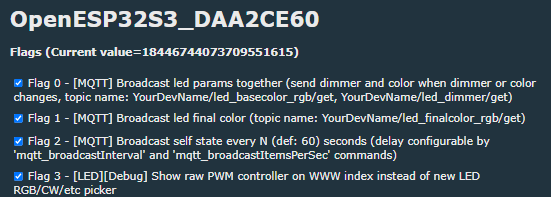

    1548_merge_66c6fb20c815
    OpenW600 settings screen with selected flags
    Screenshot of the OpenW800_CDD5556C settings panel with enabled MQTT and LED flags.
    Configuration panel of OpenLN882H with active MQTT flags.
    View of user interface with OpenBL602 flag settings, most of which are checked.
    OpenESP32S3 interface with active flags for MQTT and LED configuration.
    OpenRTL87X0C application interface with a list of set MQTT flags.
    Screenshot of flag settings for OpenRTL8710B_601D473E.

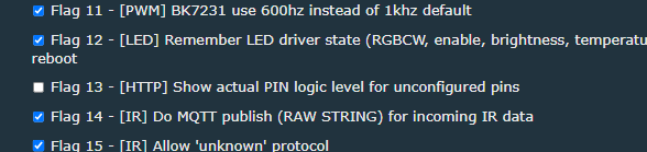

    All set flags without error apart from RTL-B which had a hard fault. It came back up with all but 1 set though
    List of configuration flags with flag 13 highlighted.
    Added after 3 [minutes]:
    setting flag 13 and saving thereafter does not cause a hard fault though
    interesting. with all flags cleared and only flag 13 set it'll hard fault if you move to the home page.
    I guess that's this it doesn't like
    Screenshot showing pin states with various settings, where only P28 is set to '1'.
    Added after 16 [minutes]:
    but unrelated to the flags fix. The same happens with general release 1.18.47 and only flag 13

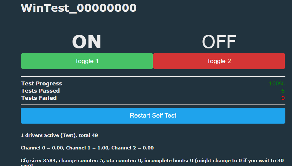

  • Self-test framework for command validation across builds
    #18 21457592
    Posts: 14771
    Rate: 12914

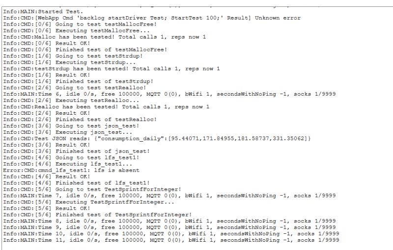

    I am adding self test system to build device.
    https://github.com/openshwprojects/OpenBK7231...mmit/a00d88b2a112c260985661cd079b7a5deba9a014
    Usage:
    1. enable ENABLE_TEST_COMMANDS in obk_config.h
    2. add your command to cmd_test.c

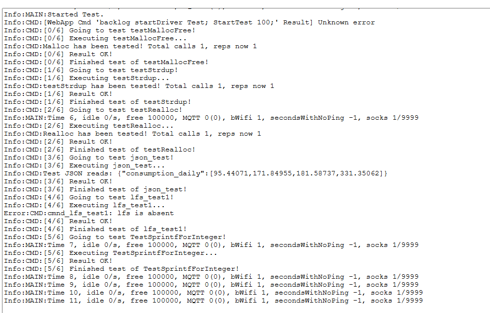

    Code: C / C++
    Code: C / C++
    3. add it to drv_test.c:
    Screenshot showing source code in Microsoft Visual Studio.
    4. do build
    5. in build run:
     backlog startDriver Test; StartTest 100;
    100 means 100ms interval between steps.
    It runs in such a way, that it first prints command it will run, it waits 100ms for log to come through, then runs command, then checks run result, then waits 100 ms, and pritns again....
    Sample run:
    Screenshot of a software test log with messages about test results.
    Test interface with toggle buttons and test results.
    The most important thing to note here is that if some command crashes, you can also run it from console without test driver.
    Please give me initial feedback, but also wait 1 day before running it. I will improve it a bit soon.

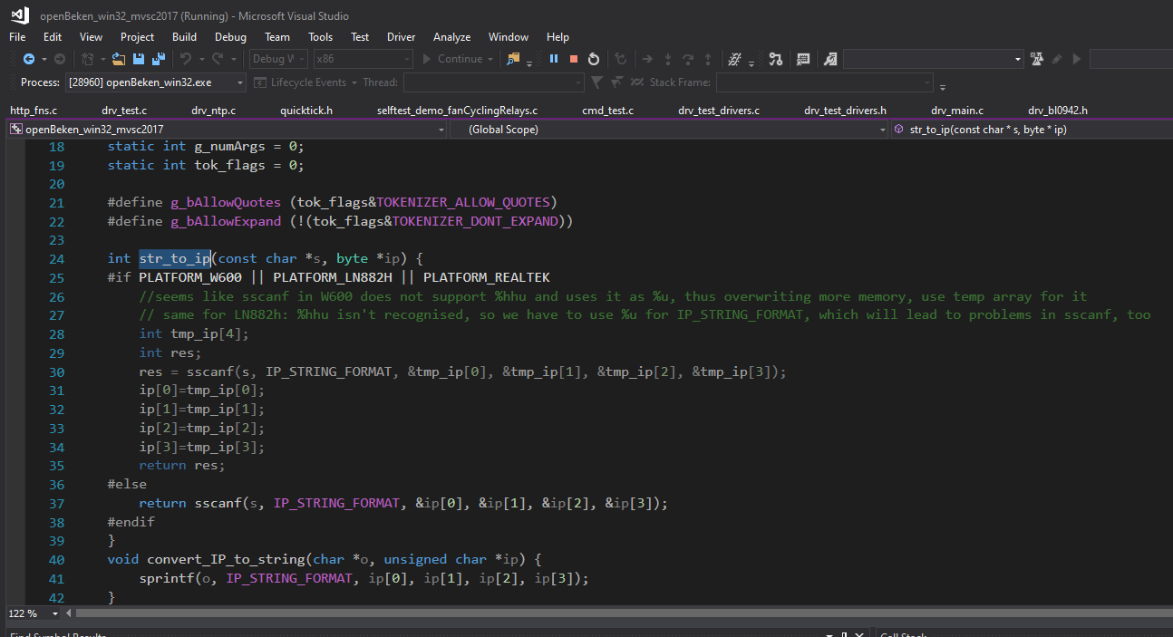

    One of practical uses of this could be this cursed IP parse bug:
    View of Visual Studio editor with C code.
  • #22 21457658

    That's why I added test commands like this one:
    Code: C / C++
    This checks IP parsing, and this is required, because it has proven problematic, see implementation:
    Code: C / C++
    This is not just a theoretical sample - we really had this issue:
    Screenshot of a comment discussing software update issues.
    As you can see above, we had a sscanf problem that requires special handling on W600/LN882H/Realtek, and we didn't catch it early.
    If we had per-platform device tests back then that cover str to ip, we would have caught it earlier.
    It is impossible to catch this problem on WIndows self tests, because it is present only on some platforms with their specific implementation.
    Thanks to the per-platform tests, it's now possible to catch it.
    If you compile OBK with test commands enabled, and if your platform has str_to_ip broken, then this code:
    Code: C / C++
    will attempt to parse "192.168.0.123", but it will fail,, then "if" will detect it, so it will return CMD_RES_ERROR.
    So, later, the drv_test.c will catch it, and it will show error here:
    Test panel displaying switch states and test results.
    Self tests are very useful, because they can quickly check if all tested features can work as expected. You don't need to setup a CW light to check if PWMs are set correctly - this is done by Windows selftests in SImulator on each Github build. You also don't need now to manually check each page like local ip config on every platform, because per-platform tests will cover it as well....
    How to run self tests?
    - to run Windows simulator self tests, just trigger online github build, they are ran automatically
    - to run per-platform tests, compile OBK with ENABLE_TEST_COMMANDS , flash it to your device, and run "backlog startDriver Test; StartTest 100;"
    I didn't have time to run per-platform tests myself, but I strongly suspect that at least realloc test will just crash BL602 device - realloc is known to be a problem on BL602.

    So now let's make a demonstration. We'll consider a hypothetical scenario where someone breaks some function by accident, for example, the channel set.
    I modified CHANNEL_Set_Ex to always set value to 0:
    Screenshot shows a GitHub pull request for merging a branch in the openshwprojects project.
    Then I commited changes to Github.
    Let's see what happens.
    It's building, so we wait a moment...
    Task list in progress on a version control platform with status information.
    And then we get:
    Dashboard showing the status of task checks in a build system.
    AS you can see, many self tests have failed. They expect channels to work, so they recognized that something is wrong:
    Computer screen from a CI/CD panel showing various build and test job statuses, with one error.

    #30 21459645
    Posts: 5220
    Help: 449
    Rate: 918
    1548_merge_82ad074ae93b
    Screenshot of OpenRTL8720D settings interface with selected flag options.
    no hard fault but flag 13 is deselected on reboot, otherwise seems OK on RTL8720D
    Screen displaying PIN states.
