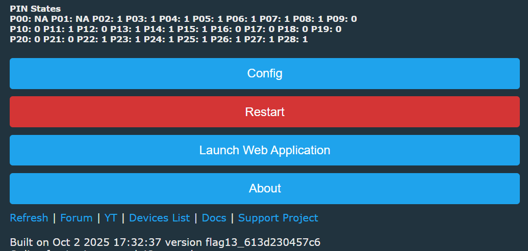

    I forget how useful Flag 13 - [HTTP] Show actual PIN logic level for unconfigured pins is for finding buttons. No GPIO Dr or tracing, just push the button and watch channel state change to identify button.
    eg, this TXW cam clearly shows P08 and P12 as being the two buttons. The trouble is that PIN States list seems to be capped to P28.
    animated
    Pin state list from P00 to P28 showing logic values on dark background

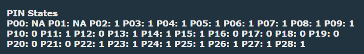

    >>21708009
    Consequence of the fast development :D flag is ambiguous to platform change and capped at BK N probably ;)

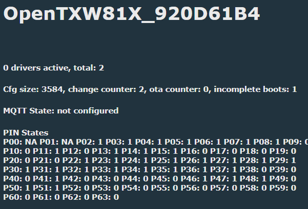

    divadiow wrote:
    https://github.com/divadiow/OpenBK7231T_App/b...296d740e/src/httpserver/http_fns.c#L996-L1016
    nail on the head as the saying goes :) a platform switch logic has to be implemented there as well

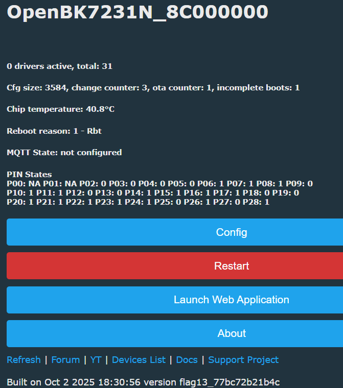

  • #11 21708115
    Posts: 5212
    Help: 446
    Rate: 914
    yay
    OpenBeken Flag 13: How to View Real-Time GPIO States for Unconfigured Pins?
    Added after 6 [minutes]:
    confirming BK7231N
    Added after 3 [minutes]:
    >>21708040
    missed this. thanks
