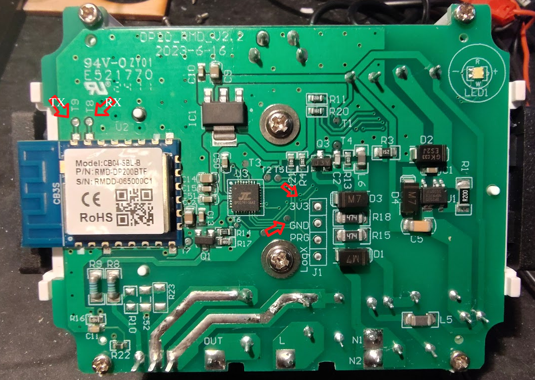

  • #3 21481572
    pabloelektrodacom
    The case has four screws in each corner in the back.
    They can be accessed by lifting the decal.
    The shell has some clips that can be opened with a plastic wedge.
    The chip is a BK7231N on a CB3S board.
    Close-up of a circuit board with various electronic components and a chip labeled CB04-SBL-B.
