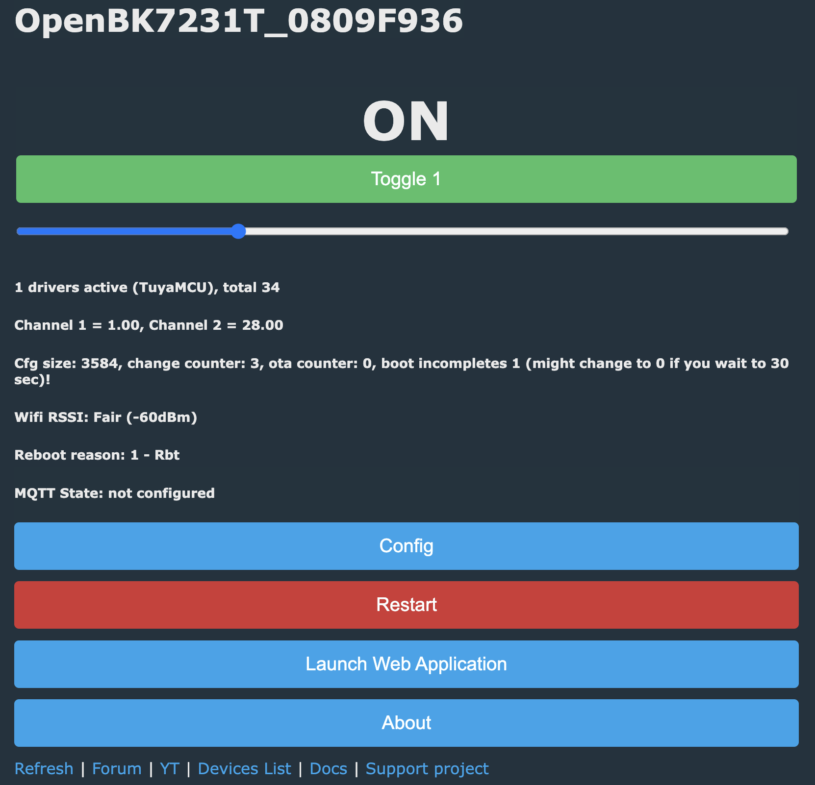

    - Your webpage should look like this now
    Web interface of OpenBK7231T dimmer showing device status, ON/OFF button, and brightness slider.
    - You should now be able to control the dimmer!
