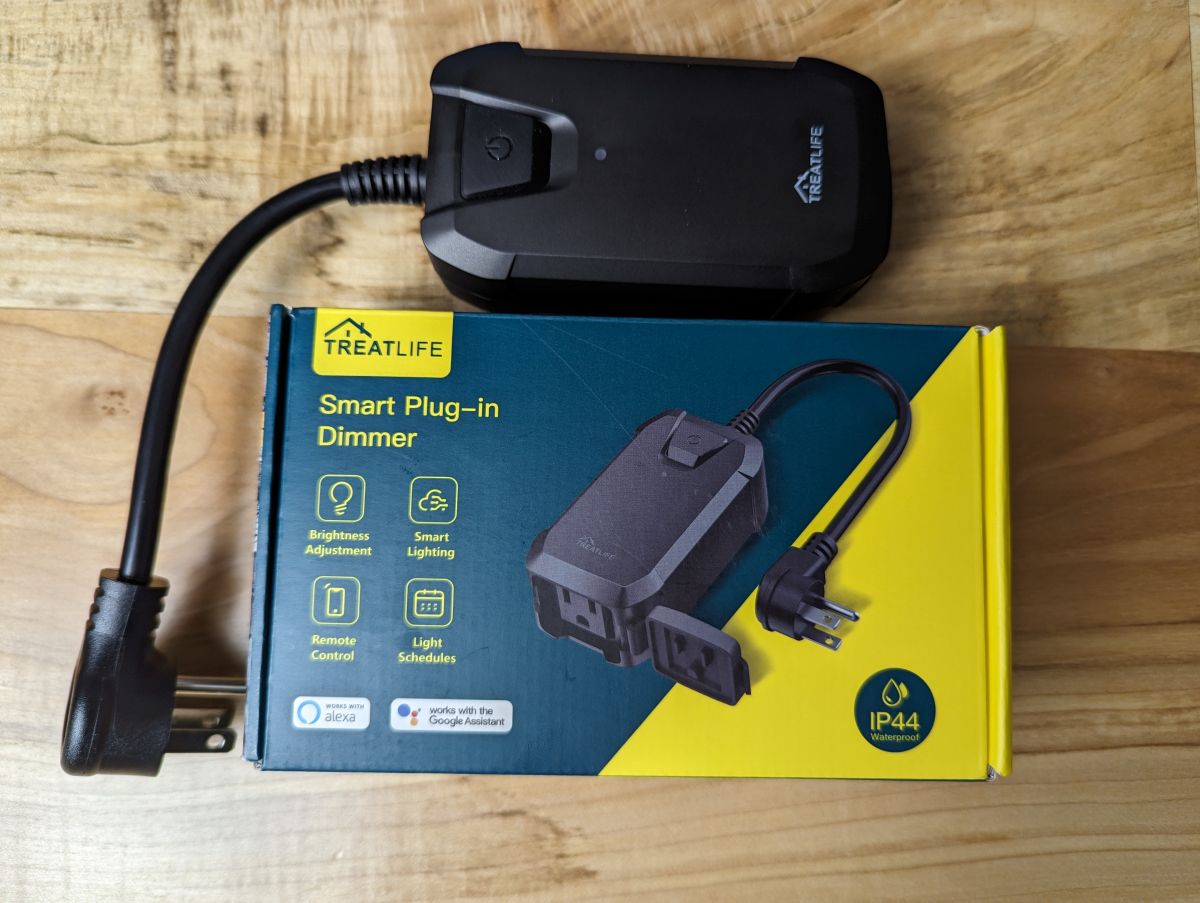

    Product overview:
    Black Treatlife Smart Plug-in Dimmer device on a colorful cardboard box.

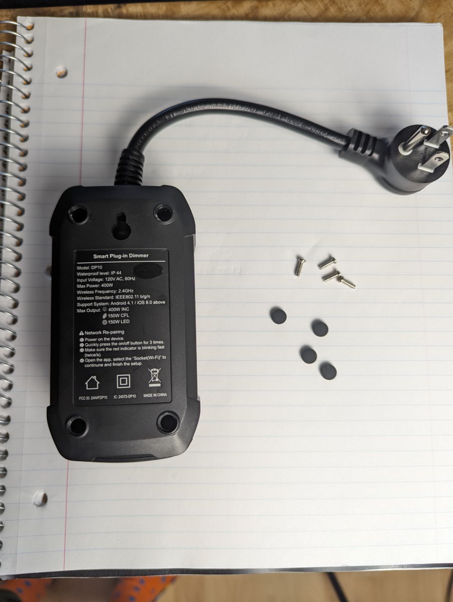

    Remove the 4 screws under the rubber pads and pull the device apart:
    Treatlife DP10 smart plug on a notebook with unscrewed screws and rubber pads.

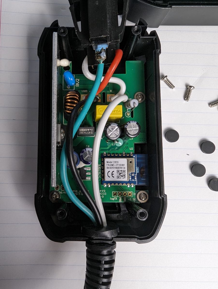

    This exposes the CB3S chip. There are three additional screws holding in the circuit board:
    Disassembled Treatlife DP10 device showing the CB3S chip on the circuit board.

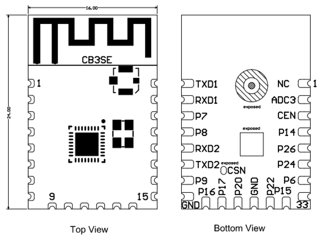

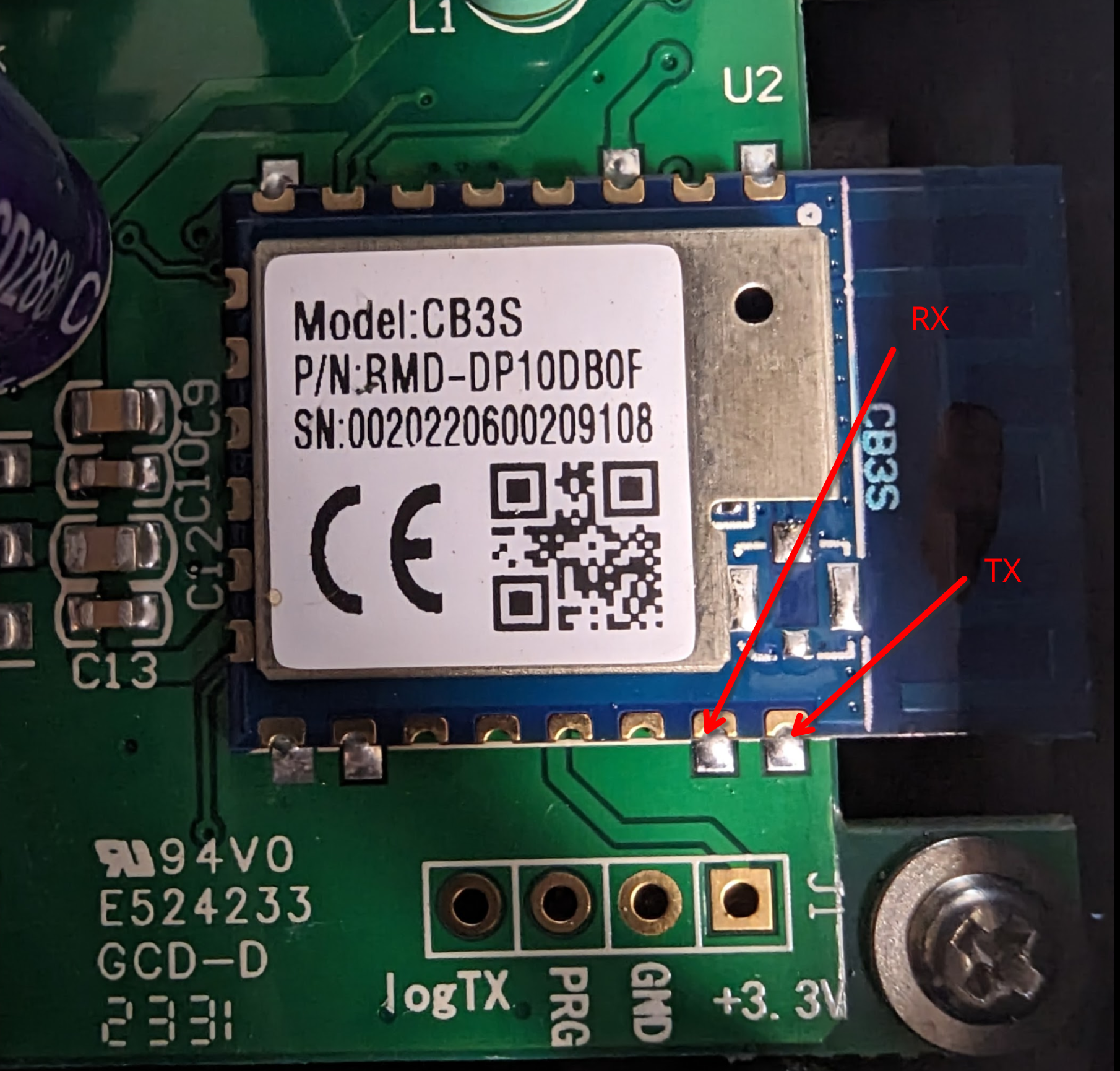

    CB3S pin layout:
    Top and bottom view of CB3SE chip with pin layout.
    Close-up of a circuit board with mounted CB3S module and labeled TX/RX pins.
    Ground and 3.3V are easily accessible on the board. Jumper wires can be clamped under tension to both ground and 3.3V. Jumper wires can then be held against the chip to dump the firmware. No soldering is required unless you really feel like it.
