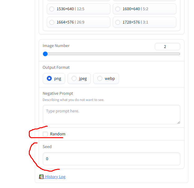

    As far as I can see, you have run the AUTOMATIC1111 UI and not Fooocus? And what does it look like, how does it compare to Fooocus? What kind of workflow do you have?
  • AUTOMATIC1111 works better than Fooocus on Linux
    #50 21562441
    andrzejlisek
    Level 32  
    Posts: 3646
    Help: 82
    Rate: 712
    Fooocus didn't work for me, and instead of trying to read up on how to configure and run it, I took the easy way out and asked GPT to write out step-by-step, cow-by-cow, what was needed and how to run Stable Diffusion on a Linux system. He suggested AUTOMATIC1111, and indeed, I did well, as my system was not ready on the spur of the moment, hence the additional upgrades and configurations.
    The interface itself is as in the screengrab https://github.com/AUTOMATIC1111/stable-diffusion-webui/blob/master/screenshot.png Functionally I think it's almost the same as far as text2img itself is concerned. In my opinion, it makes no difference whether it is AUTOMATIC1111 or Fooocus.
    The workflow when configured is:
    1. I start the server, wait for the browser with the page to start.
    2) At the top, I check out the model (I may have several models downloaded).
    3 I set all parameters, seed to 0, note that the server does not "keep" the last used parameters. I leave the other parameters as they are by default.
    4. using the "batch size" or "batch count" I can produce several images at once.
    In practice, it is sometimes some programming errors. The interface doesn't want to "grab" the model as I try to select from the list. Sometimes I have saved myself by moving unnecessary files to another folder, that there was only one model to choose from.
    The computer has 32GB of RAM and 4GB of VRAM. It happens that after a few generations the system slows down a lot, then it annihilates the server and the computer revives again. Simply close the browser and restart the server.
    I tested the same prompts as in the first post and on the same juggernautXL_v8Rundiffusion.safetensors model, I was getting images in the same style as posted in the post.
