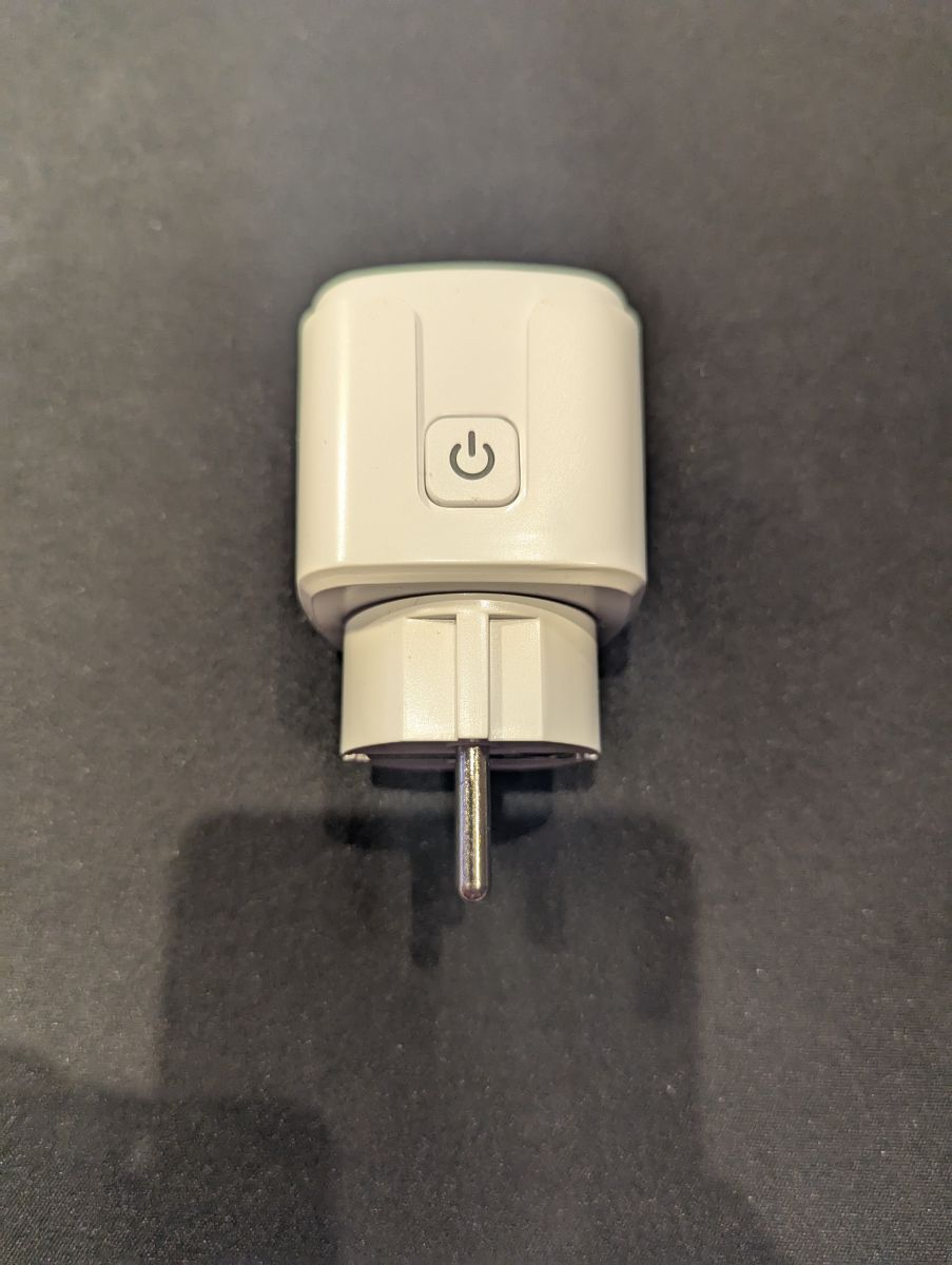

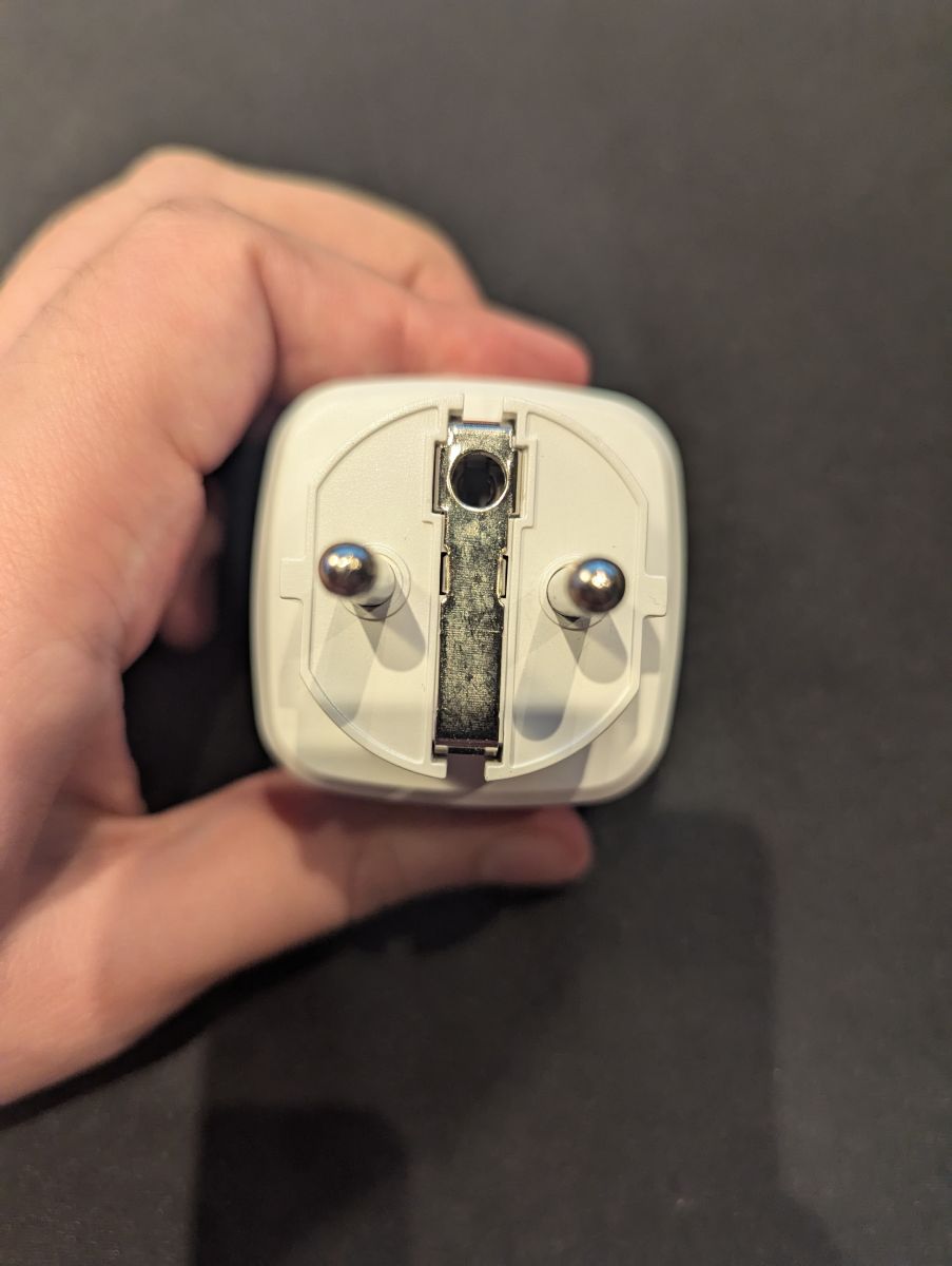

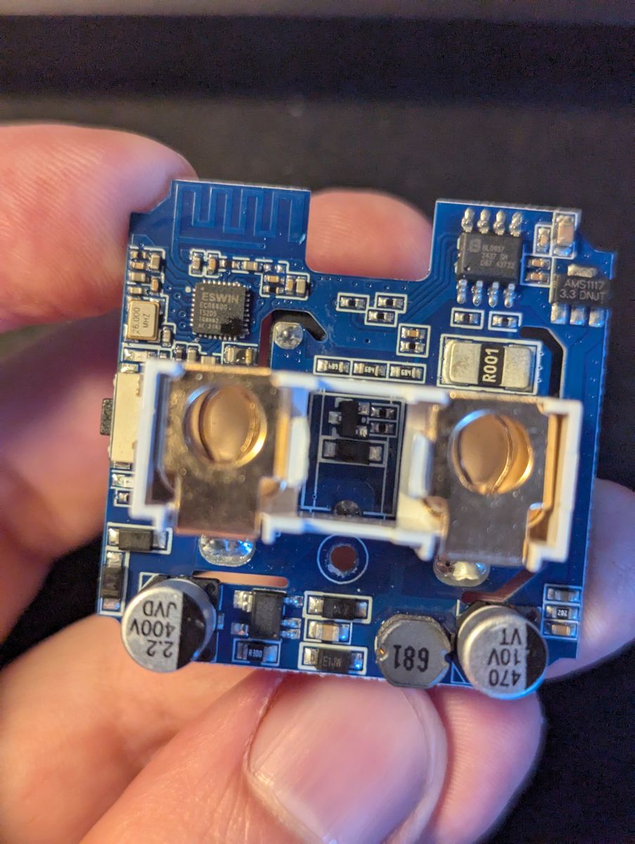

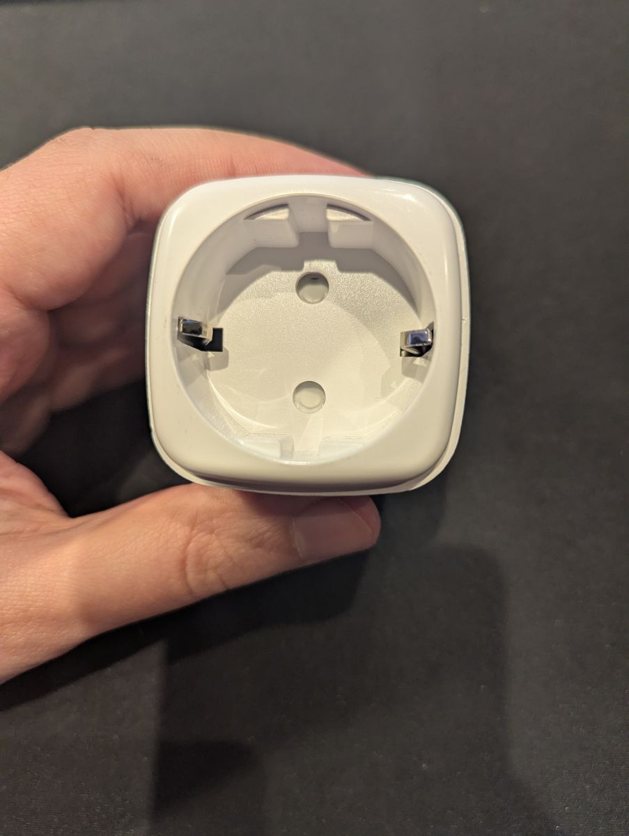

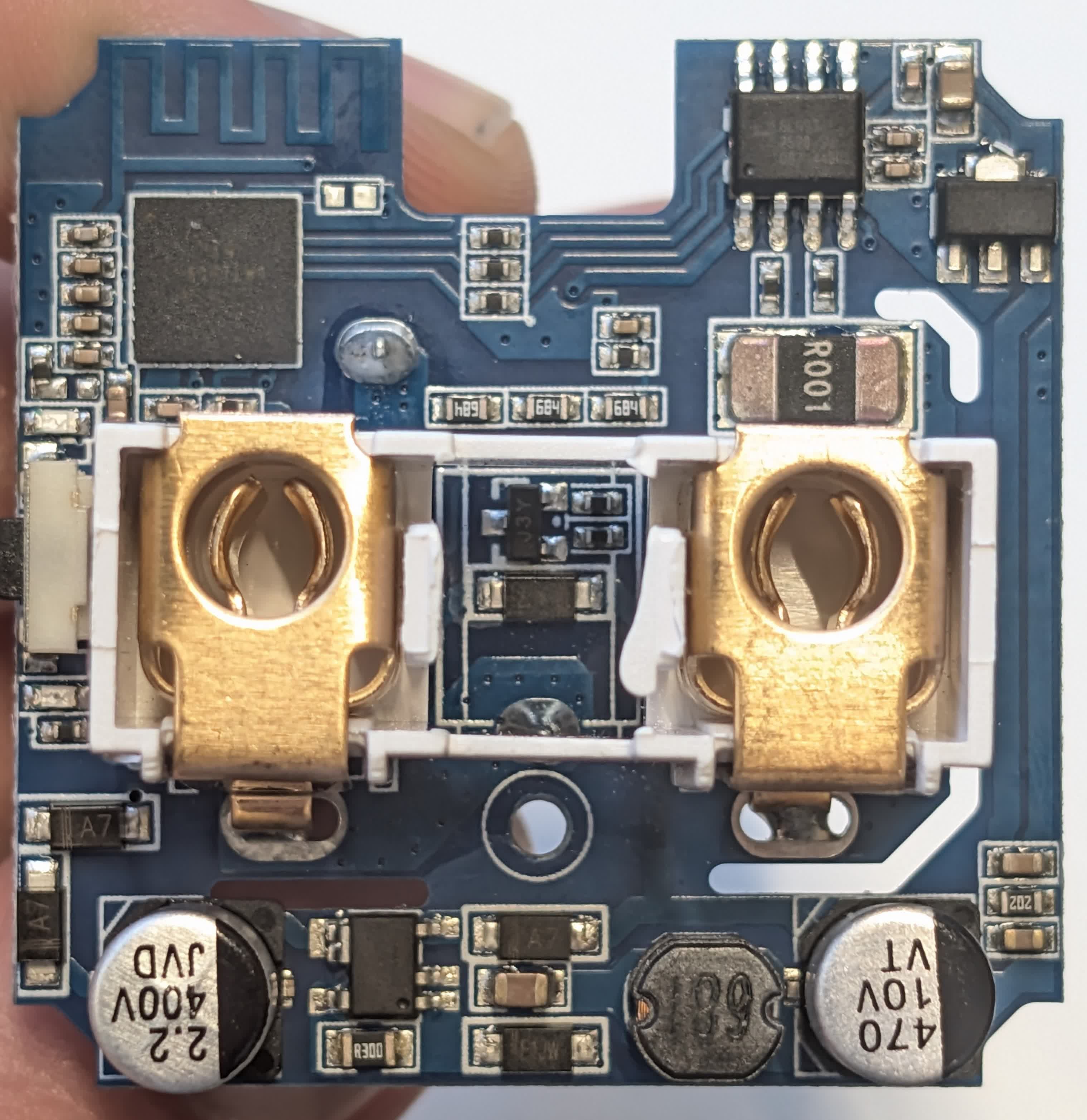

    Hi all! Let me share my teardown of TNCE TUYA Smart Plug WiFi I recently bought on AliExpress for 5 euros. The original Tuya firmware was pretty unstable and I decided to covert it to OpenBeken. Luckily, OpenBeken supports ECR6600 platform so it was possible to flash it via UART. I'll show the flashing process here step by step.
    Here is the look of the device

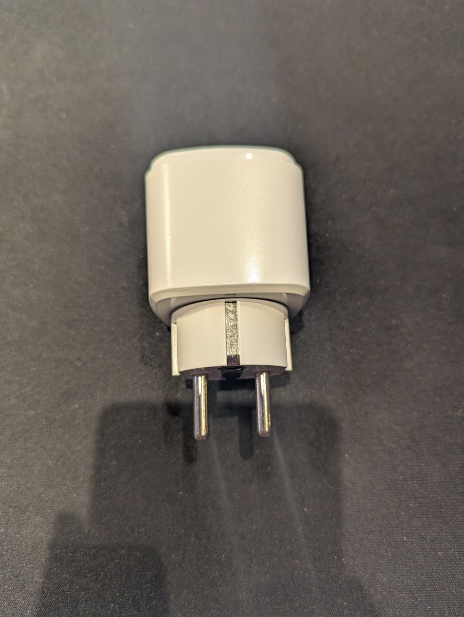

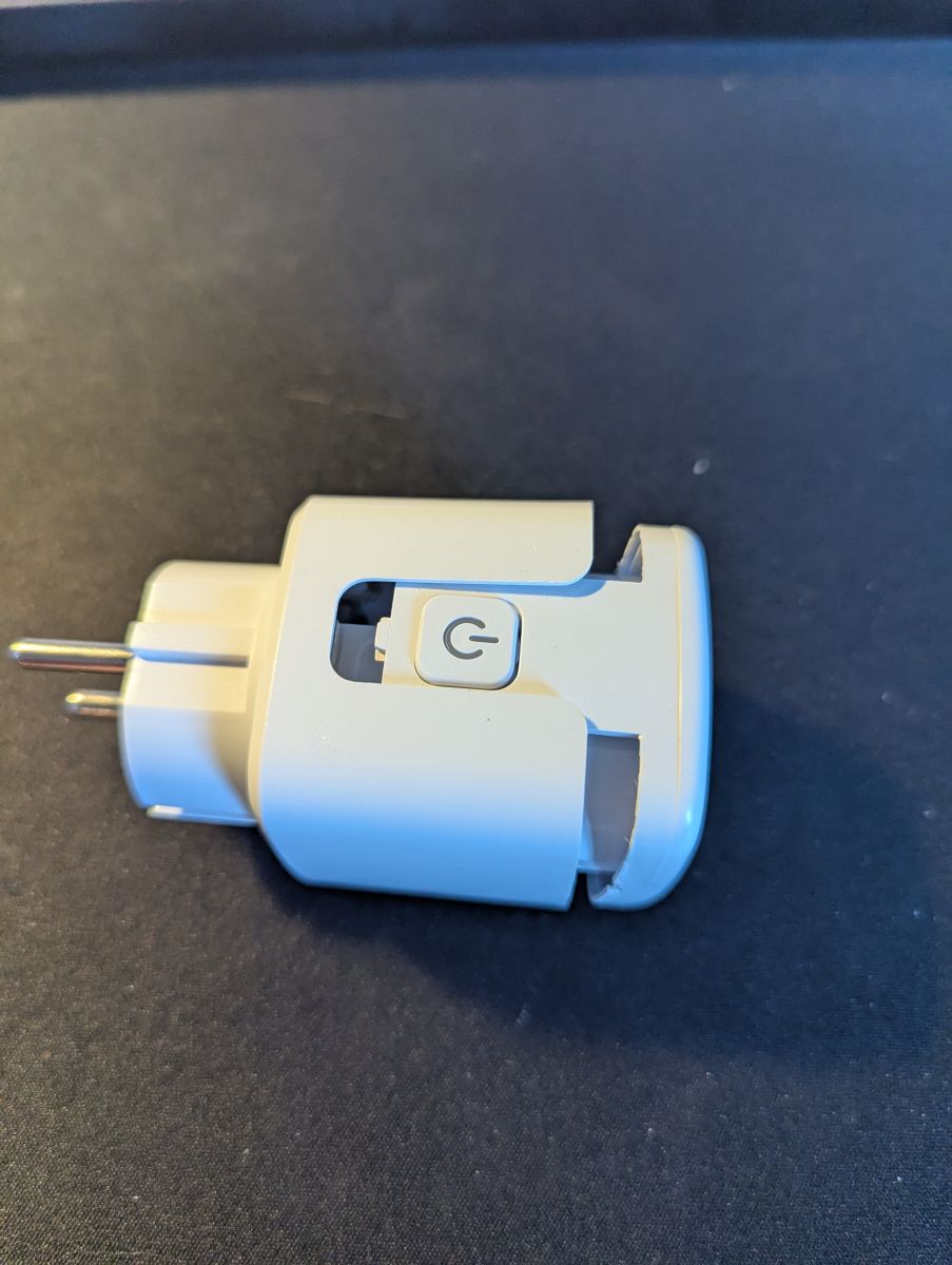

    To open up the device without much damage I used a vice: slightly squeezing from both sides till the little crack sound allows to crack the glue and split the plastic into 2 parts
    Electrical socket adapter with an on/off switch.

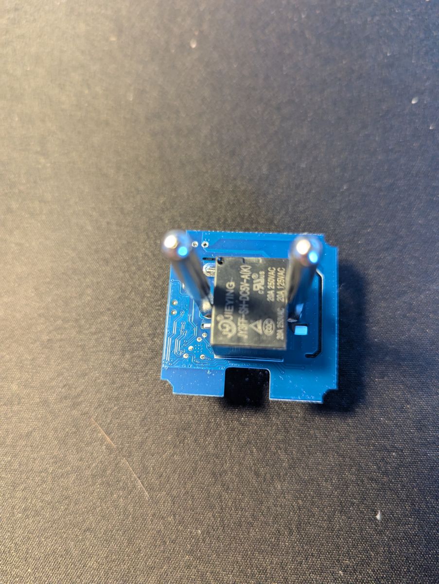

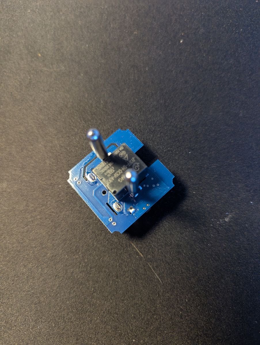

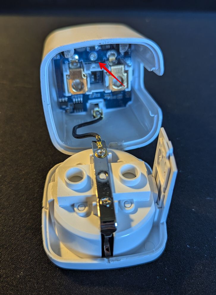

    Then removing one little screw allows to extract the PCB
    Open plug with visible interior.
    A circuit board held in hand with various electronic components.

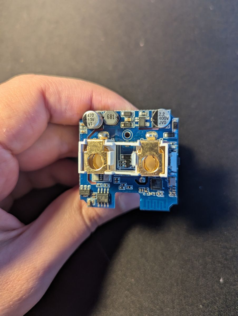

    Close-up of a blue printed circuit board with visible electronic components.
    Close-up photo of a blue circuit board with electronic components and the inscription ESWIN.
    A printed circuit board with electronic components held in a hand.
    Blue circuit board with a mounted relay.
    Blue circuit board with a lever switch on a black background.

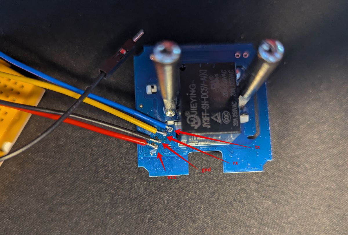

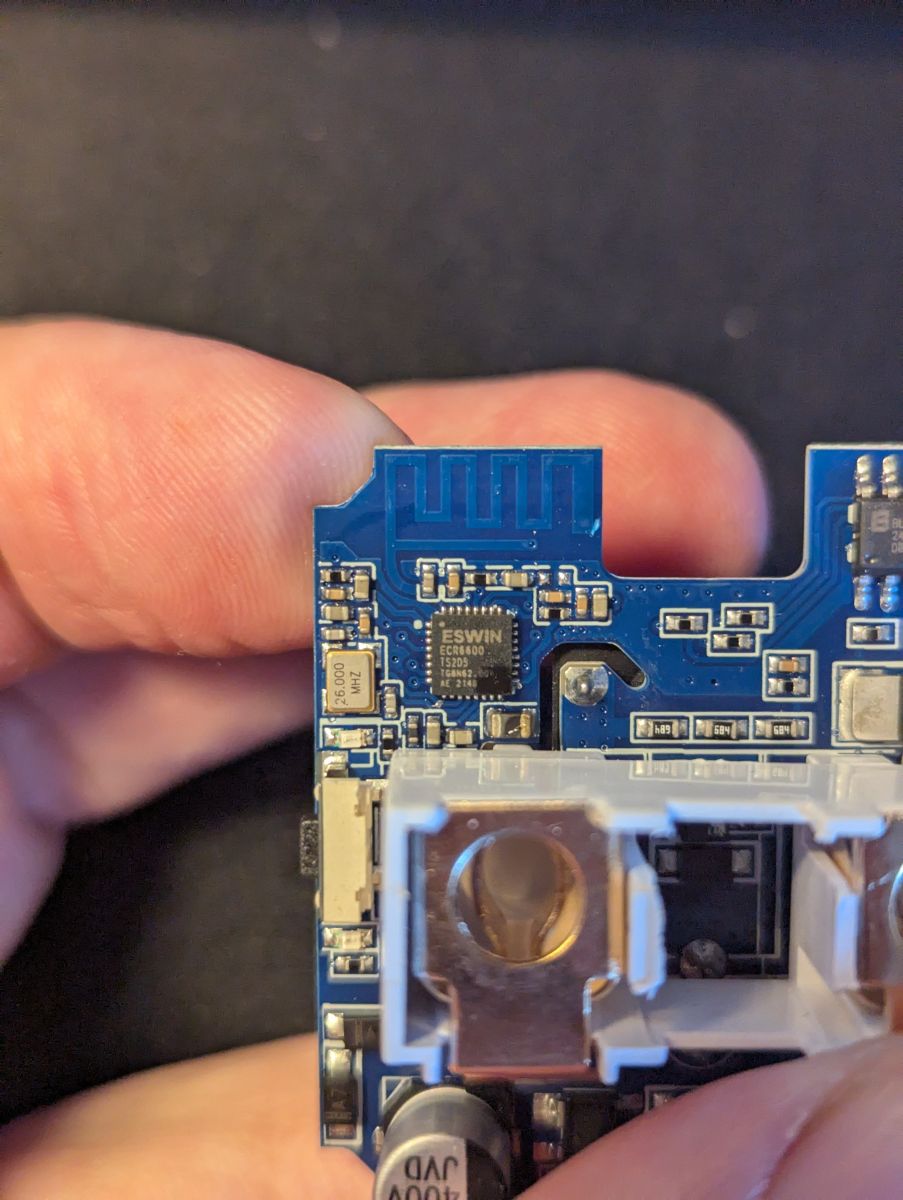

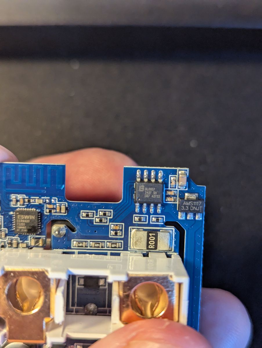

    We can see that the socket is built on the basis of ECR6600, which OpenBeken recently supported. To measure the voltage/current they use BL0937CF.

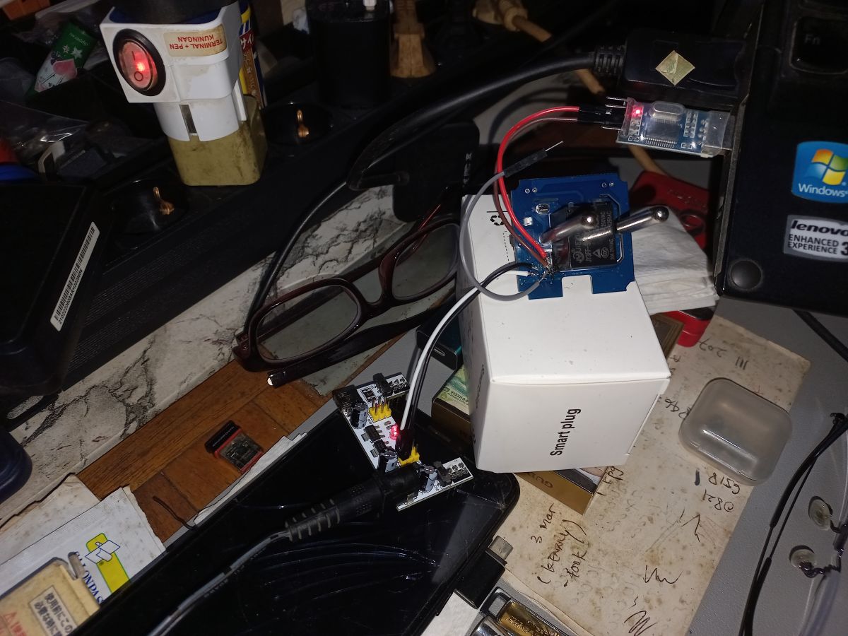

    On the back of the PCB, there are convenient pads to solder the USB-UART adapter
    Electronic circuit with JIEYING relay and connected wires.

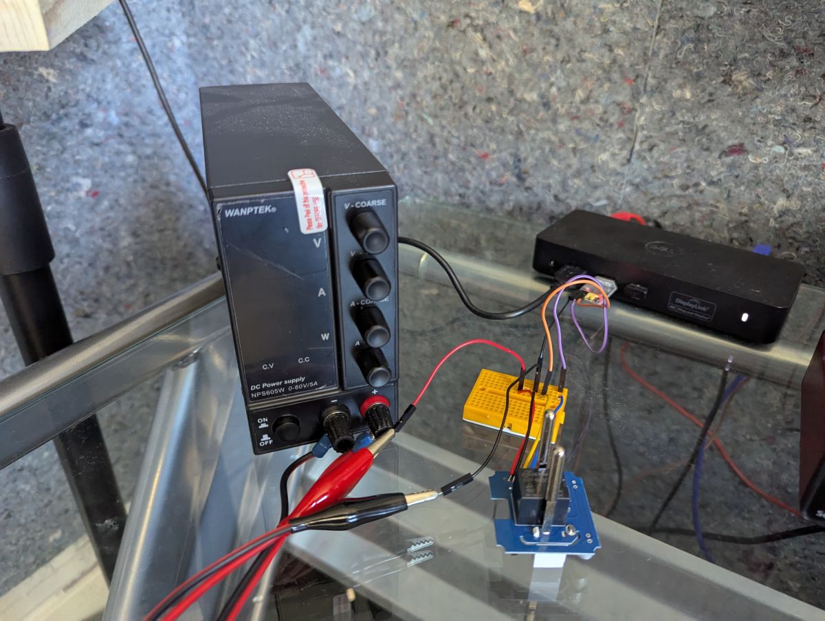

    Then we need an external 3.3V power source, I used an adjustable lab one
    Laboratory power supply and prototype board on a glass desk.
    I used this guide https://www.elektroda.com/rtvforum/topic4111822.html to flash the firmware, in a nutshell you need to:
    1) Download ESWIN_ECR6600_RDTool_v1.0.21.zip from here https://github.com/openshwprojects/FlashTools/tree/main/TransaSemi-ESWIN and use RDTool.exe
    2) In RDTool you double click "develop tool" tab, select the COM port, and on "all-in-one file path" select the firmware from latest release https://github.com/openshwprojects/OpenBK7231T_App/releases/ (ECR6600 UART Flash) - I used OpenECR6600_1.18.62.bin
    3) Then you need to click start and enable the power source of a device. You might not get in sync from the first attempt (there is some very specific timing, smth like 0.5 sec to power device after start clicked) - that's okay, you will succeed eventually.
    4) After the program finishes the flashing - you all set, the device runs free firmware now.
    Now you can unsolder the wires, put PCB back in a case and try to put it in the socket. WiFi hotspot should be running now.

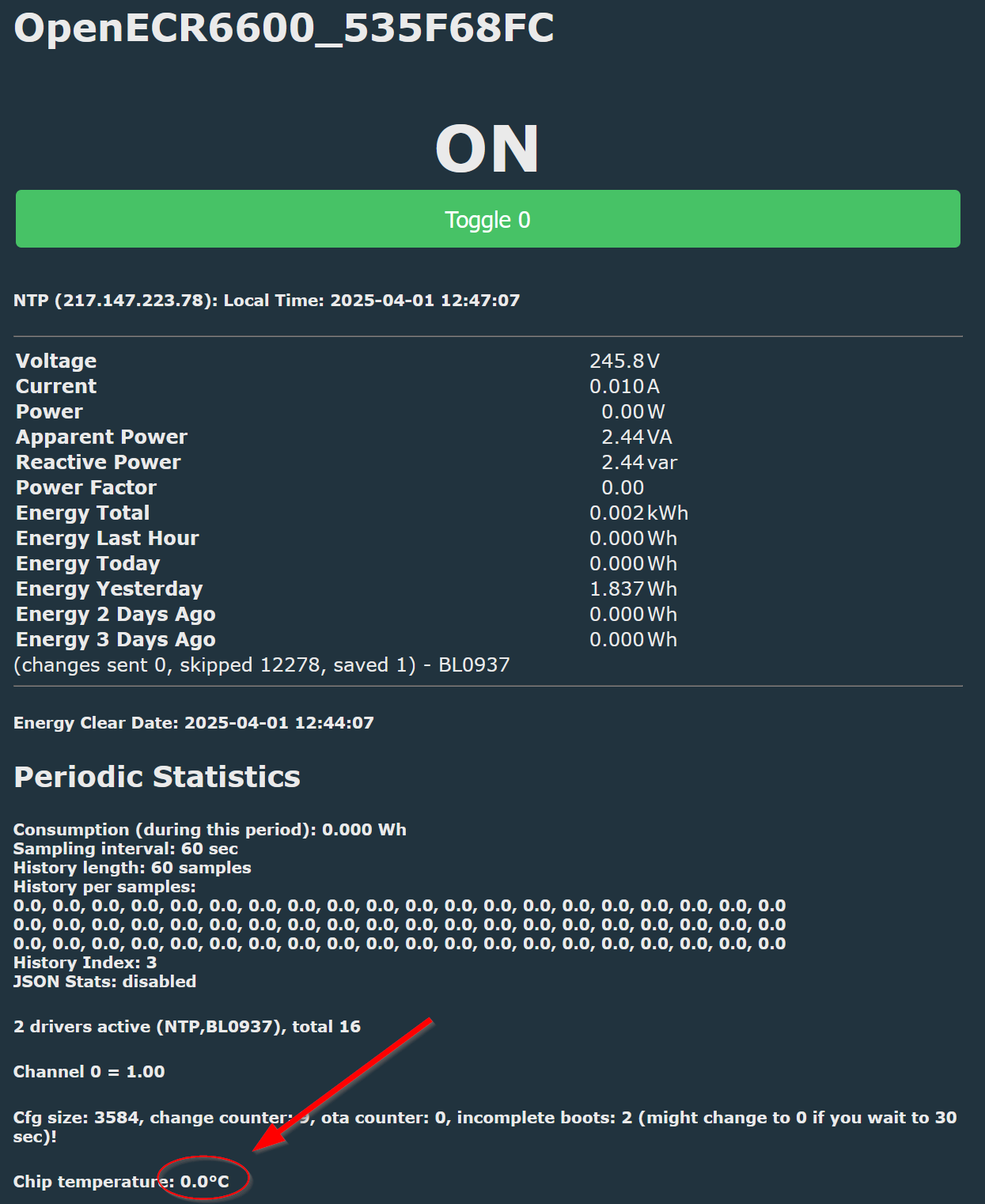

  • #8 21503392
    jannie_doedel
    Posts: 9
    works like a charme !!
    Tried to load NTP and worksfine too.
    Only chip temp is 0.0. Without config it showed 44 degrees.

    >>21503392
    The temperature indication must have been a glitch as it is working now

    insmod
    Posts: 1407
    Help: 164
    Rate: 443
    >>21503446 Not a glitch, on your screenshot there are 2 incomplete boots. If more than one - internal temperature readout is disabled.

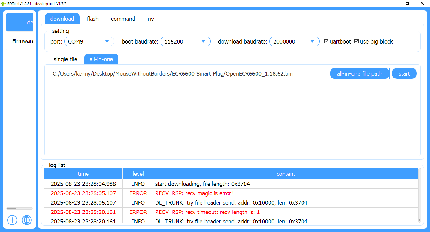

  • #16 21642454
    kennyyzm
    Hi guys, I have the same smart plug but I was not able to either backup old firmware not flash a new one. I keep getting RECV_RSP: recv timeout: recv length is: 1 (sometimes it's 3).
    RDTool window showing RECV_RSP error during firmware flashing process.
    Can someone help please? I have no idea what's that error about...
  • #17 21642461
    Posts: 14649
    Help: 655
    Rate: 12660
    So, how do you connect UART to your plug? Can you share some photos?
  • #18 21642470
    kennyyzm
    Here's the photo, I broke both TX and RX pads and resorted to use the copper trace for both.
    Electronic boards connected with wires on a cluttered desk with tools, glasses, and paper notes.

    Posts: 14649
    Help: 655
    Rate: 12660
    Well, first of all, you need to have a common ground between power supply and the UART... if you use external power supply, GND must connect to both external power supply GND and USB to UART converter GND.
  • #20 21642493
    kennyyzm
    @p.kaczmarek2 Wow, it works right away. Thanks for your help. I thought it's not possible to flash it anymore since I broke the pads, hehe, Thanks again!

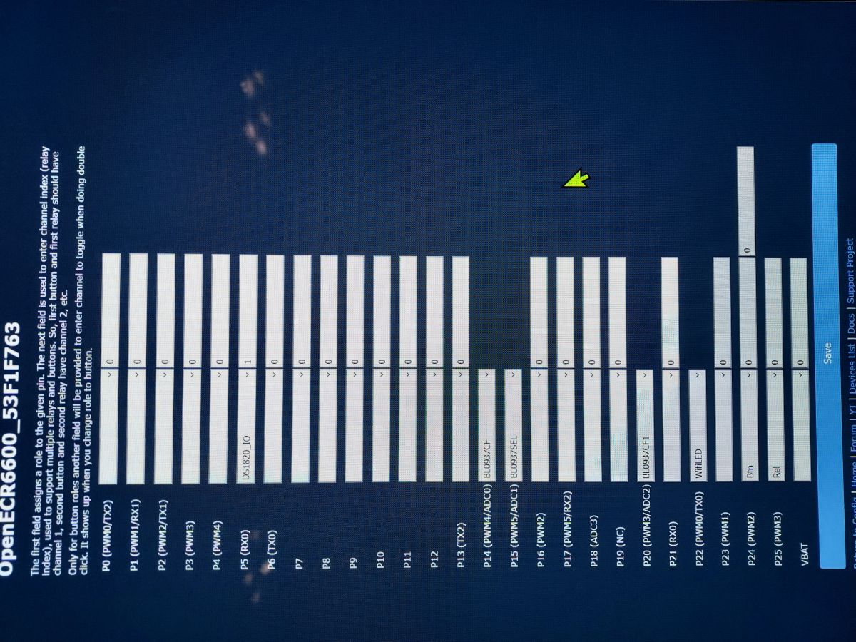

    One more thing considering this device. There seems to be a bit confusion on the config page.
    I suppose RX0 and TX0 are not ment to be there twice. See Pins 5,6,21 and 22.
    Microcontroller pin assignment screen with channel labels and options visible.

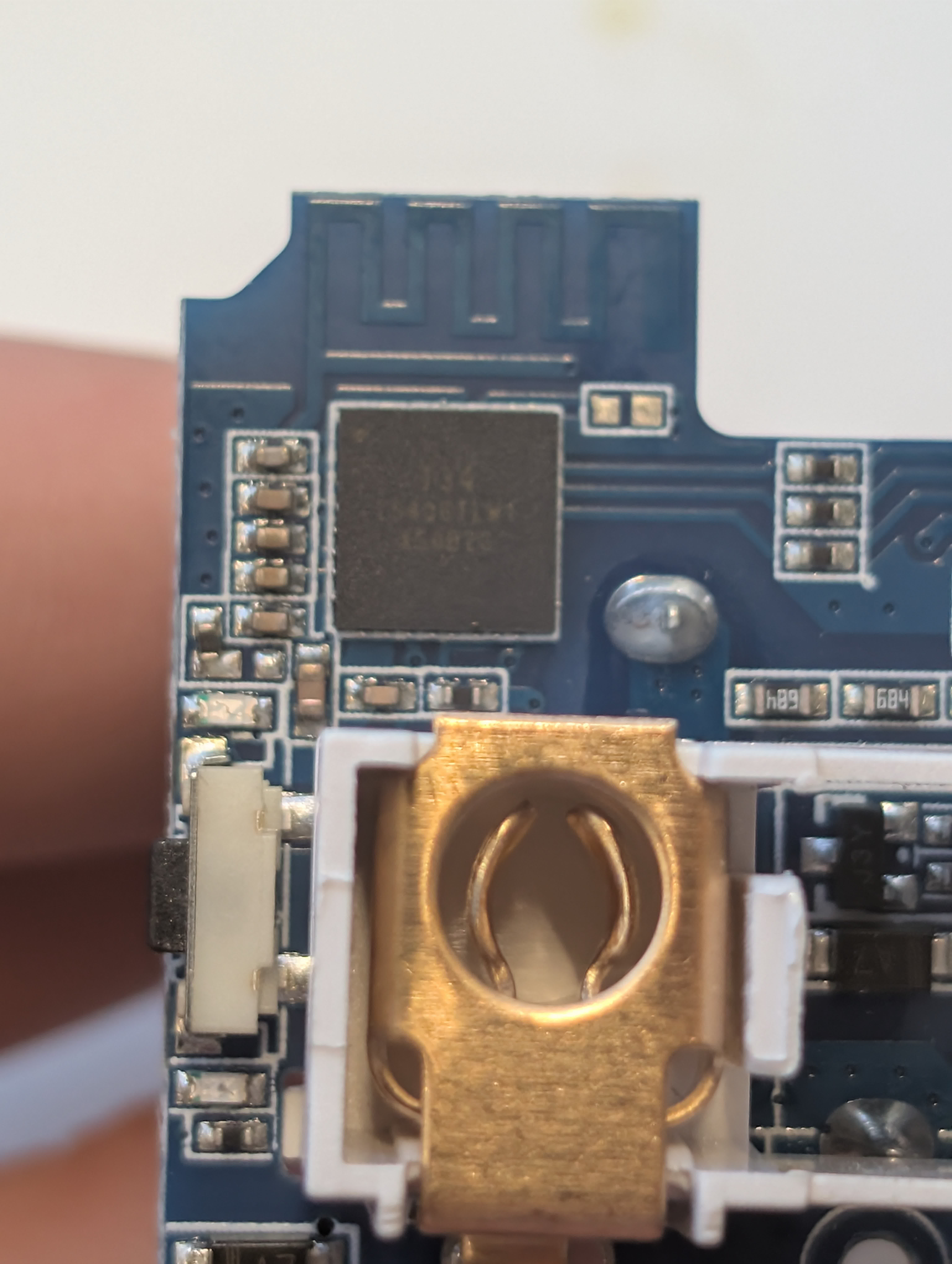

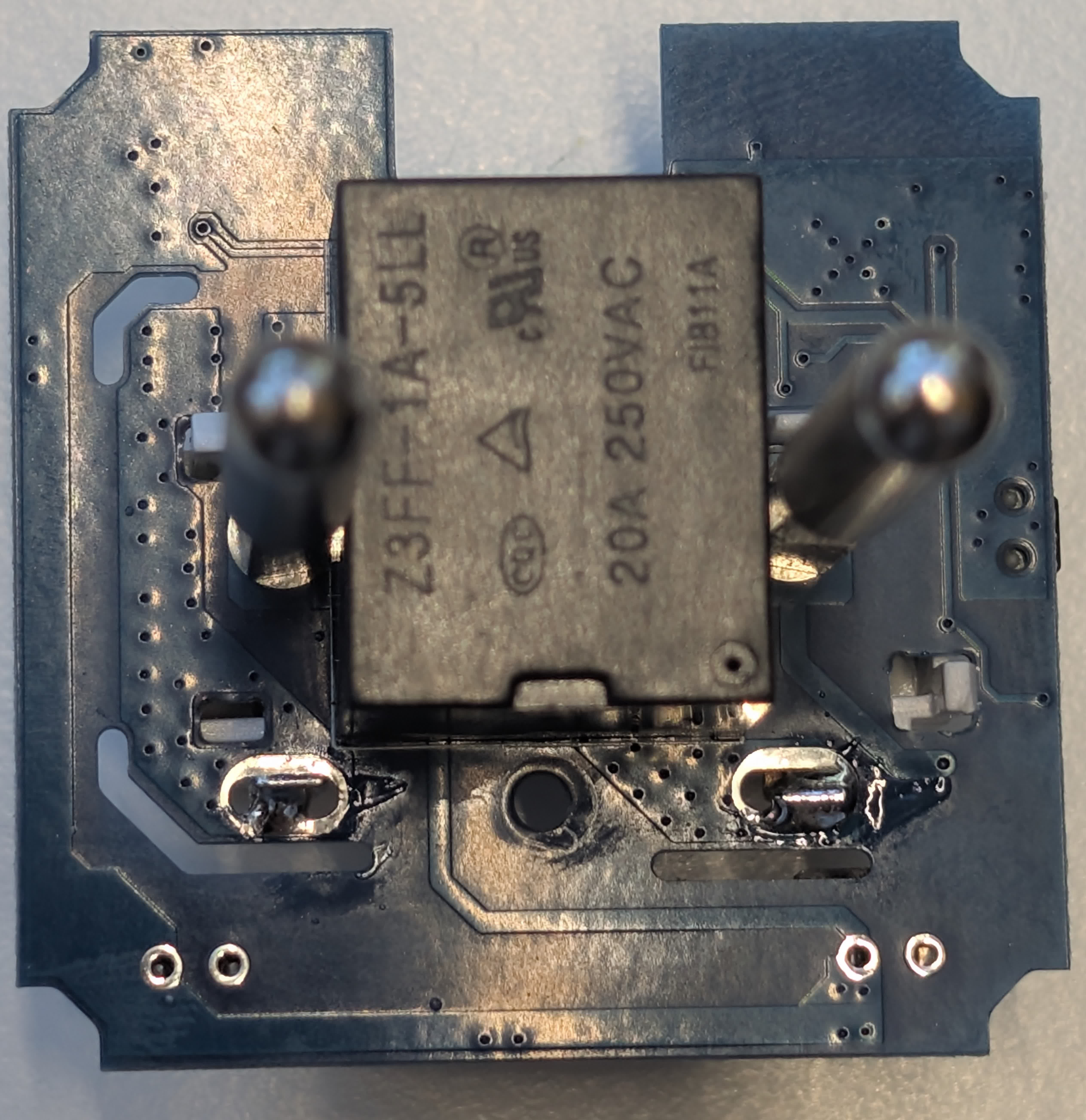

    They seem to have updated the PCB and now use a T34 chip. Unlike the other T34 posts I've seen this one doesn't even have visible pins. It's a shame because it used to be one of the easiest to flash and now it's very complicated. Does anyone have ideas how to flash it without desoldering the chip?

  • #29 21894189
    avgapon
    Posts: 9
    >>21894156
    That's a completely different product then and you should find the appropriate topic for it (T34 + BL0942).
    The device is quite easy to flash by connecting to pins of the power monitoring chip and the nearby voltage regulator.

  • The plug uses an ECR6600 Wi-Fi platform and a BL0937CF metering chip, with UART flashing powered from an external 3.3V supply. [#21485550]

How do I open the TNCE Tuya Smart Plug from AliExpress without damaging the plastic case or PCB?
Open it by gently squeezing both sides in a vice until the glue cracks, then split the plastic shell into 2 halves. After that, remove the single small screw and lift out the PCB. This method was reported to open the case with little damage to either the enclosure or board. [#21485550]
What is the step-by-step process to flash OpenBeken onto an ECR6600-based Tuya smart plug using ESWIN_ECR6600_RDTool?
Use RDTool with UART Flash firmware for ECR6600. 1. Download ESWIN_ECR6600_RDTool_v1.0.21 and load the latest OpenECR6600 UART Flash .bin. 2. Select the correct COM port, double-click the develop tool tab, then press Start. 3. Apply external 3.3V power immediately after Start; if sync fails, retry the timing until flashing completes. [#21485550]
Why does RDTool show "RECV_RSP: recv timeout" when trying to back up or flash an ECR6600 plug, and how can I fix it?
RDTool usually times out because the UART wiring or power reference is wrong. One successful fix was adding a shared ground between the external power supply and the USB-UART adapter. Another common cause is boot timing; the plug may need power about 0.5 seconds after clicking Start. [#21642476]
How should I wire the USB-UART adapter and external 3.3V power supply to the ECR6600 smart plug, including the common ground connection?
Wire TX, RX, and GND to the PCB pads, then power the plug from an external 3.3V source. The critical rule is that the USB-UART adapter and the external supply must share the same ground. One user fixed instant failures only after connecting GND to both the power supply and the UART converter. [#21642476]
What pin configuration works for the TNCE Tuya Smart Plug with ECR6600, relay, button, BL0937CF power metering, and WiFi LED?
A working OpenBeken template is P14 BL0937CF, P15 BL0937SEL, P20 BL0937CF1, P22 WifiLED, P24 Btn, and P25 Rel. The first published template omitted the LED, but later replies confirmed P22 for the WiFi LED. That 6-pin mapping is the most complete config shown for this plug. [#21503405]
Where is the WiFi LED connected on this ECR6600 smart plug, and how should it be configured in OpenBeken?
The WiFi LED is on pin P22 and should be configured as WifiLED;0 in OpenBeken. A later reply corrected the earlier template and matched the device-list entry for this model. If the LED is missing after flashing, P22 is the first pin to check. [#21503405]
What is BL0937CF, and how does it measure voltage and current in Tuya smart plugs?
BL0937CF is a power-metering chip that measures the plug’s electrical values and exposes them through CF, CF1, and SEL pins. In this plug, the board uses BL0937CF for voltage and current measurement, and the published OpenBeken map assigns P14, P15, and P20 to those metering signals. [#21485550]

Why does chip temperature show 0.0 on OpenBeken after incomplete boots, and how can I restore the normal reading?
Chip temperature shows 0.0 because repeated incomplete boots disable the internal temperature readout. A developer explained that if there is more than one incomplete boot, the internal sensor is turned off. Restore normal reading by fixing the boot stability issue and letting the device complete a clean boot cycle. [#21503467]

Why are RX0 and TX0 shown twice on the ECR6600 config page, and which UART pins are the correct ones to use?
The duplicate RX0 and TX0 entries appear to be a config-page labeling issue, not a second usable UART pair. A later post noted the duplication on pins 5, 6, 21, and 22 and questioned it directly. For flashing this plug, users relied on the actual PCB UART pads shown on the board back side, not the duplicated labels. [#21745196]
