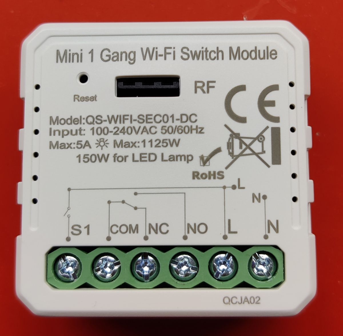

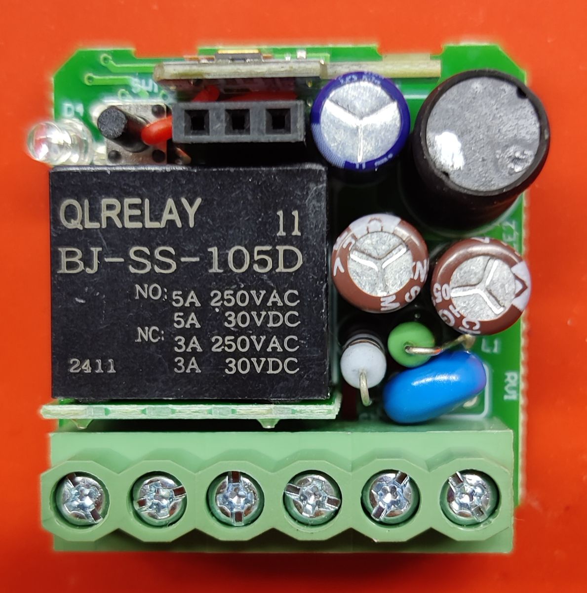

    New switch module arrived, with the isolated relay. It also has an RF port to connect RF submodule, but no RF module arrived with it.

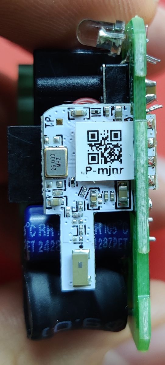

    The module contains an unknown controller module soldered in. Controller module has only "P-mjnr" marking and QR code ZOQH18SY00733

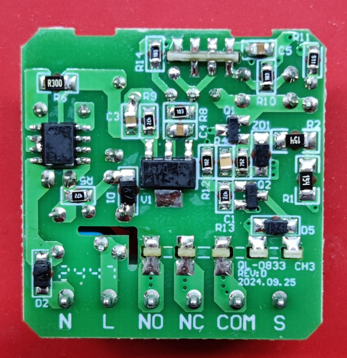

    Module PCB has also marking
    QL-0833
    REV:0
    2024.09.25
    Has someone faced such a module?

    I think I also posted a teardown of such module once. I remember this RF socket. It can be used as generic GPIO, but it is not isolated from mains, so touching it can be very dangerous. I have bought my piece on polish site Allegro.

    I desoldered the module from the PCB and it is CBLC9S (BK7231N).
    There is no possibility to update firmware without module desoldering because RX and TX do not get out of the module.
    Small PCB marked CBLC9S with wires soldered to labeled pins
    I read Tuya firmware and wrote OpenBeken one.
    But unfortunately, it cannot decode the Tuya config, so I don't know the pins.
