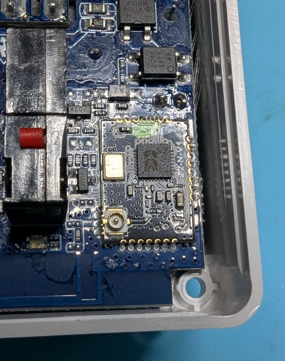

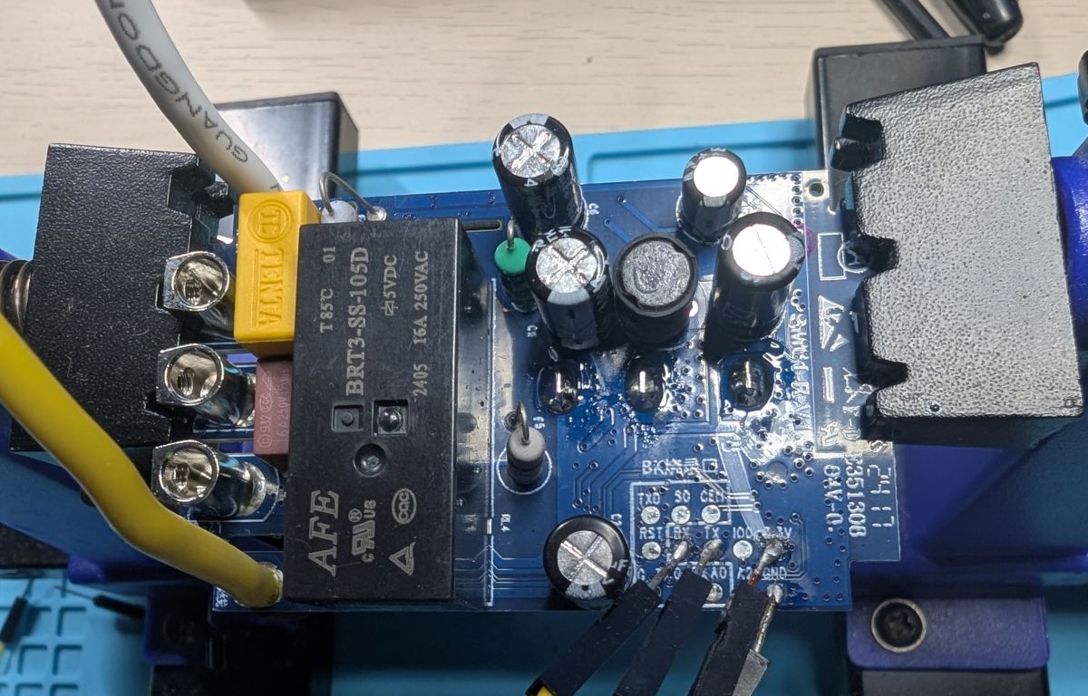

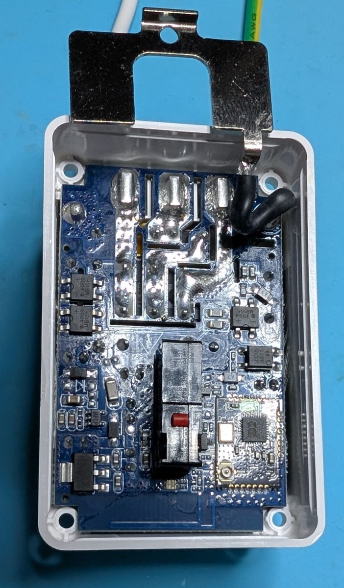

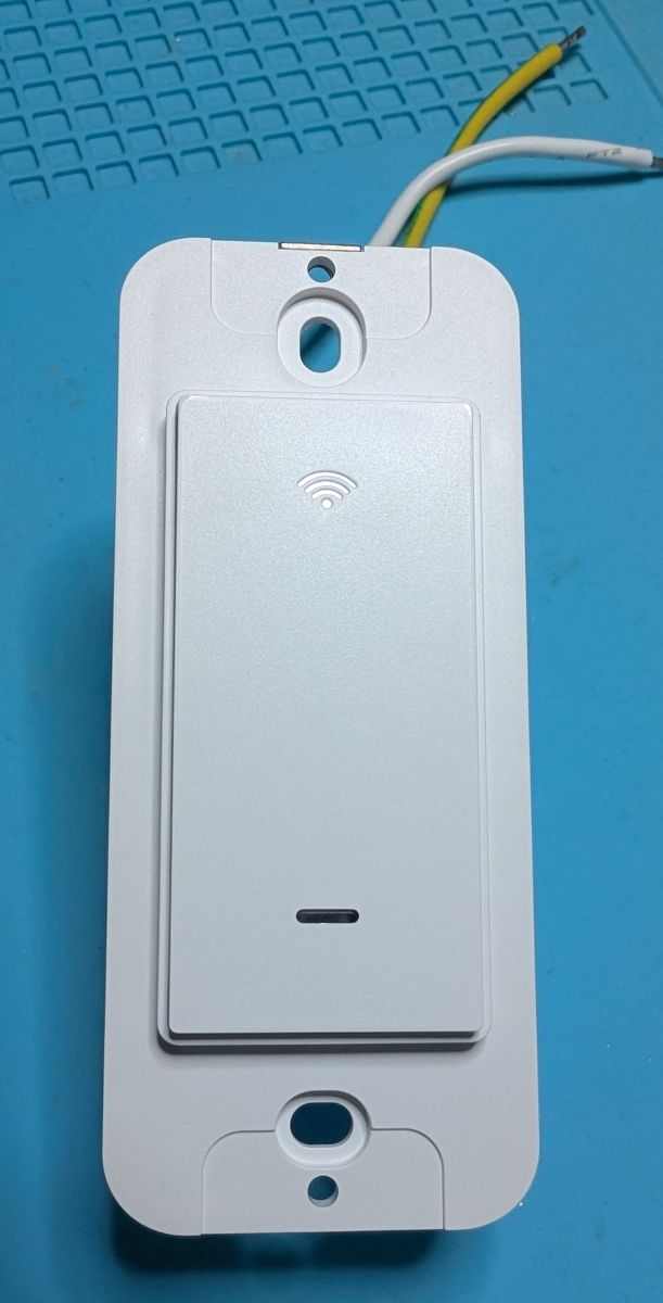

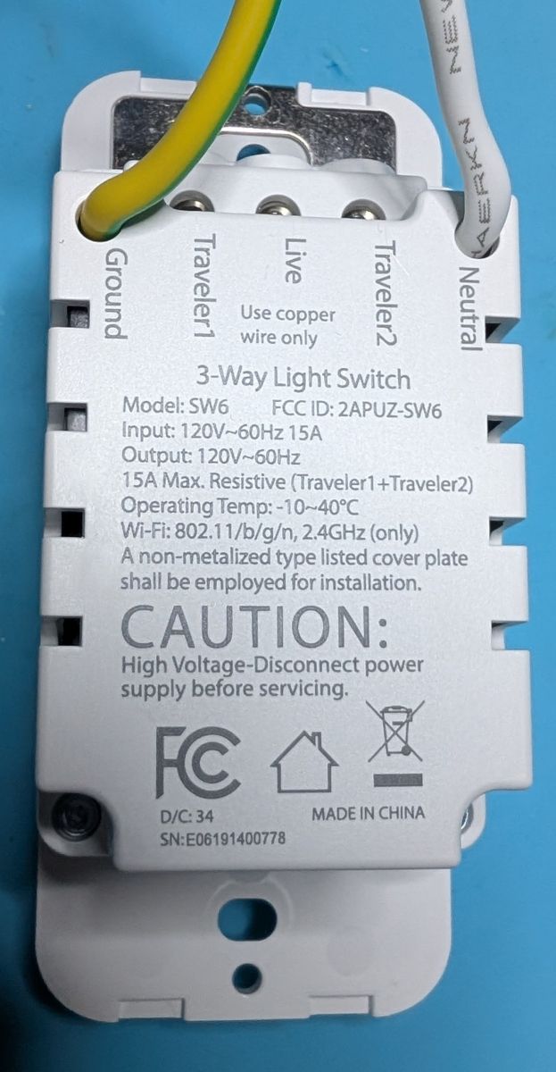

    i just installed OpenBeken on a GHome SW6 3-Way switch with BF7231N chip.
    Here are some pictures:
    Front: White smart light switch with WiFi icon and three wires coming out from the back. Back: Back view of a smart 3-way light switch with labeled wire connections and technical information.
    Config after flashing:
    - Green LED will iluminate when the load is on and >10W
    - Red LED will illuminate when the load is off
      "pins": {
        "6": "Rel_n;1", - Relay
        "14": "LED;2", - Red LED
        "22": "Btn;1", - Button
        "24": "dInput_NoPullUp_n;2", - Load detector input, low when load is >~10W
        "26": "LED_n;2" - Green LED
    Internals:
    A printed circuit board of an electronic device inside a plastic case with a metal mounting bracket.
    BK7231N chip:
    Electronic module with integrated circuit on a PCB inside a plastic enclosure.
    Serial:
    Close-up of a circuit board with a relay, capacitors, and connected wires.
