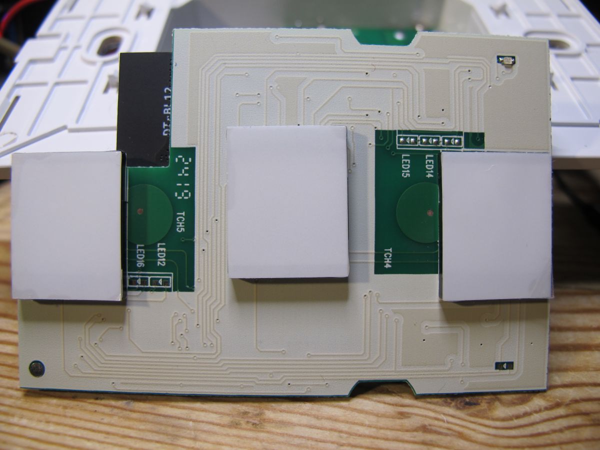

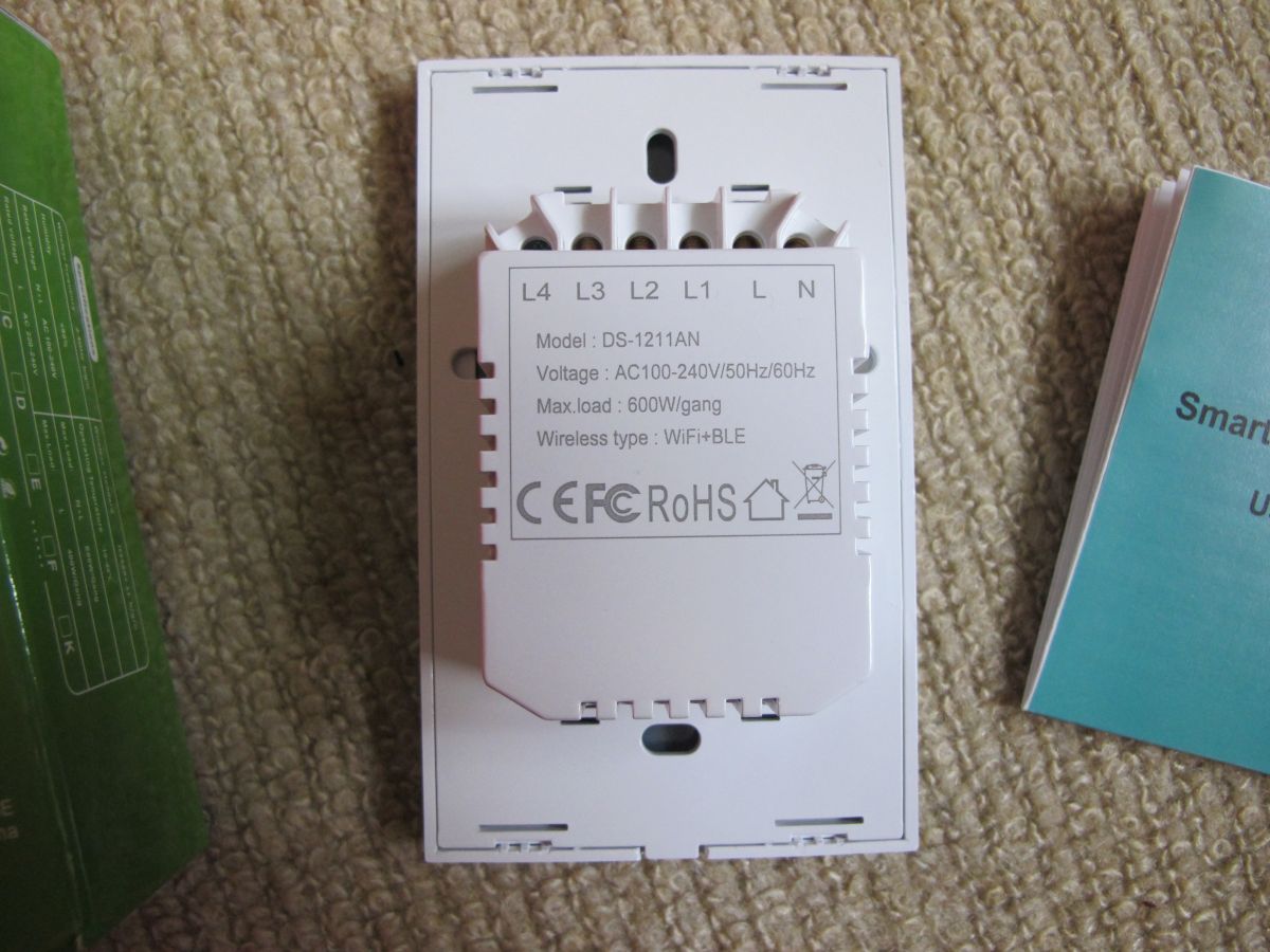

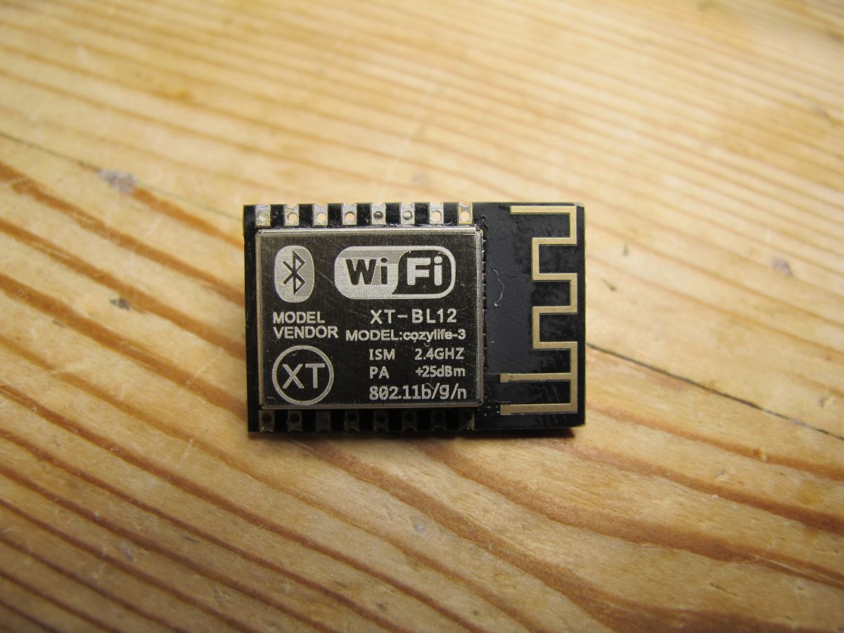

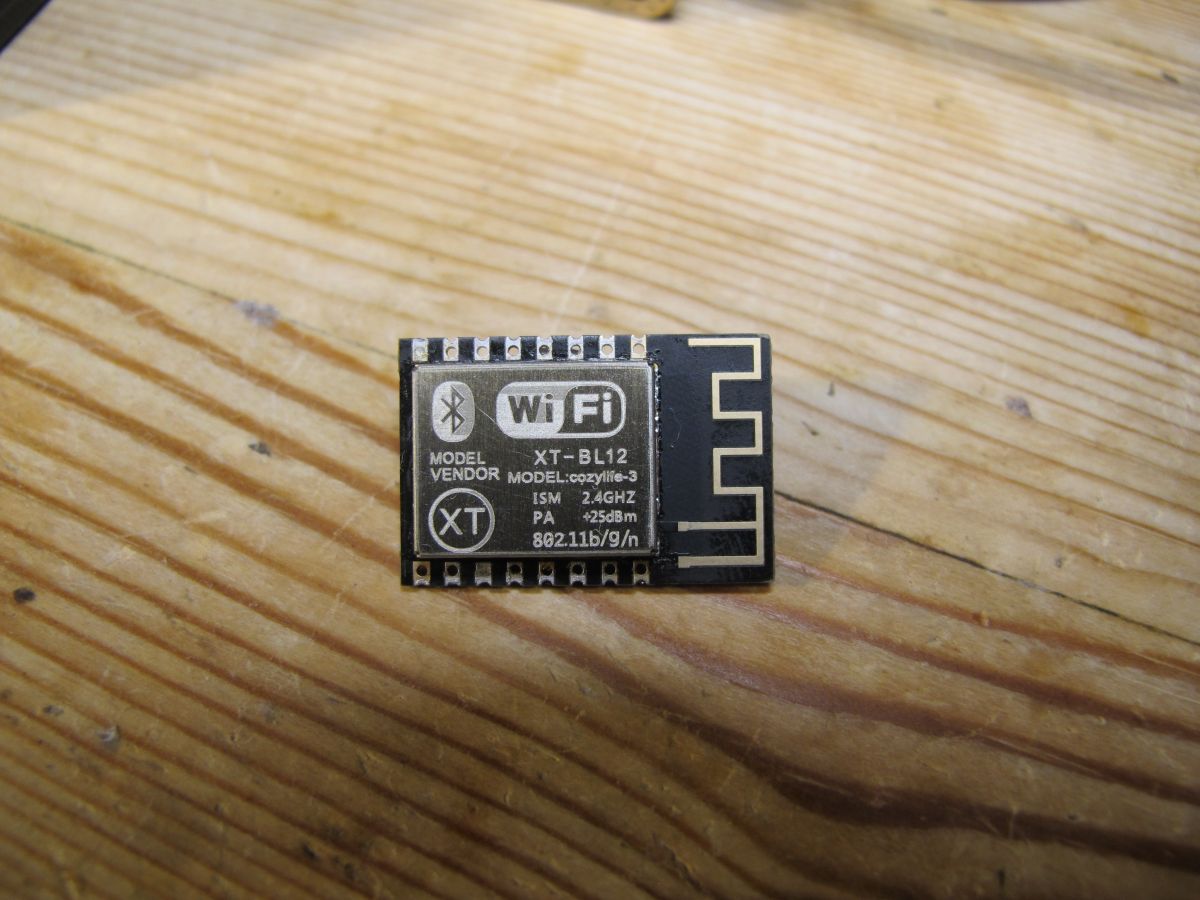

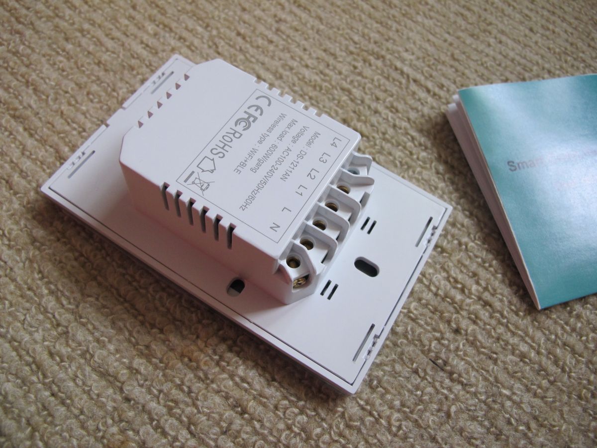

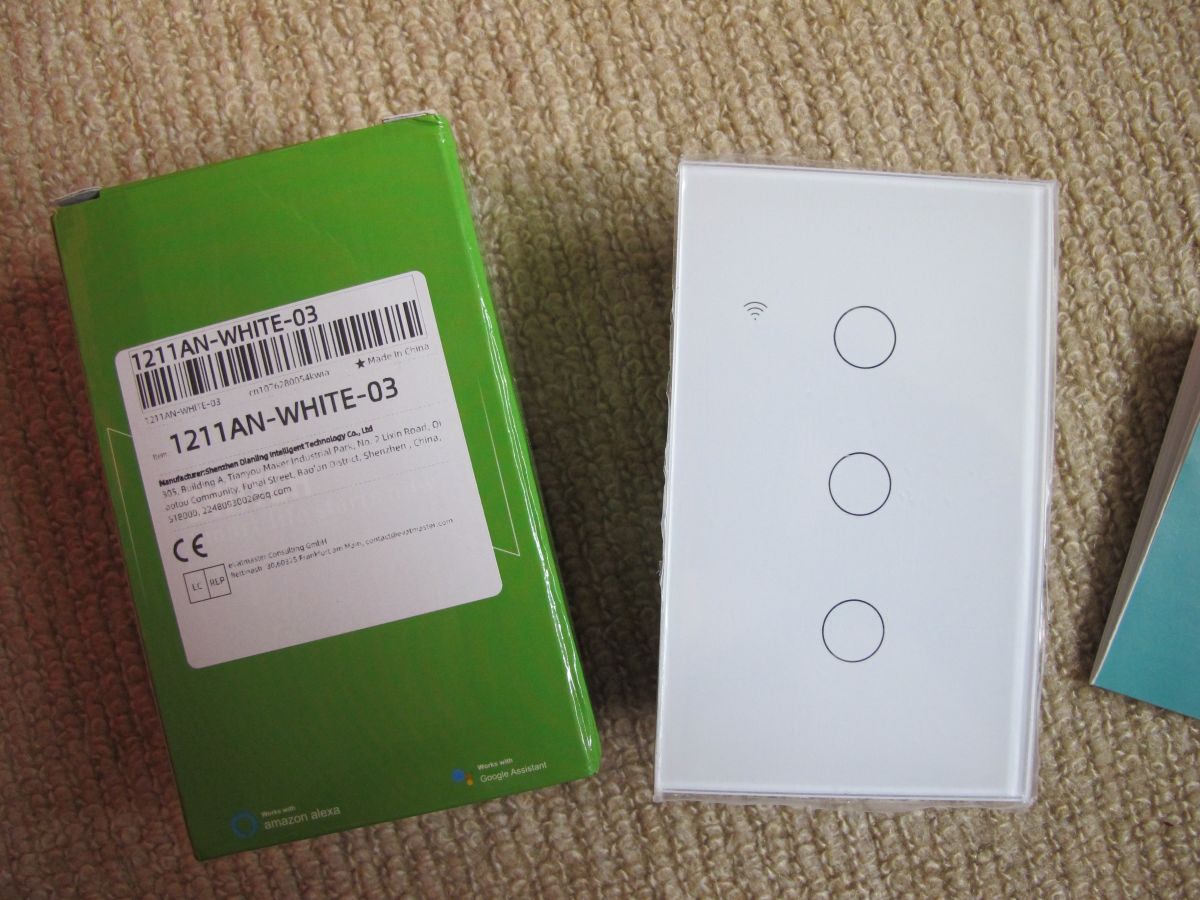

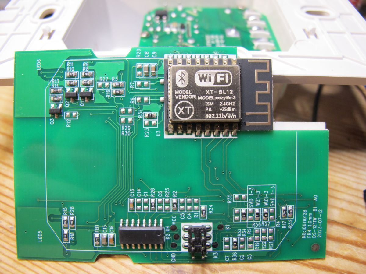

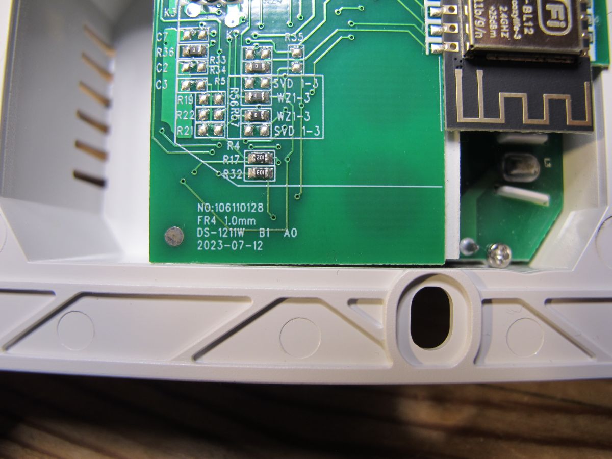

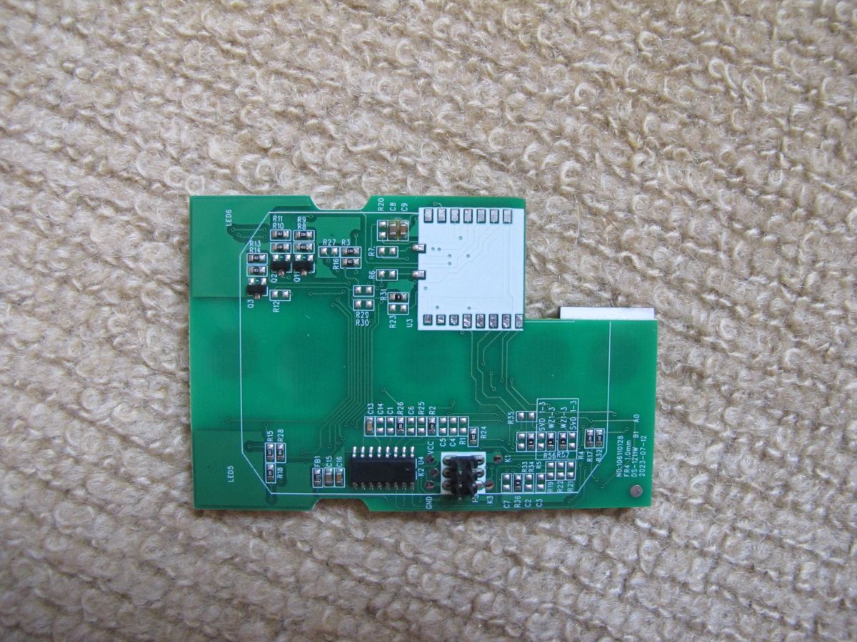

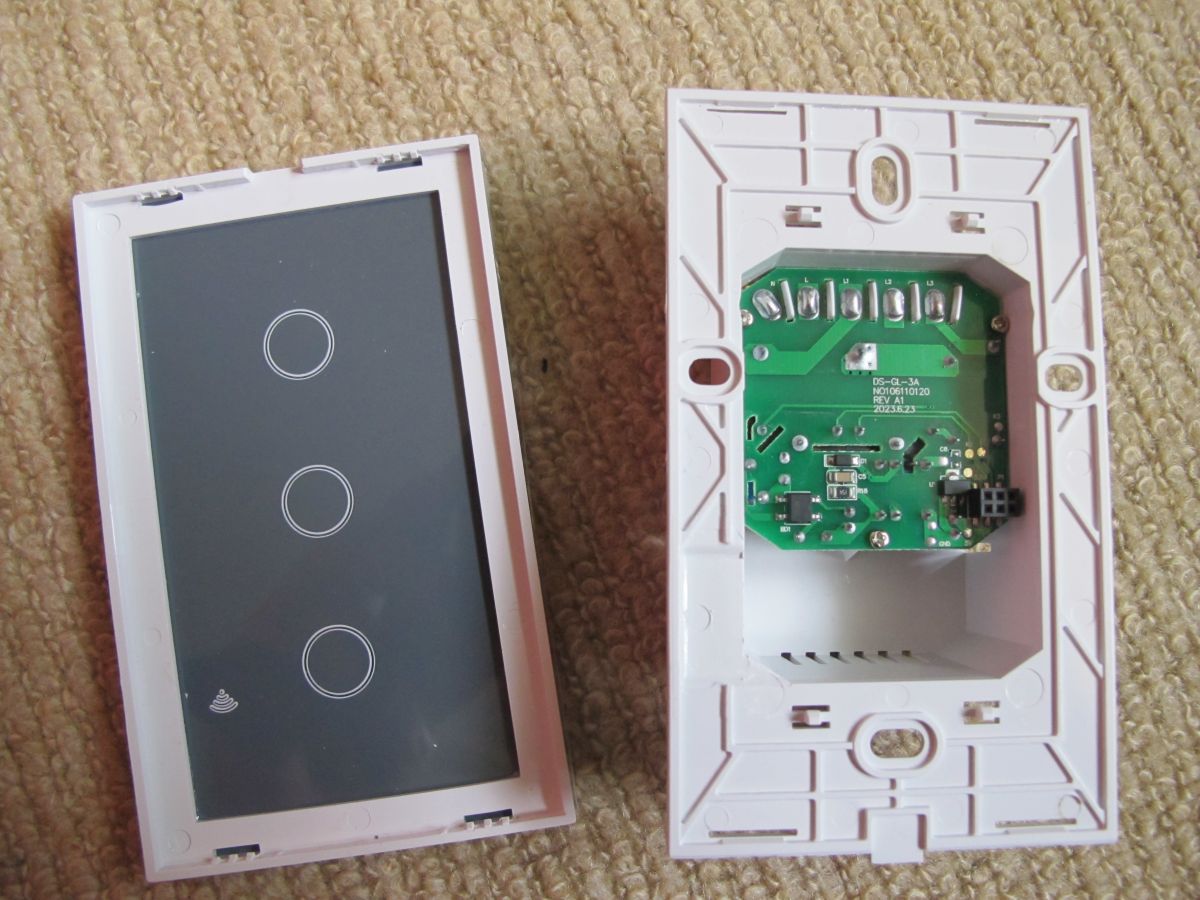

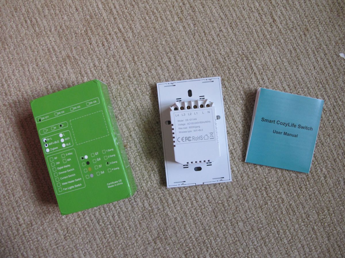

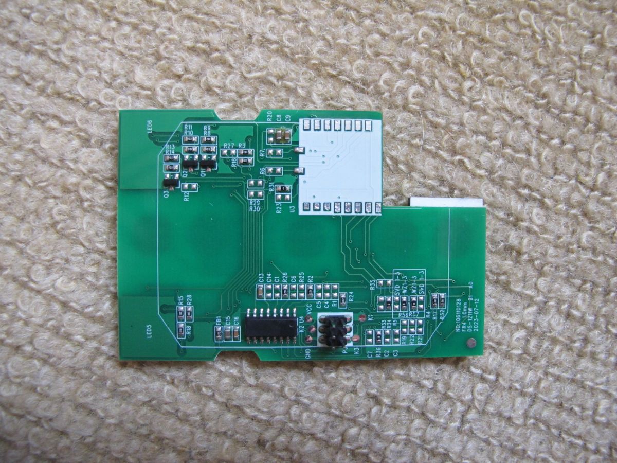

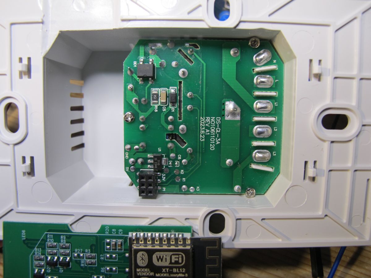

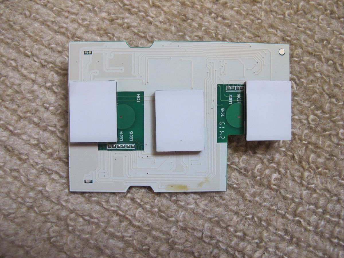

    This is the Cozylife DS-1211AN 3-gang touch wall switch. The sticker on the box states it was manufactured by Shenzhen Dianling Intelligent Technology Co Ltd.

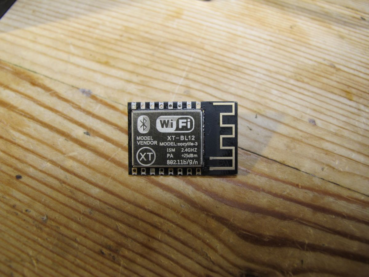

    Unfortunately it comes with a 1mb BL602 so is not an easy candidate for freeing from Cozylife cloud services as OpenBeken does not work on 1mb BL602s. It's a standard-sized 12S type module that could be replaced with an ESP-12S.

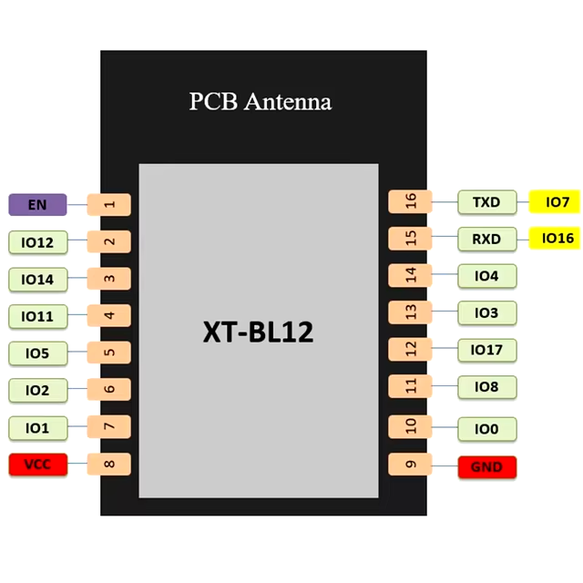

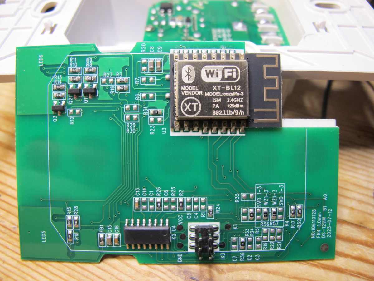

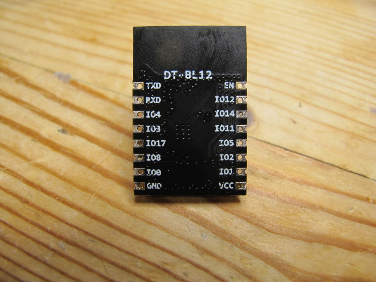

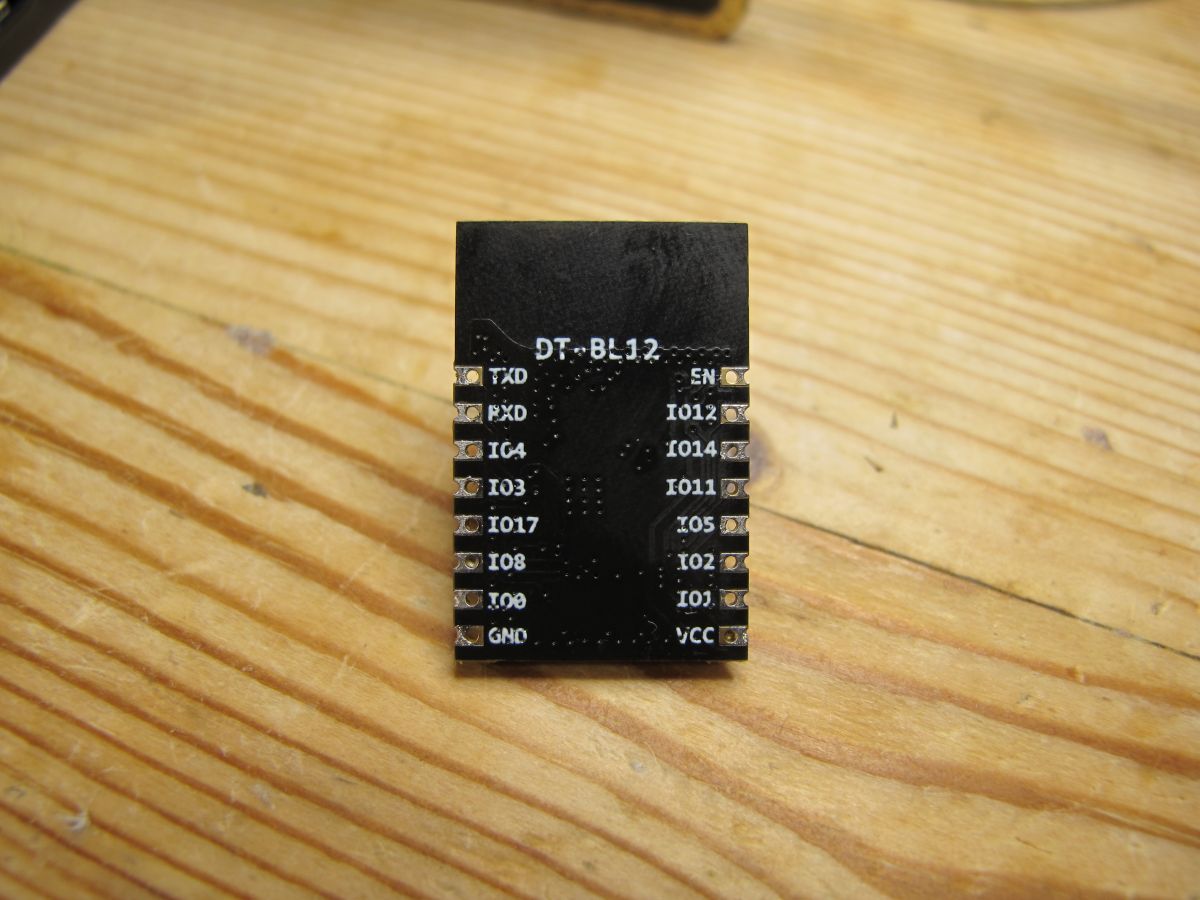

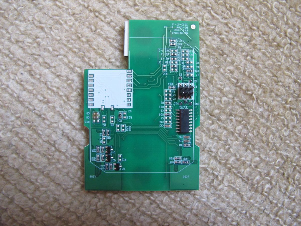

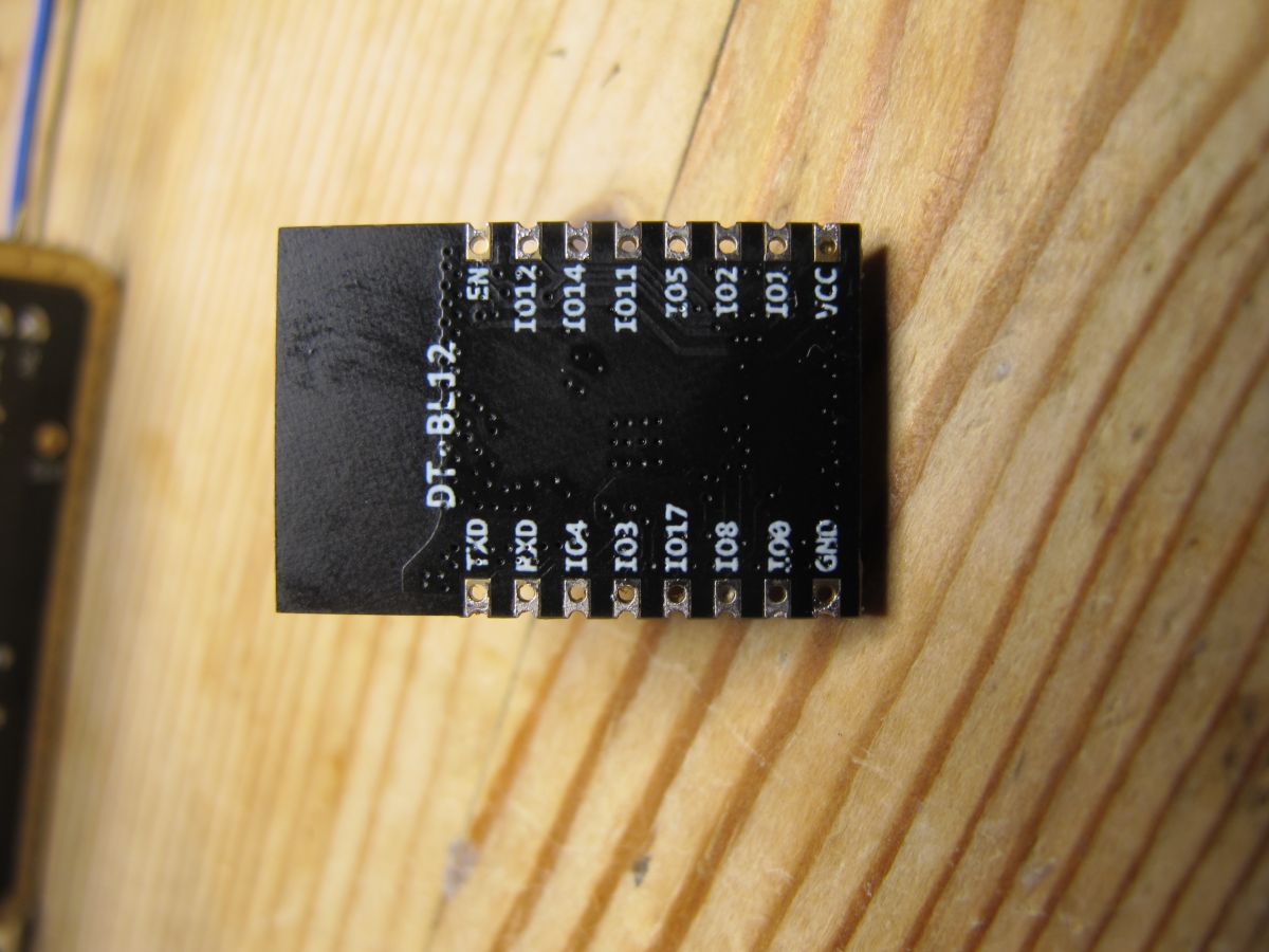

    The module is labelled as a Cozylife-3 XT-BL12 and DT-BL12, but unlike the DT-BL12 here https://cozylife.app/product/zh/hardware/wifi/dt-bl12.html the GPIOs/pads are as below
    Diagram of the XT-BL12 module with pins and a PCB antenna.

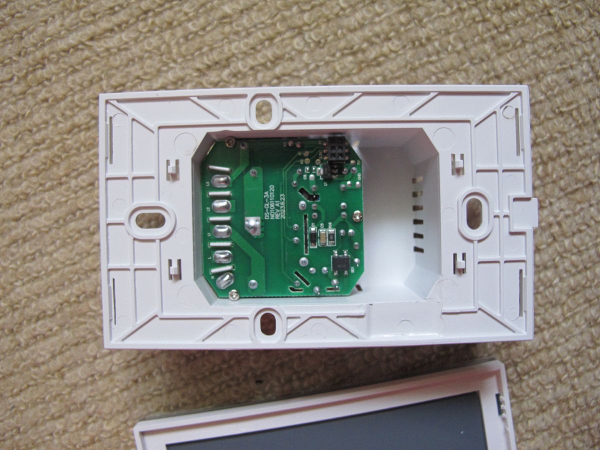

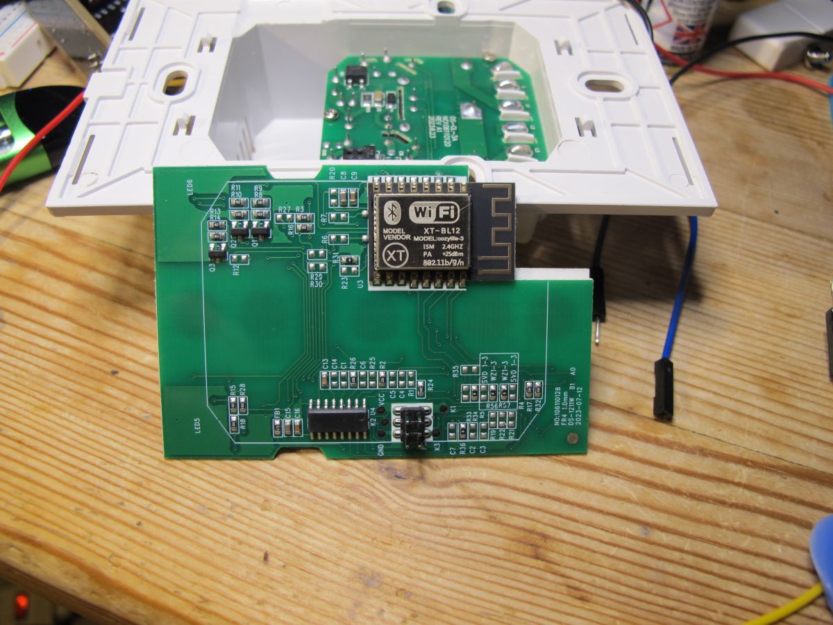

    Here's a load of pics.

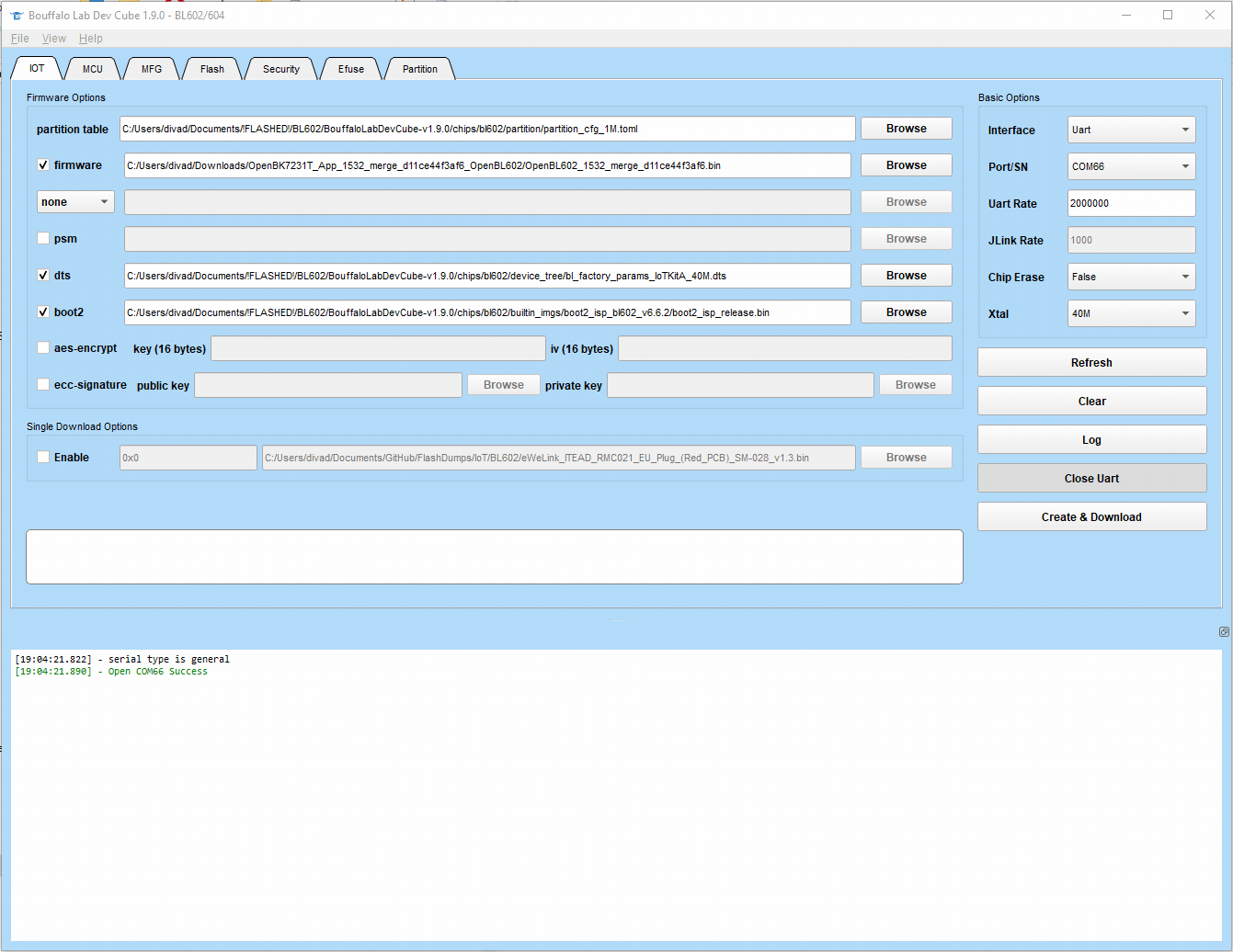

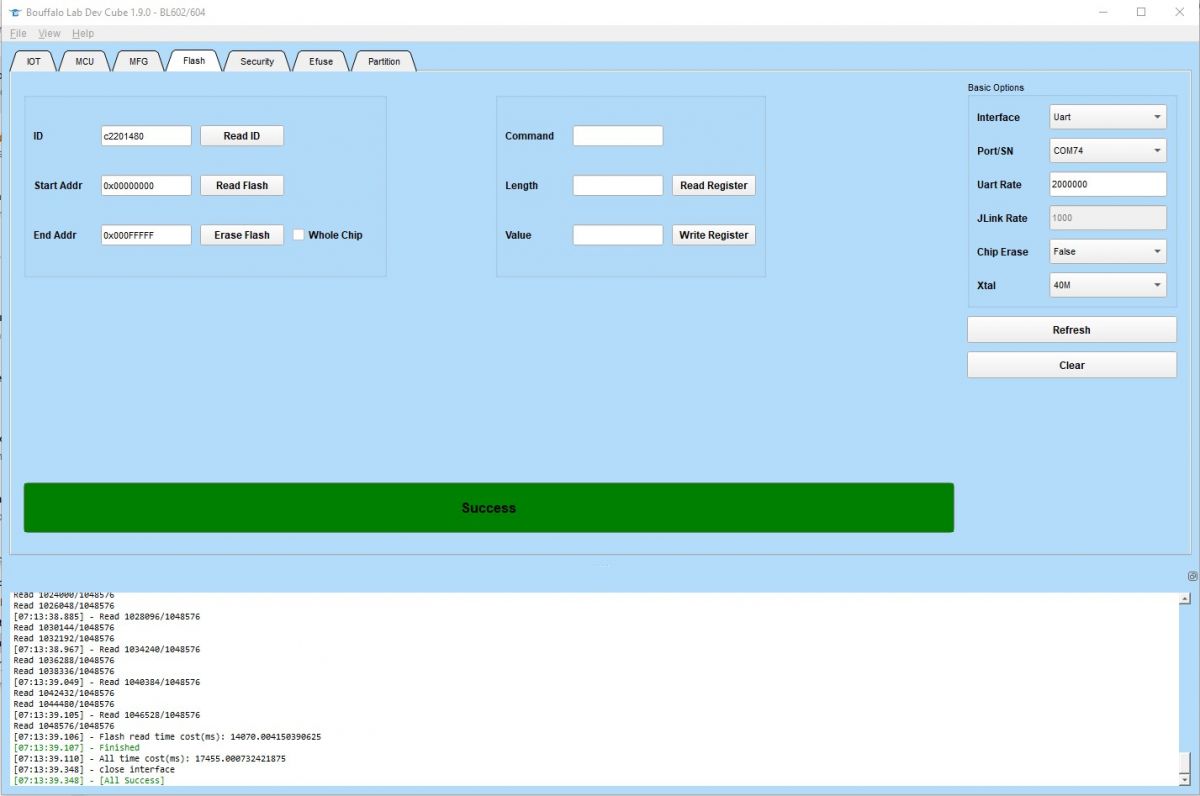

    Screenshot of Bouffalo Lab Dev Cube version 1.9.0 showing an interface for reading and writing flash memory. Circuit board with electronic components. Circuit board with three white buttons of the Cozylife DS-1211AN touch switch. PCB with electronic components and a connector on a carpet. Cozylife DS-1211AN circuit board on a woolen carpet. Interior of a plastic casing of a 3-gang touch wall switch Cozylife DS-1211AN with a visible green circuit board. Partial view of the Cozylife DS-1211AN 3-gang touch wall switch with open casing. A Cozylife DS-1211AN three-key touch wall switch lying on a beige carpet next to a user manual. 3-pole touch wall switch Cozylife DS-1211AN and its packaging. Back of the Cozylife DS-1211AN 3-gang wall switch with specification details. Box, switch, and user manual for the Cozylife DS-1211AN touch wall switch. DT-BL12 module with short-range contacts on a wooden background. Cozylife DT-BL12 module with visible pins on a wooden surface. View of DT-BL12 module on a wooden surface showing pins. Wi-Fi XT-BL12 module lying on a wooden surface. XT-BL12 Cozylife-3 module with Wi-Fi and Bluetooth markings. Cozylife XT-BL12 Wi-Fi module on a wooden background. Close-up of a circuit board in a Cozylife DS-1211AN three-way wall switch. Interior of the Cozylife DS-1211AN 3-gang touch wall switch showing the circuit board and components. Electronic circuit board inside the Cozylife DS-1211AN wall switch with visible modules and connectors. Close-up of a circuit board with visible traces, resistors, and a connector. Close-up of a circuit board from the Cozylife wall switch with a visible WiFi module labeled XT-BL12. Printed circuit board with Cozylife-3 XT-BL12 module. Close-up of a circuit board with a Cozylife XT-BL12 Wi-Fi module.

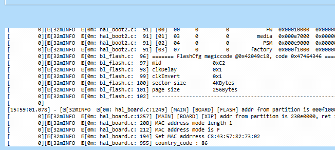

    UART boot log
    and firmware backup attached
    • flash.bin (1 MB) You must be logged in to download this attachment.

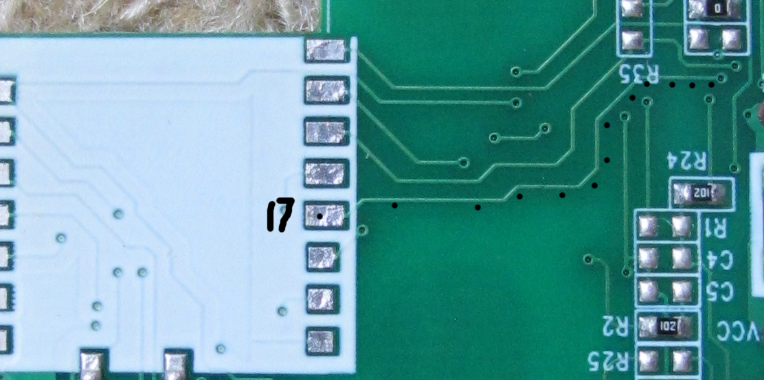

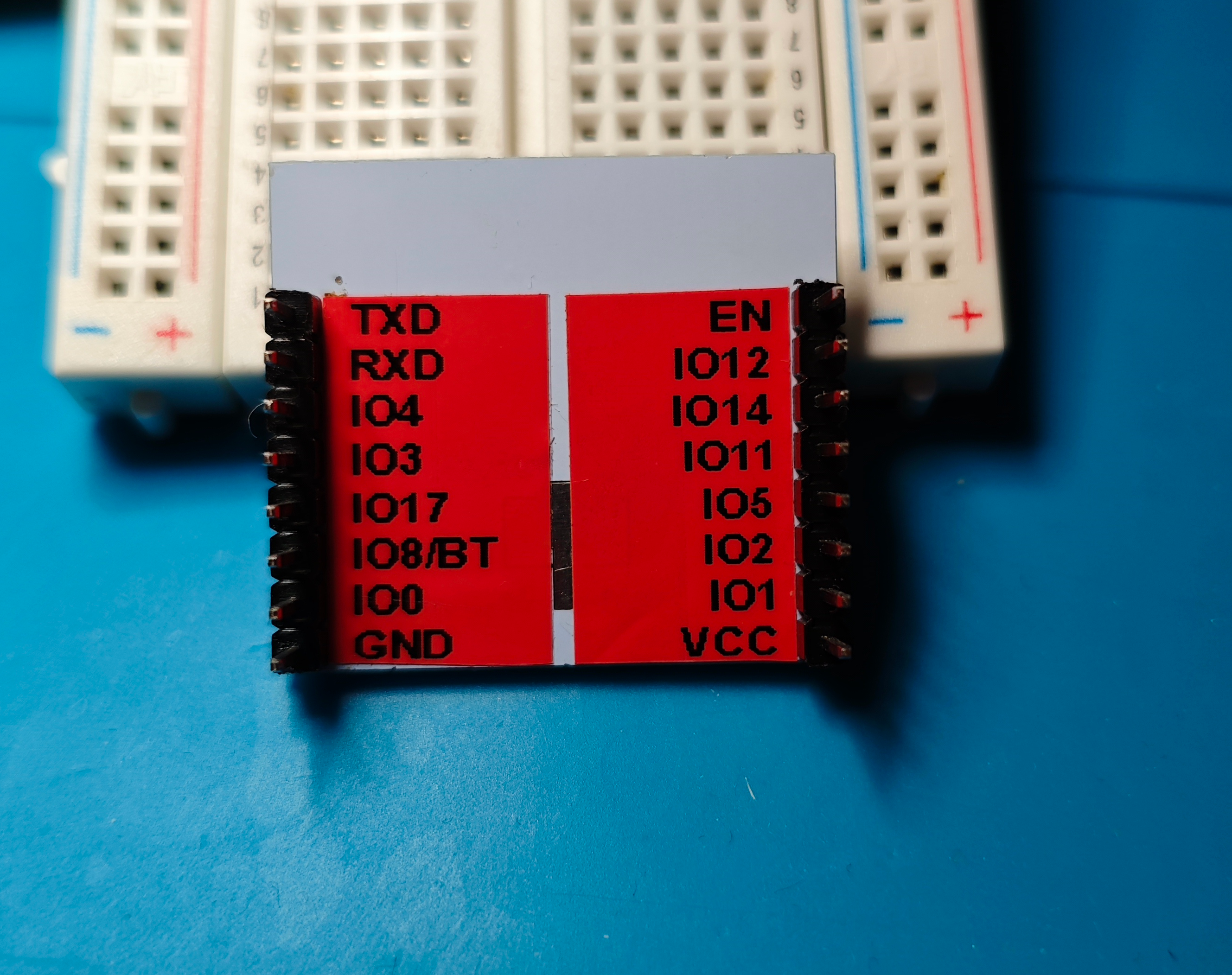

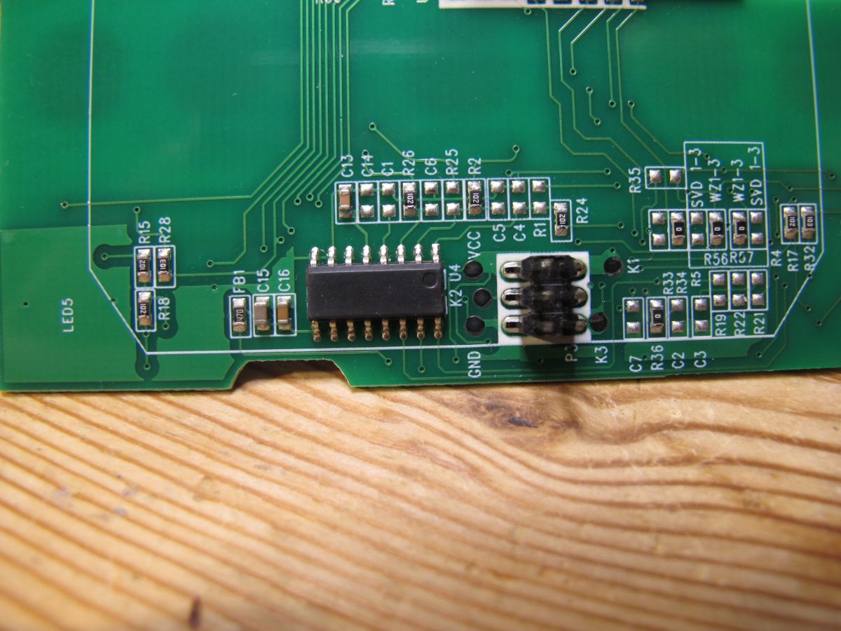

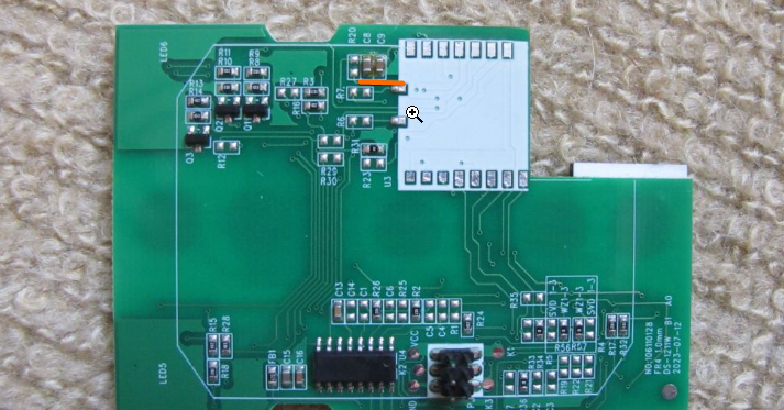

    >>21301826 Is GPIO17 used for anything? If so, then transplantation to ESP-12 would require to solder additional resistor to IO0-3V3 (about 1K), otherwise it may not boot.
    On this switch, when i replaced the stock BL602 module with an ESP one, GPIO0 low at boot prevented it from working.
  • #3 21302067
    Posts: 5195
    Help: 446
    Rate: 913

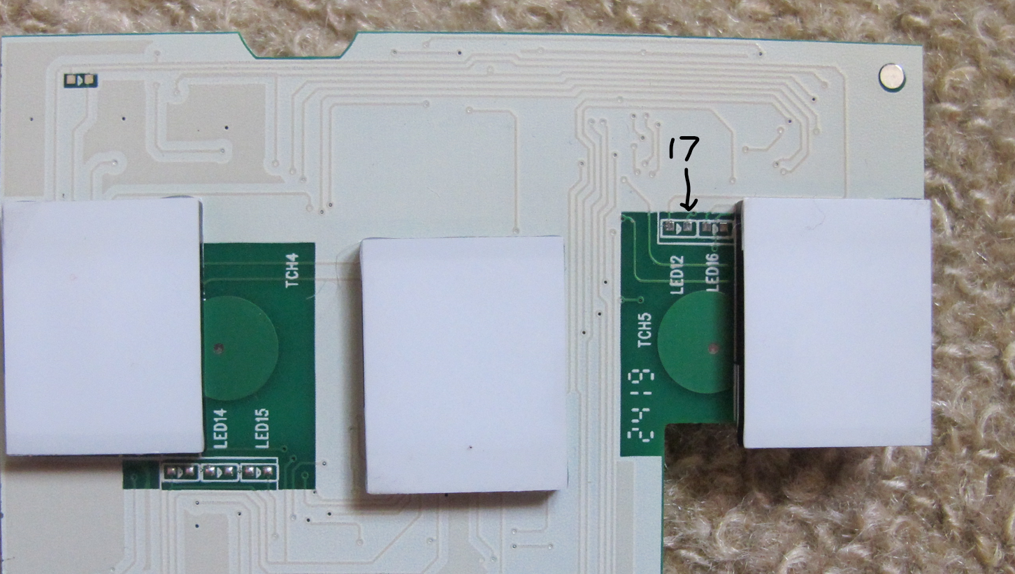

    good point. module swap is conditional.
    GPIO17 traces to:
    Electronic board with visible pin connections and GPIO17 marking.
    Portion of a circuit board with labels LED12 and GPIO17

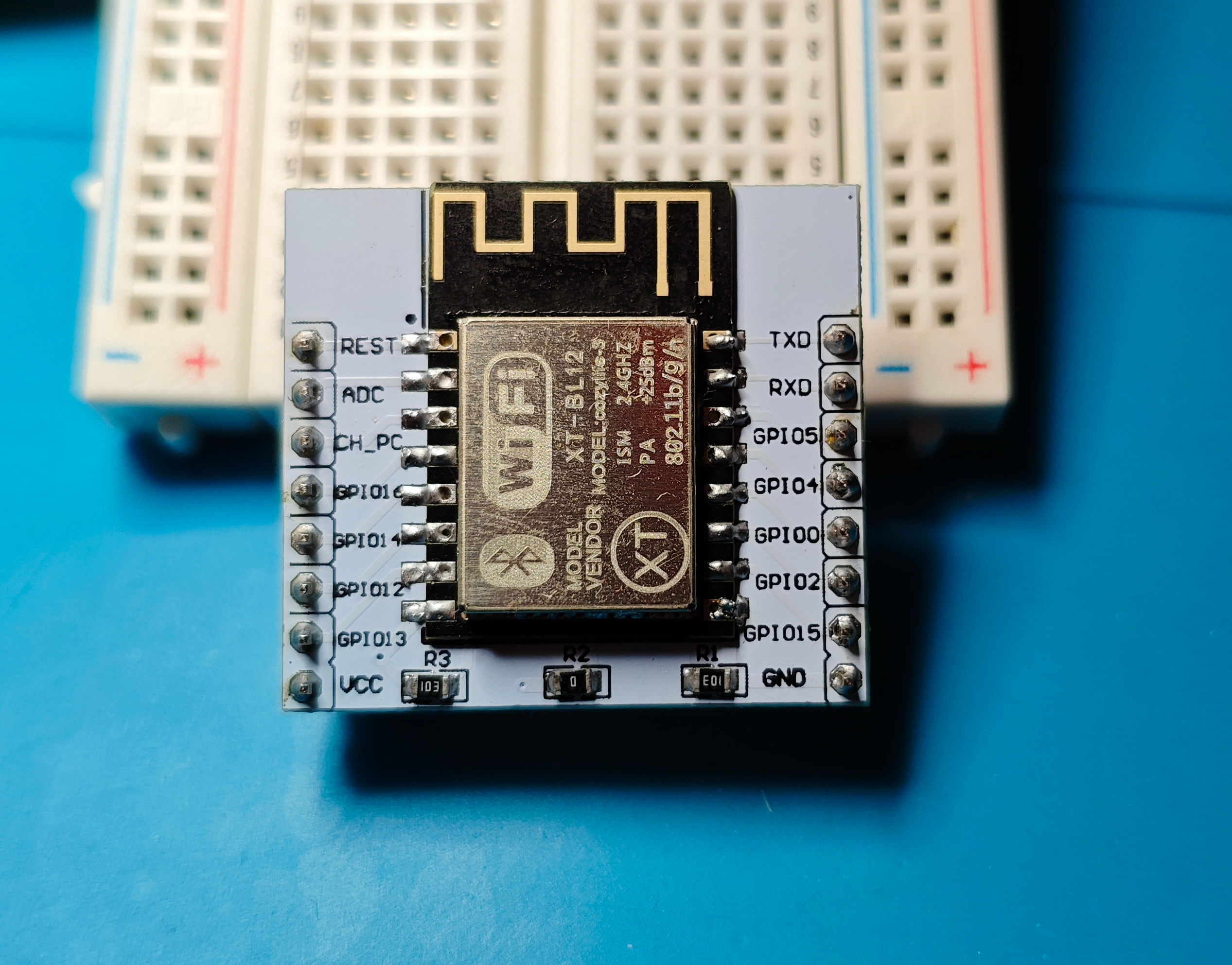

    module has a new home. ready for some unknown adventure
    Wi-Fi module mounted on a breadboard. Electronic module with various pins placed on a breadboard.

  • Boot log stops at valid PSM partition detection
    #17 21431351
    Posts: 5195
    Help: 446
    Rate: 913
    miegapele wrote:
    I do not see that toml for 1.4.8
    ah, maybe I used the 1.9.0 tomls on 1.4.8 - I've tried quite a few things.
    miegapele wrote:
    Do you get any boot log?
    yes. always to this point:
    https://www.elektroda.com/rtvforum/topic4081863.html#21267825

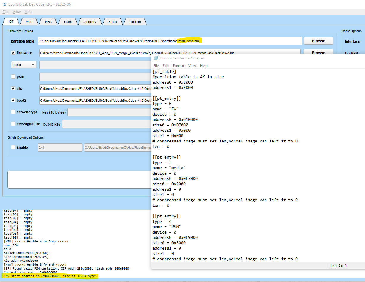

  • Suggested 32 kB partition table TOML
    #20 21432034
    miegapele
    Posts: 173
    Help: 15
    Rate: 29
    >>21431575
    Seems like 32k might be needed.
    Could you try this toml file, before we try code changes?

  • #21 21432090
    Posts: 5195
    Help: 446
    Rate: 913
    Bouffalo Lab Dev Cube software interface with a configuration file edited in Notepad.
    Added after 4 [minutes]:
    erased whole flash. changed to GA build and did again. loops
    Screenshot of debugging messages related to flash memory configuration.

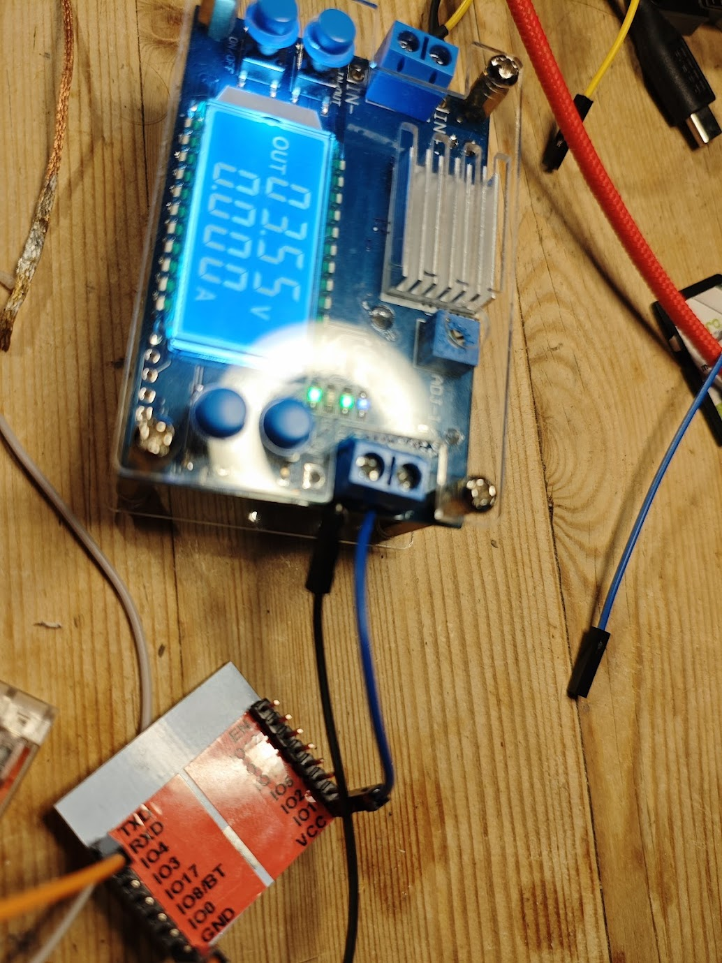

    So it's boot looping and not freezing? Then that feels like power problem... How are you powering this?
    The same might be with standard build, it tries to erase some flash and that also requires power.

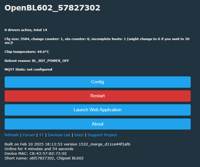

  • Shorting VCC further fixed BL602 boot loop
    #25 21434069

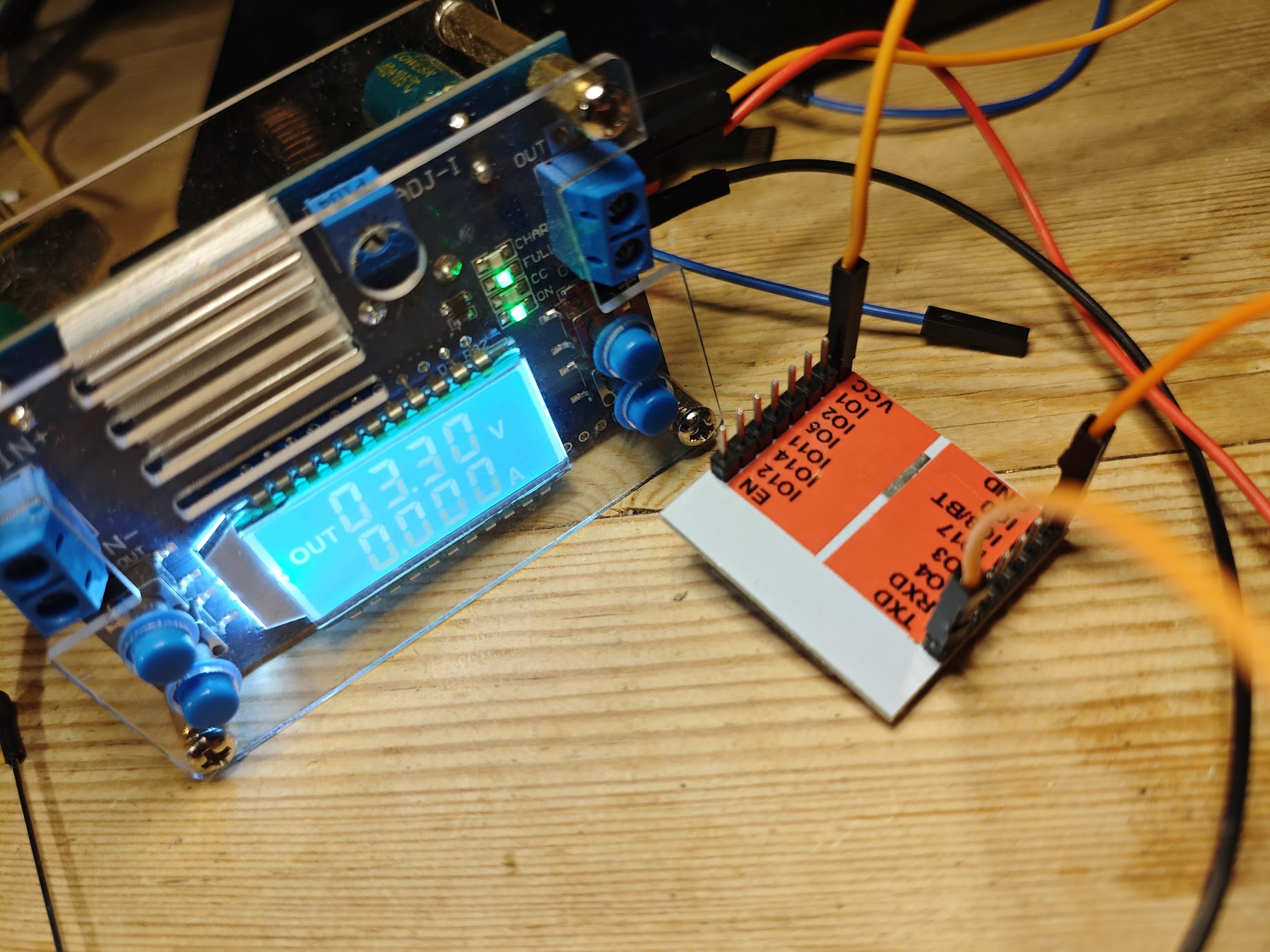

    Posts: 5195
    Help: 446
    Rate: 913
    oh wow. I thought it was power too but this PSU is usually fine with BL602 - even at 3.5v it was looping. Made VCC even shorter and now it's OK. 🙄
    Power supply module and prototyping board on a wooden table.
    :D
    Control panel for the OpenBL602_57827302 device with options for configuration, restart, and web application launch.
    full successful boot

    also, is this an opportunity to switch to new SDK for 1mb OBK releases?
    Added after 16 [minutes]:
    would you like me to flash with any other toml now?
    These BL602s are SO fussy. it started looping again and always at wifi AP join. Made VCC cable even shorter at 3.55v and now OK again.
    Electronic display and module with wires on a wooden surface.
  • #28 21434116
    miegapele
    Posts: 173
    Help: 15
    Rate: 29
    I see some capacitors on the main board. Might be not enough decoupling on bare board.
    I think you should try standard build, maybe with my toml, that 8kb PSM partition feels wrong in the other toml.
  • #29 21434122
    Posts: 5195
    Help: 446
    Rate: 913

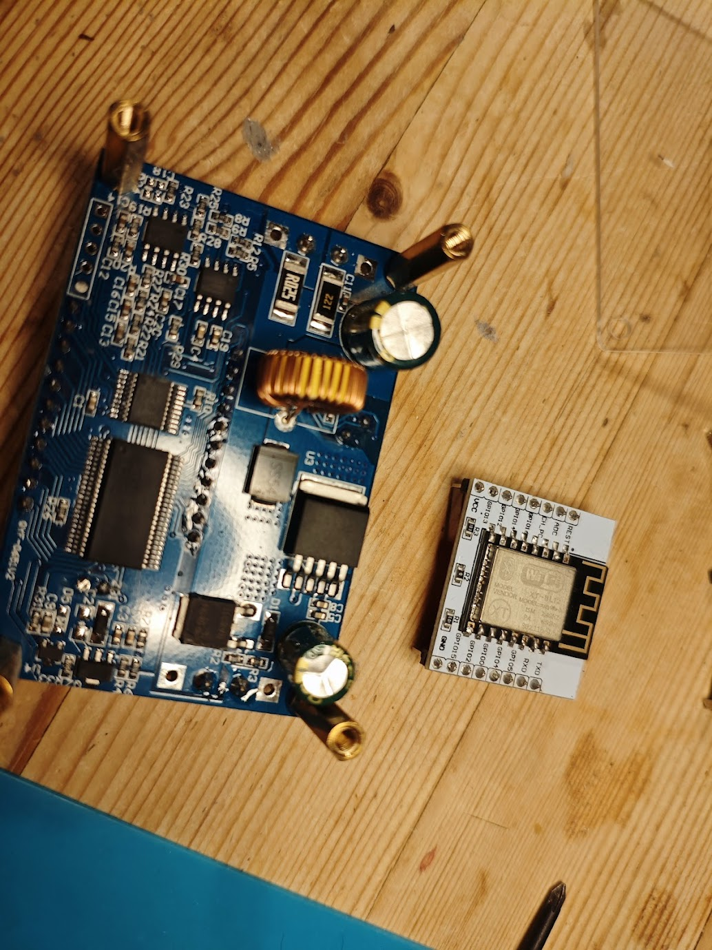

    maybe time to get a decent bench PSU.
    Added after 21 [minutes]:
    (forgive the side-bar on the power issue)
    bare board being the module breakout? XL4015 looks OK?
    Electronic module with components, including XL4015. Electronic components on a wooden table: PCB board and WiFi module.

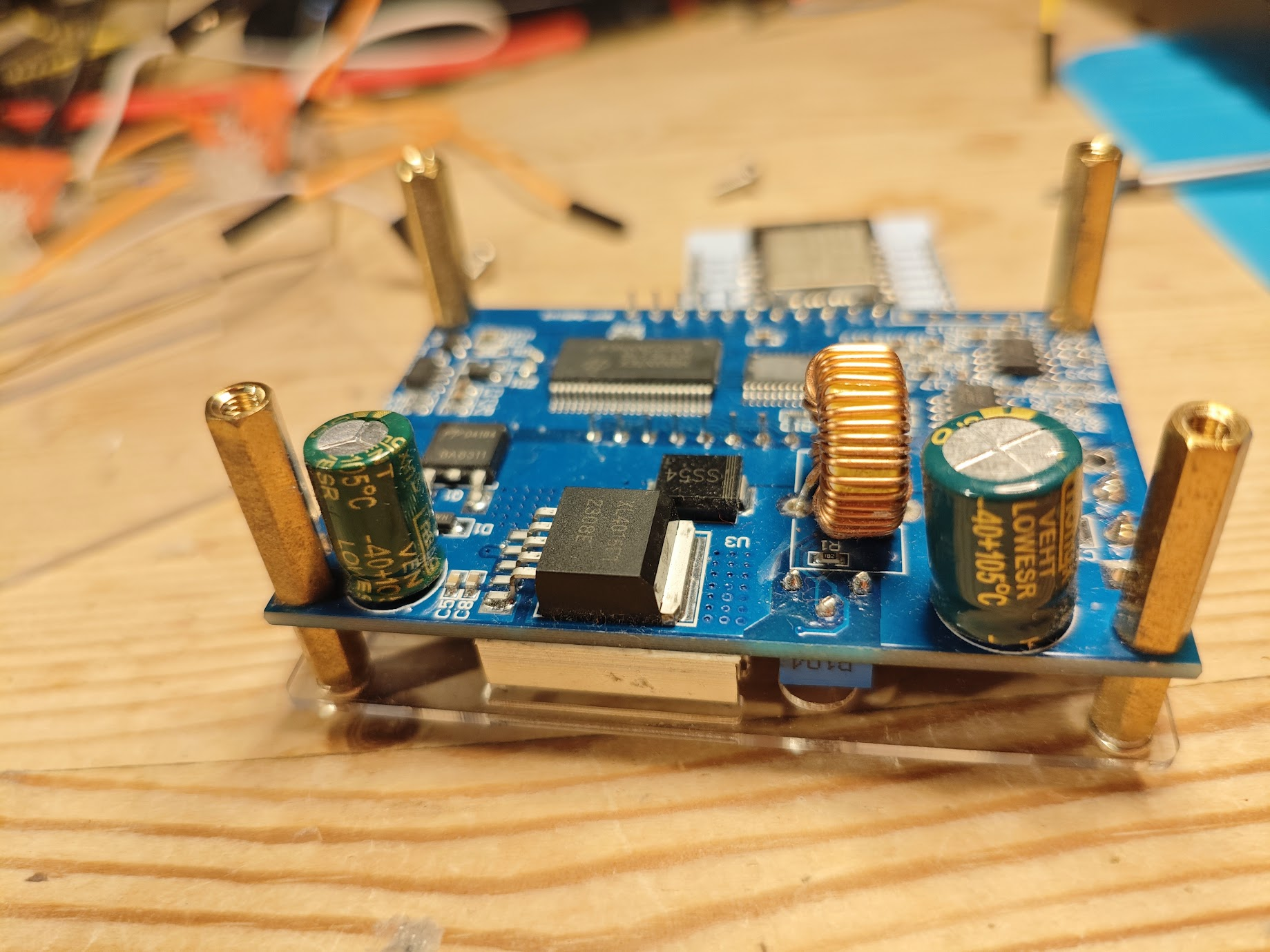

  • #30 21434160
    miegapele
    Posts: 173
    Help: 15
    Rate: 29
    I mean these two:
    Green circuit board with various electrical components.

  • The successful 1MB fix used CONFIG_BL602_USE_1M_FLASH := 1 with a build based on BL IoT SDK 1.6.39, built on February 13, 2025. [#21438533]
  • The commonly reused working 1MB partition gave FW 0xD7000 (~860KB), PSM 0x8000 (32KB), media 0x2000 (8KB), and factory 0x7000 (28KB). The thread rejected the standard 1MB PSM because 8KB was too small for OpenBL602 config writes. [#21432034]

Why did OpenBL602 originally freeze on 1MB BL602L10 at "ENV start address is 0x00000000" during EasyFlash init, and what change finally fixed it?
It froze because the BL602 SDK was reading 1MB flash parts with the wrong flash-access path during EasyFlash initialization. The visible symptom was boot stopping at ENV start address is 0x00000000, even when partition addresses looked correct. The fix was enabling CONFIG_BL602_USE_1M_FLASH := 1, then doing a clean rebuild so the new code path was actually compiled. After that, testers reported normal EasyFlash startup, sector formatting, and successful boot on 1MB parts. An expert summary from the thread was: "CONFIG_BL602_USE_1M_FLASH is what we where after." [#21438533]
What does CONFIG_BL602_USE_1M_FLASH do in the BL602 SDK, and why was it necessary for BL602L10 1MB flash support?
CONFIG_BL602_USE_1M_FLASH switches the SDK to 1MB-compatible flash read logic instead of the default ROM-driver path used on larger parts. The thread found a conditional in the SDK where 1MB builds call a different XIP_SFlash_Read...Ext path. That mattered because standard reads froze during PSM and EasyFlash access on BL602L10. Once enabled, the same firmware could boot on 1MB parts and still worked on at least one 2MB module, so the flag became the practical compatibility switch for BL602L10 support. [#21438486]
What is EasyFlash on BL602, and how does the PSM partition size affect whether OpenBL602 can save Wi-Fi settings and boot counts?
EasyFlash is the BL602 key-value storage layer that saves settings like Wi-Fi credentials, boot counters, and config data inside the PSM partition. "EasyFlash is a flash-resident configuration store that saves persistent key-value settings, using sector-based ENV records and garbage collection." When PSM was only 8KB, OpenBL602 could boot but failed to save larger config changes reliably. A 32KB PSM worked much better, and testers explicitly linked successful setting saves to the larger PSM layout. Small PSM layouts also produced Alloc an ENV failed errors during config writes. [#21440834]
Which 1MB partition TOML layout worked best for OpenBL602 on BL602L10, and why was the standard 1M TOML considered unsuitable?
The most successful 1MB layout used roughly FW 0xD7000, media 0x2000, PSM 0x8000, and factory 0x7000. That layout was repeatedly tested and gave working EasyFlash with saved settings. The standard 1MB TOML was considered unsuitable because it gave PSM only 8KB, which was too small for larger OpenBL602 config writes around 3.6KB. That caused garbage-collection churn, failed ENV allocation, and settings not surviving reboot. Later discussion proposed cleaner variants, but the custom 32KB PSM TOML was the de facto working baseline. [#21432034]
