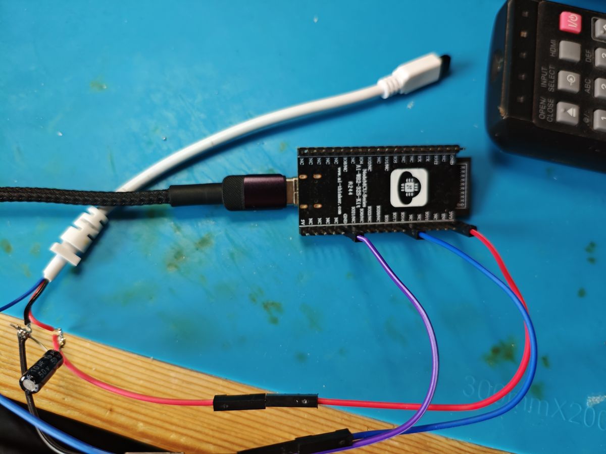

    interesting. P14 nPup - nothing for me even with remote in the receiver's face.
    Will try other BL module and/or find MagicHome with ir pads unpopulated. My receiver's a bit DIY but it's worked on other platforms so far.
    ESP32 development board with connected wires, capacitors, and USB-C cable on a blue service mat.
    Shortened data cable makes no diff. remote is fine. also testing with AC signals remotes on mobile phone ir

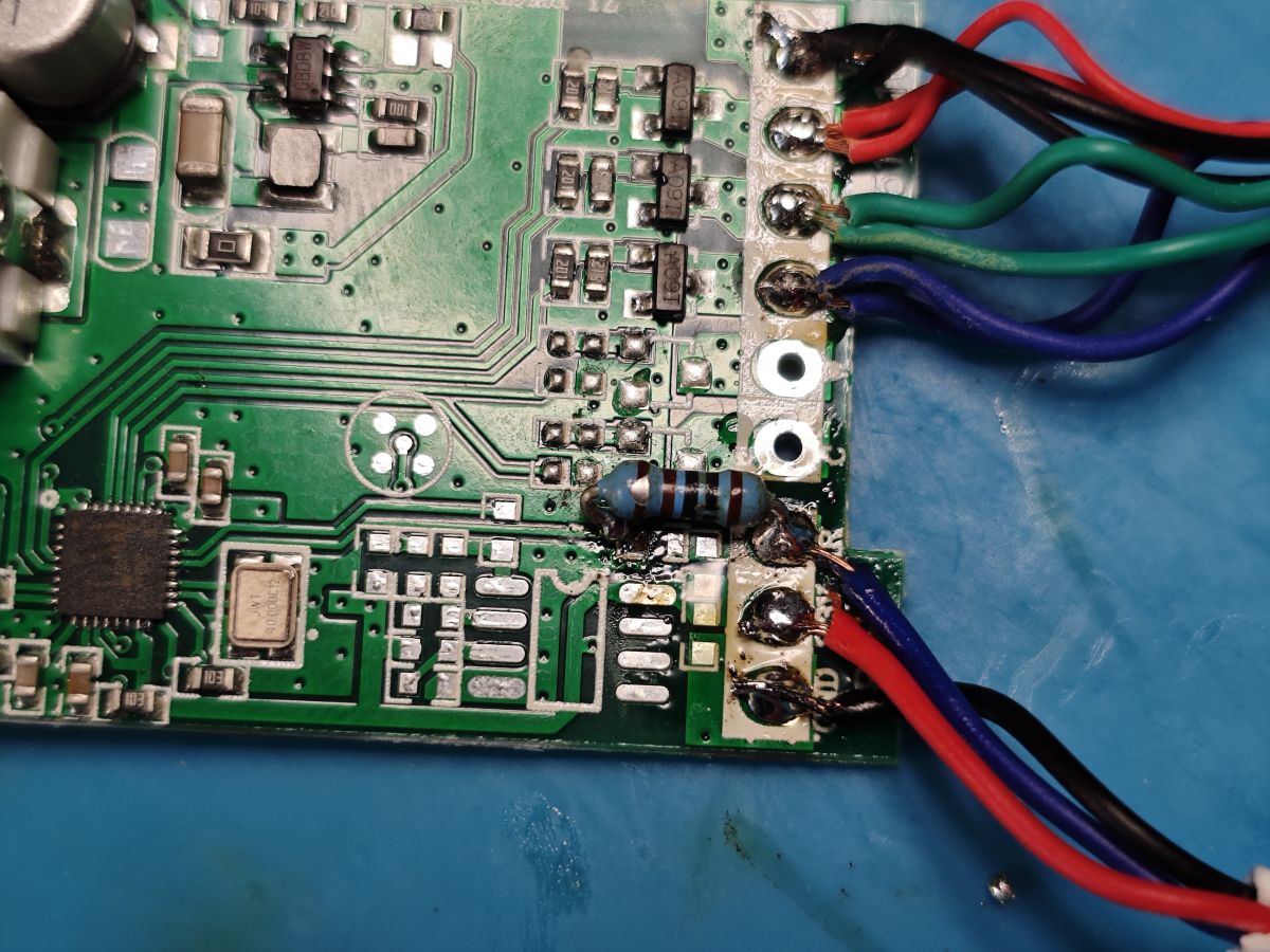

    Added after 42 [minutes]:

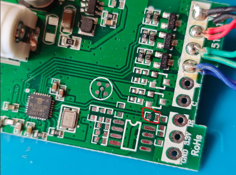

    This MagicHome is my best option for adding IR. It's only missing the resistor from IO to IR.
    Close-up of a PCB showing an empty resistor pad near the IR output.
    I measured 100ohm on a resistor to IR on another factory-fitted IR device previously, so that's what my DIY rig has on data line (as well as a bonus capacitor across VCC/GND). Is 100ohm agreeable? A safe bet to fill gap on this device?

    >>21648521
    My cheap QC ir receiver has 1k ohm
  • #279 21648582
    Posts: 5062
    Help: 438
    Rate: 893
    well well. every day is a school day.
    1k is indeed better. thanks.
    this is physical remote then 2 random AC remotes from MiRemote app
    This is with DIY/1k now - P14 nPup

    insmod wrote:
    And did you try it on your device?
    on the MagicHome? no. I went out. will add 1k plus receiver now though
    Added after 1 [hours] 7 [minutes]:
    hadn't ever converted it to OBK. Still factory.
    Close-up of a PCB with soldered colored wires and a striped resistor.
    IO12 nPup

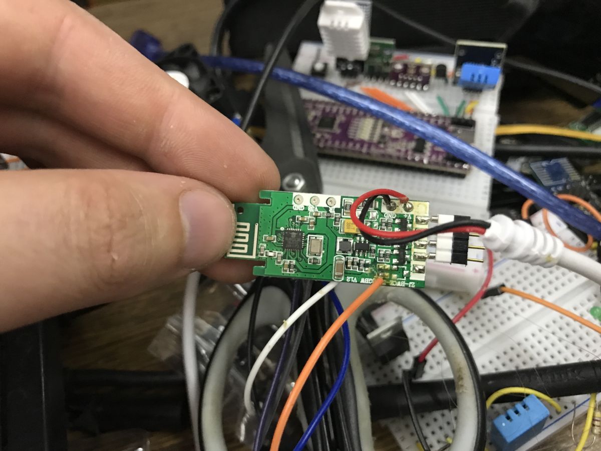

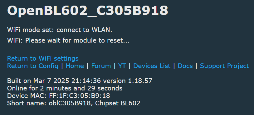

    WiFi BL602 module held between fingers, connected to a breadboard with wires.
    Reflashed my BL602:
    SharpBL602Tool.exe -b 200000 -p COM4 -wf full_binary_with_app_OpenBL602_1.18.57.bin
    pause

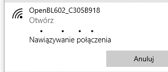

    Screenshot showing Wi-Fi connection in progress to network OpenBL602_C305B918 with Connecting message.
    Screenshot of the OpenBL602 device web panel in WiFi connection mode.

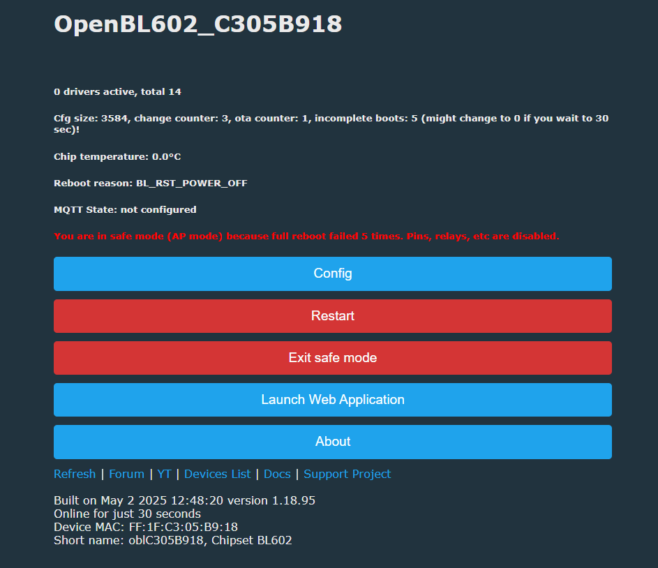

    huh I updated to OpenBL602_1777_merge_fa6089ebb6f3_OTA.bin.xz.ota
    and it no longer connects to WiFi
    [WF][SM] Exiting disconnect state
    Delete Timer.
    [WF][SM] State Action ###disconncct### --->>> ###connecting###

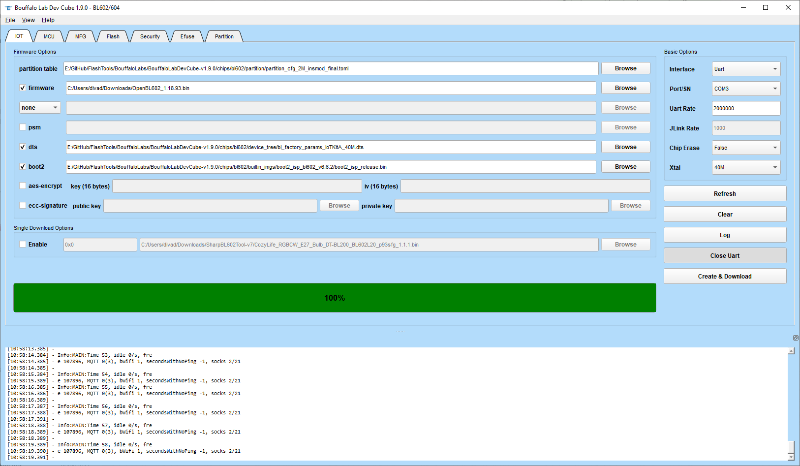

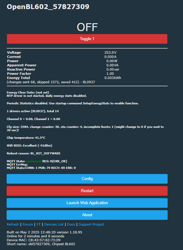

    Added after 8 [minutes]:
    So, works:
    - Build: Built on Mar 7 2025 21:14:36 version 1.18.57
    - OpenBL602_1.18.83_OTA.bin.xz.ota len:424504
    - OpenBL602_1.18.84_OTA.bin.xz.ota len:424600
    - Built on Apr 22 2025 22:31:23 version 1.18.93
    No WiFi:
    - OpenBL602_1.18.95_OTA.bin.xz.ota len:440256
    - OpenBL602_1.18.134_OTA.bin.xz.ota len:441020
    - https://github.com/openshwprojects/OpenBK7231T_App/pull/1777
    Screenshot of the OTA tool interface for the BL602 chipset, showing upload of the OpenBL602_1.18.134_OTA.bin.xz.ota file and Wi-Fi connection failure logs.

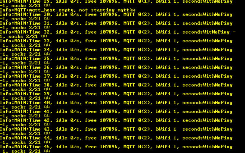

    Error log on OpenBL602_1.18.95_OTA.bin.xz.ota len:440256 (different)?
    Info:MAIN:Time 26, idle 0/s, free 113904, MQTT 0(0), bWifi 0, secondsWithNoPing
    -1, socks 2/21

  • #283 21649079
    Posts: 5062
    Help: 438
    Rate: 893
    Not sure what's going on with your board but 1.18.95 was the start of the new SDK. I've not had issues with WiFi with BL602.
    Added after 15 [minutes]:
    To add that I thought I'd done a series of old to new SDK tests at some point and the transition seemed to be a success. I could replicate your journey tomorrow if needed.
  • #284 21649103
    Posts: 14615
    Help: 655
    Rate: 12632
    That's a very serious issue. AP safe mode still works, but WiFi client is dead.
    OpenBL602 device interface screen in safe mode with WiFi client disabled.

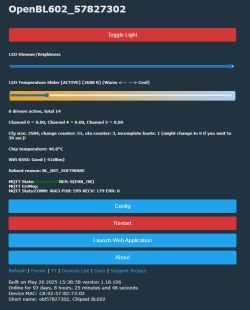

    I'm not home but I have these two online right now. want me to do anything to them remotely?
    Screenshot of OpenBL602 device interface showing OFF status and detailed technical data. Web interface of the OpenBL602_57827302 device showing LED controls, temperature, and system status.

    Well, are you able to run both those versions of them without problems?
    - 1.18.93
    - 1.18.95

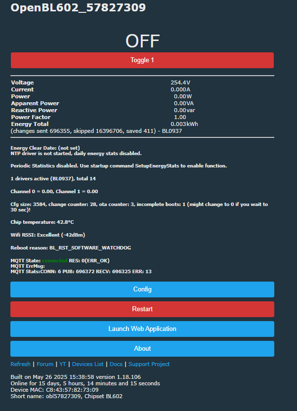

    powersave 0 set first - the plug has OTAd and connected again OK
    OpenBL602 control panel showing device status, network, energy, and system parameters
    the bulb starts OTA and goes offline for a few minutes - comes back at same version as before and no reboot. not sure what state that device is in regarding partitions or anything. Anyway, the plug came up OK.

    4mb Ai-WB2
    erase flash -> UART 1.18.93 then OTA -> 1.18.95 -> 1.18.134 -> 1.18.158 -> 1.18.159 -> 1.18.163 ✅
    latest toml. nothing configured. RSSI is 'excellent' at every version. AP 4m away.
    Screenshot of Bouffalo Lab Dev Cube 1.9.0 showing firmware flashing settings for BL602 chip.

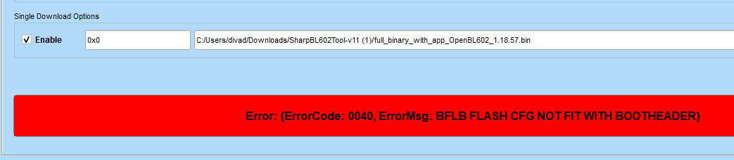

    Are you able to restore it to order without a firmware backup? Just with BLDevCube?
    not entirely sure what you mean.
    I also tried flashing full bin with BLDC but
    Screenshot of SharpBL602Tool showing a flashing error for the OpenBL602 binary file.
    Added after 56 [seconds]:
    but if OpenBL602 releases end up being the whole image they'll presumably already come with bootloader setup from new SDK - ie NOT 1.18.57?

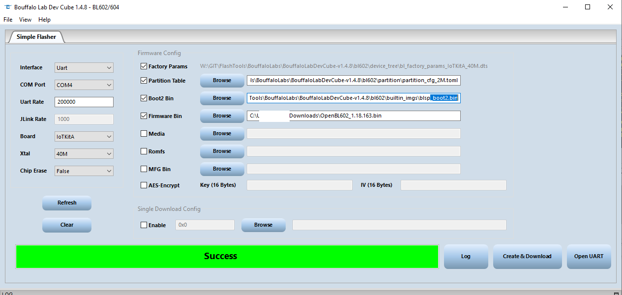

    Reflashed this way and problem persists:
    Screenshot of the Bouffalo Lab Dev Cube tool showing successful firmware flashing to a BL602 chip.
    I guess we need to update tutorials to use new flashing method.
    Added after 5 [minutes]:

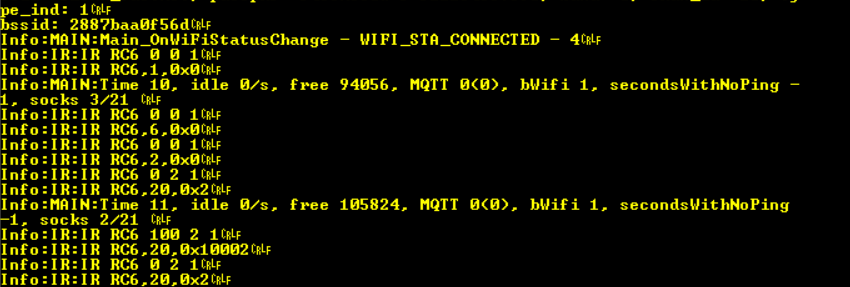

    Update: I did full erase and it works now. So.... what survived in BL602 memory first flash and was breaking WiFI?
    Added after 20 [seconds]:
    Screenshot of a console showing BL602 system debug logs related to MQTT and WiFi connection status.
    My RC6 remote works with IRRecv pin:
    Console screenshot showing system logs from the BL602 module with WiFi and IR signal data.

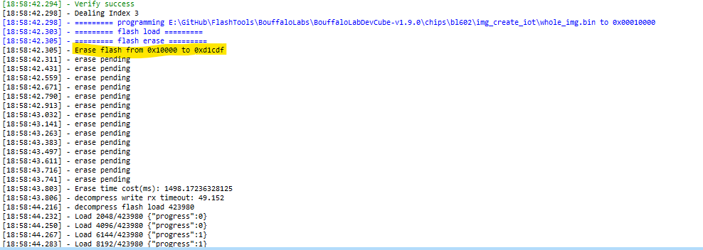

    unsure but when you do that kind of flash it'll erase only specific sections in the process. eg
    Screenshot of BL602 programming log showing flash erase and data load operations.
