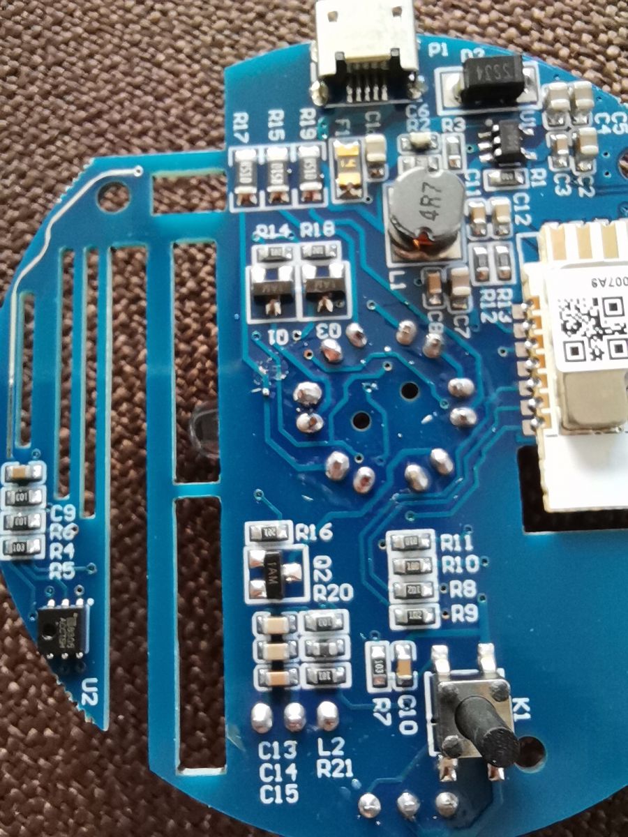

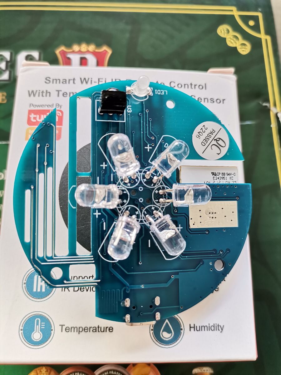

  • Pinout and CHT8305 sensor details for BKN7231N CBU
    #1 20485704
    ststefanov
    Posts: 15
    Bought from here:
    https://www.aliexpress.com/item/1005004762491352.html
    Aliexpress page cache:
    [BKN7231N CBU] Universal remote control with temperature and humidity sensor
    Almost same as https://www.elektroda.com/rtvforum/topic3933390.html, but with added temperature and humidity sensor

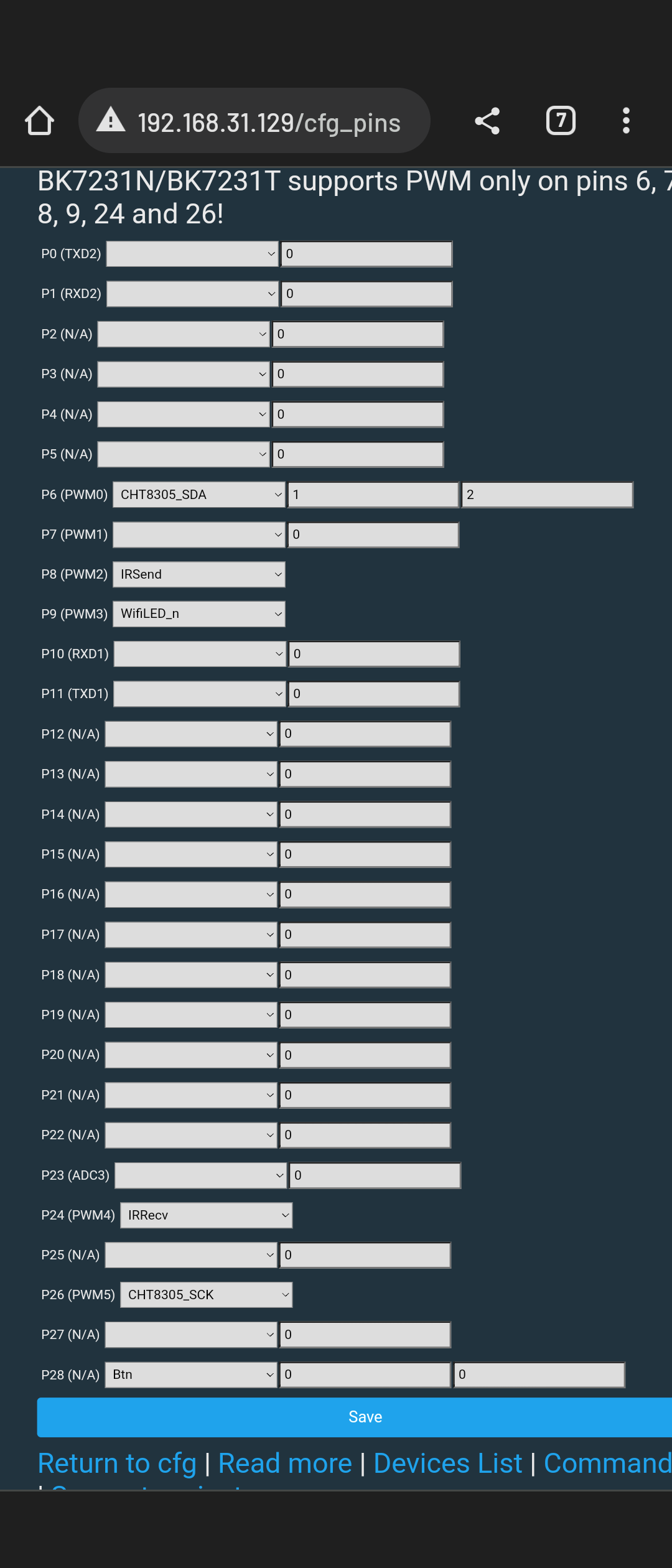

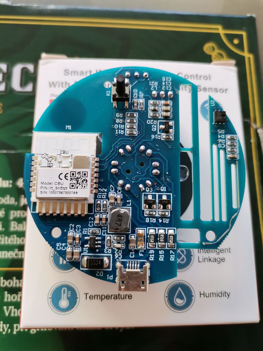

    Used GPIO pins are:
    P15 - Power IR receiver
    P17 - Red LED
    P9 - Green LED
    P28 - Reset button
    P24 - IR receiver input
    P26 - Sensor SCL
    P6 - Sensor SDA
    P7 - Sensor Alert
    P8 - IR send
    Temperature and humidity sensor is CHT8305. Datasheet is here:
    http://www.lanftek.com/Data/lanftek/upload/file/20180618/201802281014097175.pdf

    Hello, maybe it's SHT30? With I2C and an alert line? What do you think, @dheenhasty ?
    Maybe you could try assigning SHT roles to the pins, with 3 pins and 2 roles, there are not many combinations to try...
  • #3 20486043
    ststefanov
    Posts: 15
    I found it. It's CHT8305.
    Unfortunately, I'm new with OpenBK7231N and still I don't know how to configure it for this device.
    Does OpenBK7231N support CHT8305?

  • #5 20488084
    ststefanov
    Posts: 15
    GUI flasher doesn't work with my Debian Linux with several USB to TTL converters.
    Flashed successfully with uartprogram.
    I set pins for IR Send and Receive, also for CHT8305, but no data is appeared in the logs. Seems the driver is not yet finished.
    I'll check again pin numbers and functions.
    How to check CHT8305 and IR send/receive with HomeAssistant?

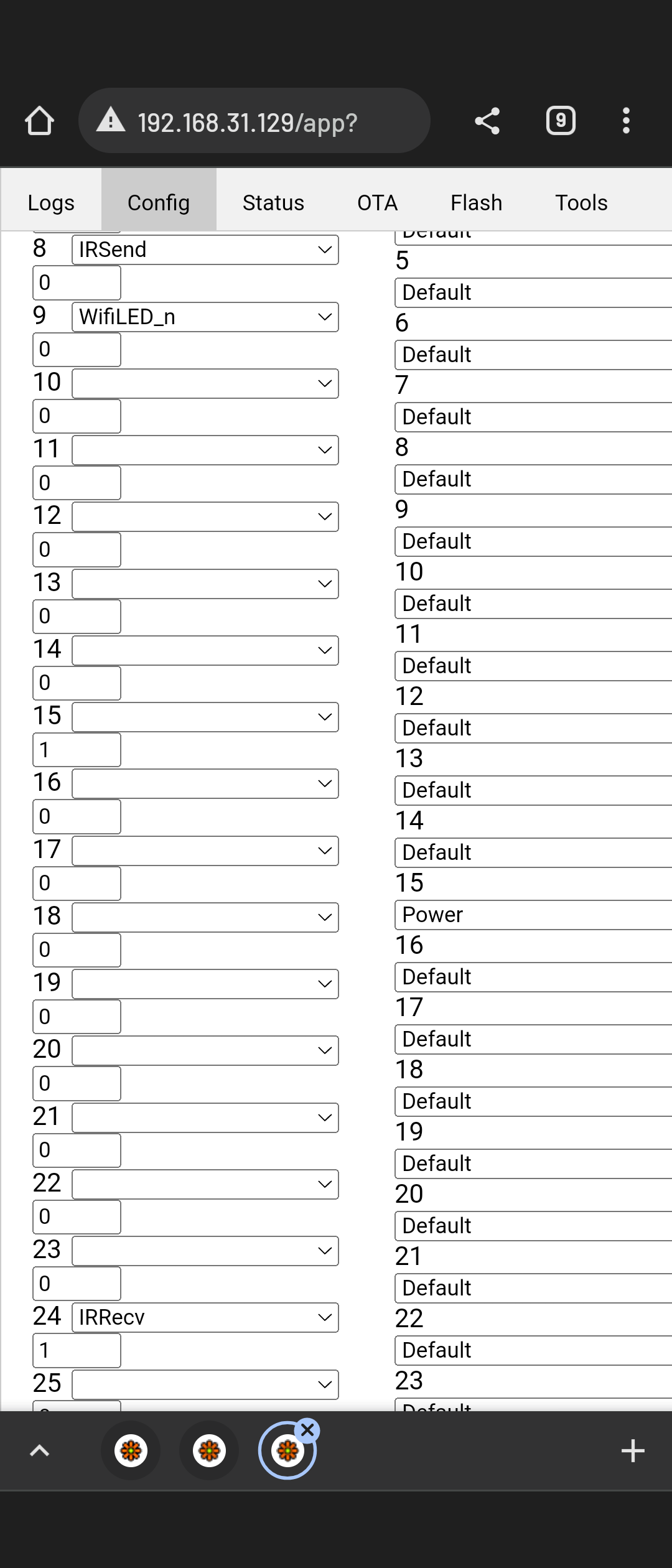

  • Requesting OpenBeken pin settings for IR blaster sensor
    #6 20490171
    strone8
    Posts: 6
    I want to sincerely thank you @p.kaczmarek2 for your work on OpenBeken!
    I'm new to this forum and am also trying to use it on this same device. I have read your suggestions @p.kaczmarek2 but I too am unable to get this ir blaster /temp/humidity sensor to function.
    @ststefanov Could you share some screenshots of your settings? I'm confused about what I should put for P15 and P24 for instance since they both deal with the IR Receiver function. Also I don't know how to input P7.
    Thank you both for your help. I sincerely appreciate it.
    Added after 5 [minutes]:
    This is my current configuration (which doesn't work) [BKN7231N CBU] Universal remote control with temperature and humidity sensor
  • Check GPIO mapping for CHT8305 and IR receiver
    #7 20491150
    Posts: 14756
    Rate: 12883
    Setting CLK and DAT pins for CHT8305 should be enough, but of course you also have to restart.. Then you can also make sure to set two different channels for DAT pin, first will store humidity, second temperature.
    If CHT8305 is not responding, then you might have chosen incorrect GPIO.
    Check with multimeter which GPIOs are connected to CHT8305. Consult documentation of WiFi module/chip if needed.
    CHT8305 driver was tested and reported to be working by our users in the past.
    To check IRRecv, set correct pin for IRRecv, restart device, and open Web Application->Log and look at logs while pressing remote button.
    @strone8 , you need to check with multimeter or by following traces, where the IRReceiver/sender are connected. What do you mean with "both pins deal with receiver function"? The IRRecv is just a single pin. What is the role of P7 in case of your device?

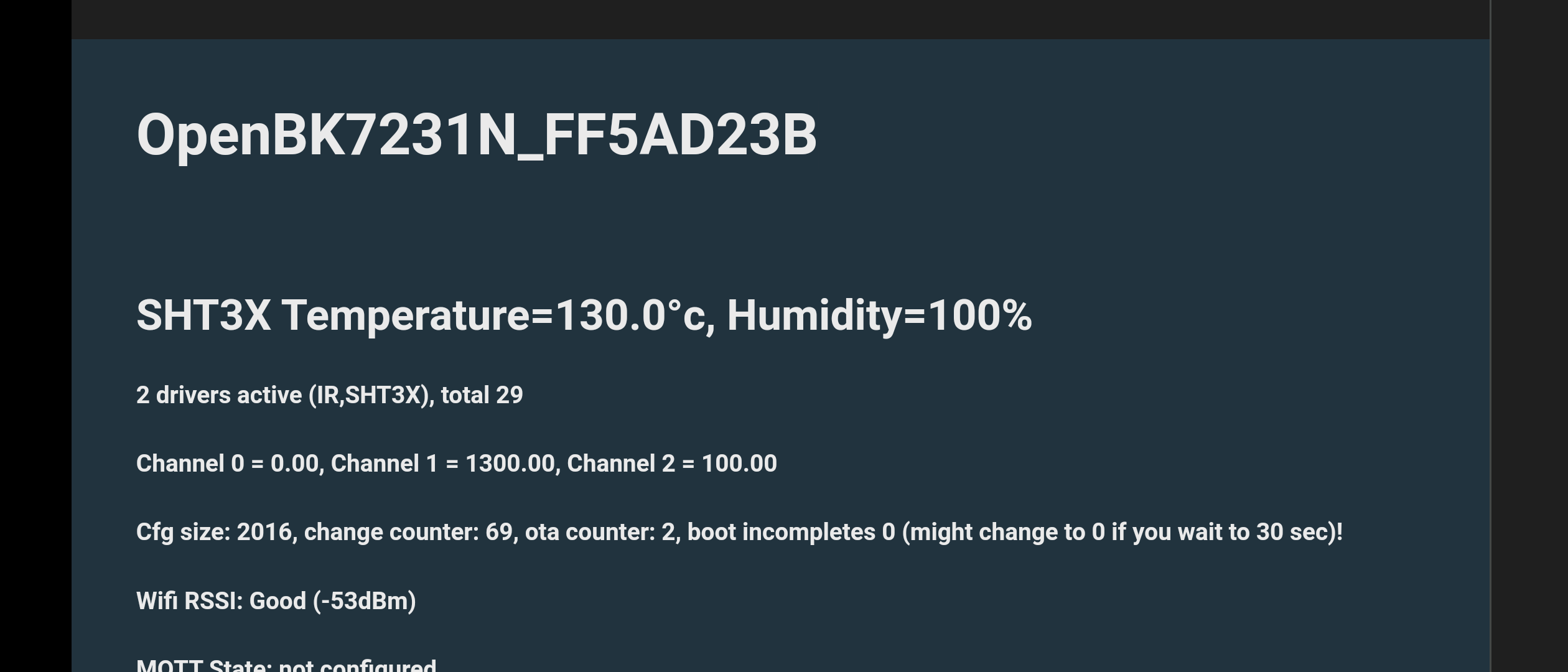

    #9 20491339
    strone8
    Posts: 6
    Thank you @p.kaczmarek2 so much. I did follow your steps in tracing and I am sure that I was initially wrong and P24 is actually the IRRecv pin from multimeter tracing.
    For some reason I am not seeing any changes in the logs with IR remote presses despite having all logging features and levels fully enabled. I have some familiarity with this procedure on a separate device previously in Tasmota using an ESP8266.
    @ststefanov had listed "P15 - Power IR receiver" and "P24 - IR receiver input" and I am still unsure how to address "P15 - Power IR receiver" in the settings or if that's even necessary.
    Following @ststefanov I tried both the CHT SDA (P6) and CHT SCK (P26) as well as Soft SDA (P6) and SoftSDL (P26) and even with channel 1 and channel 2 selected for P6, I am getting "0.00" information for each.
    Any advice you can give would be greatly appreciated.
    Added after 12 [minutes]:
    An update: @dheenhasty thank you! I changed from CHT [BKN7231N CBU] Universal remote control with temperature and humidity sensor to SHT and I am now getting activity. The readings are totally off: I am 21C with 27% humidity but at least I have somewhere to start looking for calibration.
  • #10 20491434
    dheenhasty
    Posts: 111
    Rate: 17
    The value you got is the défaut value of the driver, i think you have a bad pin définition and this does not tell you you have a sht
    There close, but the i2c command is not the same.

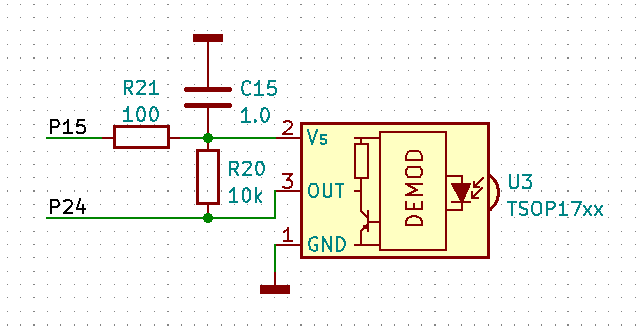

    #11 20499480
    ststefanov
    Posts: 15
    P15 is used as output to power IR receiver. Probably this is done to save power when the receiver is not needed.
    To receive IR signals we must first set P15 to 1, this will power up the receiver and all will work. Here is the part of the schematics:
    @strone8, I still don't have working configuration. Changing to SHT gives unreal results because of wrong sensor type. Calibration will not work here.
    I think there is a problem with CHT8305 support, because when I set SDA and SCL for example for SHT I see 2 drivers active. When I set them for CHT I see only one driver active.
    Edit (after some trials): Seems that driver for CHT8305 is not started (may be bug?). I enabled RAW TCP connection and using telnet start the driver manually:
    startDriver CHT8305
    Info:SENSOR:DRV_CHT8304_init: ID: 59 59
    Info:MAIN:Started CHT8305.
    Now everything is working fine!
    Unfortunately, after restart the driver was not started. I don't know if this is bug or feature. To start automatically the driver in startup command line I added:
    startDriver CHT8305
    Now after system restart the driver is started and works OK.

  • IR receiver only powered during learning mode
    #17 20500369
    ststefanov
    Posts: 15
    It was made intentionally this way. The IR receiver is used only in the learning process, which takes a very small amount of time compared to working time. All other time it is switched off to not consume power.
    If you like, you can assign LED or RELAY to P15 and switch it ON manually before learning. After learning is finished you can switch it off manually.

  • GPIO-powered IR receiver reduces heat and enables shutdown
    #20 20500390
    ststefanov
    Posts: 15
    In the TSPO1738 datasheet typical current is 5mA, which means 16.5mW wasted (on more time) power. Another idea why they made this way is that along power saving most important is to switch off receiver when send IR commands. Due to high power of transmitter receiver always repeats sent IR signal and may be this created problems in the system. Powering from GPIO allows to enable and disable the IR receiver easily.
    Added later:

13. How do I keep IR noise from corrupting sensor readings?
Disable P15 while transmitting IR. This stops the receiver from echoing high-power bursts and prevents MCU overload [Elektroda, ststefanov, post #20500390]

No. Using SHT roles on a CHT8305 only returns default constants, not real data. Correct the pin roles instead [Elektroda, dheenhasty, post #20491434]
15. Where is the documentation for pin roles?
OpenBeken lists every role, including AlwaysHigh, SoftSDA, and IRRecv, in ioRoles.md on GitHub [OpenBeken Docs].
