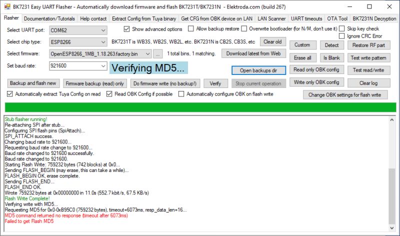

    cool. fails MD5 for me, but boots OK
    Screenshot of BK7231 Easy UART Flasher showing “Verifying MD5…” and an MD5 verification timeout in the log
  • #93 21846795
    Posts: 14615
    Help: 655
    Rate: 12632
    MD5 also fails for me, not yet clear why, but i will look into it

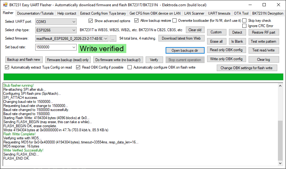

    Added after 9 [minutes]:
    Screenshot of BK7231 Easy UART Flasher showing “Write verified” and a flashing operation log.
  • #94 21846838
    Posts: 5062
    Help: 438
    Rate: 893
    cool. I wonder how the flash size detection for 2mb+ could work when it happens after the firmware has been downloaded. download both in one go then EF chooses what to flash based on detected flash size?
  • #95 21846850
    Tilator
    Posts: 133
    Rate: 13
    Is it possible, it uploads 2MB but download whole 4MB for comparison?
