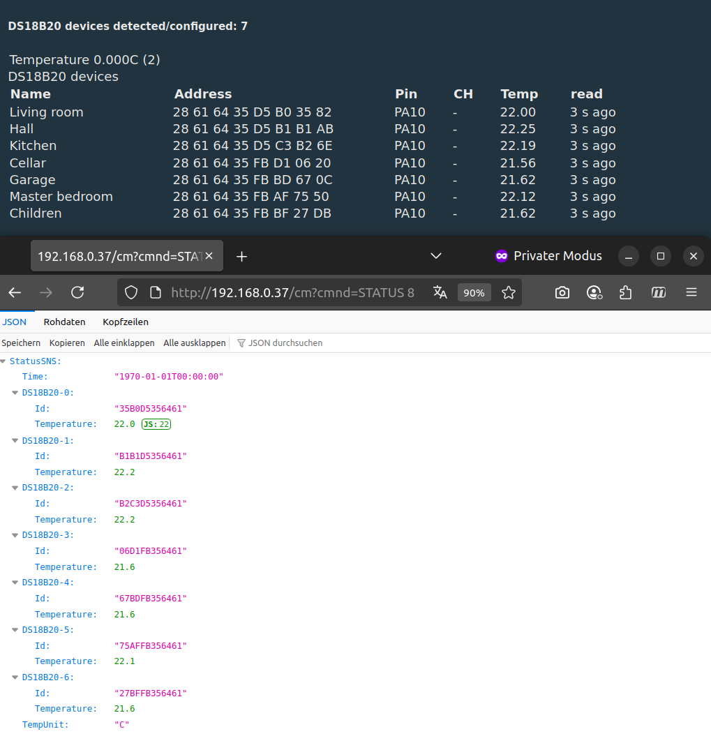

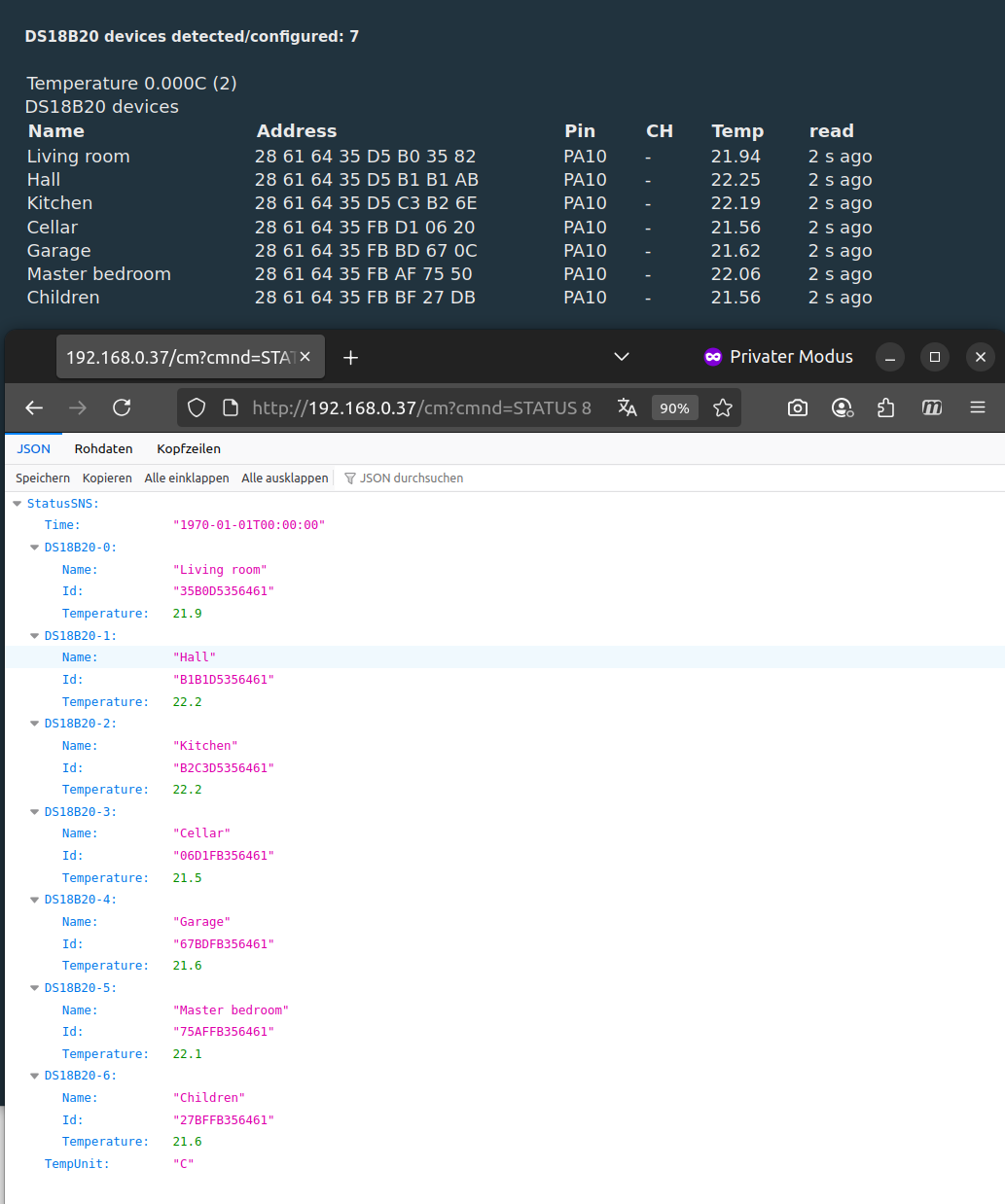

    @Tilator do you know incidentally how multiple sensors on one device are handled? So we can follow this for the other driver, too?
    If not, I can try to check the code ...
    Added after 16 [minutes]:
    No need to check - found it:
    https://tasmota.github.io/docs/DS18x20/#multiple-sensors
    {"Time":"2021-01-02T09:09:44","DS18B20-1":{"Id":"00000566CC39","Temperature":13.3},"DS18B20-2":{"Id":"0000059352D4","Temperature":1.2},"DS18B20-3":{"Id":"000005937C90","Temperature":22.5},"TempUnit":"C"}
    Sadly it doesn't use the human readable name but the ID...
    Added after 2 [hours] 12 [minutes]:
    Opened PR#1811 for the multiple DS1820 sensors.
    There is one "plain" Tasmota version, adding "-<id>" to the sensor and an Id to identify the sensor (middle 48 bits from ROM address in reverse order).
    Flashing OpenBeken/OBK firmware to ESP8266/ESP8285 devices
    Included is a (commented out) version which additionally adds a "Name": field in JSON:
    (both images are with "wrong" index number, which is now corrected - Tasmota will start index with "-1" not with "-0")

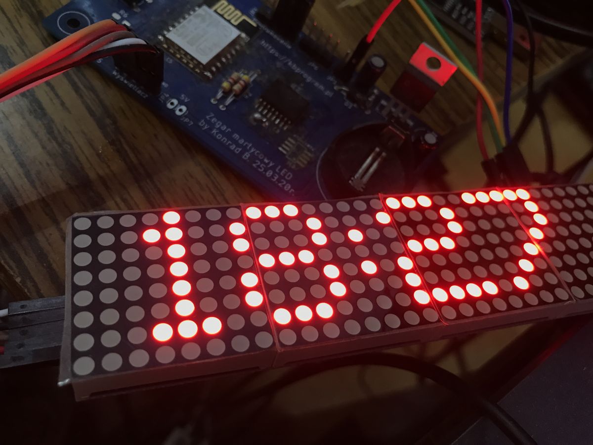

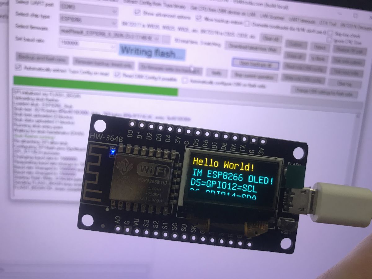

    My MAX72xx clock works on ESP8266, nice:
    startDriver MAX72XX
    // [clk][cs][din]
    MAX72XX_Setup 10 8 9
    startDriver NTP
    startDriver MAX72XX_Clock
    ntp_timeZoneOfs 2
    LED display showing time 18:27 connected to an electronic control board
    I had to manually use OBK pin indexes. Probably I need to add a translation function.

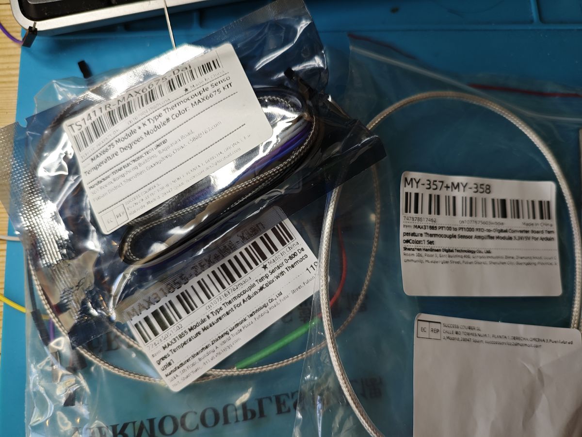

    interesting. I have a MAX6675, MAX31855 and MAX31865.
    Thermocouple modules and temperature sensor wires with MAX6675, MAX31855, MAX31865 in packaging

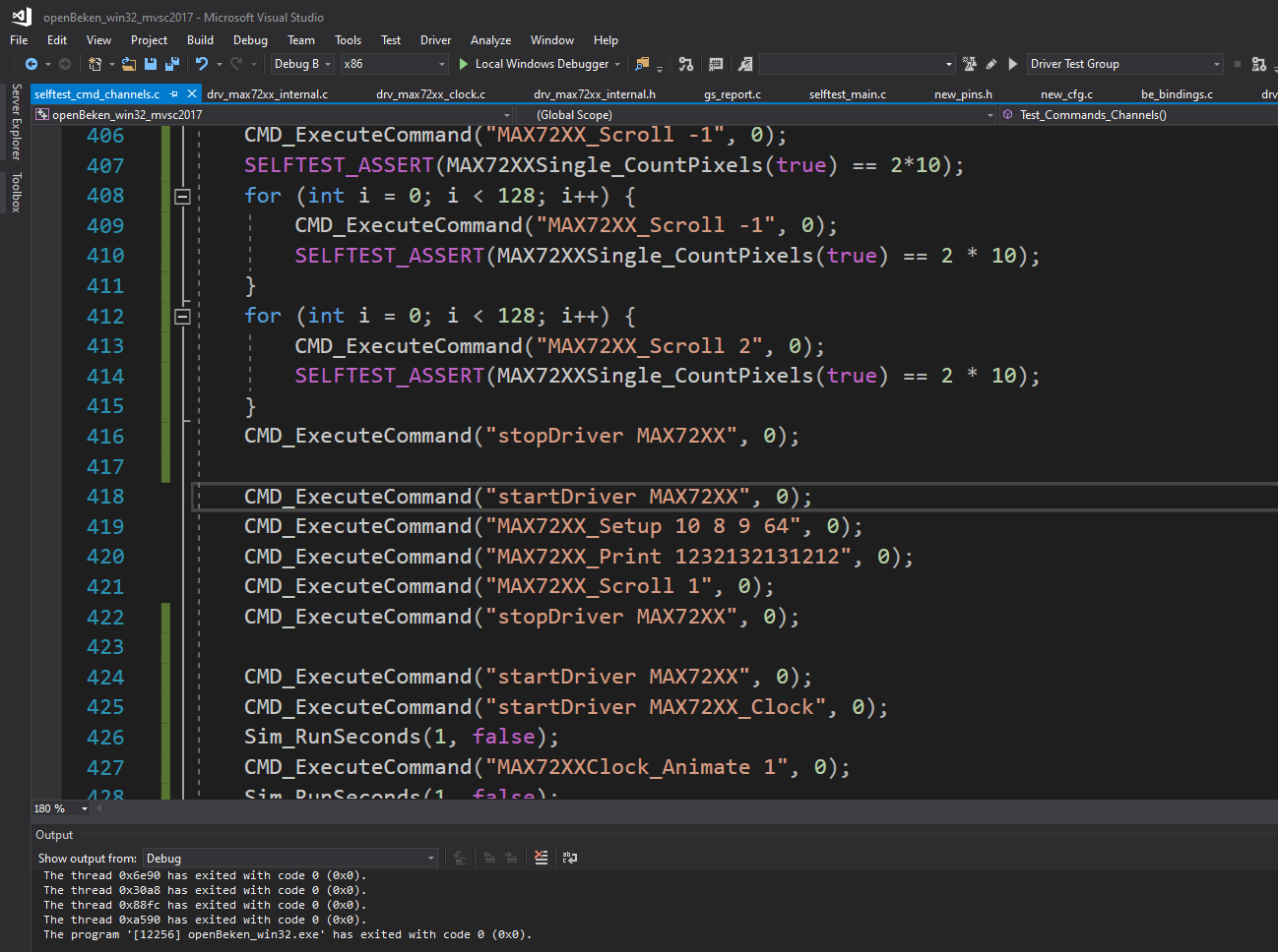

    You've confused the sensor I use for hot air testing with the display driver.
    https://www.elektroda.com/rtvforum/topic4055231.html
    For now, I am focusing on a display driver for a clock. If you want to test, you need to buy the LED matrix from this topic:
    https://www.elektroda.com/news/news4073144.html
    For now, I'm finishing text scrolling, along with self tests:
    Visual Studio editor showing C code for testing the MAX72XX driver

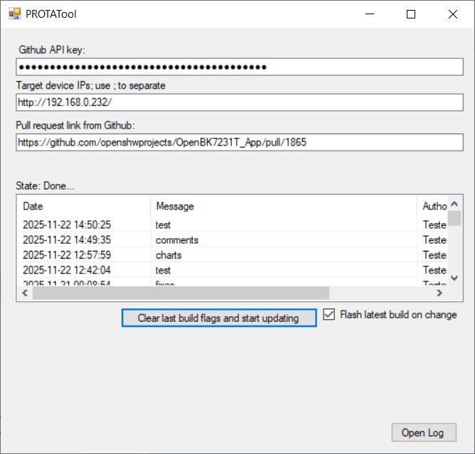

    It looks I had too many drivers compiled into build. I removed few and OTA works for me. Or at least, in most cases. I alsohave to disable running drivers before OTA, I need to look in the code to make sure it will be done automatically.
    PROTATool window with update log and input for device IP address.

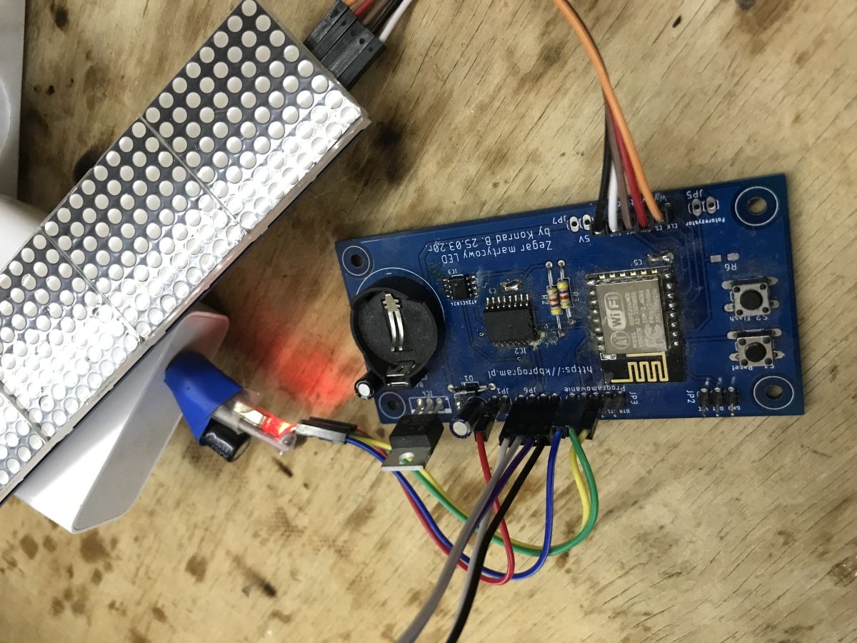

    My ESP8266 board:
    ESP8266 board with LED matrix display and multicolored connection wires

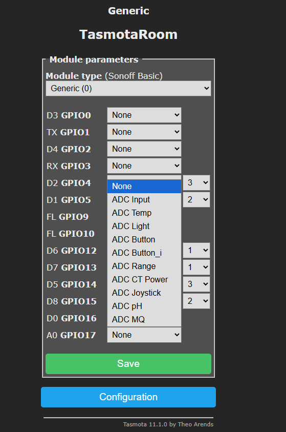

    I've added ADC on ESP8266 and it seems to work, but I need to solder potentiometer to be sure. I will bump pins counter and add it as 13th pin, named ADC and do all the checks.
    Maybe later I will also try to support pin string names in functions where pin indexes are expected, for example, in AHT20 driver init.

    For ADC pin use GPIO_NUM_NC
    Replace only for ESP8266
    int g_numPins = sizeof(g_pins) / sizeof(g_pins[0]);
    with
    int g_numPins = sizeof(g_pins) / sizeof(g_pins[0]) - 1;
    And HAL_PIN_GetPinNameAlias from xradio hal. Again, only for ESP8266
  • #74 21759094
    Posts: 14615
    Help: 655
    Rate: 12632
    Yup, I figured GPIO_NUM_NC out, I didn't see your message. But why:
    Code: C / C++
    I think setting GPIO_NUM_NC already prevents the crash-calls, as the ADC pin is ADC-only on ESP8266.
    Changing that count would also cause problems here:
    Code: C / C++
    So I am not sure about that.
    Later I will also need to change int http_fn_cfg_pins to show only ADC option there.

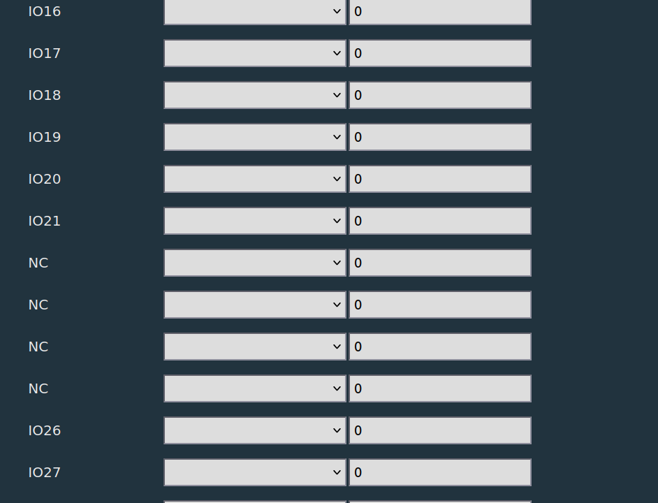

    insmod wrote:
    >>21759023
    Maybe a bit late now, but would using "GPIO_NUM_NC" for the IOs mapped to memory would be an option with ESP8266?
    This way, the index would be equal to IO pin, if I got it right?!?
    Sure, this would break all actual configs, but we might add a "onetime-wrapper" or something.
    But would this break something else?
    #elif PLATFORM_ESP8266
    espPinMapping_t g_pins[] = {
       { "IO0", GPIO_NUM_0, false }, // 0
       { "IO1", GPIO_NUM_1, false }, // 1
       { "IO2", GPIO_NUM_2, false }, // 2
       { "IO3", GPIO_NUM_3, false }, // 3
       { "IO4", GPIO_NUM_4, false }, // 4
       { "IO5", GPIO_NUM_5, false }, // 5
       { "NC", GPIO_NUM_NC, true }, // 6
       { "NC", GPIO_NUM_NC, true }, // 7
       { "NC", GPIO_NUM_NC, true }, // 8
       { "IO9", GPIO_NUM_9, false }, // 9
       { "IO10", GPIO_NUM_10, false }, // 10
       { "NC", GPIO_NUM_NC, true }, // 11
       { "IO12", GPIO_NUM_12, false }, // 12
       { "IO13", GPIO_NUM_13, false }, // 13
       { "IO14", GPIO_NUM_14, false }, // 14
       { "IO15", GPIO_NUM_15, false }, // 15
       { "IO16", GPIO_NUM_16, false }, // 16

    But why? What is the motiviation behind that?
    I would rather support string pin names in OBK console commands, something like, PIN_Parse(const char *s), and it checks string for pin name match and if it does not match, it returns atoi
  • #79 21759160
    max4elektroda
    Posts: 755
    Help: 48
    Rate: 187
    My laziness or forgetfulness if using drivers giving pins in startdriver command because I simply forgot to use "8" if I connected sensor to "IO12".
    Usually I start with wrong numbers on ESP8266 :-(

    On S2 it looks like this - we might simply hide "NC" in GU, since we can't configure them anyway, if I understand it right.
    Don't we do this with PWM pins, too???

    ADC role on ESP8266 should be also only visible for ADC pin, just like I shown on screenshot from Tasmota.

    ESP8266 support for flasher (briefly tested):
    ESP8266 board with OLED showing “Hello World!”, connected via micro USB, in front of a flasher window
    @divadiow
