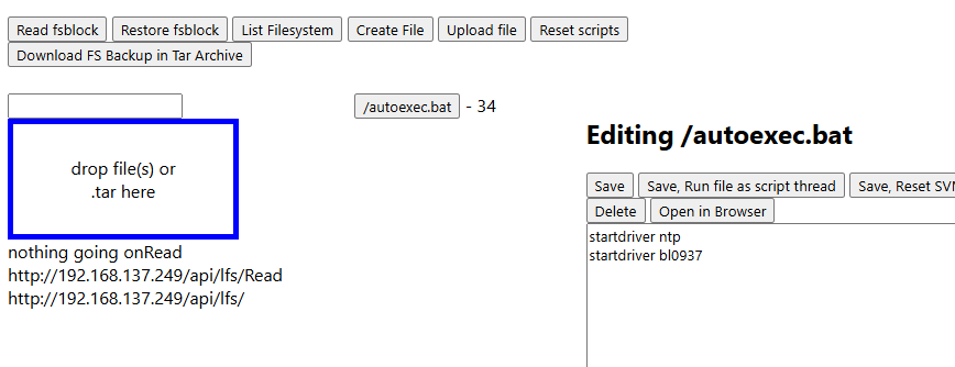

    1mb mini module from GU10 bulb - https://discourse.superhouse.tv/t/flashing-an-esp-8285-on-a-wiz-bulb/741/4
    first boot + client join AP. says QIO but boots.
    I see 03 here in post-flash dump = DOUT

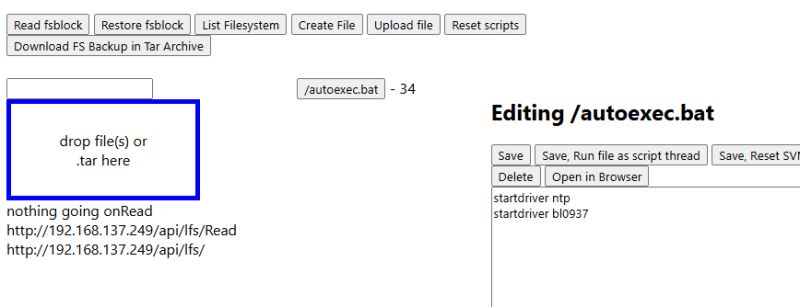

    Flashing OpenBeken/OBK firmware to ESP8266/ESP8285 devices
    Added after 7 [minutes]:
    1mb still. LFS OK. These two drivers start.
    Added after 8 [minutes]:
    memory with no drivers started

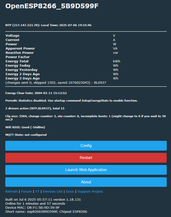

    Added after 9 [hours] 20 [minutes]:
    https://github.com/openshwprojects/OpenBK7231T_App/actions/runs/16106020194
    used ESP-Flasher.exe - ie not esptool cmd
    Added after 11 [hours] 58 [minutes]:
    I don't think BL0937 is working. Tried on ESP-02S real device and NodeMCU with Arduino PWM sketch thing https://www.elektroda.com/rtvforum/topic4109046.html

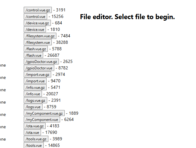

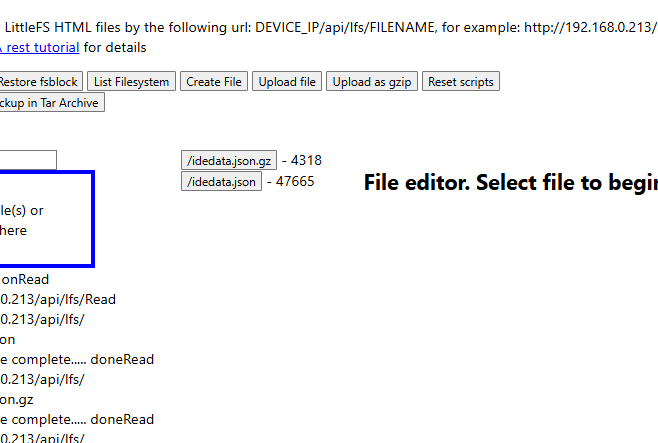

    I am adding "upload as GZIP" button along with simple gzip header handling in the firmware code. Browser will decode file on the fly.
    Here is comparison with and without compression:
    Added after 3 [hours] 53 [minutes]:
    LFS GZIP Topic: https://www.elektroda.com/rtvforum/topic4129516.html

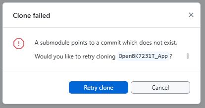

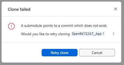

    hmm. fresh clone
    Error dialog: clone failed because a submodule points to a missing commit.
    Added after 21 [minutes]:
    just cloned without submodules

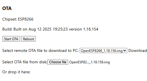

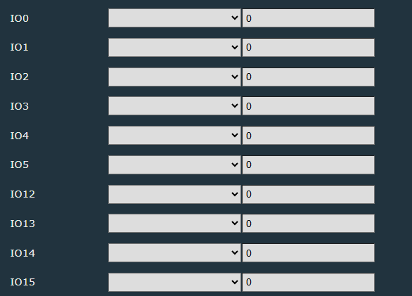

    OTA interface for ESP8266 with buttons and update file selection
    insmod wrote:
    + breaking change for esp8266, added 3 missing pins (io9, io10 and io16).
    before
    GPIO configuration interface with all values set to 0
    after
    Configuration table with dropdown settings for IO0–IO16 pins
    free mem 1.18.156
    Added after 3 [minutes]:
    wasn't able to OTA from 1.18.154 to 1.18.156. Wipe and UART 1.18.156 -> 1.18.155 =
    web app REST

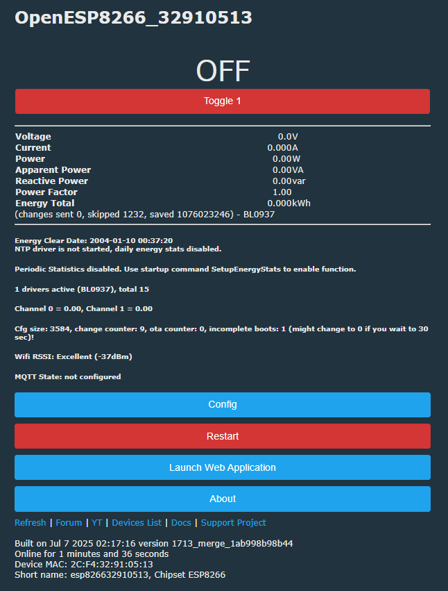

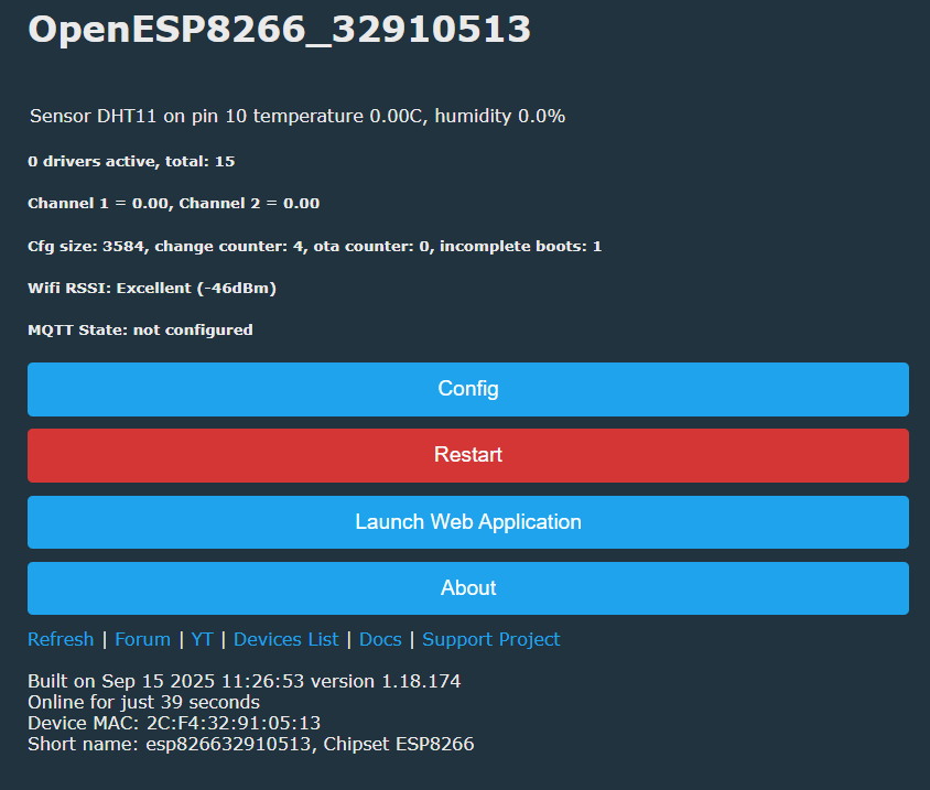

    OpenESP8266 web interface showing sensor data and system status

    Tilator
    Posts: 133
    Rate: 13
    >>21691103
    I tested it a bit more.
    While DHT11 is configured to pin 1-5, it's reported correctly on home page.
    When configured to pin 9-10, it's reported to be connected to pin 6-7.
    If I configure it to pins 14-16, it's reported to pin 10-12.

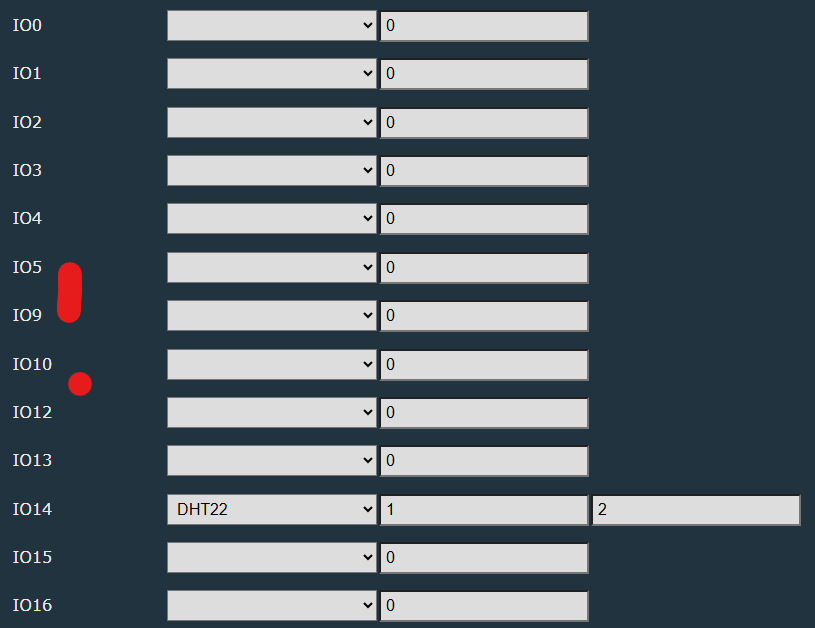

  • #48 21691147
    Posts: 5062
    Help: 438
    Rate: 893
    isn't it just because there are 4 pins not available above IO5
    Screenshot showing IO pin settings, with IO9 and IO10 marked in red.
  • #49 21691155
    Tilator
    Posts: 133
    Rate: 13
    That's how I find it too. It reports config page list index on home page and only pins 0-5 correspond the index.
    I did also try to connect the sensor with pin 14 using console command "setPinRole 14 DHT11", but it was not possible. Max pin value seems to be 13.
  • #50 21691202
    insmod
    Posts: 1395
    Help: 164
    Rate: 436
    >>21691155
    setPinRole sets role at pin index.
    So, pin with index №12 is IO16 on ESP8266.
    Pin with index 6 is IO9.
    All of this is because IO6-IO8 are flash pins and can't be used, and were therefore excluded from pin list.

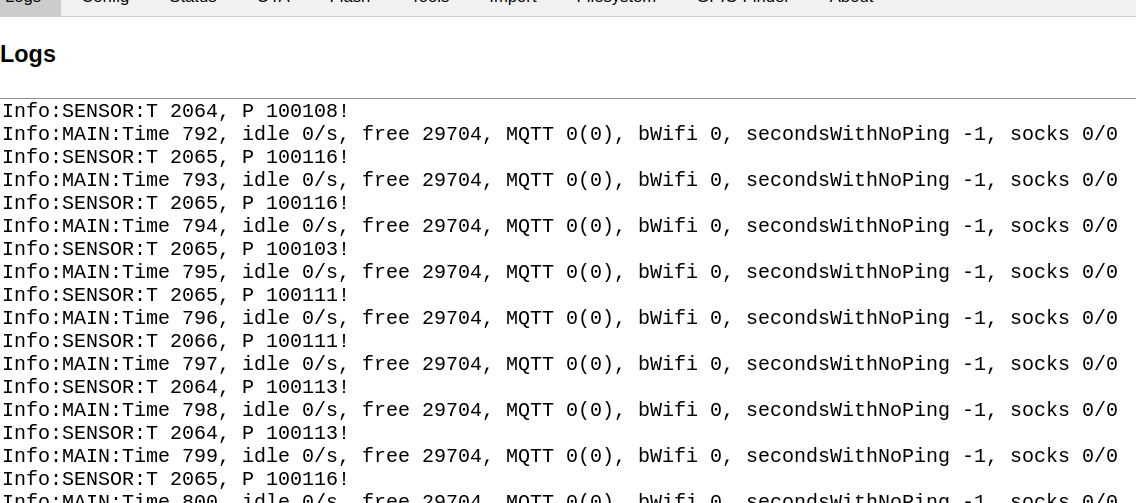

  • #52 21695550
    Tilator
    Posts: 133
    Rate: 13
    I tested it yet bit more by installing this to an ESP-S01. I have replaced the original 1MB flash with 8MB flash to enable easier updating.
    Assigning pins 0-5 to a relay works as expected. But assigning it to pins 9-16 makes UI hanging and other odd behavior.
    So - would it really be possible that config UI is not correct?
    #53 21695760

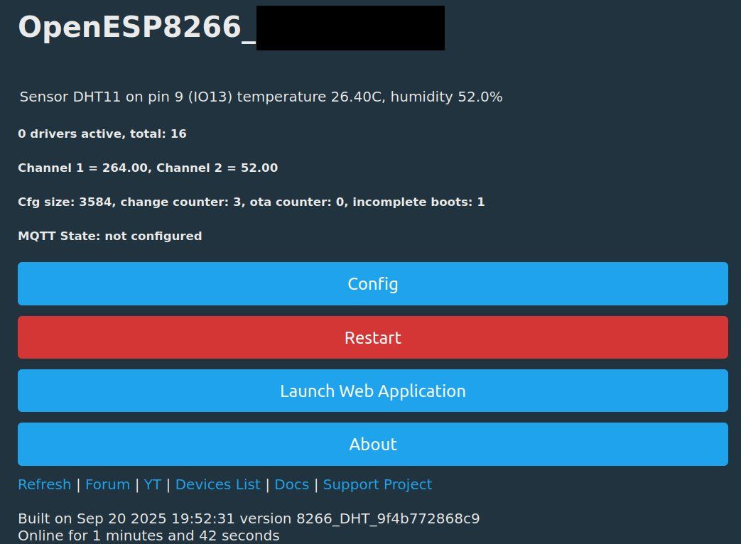

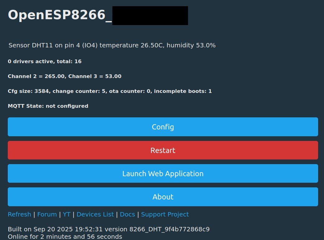

    Tested on ESP-12F:
    Can't get pin 5 working at all - even "always low" won't change it.
    But a quick test with pins 2, 4, 12, 13, 15 works (compiled a firmware with DHT driver https://github.com/MaxineMuster/OpenBK7231T_App/actions/runs/17883510649 and tested with DHT11, DS1820 won't work, probably timing issues)
    Added after 37 [minutes]:
    To check, I also added pin alias on DHT display on main page:
    https://github.com/MaxineMuster/OpenBK7231T_App/actions/runs/17884126801
    OpenESP8266 interface showing DHT11 sensor reading: 26.4°C and 52.0% humidity
    OpenESP8266 interface with DHT11 sensor data on pin IO4
  • #54 21702652

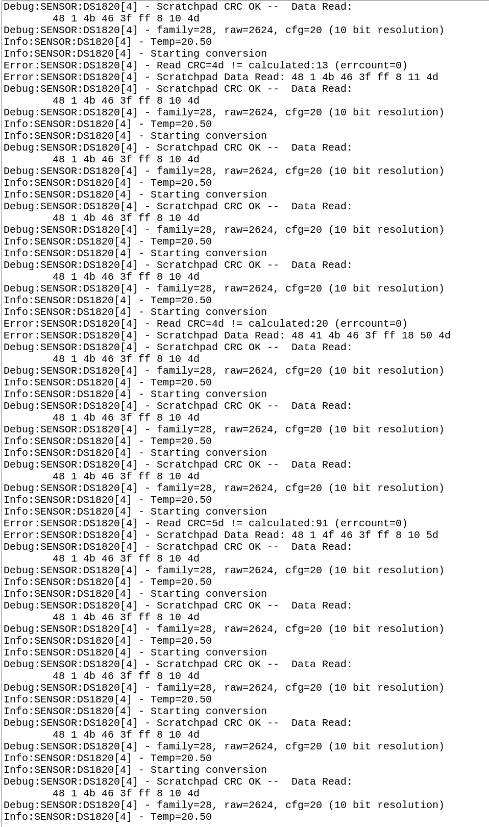

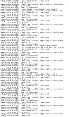

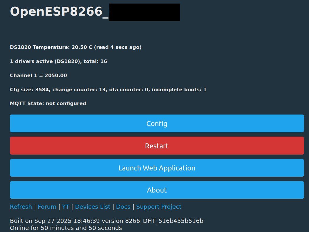

    max4elektroda
    Posts: 755
    Help: 48
    Rate: 187
    This run
    https://github.com/MaxineMuster/OpenBK7231T_App/actions/runs/18063697171
    will provide a "hacky" DS1820 enabled ESP8266 firmware.
    To get timing kind of working, first I had to make "writeByte" doing all "writeBit" inline in a loop.
    But even then reading did always fail.
    In the end I removed all "usleeps", when reading the onewire pin. It's only set output "0", set input "Pullup" and immediately read the pin.
    This way I often get valid readings.
    OpenESP8266 dashboard showing DS1820 temperature data and configuration buttons Screenshot of temperature sensor DS18B20 logs with CRC read errors

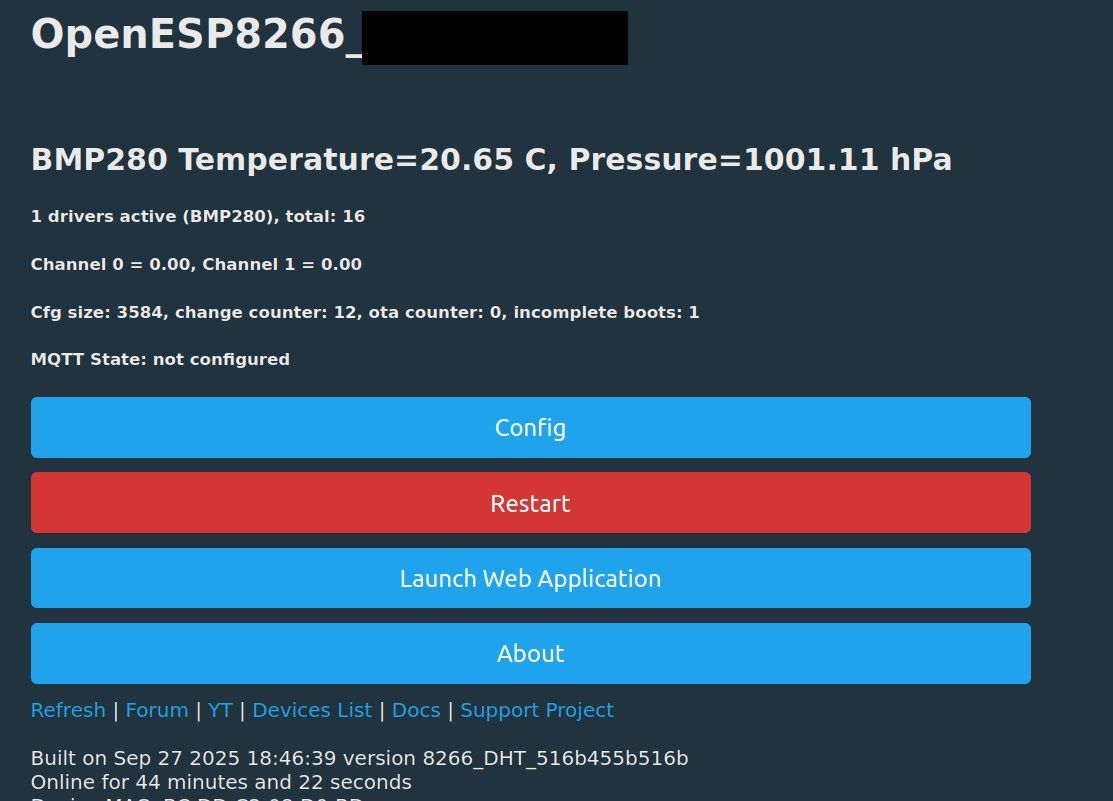

    Also enabled is DHT (tested with DHT11, see above) and BMP280:
    OpenESP8266 interface showing 20.65°C and 1001.11 hPa from BMP280 sensor Console screenshot showing sensor logs and system status messages
  • #55 21702673
