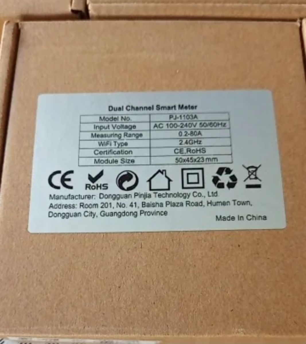

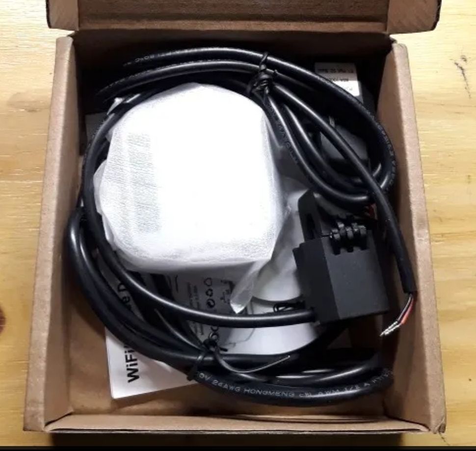

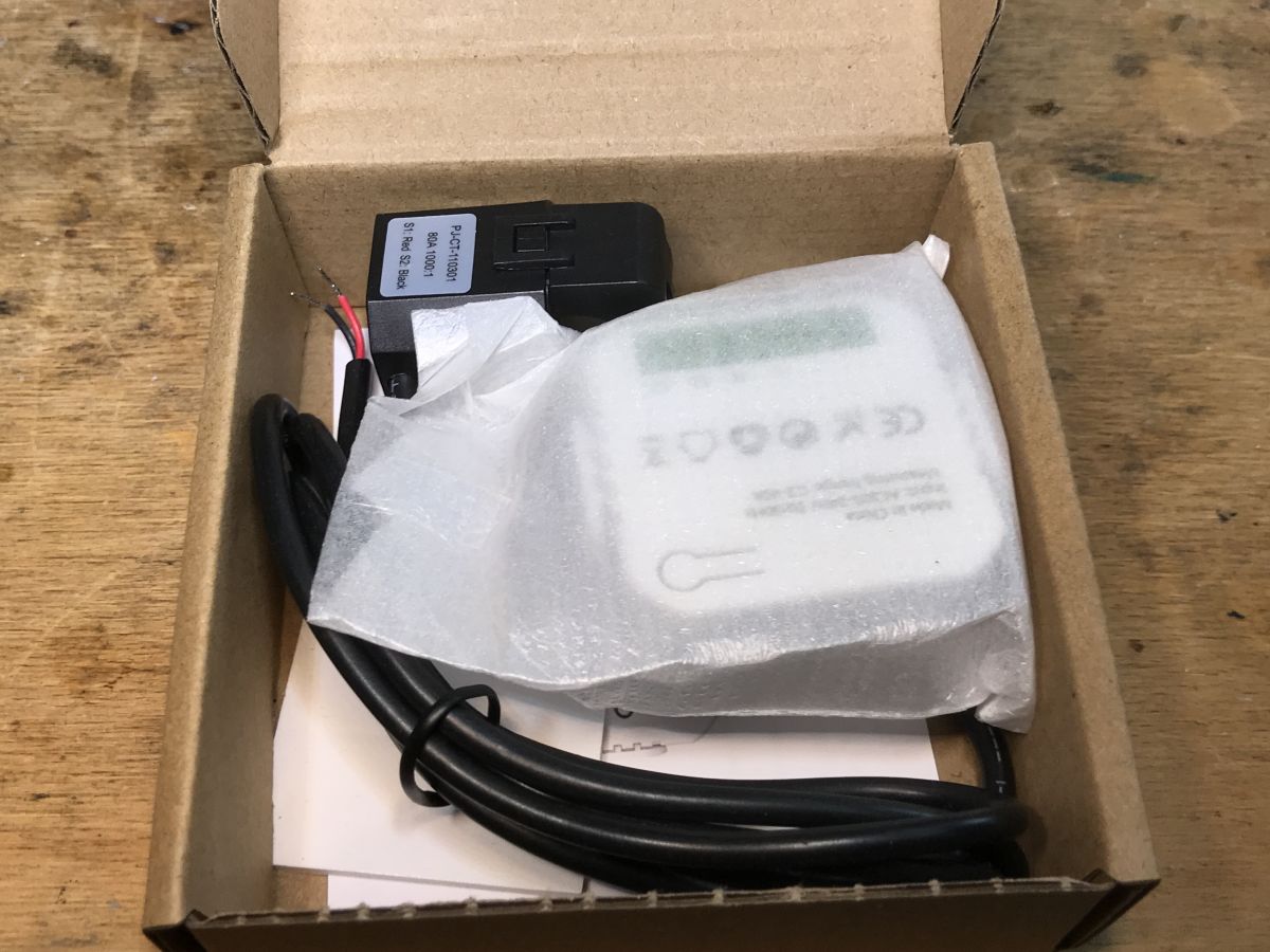

    Energy meter ordered from Aliexpress
    Tuya WiFi energy meter with two inductive coils.
    Specifications:
    Name: Tuya WiFi Energy Meter
    Material: PC
    Type: 1CT, 2CT (optional)
    Current: 0.2-80A
    Input voltage: 110-240 V, 50/60Hz
    Accuracy grade: 1.0
    Working current: -10℃ to 55℃
    Wireless type: 2.4GHz
    Item size: 47 * 47 * 18mm / 1.85 * 1.85 * 0.71in
    Package size:
    1CT: 100 * 100 * 30mm / 3.94 * 3.94 * 1.18in
    2CT: 115 * 115 * 40mm / 4.53 * 4.53 * 1.57in
    Package weight:
    1CT: 150g / 5.29ounce
    2CT: 200g / 7.05ounce

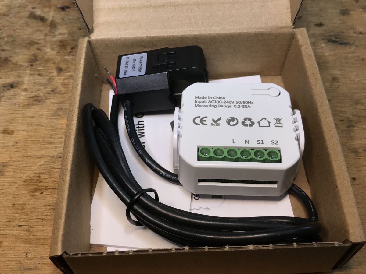

    Nameplate of energy meter PJ-1103A
    Tuya WiFi energy meter set in a box.

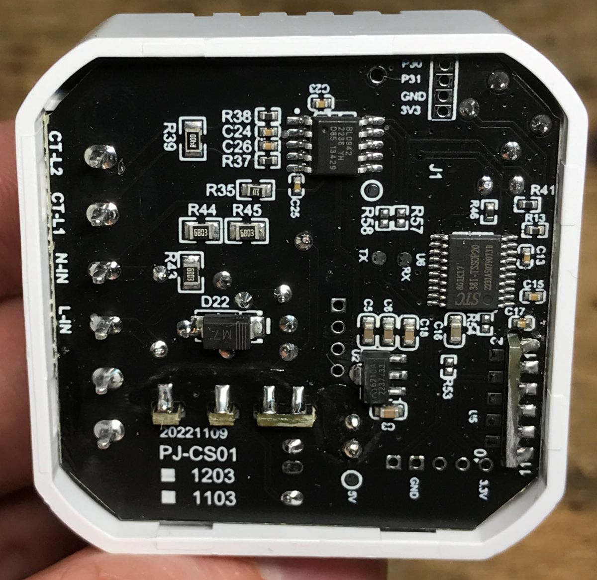

    EB2S:
    View of a circuit board with electronic components.
    Mainboard:
    Main board of the Tuya WiFi energy meter with BK7231N chip.

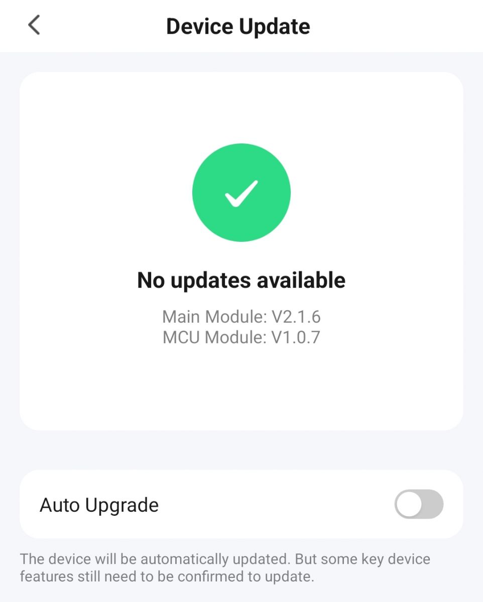

    Smart Life application / Tuya platform version check:
    Device update screen indicating no updates available.

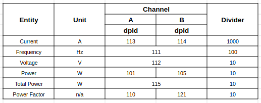

    Example of autoexec.bat required to configure TuyaMCU for channel A:
    Code: Dos
    3. Can be configured more parameters and additional channel B as per:

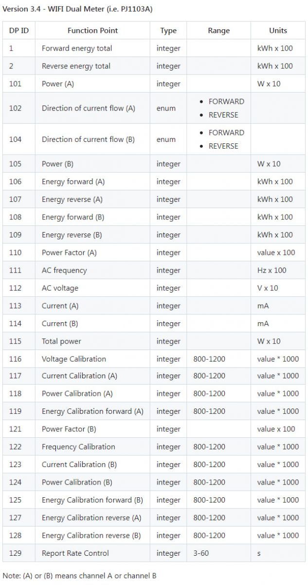

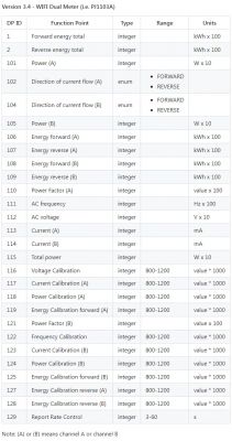

    Extracted dpIDs:
    Configuration parameters table for the Tuya energy meter

    Hm mine was PJ-MGW1103 meter with CT CB2S...

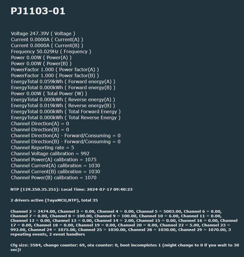

    I have one of these same units PJ-1103A and have set it up using the supplied config and what is found in other forums.
    Below is what the GUI looks like
    Graphical user interface for the PJ-1103A unit showing various statistics.
    and Below is my config

    The energy stats seem either not to work or to be wildly inaccurate and some of them are lost of you power cycle the unit.
    My 2 questions to @p.kaczmarek2   are
    1/ Can we get energy stats to work like the BL0492 driver rather than this way
    2/ How can I use Enums for channel 19 and 20 rather than rewriting just the channel labels
    Thanks in advance.
  • #6 21164859
    Posts: 14791
    Rate: 12937
    It should be possible to link old BL0942 energy stats to TuyaMCU, but TuyaMCU may not provide frequent enough updates for it to work good. It is currently not implemented.
    dpIDs 20 and 19 are current direction? We can create channel type for that.

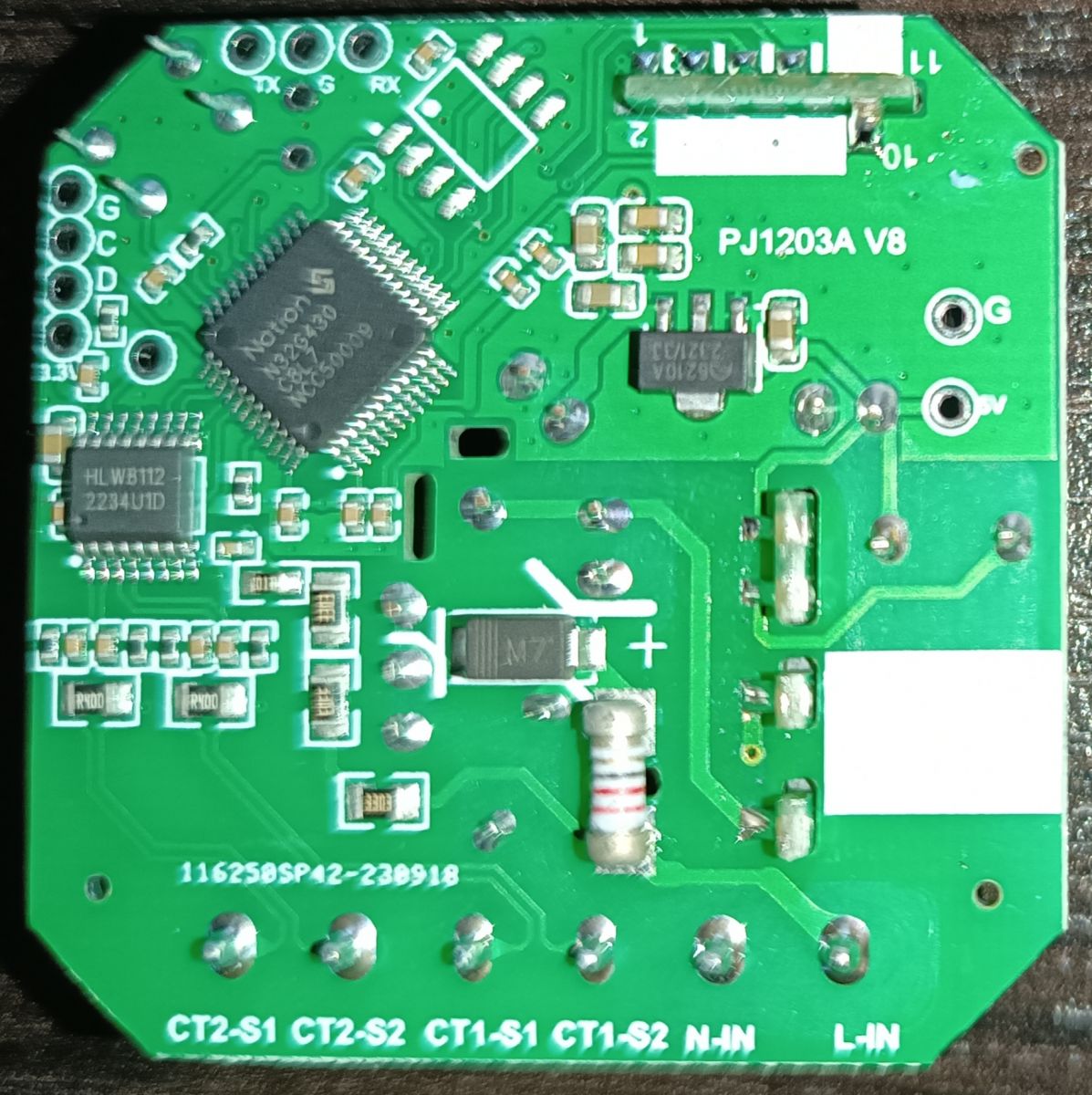

    Thanks but this is not a BL0942 it's a HLW8112
    I am unsure but maybe we can bypass Tuya MCU and connect straight to CB2S but this would require a driver and from what I can find there is not a lot of data around for it.
    (Data sheet attached)
    Maybe I just purchase a new unit that's based on the BL0942 chips ??
    DPid 102 and 104 are the clamp A and B directions .
    Thanks again

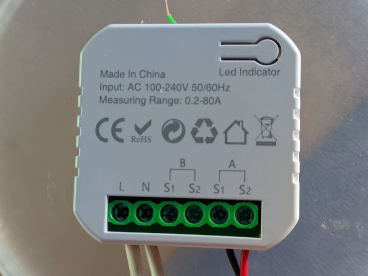

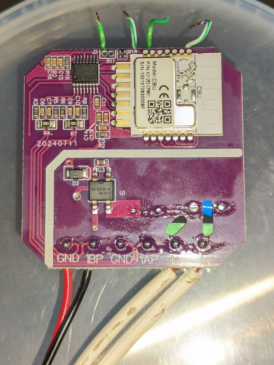

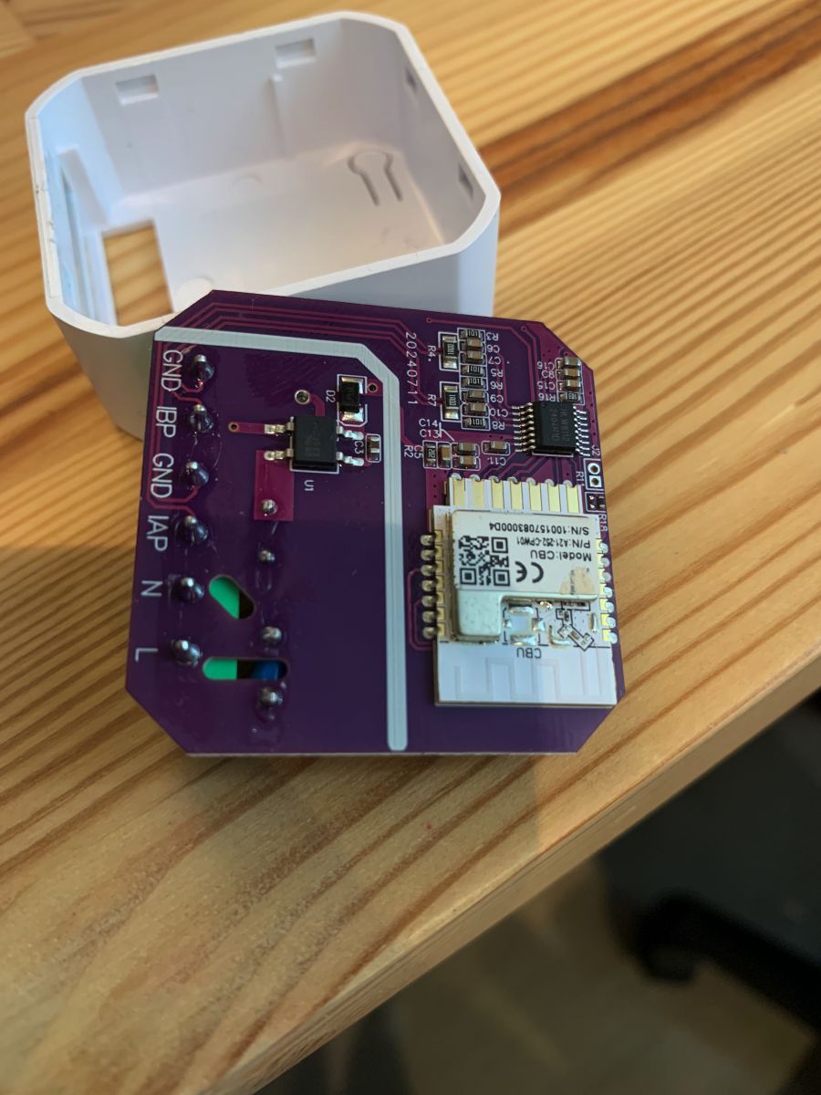

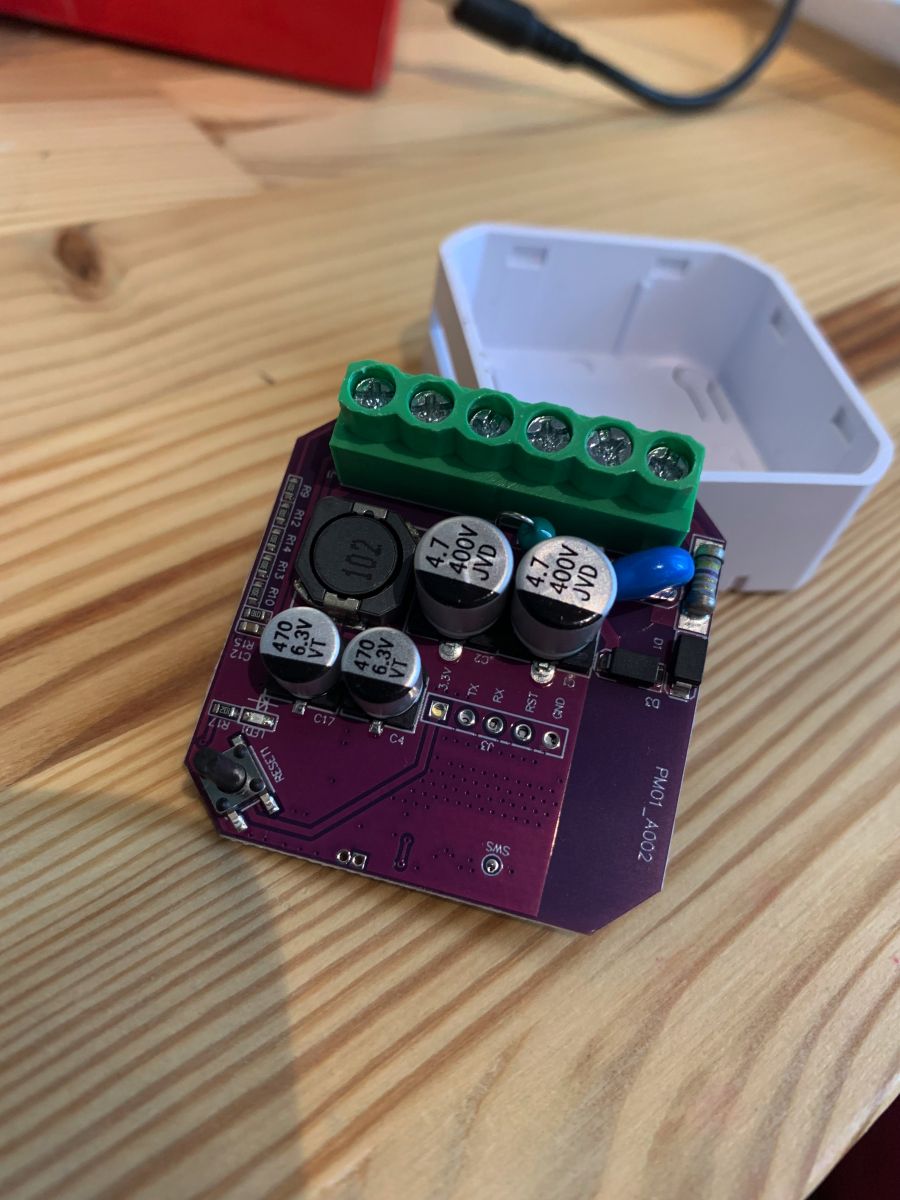

  • Direct-mains design with CBU and HLW8112
    #9 21212779
    dicamarques
    Posts: 10

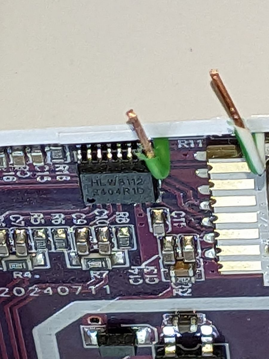

    I just got a power meter, similar to this one, but the interior is just the CBU and the HLW8112 .
    So I think we can assume mine is a direct connection?
    Close-up of a circuit board with a visible integrated circuit marked HLW8112.
    Inside of a power meter showing CBU module and electronic components.
    Circuit board with electronic components, including capacitors and a connector.
    Electrical power meter with visible connectors and labels.

  • Questioning HLW8112 UART or SPI interface
    #12 21212842
    Posts: 14791
    Rate: 12937

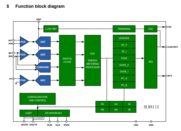

    Ok, I haven't found much in that binary backup, so I'd say just flash OBK and we will see. In worst case you can always restore factory firmware.

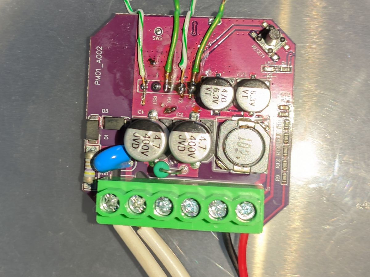

    The another question is how the HLW8112 protocol looks like. It may be not supported yet. Is it using UART or SPI?
    Function block diagram of the HLW811X chip showing connections and components.
    Maybe it would be helpful to check and sketch the connections of HLW8112 pins to the WiFi module?
  • #13 21213489
    dicamarques
    Posts: 10
    >>21212842

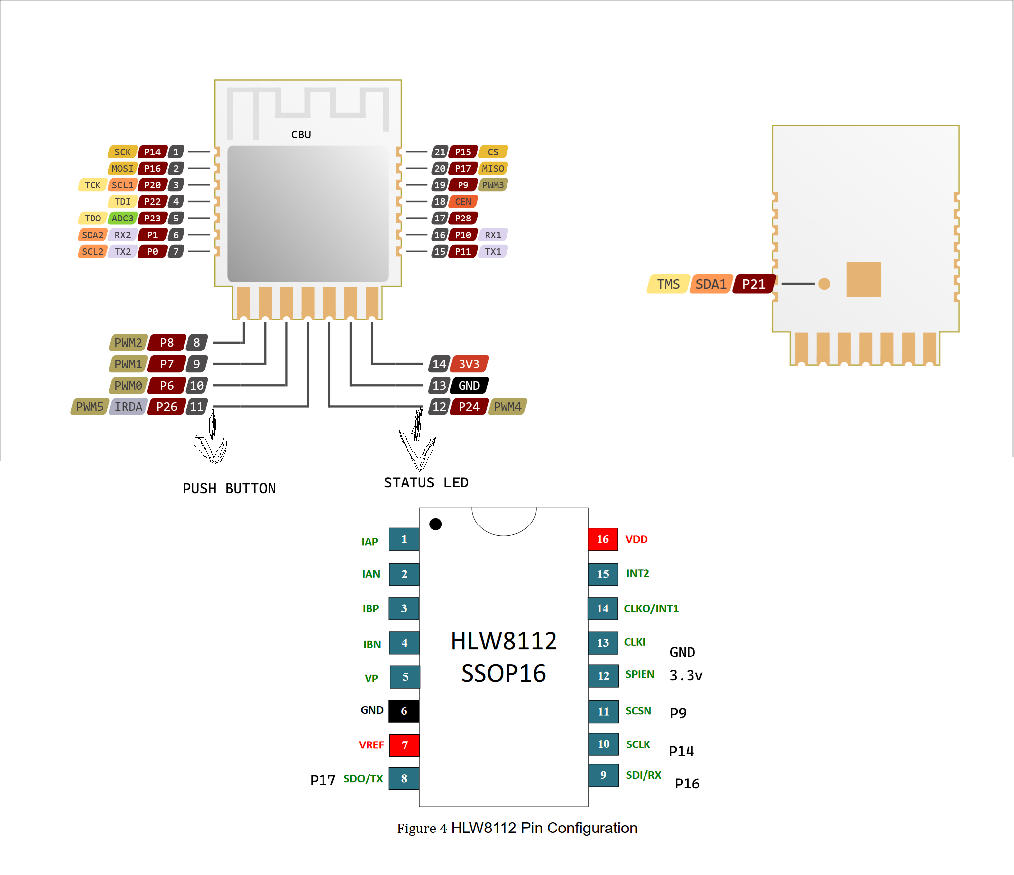

    I'm trying to make a diagram, but from the datasheet of the HLW8112, the PIN SPIEN is High, so I'm assuming its SPI

    I should add that I did this dump before I configured the device with the smartlife app
    Here's the pinout I managed to find
    Pin diagram of an electronic module with labels.
  • #16 21214642
    Posts: 14791
    Rate: 12937
    Hmm, we have BL0942 SPI mode supported, how is HLW SPI different from that?

    Very popular model, I currently have two of them. I flashed one before I realized that there are no drivers for this type of energy monitor chip. CBU/HLW8112.
    Flashing is very easy and convenient. I'm waiting for an update to use this with OpenBekken. I made a dump; if you need any data, I can provide it.
    A blue circuit board with green terminals and capacitors on a wooden table. Circuit board with a purple circuit and electronic module on a wooden surface.

    #25 21333707
    nhsqr
    dicamarques wrote:
    The code I have on my repo has an initial communication with the chip, but I still hadn't had time to implement all the features and see if it's really working
    I have compiled your repo branch: drv_hlw8112
    I can see that the driver is compiling successfully but after flashing it does not show up in module configuration drop down menu (on both web and app).
    Am I missing something?
    This is an interesting project that I think I can help with in the next few weeks.
    Also I have found a very well written driver in a Chinese repo: https://github.com/notrynohigh/BabyOS
    But the development of this driver was: https://github.com/Hossein-M98
    Mine is exactly the same as https://www.elektroda.com/rtvforum/topic4016609.html#21212779
  • Need to start HLW8112SPI driver first
    #26 21333858
    dicamarques
    Posts: 10
    >>21333707
    I think you first need to send the command startDriver HLW8112SPI if I'm not mistaken
    I was looking at that babyOs, maybe we can have a look at this file https://github.com/notrynohigh/BabyOS/blob/master/bos/drivers/b_drv_hlw811x.c
    I haven't had the time to continue debugging my development but maybe this can speed up the process
    Or maybe: https://github.com/MahdaSystem/HLW811x/blob/master/src/HLW811x.c it's easier
  • HLW8112SPI init fails with register write errors
    #27 21333875
    nhsqr
    dicamarques wrote:
    >>21333707
    I think you first need to send the command startDriver HLW8112SPI if i'm not mistaken
    Or maybe: https://github.com/MahdaSystem/HLW811x/blob/master/src/HLW811x.c its easier
    Yes, you are right about the command. I took a look at the code and saw it. Unfortunately it gets me:
    Warn:EnergyMeter:HLW8112_SPI_Init
    Error:EnergyMeter:Failed to write reg 80 val A04: read 410000
    Error:EnergyMeter:Failed to write reg 81 val 00: read 60000
    Warn:EnergyMeter:HLW8112_SPI_Init_OUT
    Info:MAIN:Started HLW8112SPI.
    So now I am not sure if the HLW8112 chip is not working properly or is there something wrong in the code because before I flushed it, the original firmware was freezing for some unknown reason. And now I am thinking of buying another one but it will take at least a couple of weeks to arrive.

    #28 21337073
    laszlokondas
    Hello all! I'm using this meter with, using the TuyaMCU driver with the configuration from @rohanb. I can also confirm that the instant measurements are OK, but from the historical ones only the energyTotal is reliable.
    I did not use calibration values in the config, and my sensor measurements are off by 5% approx. Is there a way I can access the calibration values from the original firmware? Unfortunately I did not make a dump before flashing openBeken...
  • Autoexec config for PJ-1103A dual-clamp meter
    #29 21373100
    alexan_e
    >>21337073
    Hi, I've made this one and I can access all the configuration settings and change them.
    autoexec.bat for PJ-1103A dual clamp energy meter (Tuya)
    startDriver TuyaMCU
    tuyaMcu_setBaudRate 9600
    tuyaMcu_defWiFiState 4
    startDriver NTP
    ntp_setServer 129.250.35.251
    // set for your timezone
    ntp_timeZoneOfs +2
    setChannelType 2  EnergyTotal_kWh_div100
    setChannelType 3  EnergyTotal_kWh_div100
    setChannelType 4  Power_div10
    setChannelType 5  ReadOnly
    setChannelType 6  ReadOnly
    setChannelType 7  Power_div10
    setChannelType 8  EnergyTotal_kWh_div100
    setChannelType 9  EnergyTotal_kWh_div100
    setChannelType 10 EnergyTotal_kWh_div100
    setChannelType 11 EnergyTotal_kWh_div100
    setChannelType 12 PowerFactor_div100
    setChannelType 13 Frequency_div100
    setChannelType 14 Voltage_div10
    setChannelType 15 Current_div1000
    setChannelType 16 Current_div1000
    setChannelType 17 Power_div10
    setChannelType 18 PowerFactor_div100
    setChannelType 19 TextField
    setChannelType 20 TextField
    setChannelType 21 TextField
    setChannelType 22 TextField
    setChannelType 23 TextField
    setChannelType 24 TextField
    setChannelType 25 TextField
    setChannelType 26 TextField
    setChannelType 27 TextField
    setChannelType 28 TextField
    setChannelType 29 TextField
    SetChannelLabel  2   "Total Forward energy"
    SetChannelLabel  3   "Total Reverse energy"
    SetChannelLabel  4   "Power A"
    SetChannelLabel  5   "Direction A (0=forward - 1=reverse)"
    SetChannelLabel  6   "Direction B (0=forward - 1=reverse)"
    SetChannelLabel  7   "Power B"
    SetChannelLabel  8   "Forward Energy A"
    SetChannelLabel  9   "Reverse Energy A"
    SetChannelLabel  10  "Forward Energy B"
    SetChannelLabel  11  "Reverse Energy B"
    SetChannelLabel  12  "Power Factor A"
    SetChannelLabel  13  "AC Frequency"
    SetChannelLabel  14  "Voltage"
    SetChannelLabel  15  "Current A"
    SetChannelLabel  16  "Current B"
    SetChannelLabel  17  "Total Power"
    SetChannelLabel  18  "Power Factor B"
    SetChannelLabel  19  "Voltage Calibration (800-1200)"
    SetChannelLabel  20  "Current A Calibration (800-1200)"
    SetChannelLabel  21  "Power A Calibration (800-1200)"
    SetChannelLabel  22  "Energy A Calibration Forward (800-1200)"
    SetChannelLabel  23  "Frequency Calibration (800-1200)"
    SetChannelLabel  24  "Current B Calibration (800-1200)"
    SetChannelLabel  25  "Power B Calibration (800-1200)"
    SetChannelLabel  26  "Energy B Calibration Forward (800-1200)"
    SetChannelLabel  27  "Energy A Calibration Reverse (800-1200)"
    SetChannelLabel  28  "Energy B Calibration Reverse (800-1200)"
    SetChannelLabel  29  "Adjust Reporting Rate (3-60)"
    linkTuyaMCUOutputToChannel 1   1 2
    linkTuyaMCUOutputToChannel 2   1 3
    linkTuyaMCUOutputToChannel 101 2 4
    linkTuyaMCUOutputToChannel 102 2 5
    linkTuyaMCUOutputToChannel 104 1 6
    linkTuyaMCUOutputToChannel 105 1 7
    linkTuyaMCUOutputToChannel 106 1 8
    linkTuyaMCUOutputToChannel 107 1 9
    linkTuyaMCUOutputToChannel 108 1 10
    linkTuyaMCUOutputToChannel 109 1 11
    linkTuyaMCUOutputToChannel 110 1 12
    linkTuyaMCUOutputToChannel 111 1 13
    linkTuyaMCUOutputToChannel 112 1 14
    linkTuyaMCUOutputToChannel 113 1 15
    linkTuyaMCUOutputToChannel 114 1 16
    linkTuyaMCUOutputToChannel 115 1 17
    linkTuyaMCUOutputToChannel 121 1 18
    linkTuyaMCUOutputToChannel 116 2 19
    linkTuyaMCUOutputToChannel 117 2 20
    linkTuyaMCUOutputToChannel 118 2 21
    linkTuyaMCUOutputToChannel 119 2 22
    linkTuyaMCUOutputToChannel 122 2 23
    linkTuyaMCUOutputToChannel 123 2 24
    linkTuyaMCUOutputToChannel 124 2 25
    linkTuyaMCUOutputToChannel 125 2 26
    linkTuyaMCUOutputToChannel 127 2 27
    linkTuyaMCUOutputToChannel 128 2 28
    linkTuyaMCUOutputToChannel 129 2 29
    // do not send to MQTT the following channels
    SetChannelPrivate 19 true
    SetChannelPrivate 20 true
    SetChannelPrivate 21 true
    SetChannelPrivate 22 true
    SetChannelPrivate 23 true
    SetChannelPrivate 24 true
    SetChannelPrivate 25 true
    SetChannelPrivate 26 true
    SetChannelPrivate 27 true
    SetChannelPrivate 28 true
    SetChannelPrivate 29 true
    // you can use these to force initial calibration values
    //SetChannel 19 1000
    //SetChannel 20 1000
    //SetChannel 21 1000
    //SetChannel 22 1000
    //SetChannel 23 1000
    //SetChannel 24 1000
    //SetChannel 25 1000
    //SetChannel 26 1000
    //SetChannel 27 1000
    //SetChannel 28 1000
    //SetChannel 29 10
    PowerSave 1
    It's based on this table which can be found image source
    Configuration table for the PJ-1103A WiFi Dual Meter.
