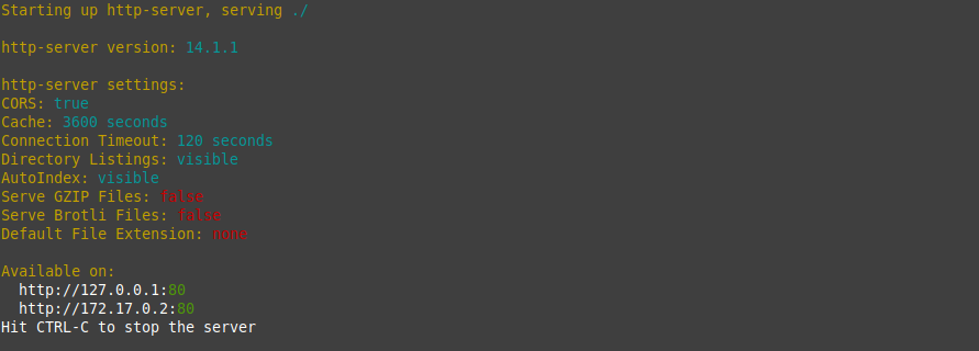

    Run this command:
    Code: Bash
    This downloads the image and launches the container, exposing port 7231. Adjust the port according to your preference, ensuring alignment with application settings.

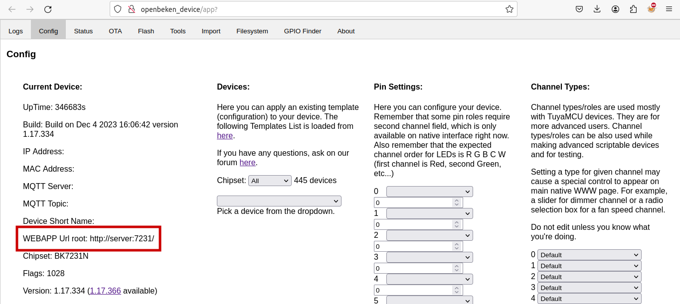

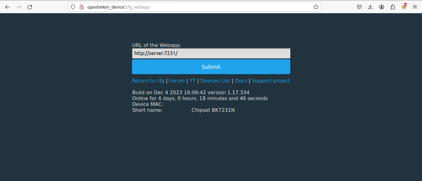

    3. Change URI address of hosted files(In my case files are hosted on computer with hostname: server):
    Please visit the specified page, and following that, proceed to adjust the settings on your device at the provided address (in this instance, it is the hostname of my IoT OpenBeken device).
    Code: Bash
    Here, the address of our local server, which stores files for us, is entered.
    OpenBeken IoT web application configuration page with a URL input box.
    4. Check the results
    With those steps completed, the configuration process should now be finished.
    Upon successful execution of the plan, the following is expected in the web browser:
    Screenshot of the OpenBeken IoT configuration interface highlighting the web app URL.

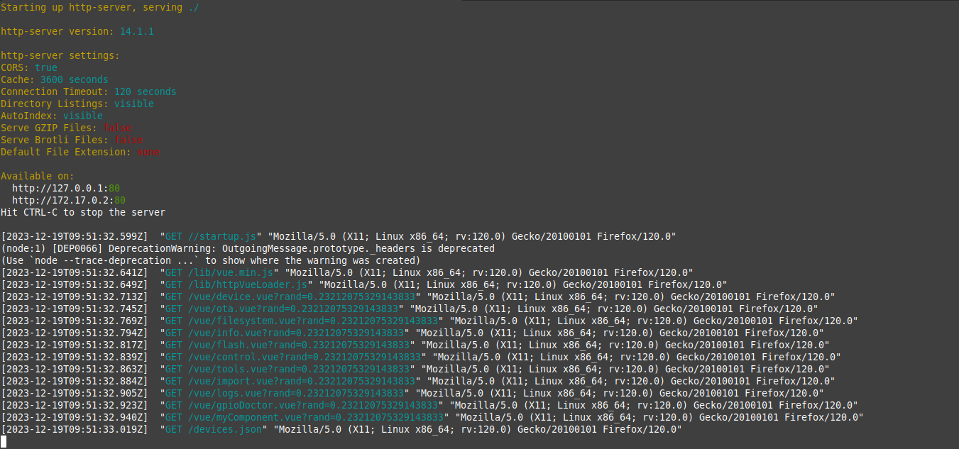

    On the server side within the Docker/container environment:
    Screenshot showing http server logs running in a Docker environment for the OpenBeken IoT application.

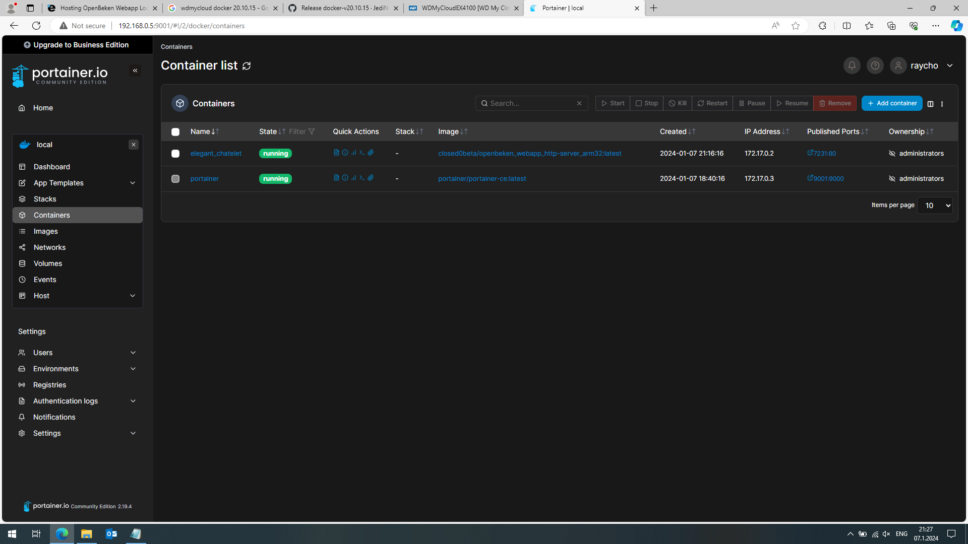

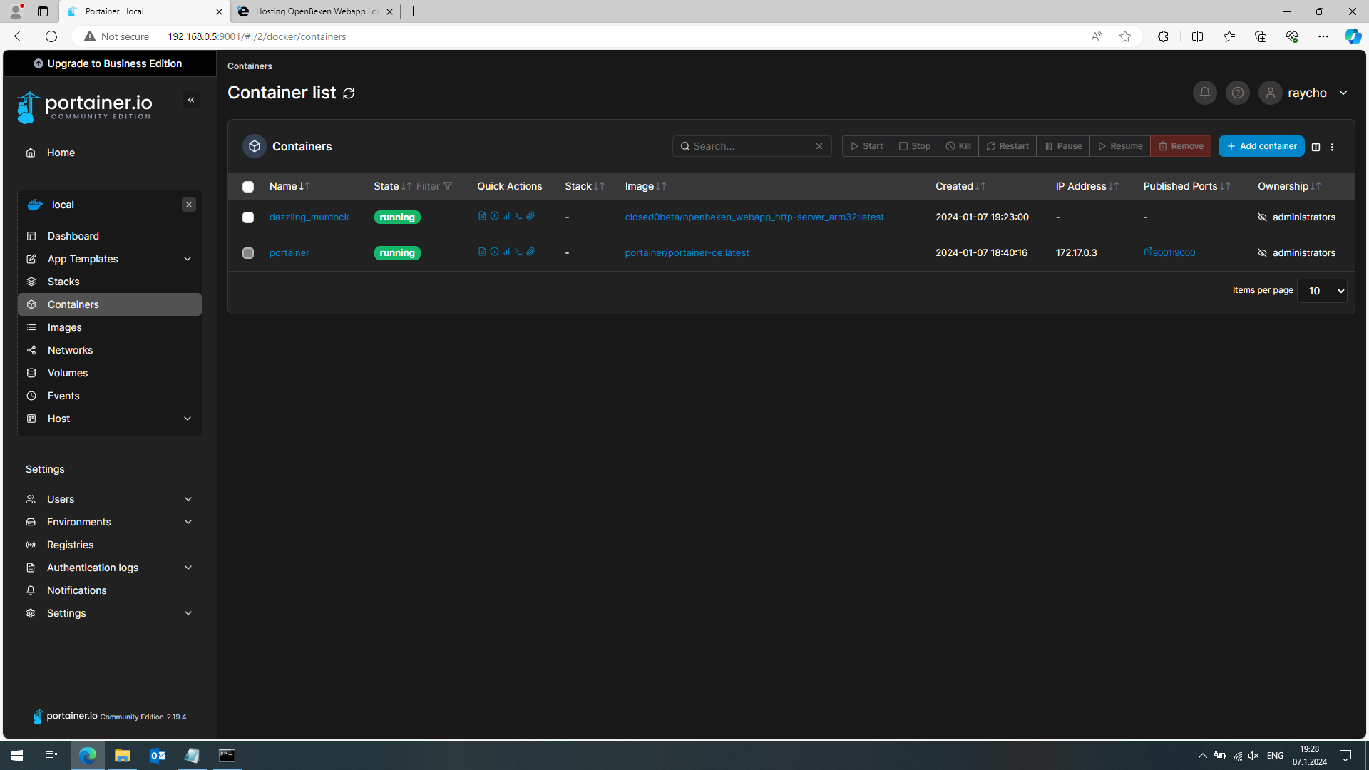

    @taktlos Something wrong with port publishing in the last version.
    Screenshot of Portainer panel showing a container list with port issues.
    without restart=always container stops after few seconds. With this option keeps running but keeps restarting and port is almost all the time closed.
    Exit code is always 139.
    Probably better to reverse back to previous version
  • #11 20896830
    taktlos
    Posts: 21
    Rate: 9
    All right, so the earlier obsolete version of Alpine Linux back in business.
    Code: Bash
  • #12 20896964
    Angel0fDeath
    Posts: 118
    Rate: 33
    Screenshot of the Portainer application showing a list of two running containers.
    Yep. With outdated Alpine - everything is ok.
    I think the problem is with my docker - v 20.10.15 for wdmycoudex4100 dated May 2022.... But there is no newer version.
    Nevertheless, THANKS

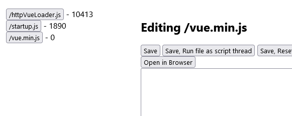

  • Littlefs write error indicates flash space limit
    #15 20924116
    jkwim
    Posts: 186
    Rate: 25
    I tried creating the files in LittleFS.
    Screenshot of a file editor showing three JavaScript files with their sizes.
    I edited the paths so that everything gets referenced from / (no sub directories).
    As you can see the two files occupy roughly 12kB.
    The next file vue.min.js is about 92kB and the save is not successful which probably means that there is not enough space.
    Somewhere in the forum I see a comment saying up to 512kB of space can be made available if we maintain the flash file size to a minimum.
    https://www.elektroda.com/rtvforum/topic3887748.html#19984683
    Is there a way to find out how much space is being taken up by the currently installed firmware from the device itself?
    UPDATE:
    I tried saving a test file with incremental character count and saw this error -28 in the logs:
    Screenshot of three files with their sizes in bytes.
    Debug:API:GET of api/info
    Error:API:Failed to write to test.txt with error -28
    Debug:API:3708 total bytes written
    Debug:API:GET of api/lfs/
    Debug:API:LFS read of
    Debug:API: is a folder
    Debug:API:opened folder  lfs result 0
    Added after 7 [hours] 49 [minutes]:
    @p.kaczmarek2
    Do you have an answer for my question above regarding finding out the flash space used in the device?

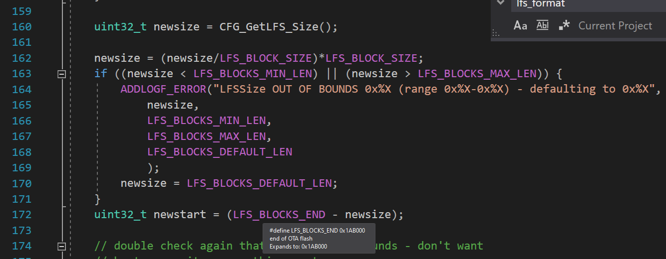

  • LittleFS can overlap OTA space with lfs_format size
    #17 20925206
    Posts: 14725
    Rate: 12809
    @jkwim please open another topic and we can look into that together, but long story short, LittleFS could have even 500kB or so, but it would need to be shifted to the OTA space, and then OTA would wipe out it....
    EDIT: @Angel0fDeath it's almost as you say, with the exception of the fact that the second megabyte of flash already consists some things, like OBK config, or RF partition, or Tuya config, so we can't just overwrite it with LittleFS
    but the shortest answer is:
    lfs_format <size>
    the code wll properly offset LFS into the space and can overlap OTA for larger file systems:
    Code snippet about LittleFS size in flash memory.
