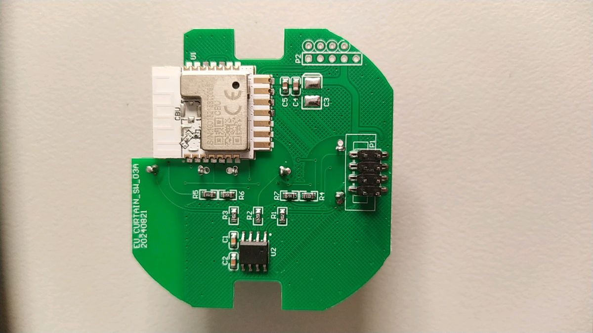

    [BK7231N/CBU] MOES WS-Y-EUTC-WH-MS Curtain switch (capacitive touch)

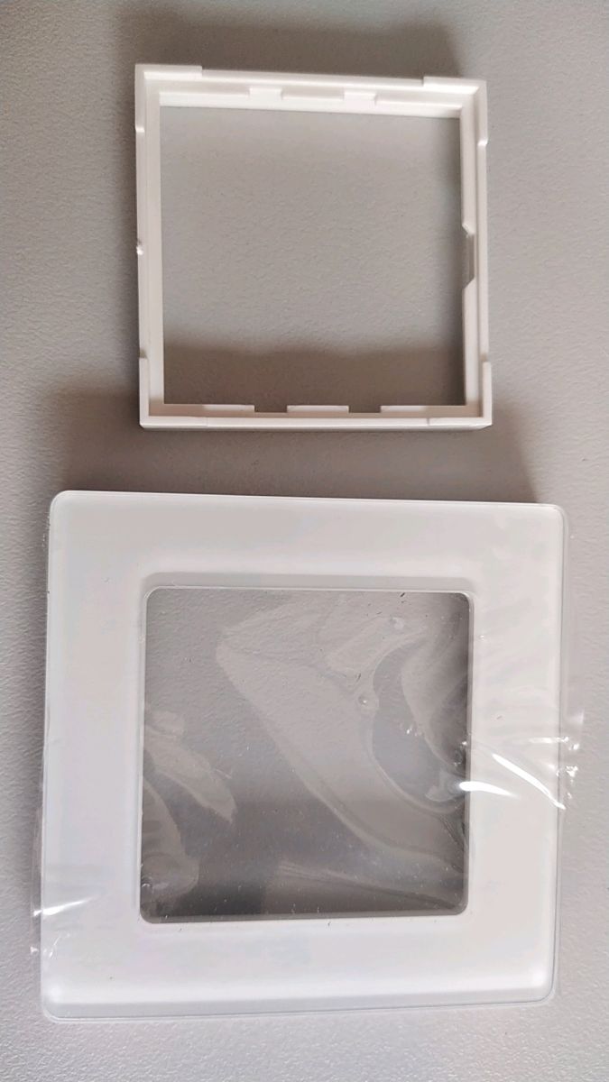

    comes with an additional adapter frame to make it EU standard compatible

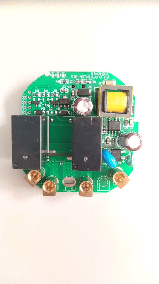

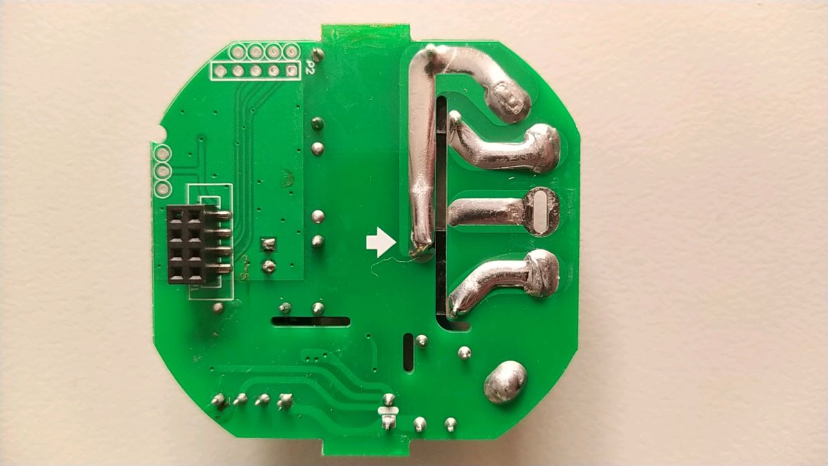

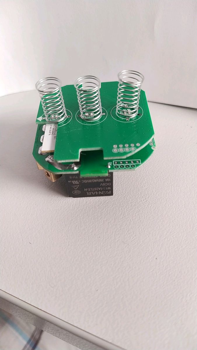

    Curtain switch PCB with two relays and screw terminalsBottom view of green PCB with thick solder traces and 8-pin connector on the left

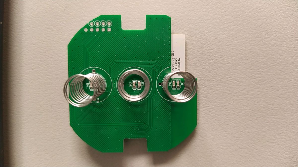

    Touch PCB with three spring coils and labels D1, D2, D5 on a green circuit boardMOES curtain switch PCB with BK7231N module and pin header visibleElectronic module with three springs on a green PCB of a curtain switch

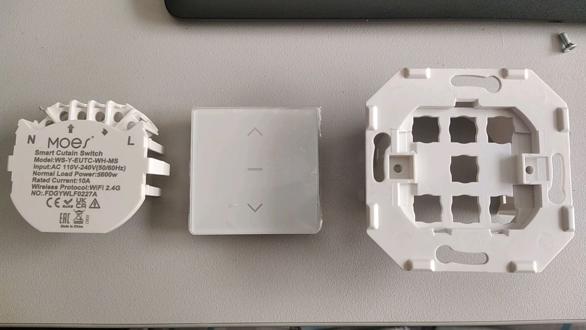

    Three components of MOES WS-Y-EUTC-WH-MS smart curtain switch on tableWhite plastic frame and adapter for MOES curtain switch

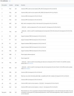

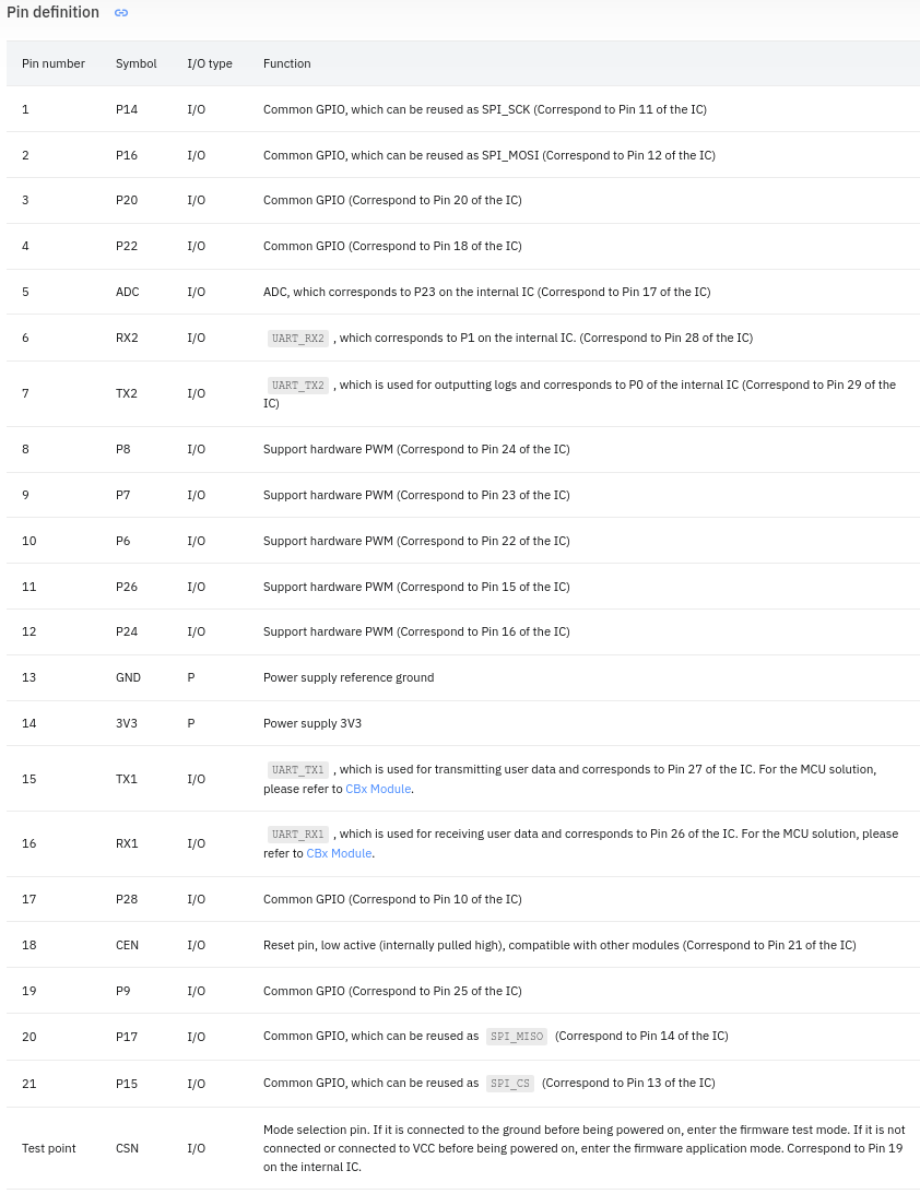

    Table showing pin definitions for BK7231N electronic chip

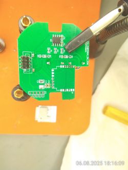

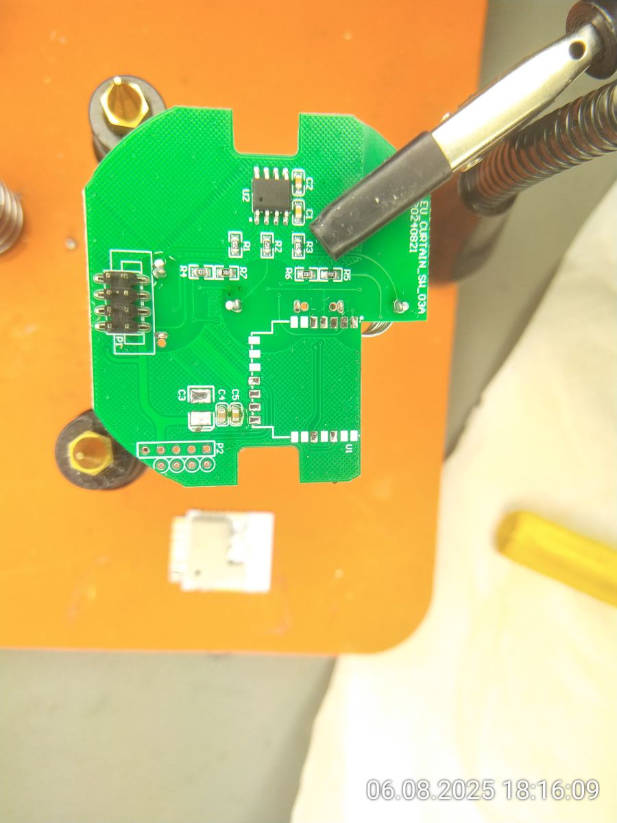

    Used pads:
    MOES WS-Y-EUTC-WH-MS PCB mounted in a service clamp
    Leads to used pins:
    01/P14           <-> led down
    02/P16           <-> led middle
    03/P20           <-> led up
    04/P22           <-> led background
    05/P23           <-> down button
    11/P26           <-> relais down
    12/P24           <-> relais up
    13                    <-> GND
    14                    <-> 3.3V
    17/P28           <-> up button (top)
    19/P9             <-> stop button (middle)
    Since i dont know what to do with the middle button i just enable the led right now. its free for other usage.
