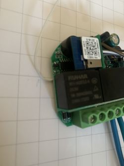

    I buy a switch for roller shutter
    There’s a WB2S I flash it but I don’t understand how to configure it. There’s another mcu in the board and I don’t know what it does.
    Could you help me to configure it ?

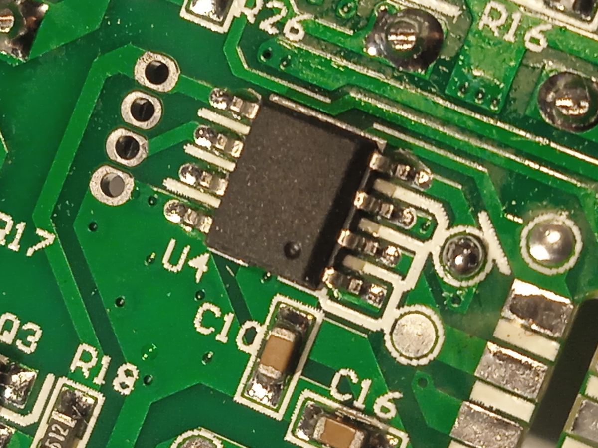

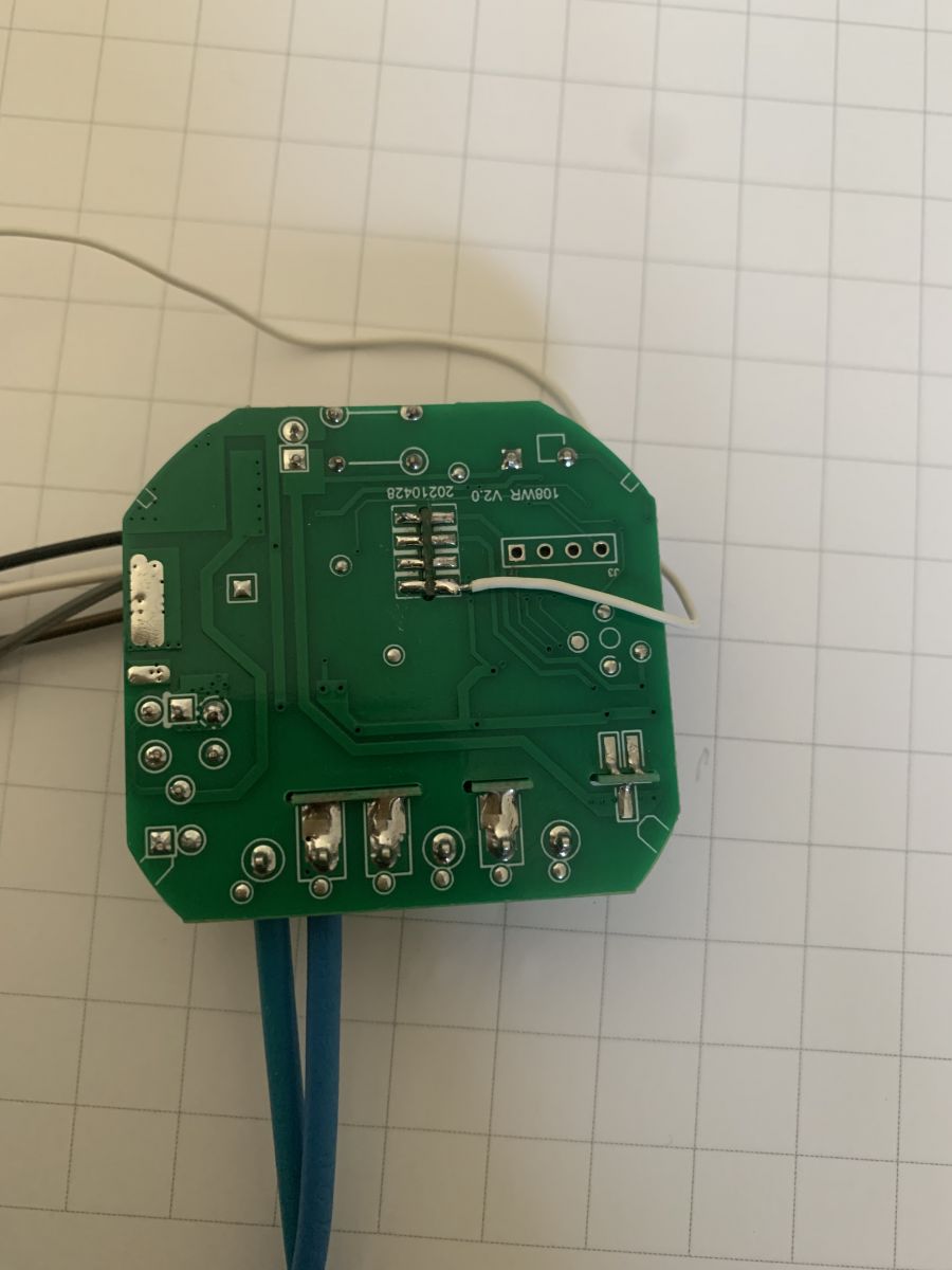

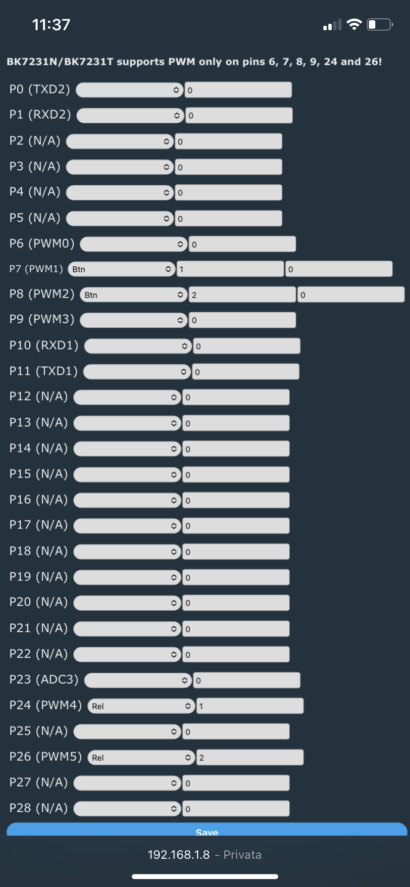

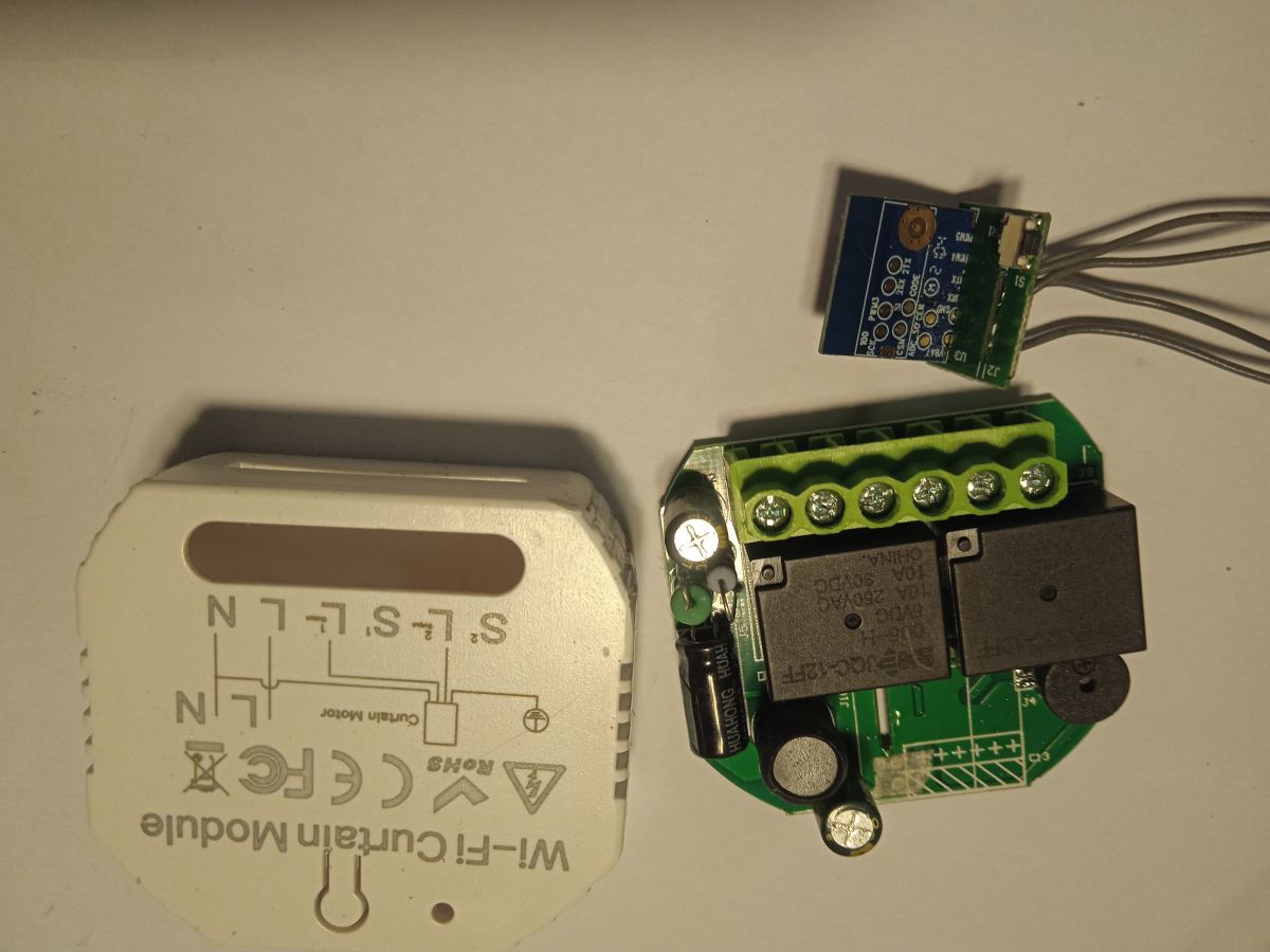

    I try to understand how it’s connected but it’s not so easy. It’s a roller shutter 2 buttons, 2 relays a buzzer, Wifi led and push button.
    There’s nothing on the “MCU” I don’t think it’s tuyamcu because there are only 16 pins
    I don’t have all photos because after flash I solder it again but if it works I have another one and I can do it.
    I configure as attached. The relay 2 works but the first one no Moes MS-108WR WB2S Curtain Switch Configuration: Roller Shutter MCU Help Needed Moes MS-108WR WB2S Curtain Switch Configuration: Roller Shutter MCU Help Needed Moes MS-108WR WB2S Curtain Switch Configuration: Roller Shutter MCU Help Needed Moes MS-108WR WB2S Curtain Switch Configuration: Roller Shutter MCU Help Needed

    Let's first get IO working, then we will worry about the driver. I may write one for you if that's needed.
    Do you have two buttons, each for each relay, on main page?
    Are you sure that you got the pin mapping right? Maybe relay is on the another pin?

    Yes I have 2 buttons
    I’m not sure about anything. I’m just trying to figure it out

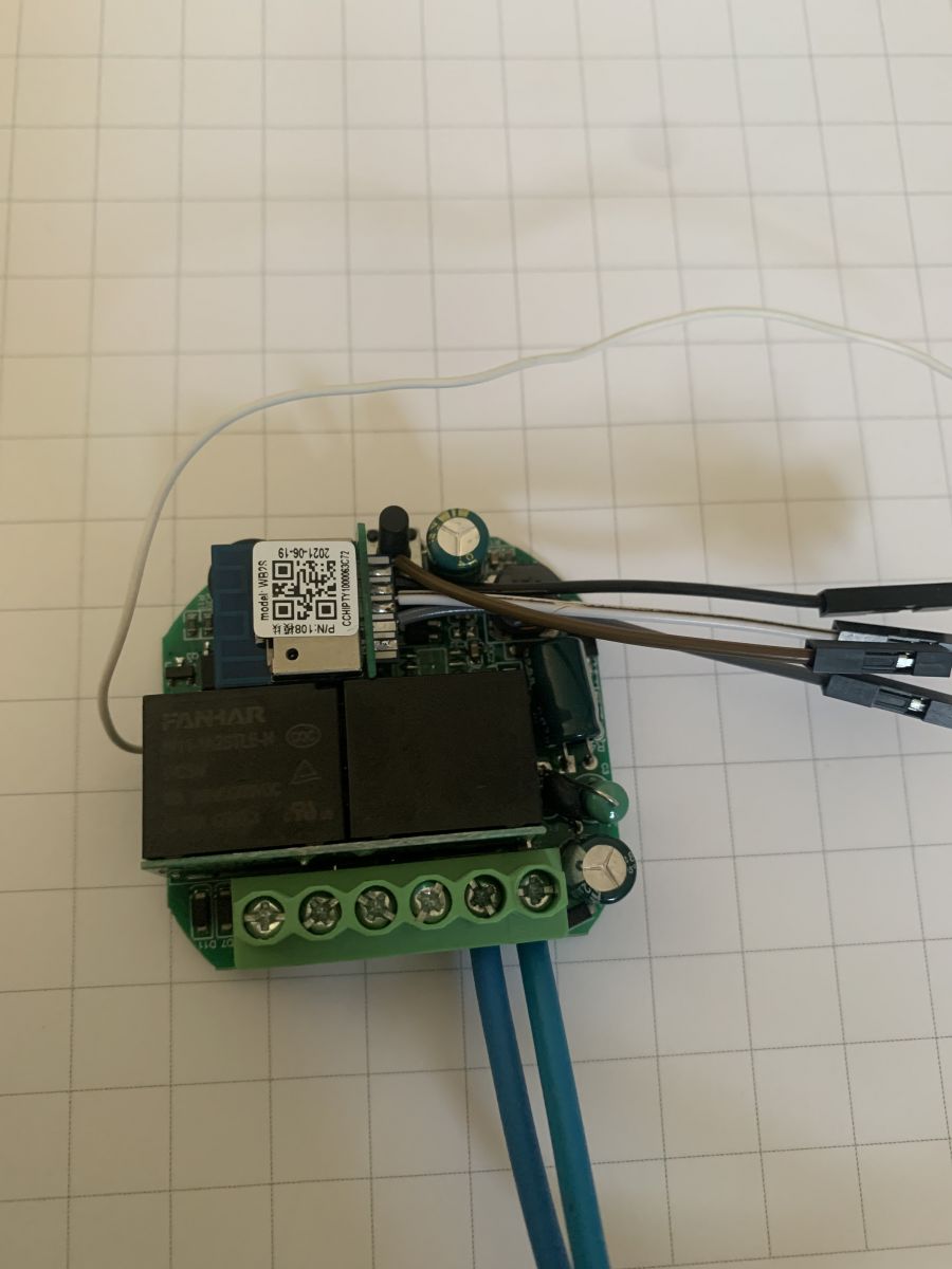

    I tried with the tester and I see that when buttons are on on the app pwm4 and pwm5 are on but it could be that it’s the wrong map
    It’s difficult to follow the paths on the circuit

    Okay then can you just check each pin one by one in OpenBeken? Just set Relay role and see if it clicks? Then set relay role for next pin, etc etc.... easy to do.

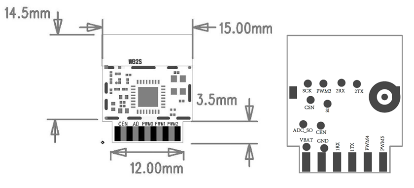

    Here are the pins that are routed on the WB2S:
    Thats not much, just a few pins, you can try them one by one

    First of all, take a look here:
    TXD2, also called 2TX, is on the back of the module. It's a test pad. It is most certainly NOT used for any IO control in your device.
    Why are you trying to change role for a pin that's clearly not used in your device?

    The problem is that I removed WB2S from the board because TX or RX was not connected and it was inaccessible so I just disordered flash and soldered again. Now it’s difficult to see the pads
    I tried P0 because I tried other pins and relay 1 never triggered. It could be also that the device doesn’t work properly otherwise I don’t understand why it never triggers.

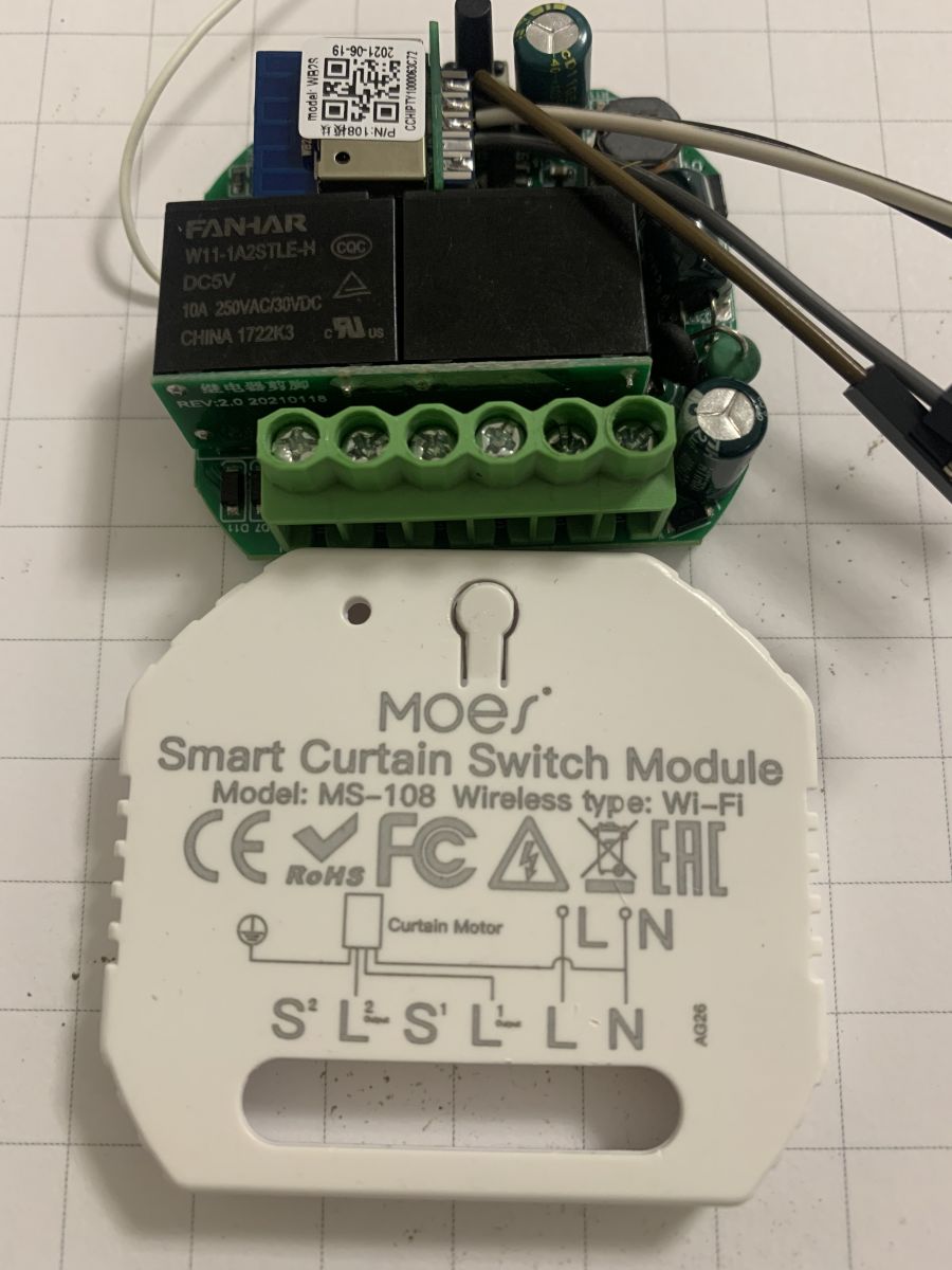

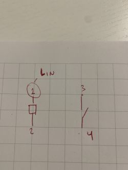

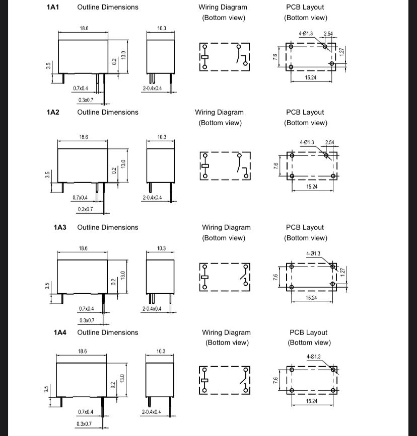

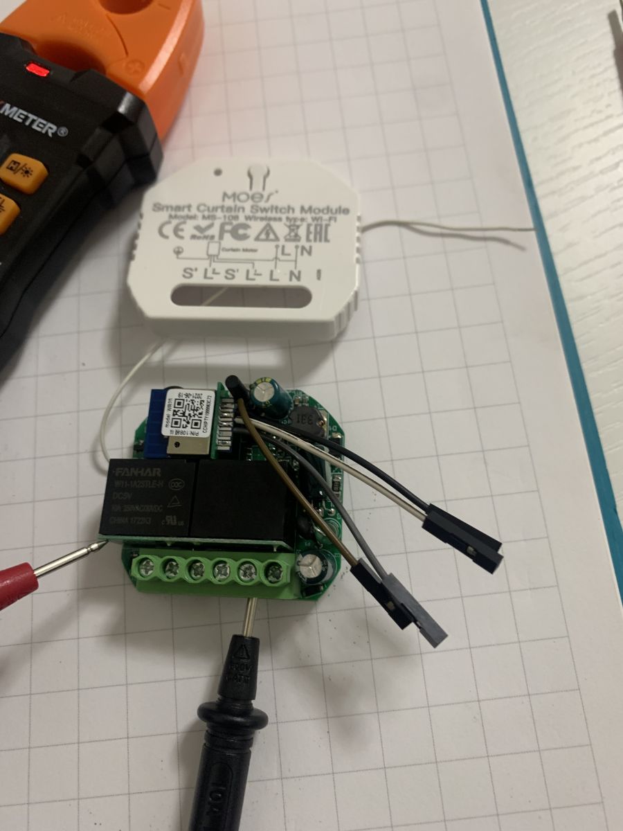

    I try to investigate the module
    I start from relay but there’s something that I don’t understand
    The relay is W11-1A2STLE-H
    One of the pins of the coil is connected to main (line). The coil is 12v (I look at the data sheet) so why one of the pins of the coil is attached to the main ?
    Look : Moes MS-108WR WB2S Curtain Switch Configuration: Roller Shutter MCU Help Needed Moes MS-108WR WB2S Curtain Switch Configuration: Roller Shutter MCU Help Needed Moes MS-108WR WB2S Curtain Switch Configuration: Roller Shutter MCU Help Needed Moes MS-108WR WB2S Curtain Switch Configuration: Roller Shutter MCU Help Needed
    Added after 23 [minutes]:
    Connected pins are : Rx PW1 PW2 PW0 and Vbat GND PW5 PW4

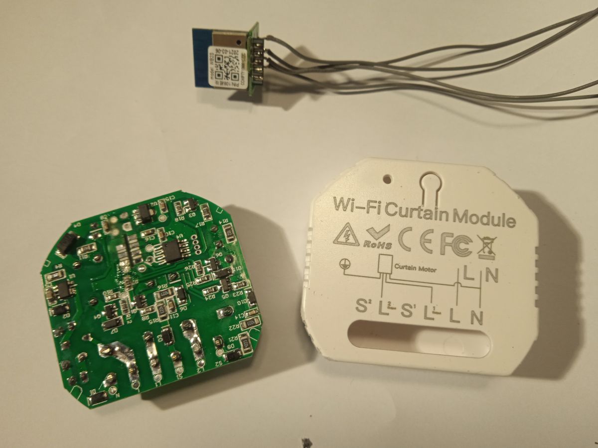

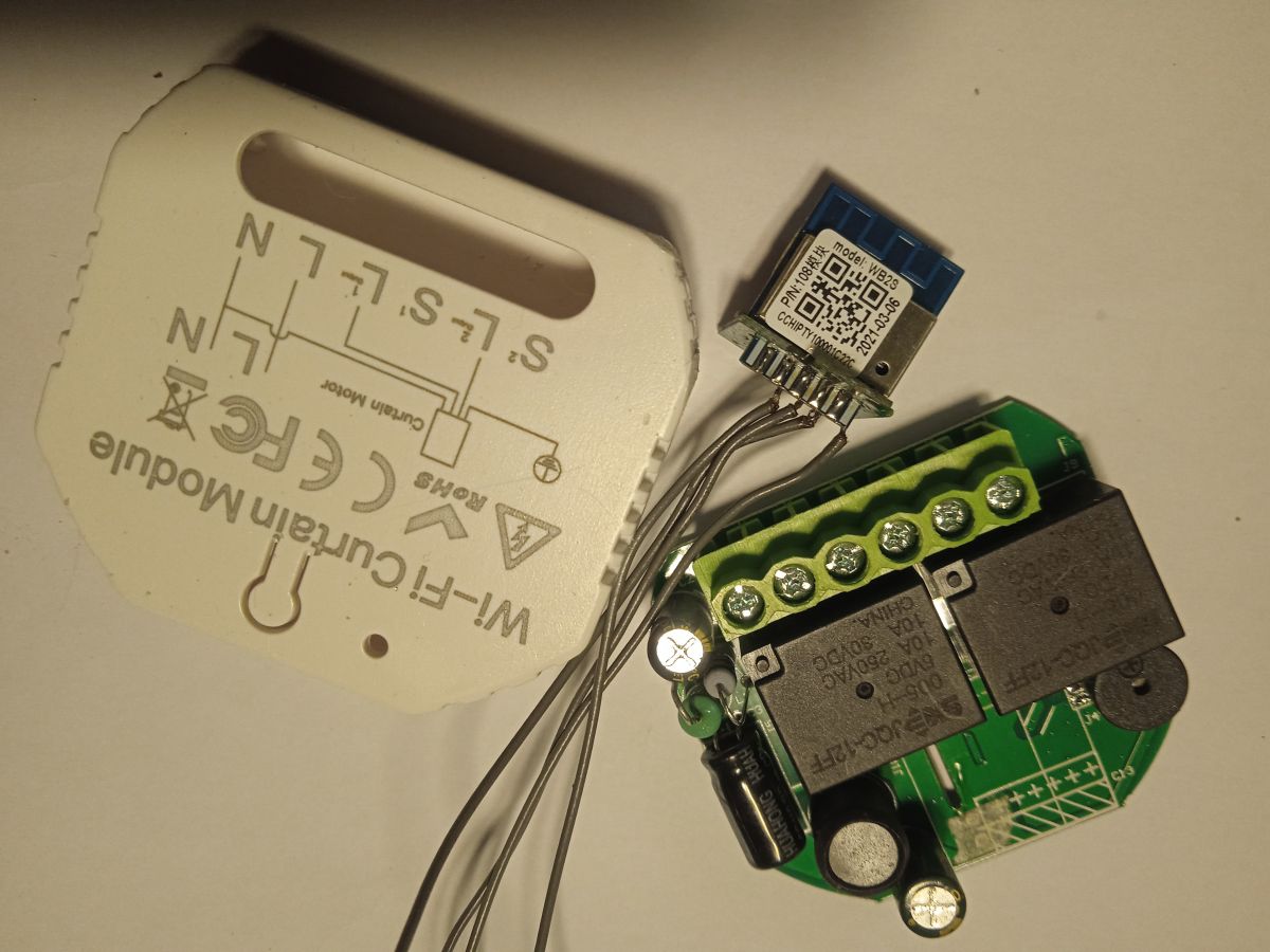

    I am changing the software in my Tuya devices one by one. The relays went without a problem but the temperature sensors and roller shutter controllers did not.
    I have two types of roller shutter controllers, the first one is the MS-108 Wi-Fi Curtain Module. I am attaching a photo and the content downloaded from bk7231t via bk7231flasher.
    Wojtek
    MS-108 Wi-Fi Curtain Module and electronic circuit board. MS-108 Wi-Fi curtain control module with exposed circuit board and casing. MS-108 Wi-Fi curtain control module with circuit board and electronic module. Close-up of a circuit board showing an electronic component labeled U4.

    Cloudcutter as I read it is pulling the configuration and key from the Tuya devices and then disconnecting from the Tuya cloud. As HA warns that they will soon end support for Local Tuya so I am converting what I can to MQTT.
    1 I initially replaced the WB2S with an ESP-02S from Tasmota. It works but in HA it shows up as a normal dual relay module. It has the ability to switch on both relays at the same time and I don't really know how to calibrate the motor timing.
    2 The UART converters have arrived and I have reprogrammed the WB2S to OBK. I copied the json from cloudcutter and imported via the WEB application. It works in a similar way to Tasmota i.e. I have three buttons first and third for control - I can control the operation of the relays independently with them. The second is probably reset but it doesn't work as the LED doesn't light up either.
    Configuration after import:
      "vendor": "Tuya",
      "bDetailed": "0",
      "chip": "BK7231T",
      "board": "TODO",
      "flags": "1024",
      "keywords": [
        "TODO",
        "TODO",
        "TODO"
      "pins": {
        "6": "Btn;2",
        "7": "Btn;1",
        "8": "Btn;3",
        "10": "WifiLED_n;0",
        "24": "Rel;3",
        "26": "Rel;1"
      "command": "",
    What do I need to do to exclude both relays switching on at the same time? Buttons cannot be used because the roller shutter switches exclude the possibility of both relays being switched on even if they are pressed at the same time - but in HA this is already possible. How do I configure the operating time? And how do I make the HA see the roller shutter controller and not the double relay?
    Greetings
    Wojtek
    edit.
    A lot of searching around OBK topics but I managed thanks to the description and advice from this topic:
    https://www.elektroda.com/rtvforum/topic4015497.html#20910126
    - this controller I already have reprogrammed you can see it in HA the only problem is the double click of the relay when controlling the buttons - this will double exploit the contacts themselves. Unfortunately it is still possible to switch on both relays at the same time from the web as well as the HA. It's a shame that there isn't a feature like in Tasmota that secures this when configured as a roller shutter controller. It is also a problem when editing autoexec via WebApplication after clicking "Save, run file...". also both relays switch on. It is safer to save the file and do a restart.
    I still just need to figure out the calibration.
