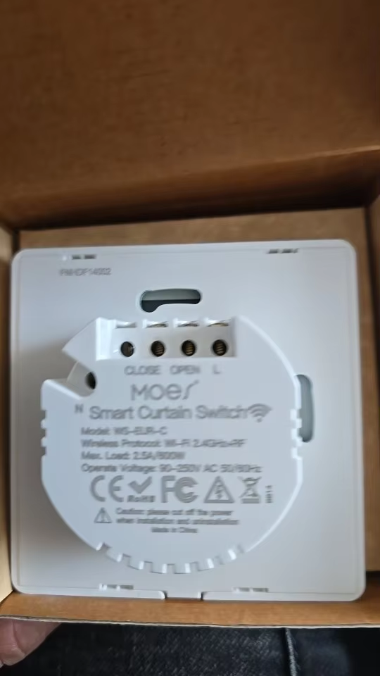

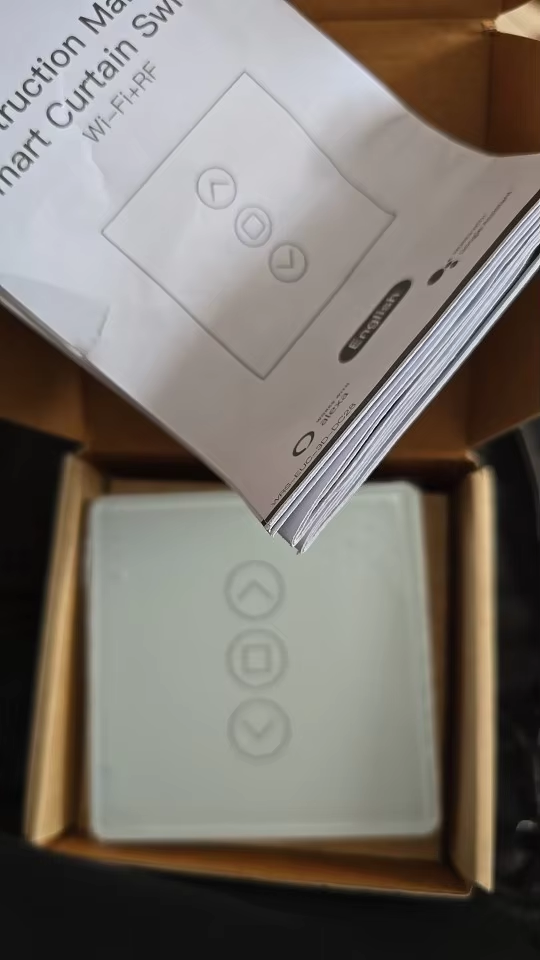

    The MOES WRS-EUC-3D Smart Curtain switch ( this little fellow) is working with a CB2S module and uses TuyaMCU.
    Box of MOES smart curtain switch with Alexa and Google Assistant logos. MOES WRS-EUC-3D Smart Curtain Switch with instruction manual in box. White smart curtain switch MOES WRS-EUC-3D in a cardboard box.

    The CB2S must be desoldered in order to program.
    Flag config: 7,19,43,50 set to 1
