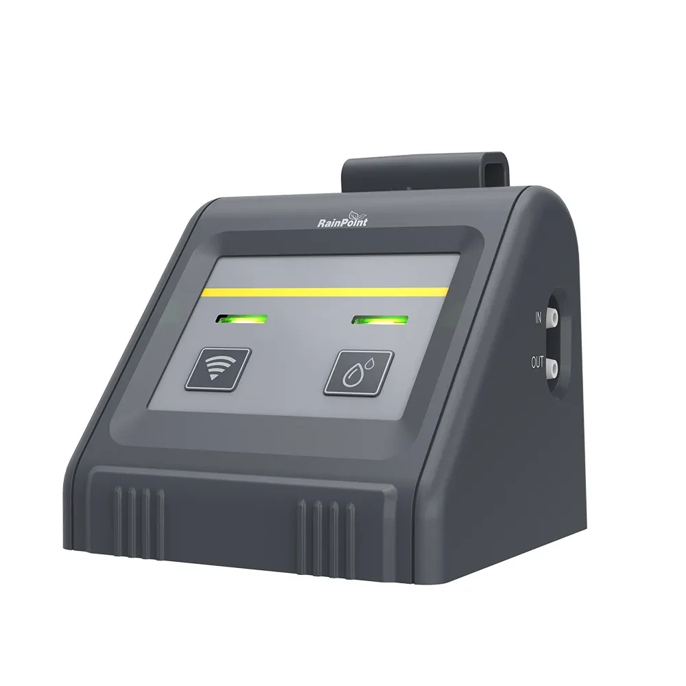

    Tuya RainPoint Indoor Water Pump (TTP106W) with CB3S Module Successfully Flashed with OpenBeken 1.18.145
    Semi-Success: Tuya RainPoint TTP106W Indoor Water Pump/Irrigation with CB3S Module and OpenBeken
    This thing comes with a bunch of tubes and I connect it to a 20 liter tank for watering while away on vacation. The RainPoint app sucks and I was hoping to configure a better system that could water at the same time every day instead of only X hours from me configuring it at that moment. The problem is if I want it to water at 5 am every 48 hours, I better configure it at 5am. Anyway...we'll see how far I get with that..
    Enclosure is easy to open and I was able to flash it using UART by holding the TX/RX directly on the module with my steady fingers(no soldering!) with thanks to the following:

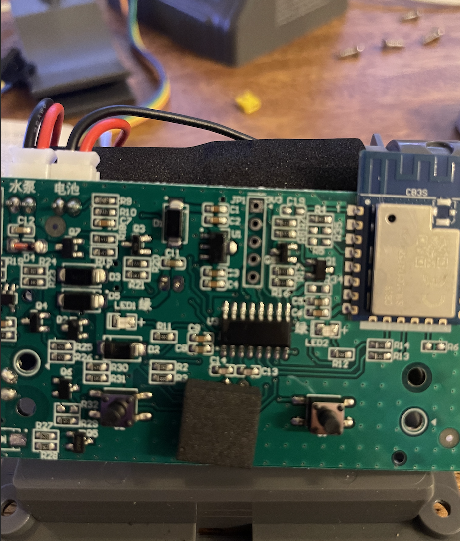

    When I set off on this journey, I didn't realize there was a separate MCU that interfaces with the CB3S module. I thought it was odd that the physical button still turned the pump on and off.
    Now I've learned a bit about what the TuyaMCU is and how we need to load the driver and create a autoexec.bat with channel mappings.
    Basically the TuyaMCU controls the pump and is the only controller doing anything when running only on batteries. (when the USB cable is plugged in, the Wifi module is awake and can give commands/program the MCU).

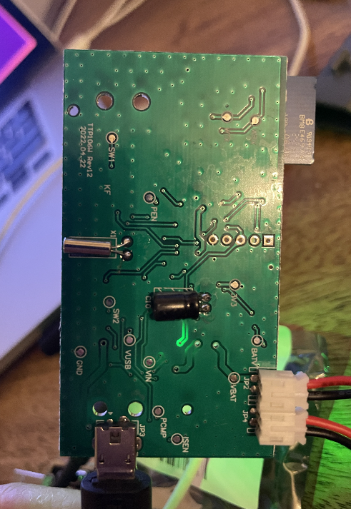

    FYI, the back of my PCB board says "TTP106W Rev12" with a date of 2022.04.22

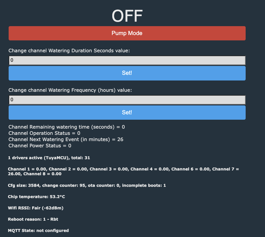

    I have enabled the following flags: 31, 37, and 51 ( still have to learn what the other various TuyaMCU-specific flags are supposed to do)
    Can switch on the pump from the webpage and see/change some values. Seems like it doesn't populate the value after a restart though...not sure what that's about..
    EDIT: fixed it by using the dpCache and some SetStartValue 2 -1 // set it to last remembered between reboots
    Anyhow, I'm far enough along that I thought I could share my autoexec.bat and await some critique..

    Here are some photos of the internals.
    Close-up of a green PCB with a C3S module and various electronic components
    Green PCB with micro USB and power cables connected
    I do have a backup of the original firmware. I think I had tried some of the tools to decipher what was in there and it looked like gloppity-gook in the hex viewer.

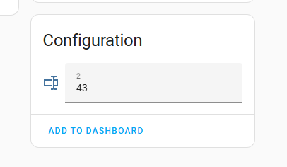

    I see.. let's start by adding text field to HA discovery. Can you help testing that?
    “Configuration” widget with numbers 2 and 43 and “ADD TO DASHBOARD” link
    Added to main, should be in release soon
    https://github.com/openshwprojects/OpenBK7231...mmit/6ae05de5600b7ad387dafc67c0253e1b58e74296
    PS: setStartValue 22 does not work because:
    define MAX_RETAIN_CHANNELS 12
  • #5 21630066
    alleywayapps
    Posts: 8
    Thanks for that hint - I moved from channel 22 to channel 11 and now works as expected.
