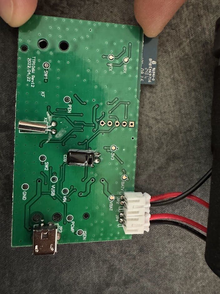

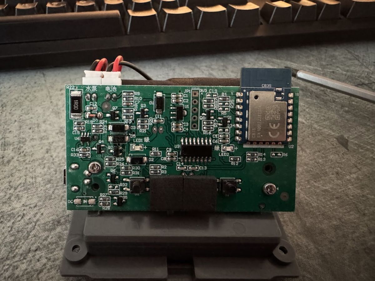

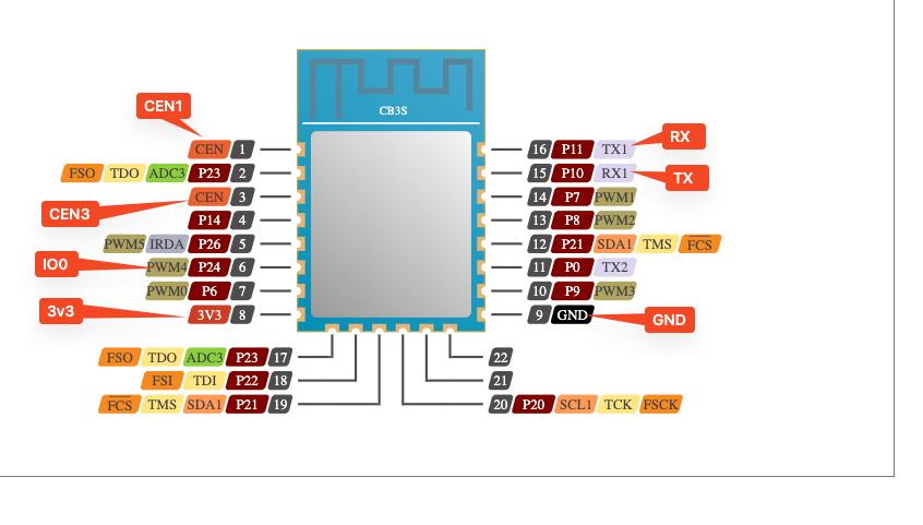

    I want to flash my RAINPOINT WiFi Automatic Watering System which uses CB3S chip with https://github.com/openshwprojects/BK7231GUIFlashTool by using CH340 board but I'm getting error - Getting bus failed.
    I believe I'm having problem with putting it in flash mode. I tried several methods like:
    - quick re-connect of 3v3 after I hit flash firmware button
    - quick connect both CEN1 or CEN2 pins to GND pin
    - quick connect pin 6 (IO0) to GND
    - tried all port speeds
    TX and RX are swapped, and I don't have any other idea what to do. Seems like I'm making obvious and simple mistake, but can't find it. I flashed many Sonoff and Shelly devices with Tasmota so I'm familiar how things work is basic simple way, but I can say I'm still beginner.
    Let me know what's the case here, please.
    This is how I did connect CB3S pins to my CH340 board.

    That's certainly an interesting device, I would like to get this running for you. Obviously, the first step is flashing, but as you already noticed, there is some issue.
    This is most likely because your device is using TuyaMCU and has extra MCU connected to CB3S via the same UART port which is used for flashing.
    Long story short, you will probably need to remove this MCU first or cut RX/TX traces or desolder CB3S or try to put MCU into the reset mode (if datasheet is available).

    Device can be powered by 4 AA batteries or can also be powered all the time through power adapter.
    I have tested TX and RX with multimeter to see if any connection exists towards the chip in the middle of picture, but none of the pins are connected.
    Any other proposal how to check?

    I did mine using minicom from Linux, setting baud rate to 9600
    Can you try just touching the RX of your UART device to the TX2 with nothing else connected, then plug the USB power to the RainPoint board?
    This just to make "first contact" - you should be able to see a bit of logging.

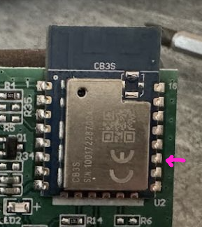

    I flashed mine simply by holding the leads to the module with steady hands...
    Close-up of the CB3S module on a circuit board with one pin marked by a pink arrow.[/img]

    I got this when I connected TX2 from Rainpoint board to RX on CH340 device. But I had to connect GND as well.
    I was using baud | 115200 8N1

    - https://templates.blakadder.com/rainpoint_TTP106W.html -> https://templates.blakadder.com/assets/device_images/rainpoint_TTP106W_pcb.webp
    Openbeken flashed with USB power and serial only

    Ah yes, you're right on the baud.
    I didn't need to do GND to RST. Not sure what IO0 is.
    I don't think I even connected 3v3. I only used GND, RX and TX while flashing and the power from USB.
    And it was either CEN1 or CEN3 that you have to do a short touch to from....somewhere...GND?
    Also...I did a backup of the orig firmware first. I did it twice out of paranoia.
    And then just do a straight write of Openbeken.
  • USB power and GND-to-RST enabled flashing CB3S
