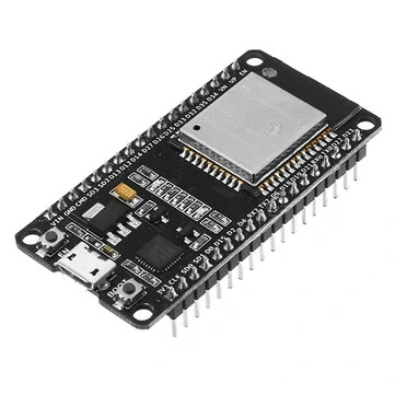

    Hi, do any of you have the original firmware for the GOSUND P1 ESP8265 strip, CUCO_Z0_V1.1? Unfortunately, but a surge went on the ESP and it died.
    Thanks in advance.
  • #2 21633862
    Posts: 14764
    Rate: 12898
    And what kind of ESP is there? TYWE2S? Maybe the flash chip is still alive and can be read from it? Do you have a CH341 programmer to try?
    And if not, you can try here, but we don't seem to have that batch:
    https://github.com/openshwprojects/FlashDumps/tree/main/IoT/ESP8266
    Added after 13 [seconds]: .
    ... and if not then Tasmota or Supla

  • #4 21742086
    Qba...
    Posts: 6
    Have you replaced the chip/will you be replacing it?
    I had the original soft somewhere, but couldn't find it quickly. On the other hand, I have the yaml and bin under ESPHome. Minimally changing the behaviour, but not in terms of basic functionality.

  • #12 21742230
    Posts: 14764
    Rate: 12898
    I haven't come across a locked device flash on the ESP8266, is there even such a thing? It's the ESP32 that is often locked, and then you have to replace the whole module.
    You can program with confidence, just be sure to make a full copy of the batch so you have a fallback option if something goes wrong.
