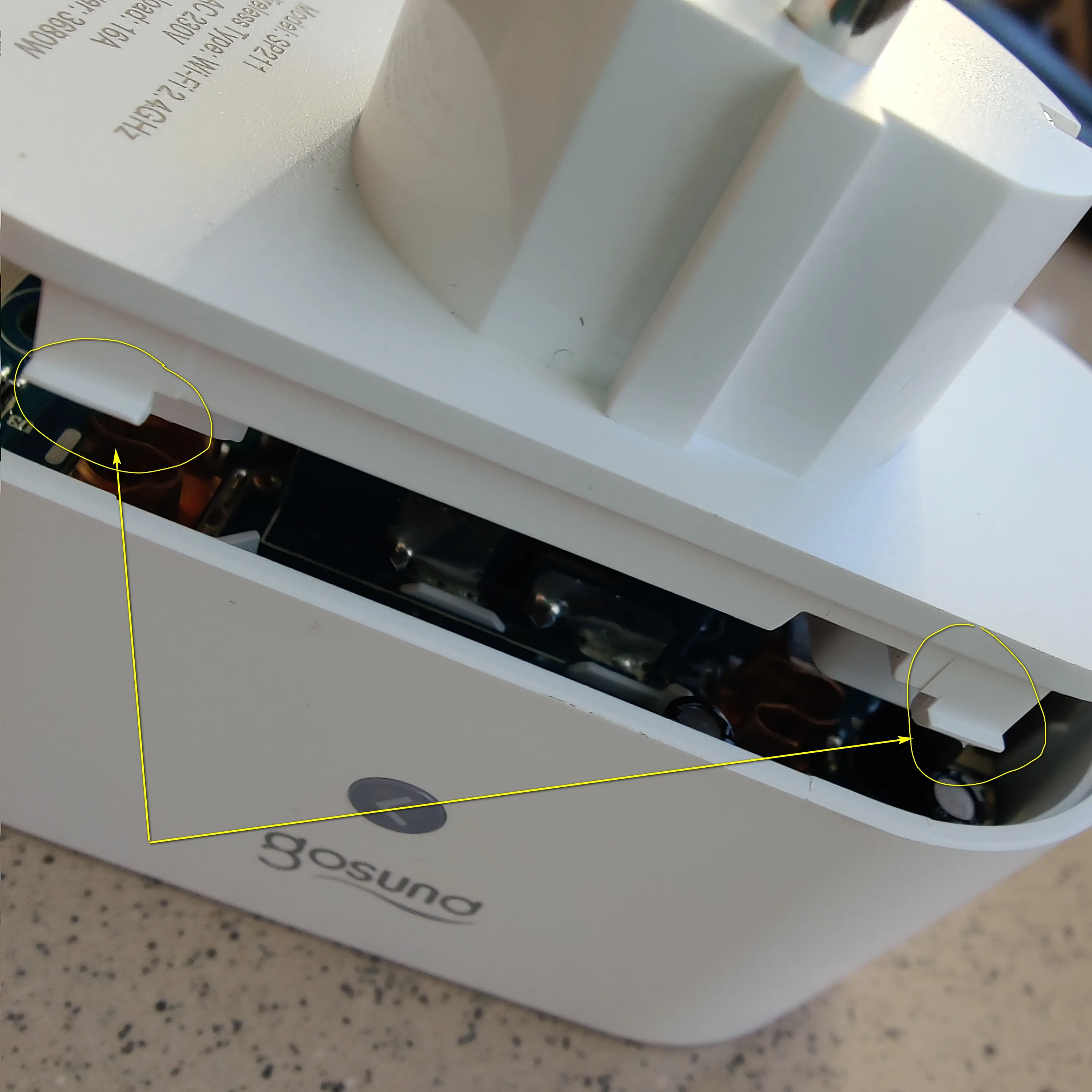

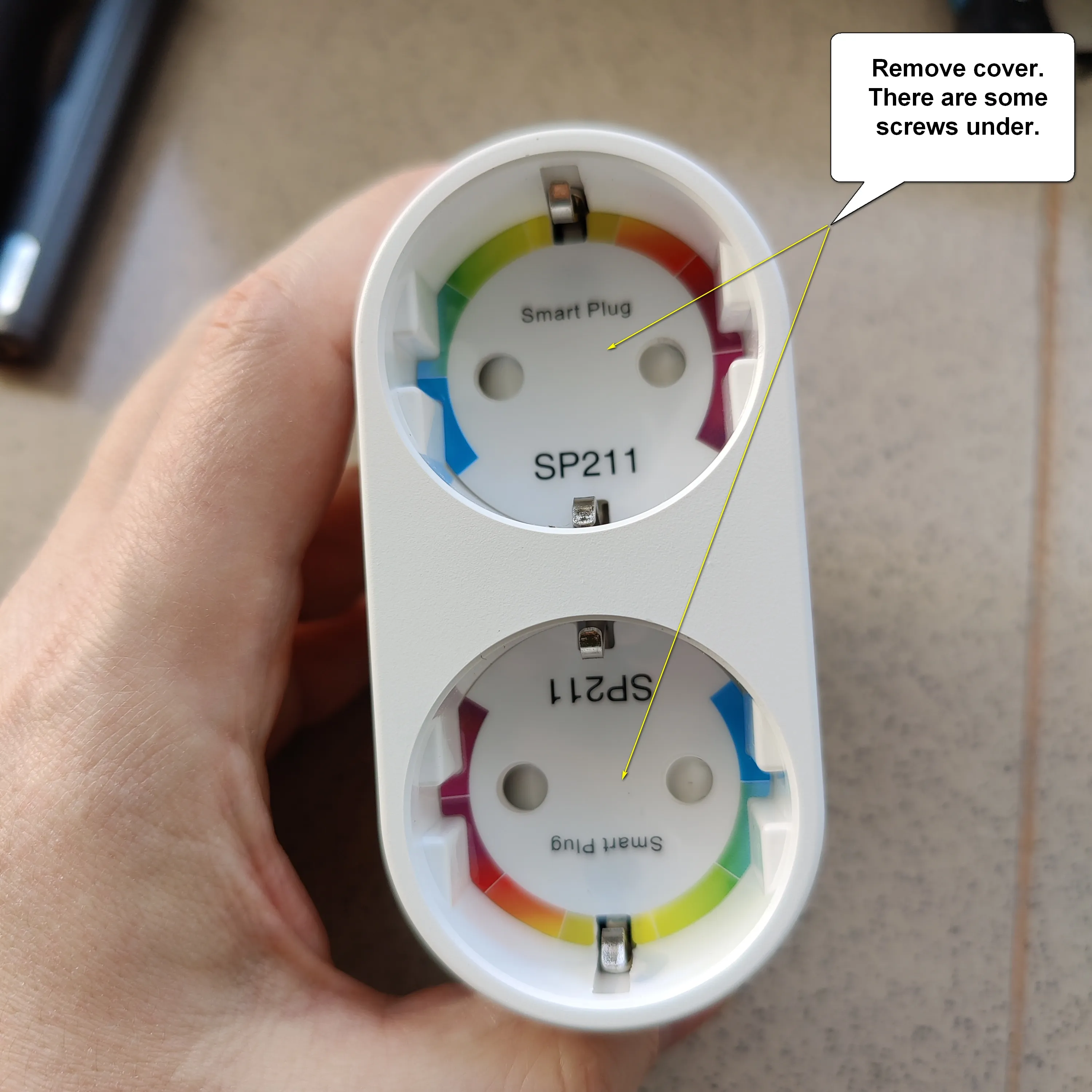

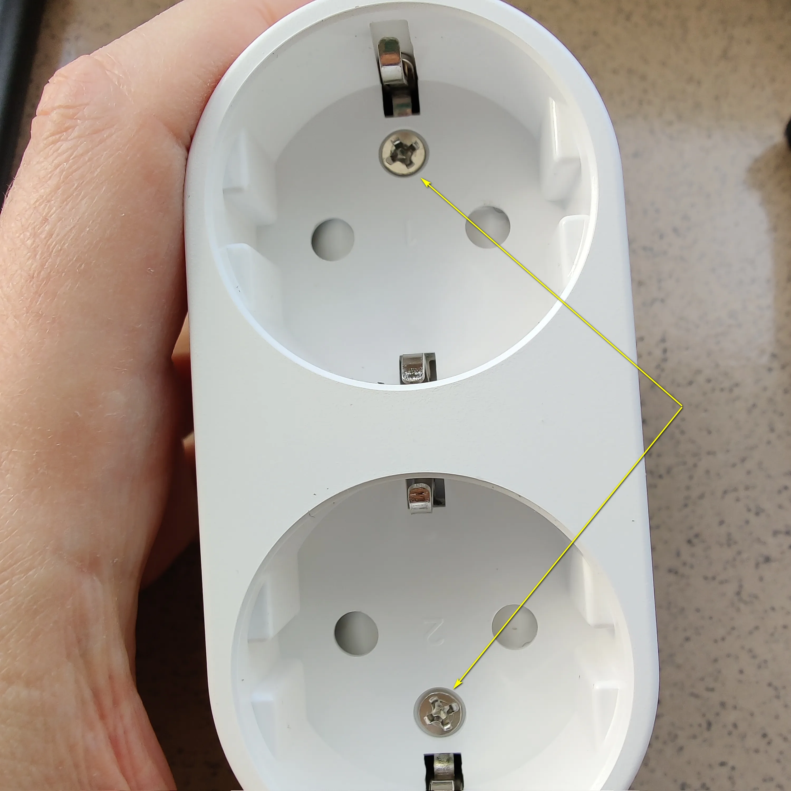

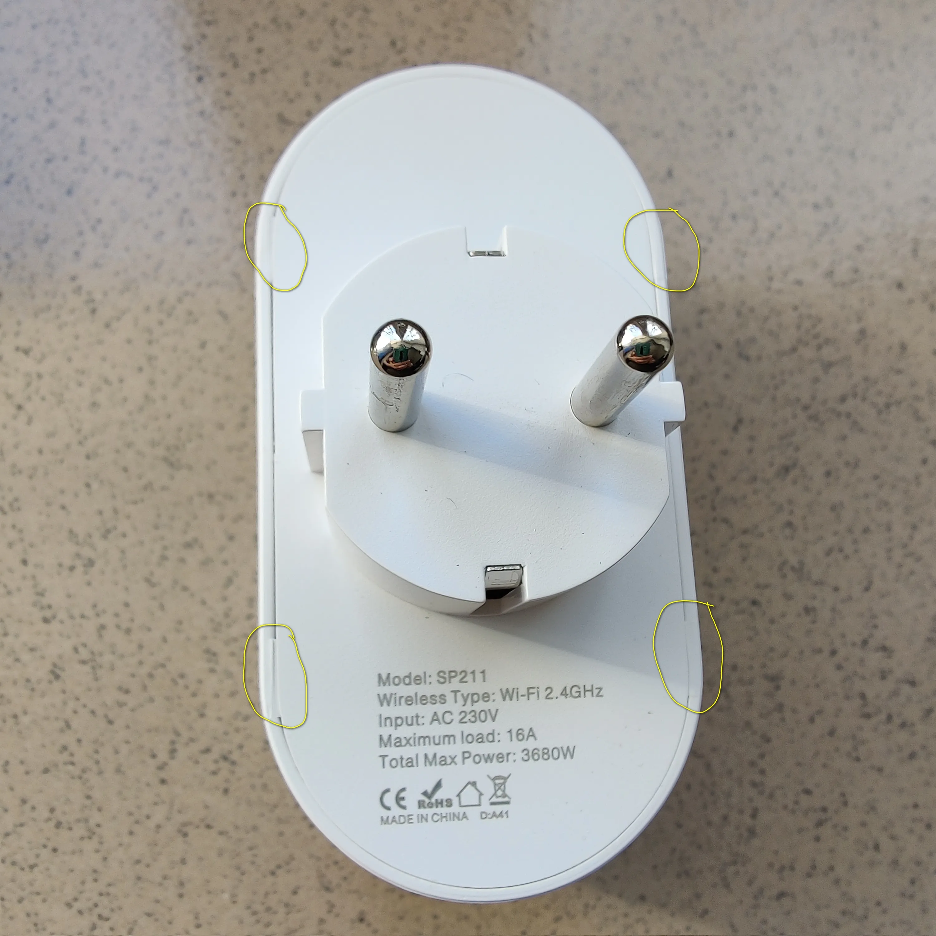

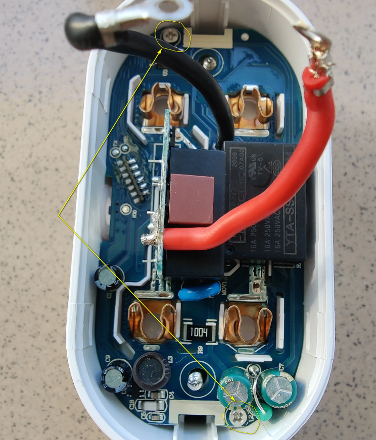

    simply the whole hardware did not changed that much with reference to what you guys can see here:
    https://templates.blakadder.com/gosund_SP211.html
    Smart plug SP211 in hand, with an annotation indicating the need to remove the cover to access screws.
    Close-up of two electrical sockets showing mounting screws.
    Gosund SP211 smart plug with highlighted case latches.
    Close-up of an open Gosund SP211 socket showing internal components. Interior of a smart plug showing the mainboard and attached wires.
    the opening process is already well described with all the necessary pictures in the link above.

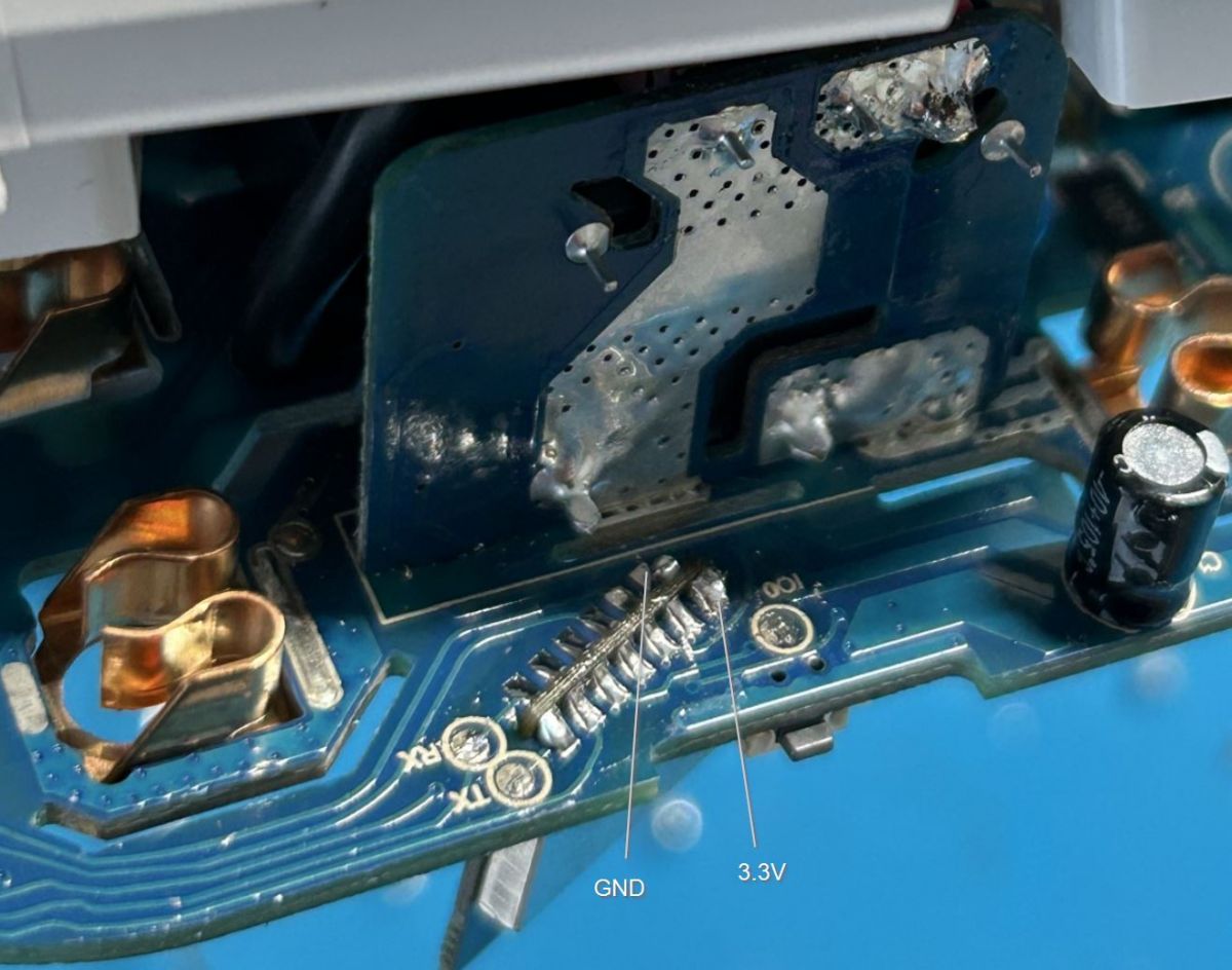

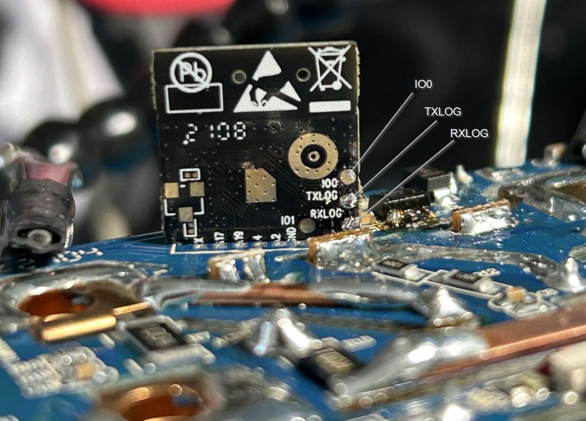

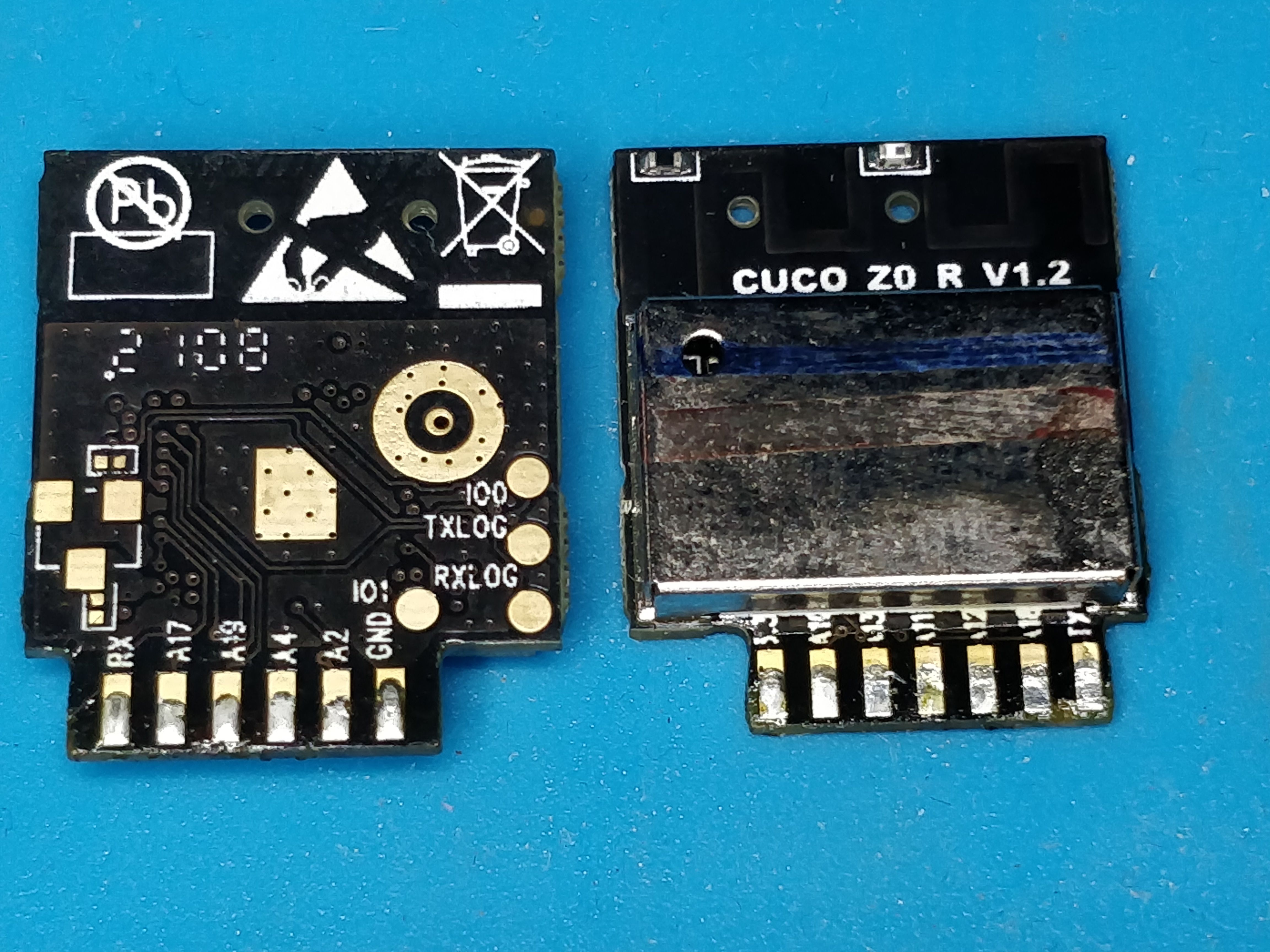

    Sorry for hijacking this thread. I recently purchased a couple of Gosund SP211 plugs and there appears to be multiple versions of the plug. At least in my case, the chip inside the plug was an RTL8720CF on a CUCO Z0 R V1.2 board (there is a good close up photo of the board available here):
    CUCO Z0 R V1.2 electronic module mounted on a circuit board.
    To flash OBK, I connected wires to three pads on the back of the module: IO0, TXLOG, and RXLOG:
    Close-up of an electronic chip attached to a circuit board with connection labels.
    Additionally, I connected wires to the GND and 3.3V pins on the bottom of the board:
    Close-up of electronic components on a circuit board with labeled GND and 3.3V points.
    TXLOG should be connected to RX on the USB to UART adapter, and RXLOG to TX.
    To put the chip into flash mode, connect IO0 to 3.3V during power-up.
    I read the existing firmware using LTChipTool, but I encountered an error when attempting to flash OBK. To resolve this, I switched to the AmebaZ2 PG Tool, which worked successfully. (More info about how to flash RTL8720CF chips can be found in this thread)
