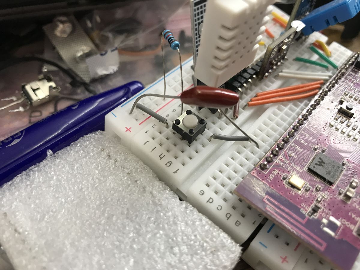

  • 100 nF capacitor debounces switch contact bounce
    #34 21642249
    Posts: 14771
    Rate: 12914
    How much bouncy? For me, on W800, it was adding sometimes 1, sometimes 3, etc, sometimes 5.
    I solved it with a capacitor - just like we debounce buttons, with a capacitor. 100nF one connected between pin and ground. It removes tiny "bouncing" of switch contact, so it removes "ghost edge transitions" that happen due to the switch imperfections.
    Now, each press adds 1.

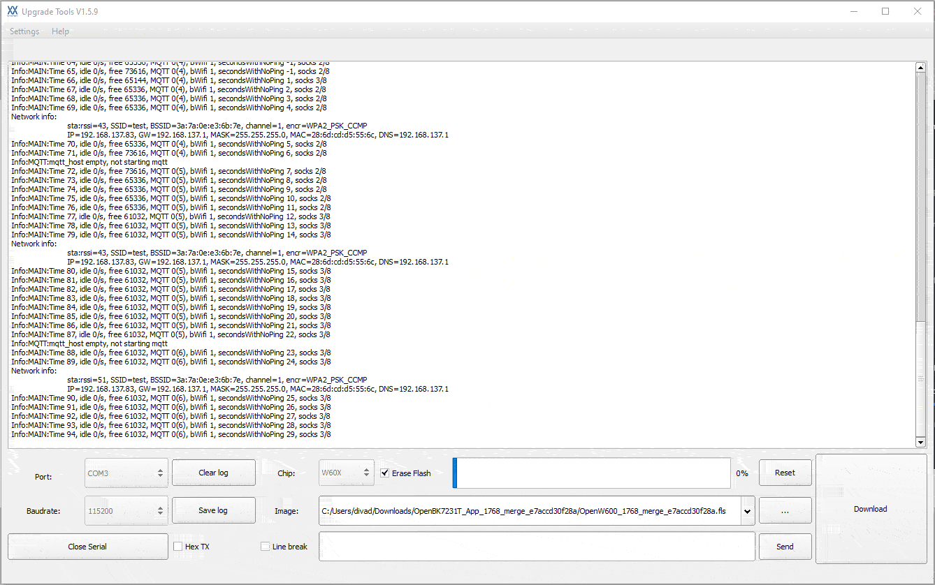

    this kind of bouncy
    Upgrade Tools window showing Wi-Fi logs and firmware flashing options for a W60X chip.
    no, no resistors or capacitors. so maybe I ignore bouncy because it would be OK on real device. all that matters for this test is the counting and no crash?

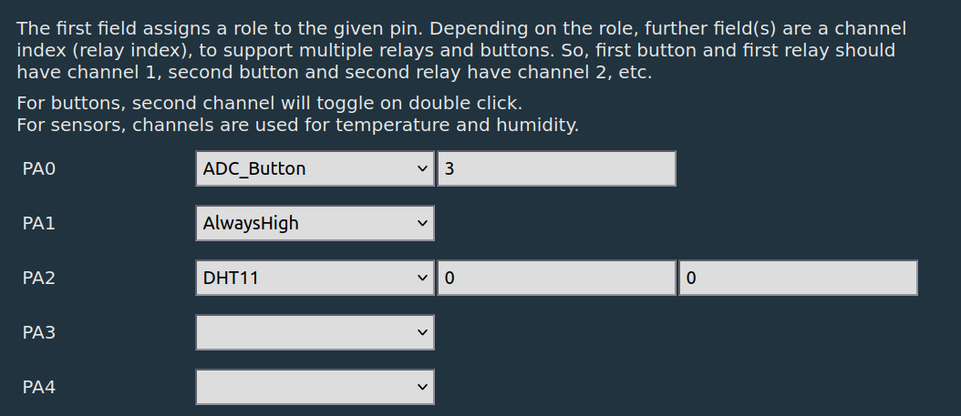

  • Binary size impact of pin channel descriptions
    #38 21642359
    max4elektroda
    Posts: 758
    Help: 49
    Rate: 189
    But that's the one that increased binary size?
    https://github.com/MaxineMuster/OpenBK7231T_App/actions/runs/17175436952
    For most platforms it's less or same size, some are slightly larger, max 64 bytes (see below - I filtered out all with same size)
    The W800 gives an idea, how much it will increase with the additional information on channels and (that's just a wip state) filtering out unconfigured pins.
    This is also included in Windows simulator so it can be tested without flashing ...
    There are two small changes at the moment even without "#define ENABLE_USE_PINROLE_CHAN_DESC":
    I changed (hopefully improved) the text on the page a bit (maybe @divadiow can tell if it's understandable and maybe correct or really improve it ;-)).
    Pin role dropdown and channel input field with explanatory English text
    And unconfigured pins or roles without any channels won't show a channel at all:
    Screenshot of pin configuration interface with assigned roles and channels

    Sorry @divadiow, I was not clear.
    I meant if you could comment the second text
    The first field assigns a role to the given pin. Depending on the role, further field(s) are a channel index (relay index), to support multiple relays and buttons.
    So, first button and first relay should have channel 1, second button and second relay have channel 2, etc.
    For buttons, second channel will toggle on double click.
    For sensors, channels are used for temperature and humidity.

Why does my counter increase constantly with nothing pressed?
A floating input sees noise and triggers edges. The maintainer explains that, before the change, pins without pull resistors would count rapidly. Counter inputs now default to pull‑up to stop spurious counts. Use a proper resistor or cap when testing. [Elektroda, p.kaczmarek2, post #21642139]
How do I wire a push button for stable counts?
Use the default pull‑up, connect the button between the GPIO and GND, and add a 100 nF capacitor to GND for debounce. A 10 kΩ pull‑up improved stability on W800; “Now, each press adds 1.” This mirrors classic hardware debounce practice. [Elektroda, p.kaczmarek2, post #21641962]

  1. Pick a GPIO with a user button and set role to Counter_f.
  2. Leave default pull‑up, wire the button to GND, add 100 nF to GND.
  3. Press and watch logs; each press should add exactly one. [Elektroda, p.kaczmarek2, post #21641962]
