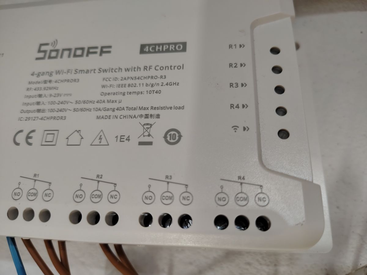

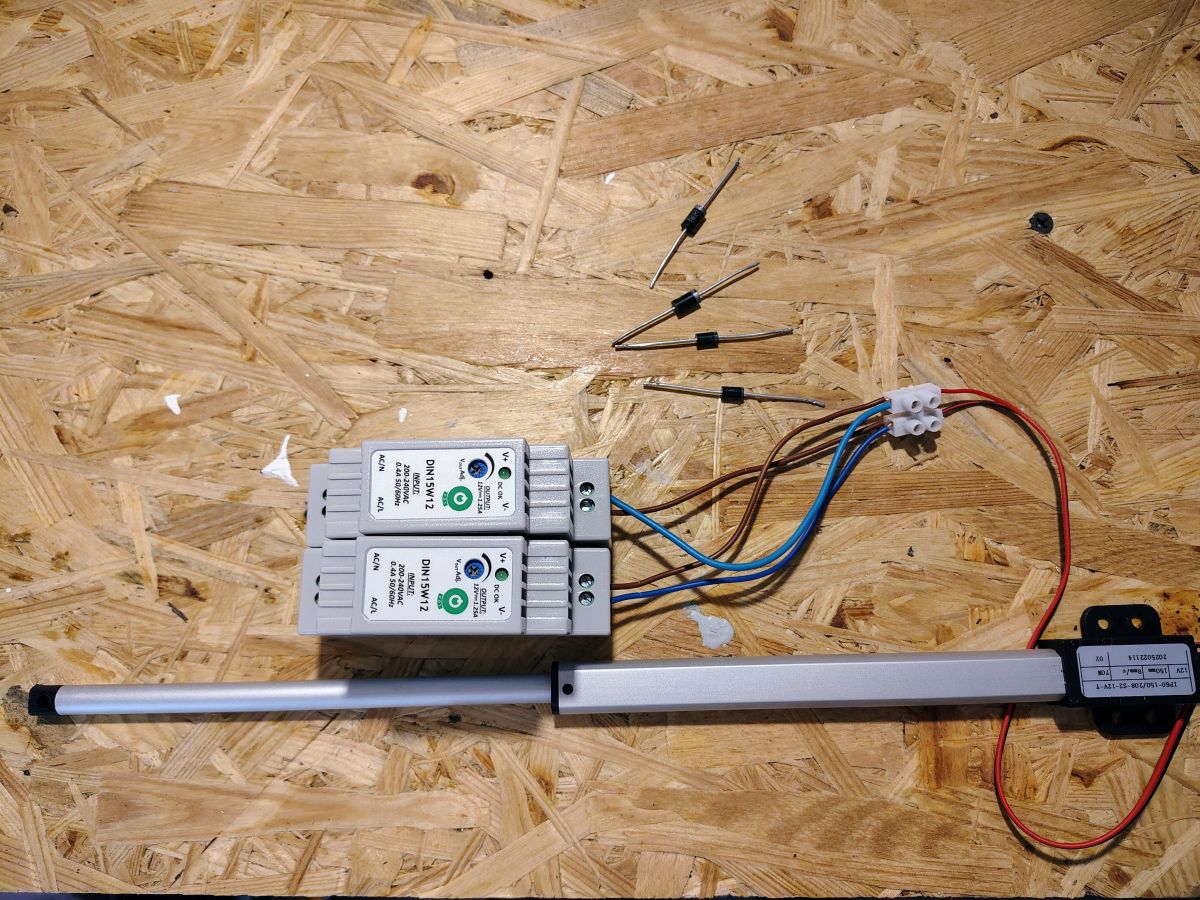

    Hi, Good afternoon.
    Could you please direct me how to connect a 12 volt actuator to two 12 volt power supplies so that the control is based on the principle of actuating alternating power supplies with opposite polarity, via a 230 volt NO/NC relay. Someone told me that I should use rectifier diodes, unfortunately either this is the wrong hint or I am wiring these diodes wrong. Or should I use a completely different solution? In this connection as in the pictures the power supplies at the output make a short circuit, because the voltage from one powered supply seems to bridge on the other unpowered supply.... I'm not an electronics engineer, I don't know, I just want the actuator to close or open when it gets a signal from a temperature sensor that works with a 230V relay.
    Power supplies 12 V, 1.25 A.
    Rectifier diodes - 5 A sb5200 ssg25043.
    Actuator 12 V, current consumption unknown, but these power supplies will quietly power this actuator as I connect "makeshift".
    I don't necessarily have to use these power supplies, I can give them away, there may be another solution, as long as not some expensive one.
    Close-up of a Sonoff 4CHPRO R3 relay panel showing R1–R4 terminals with NO, COM, and NC labels
    Two 12V power supplies, linear actuator, and rectifier diodes on wooden surface. .

    One power supply can be used why two?
  • #3 21697217
    szczudlo
    Posts: 16
    78db78 wrote:
    You can use one power supply why two?
    That's why I'm asking how to wire it up - the less unnecessary hardware, the better. I'd like it to work properly, but I don't know how to figure out what to use.

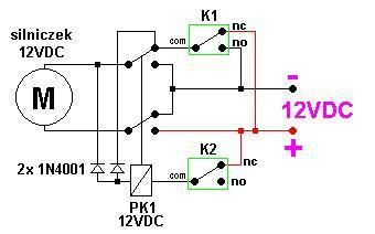

    Electrical diagram with relay K reversing rotation of 12VDC motor
    Applying voltage to relay K changes the direction of rotation.

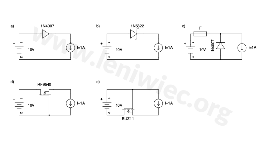

    If I don't know everything inside the power supply and the load is inductive, I use a diode on the output.
    Some kind of protection should be inside the power supply, but if I can't see what kind then maybe I'm duplicating it, a diode is not a fortune.

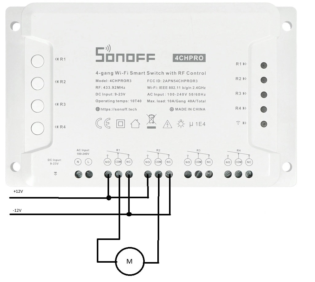

    This Sonoff module has 4 relays with NO-COM-NC switched contacts.
    Using two channels (e.g. 1 and 2), you can control the motor in two directions.
    Connect +12 V from the power supply to NO (1) and NO (2).
    Connect -12 V from the power supply to NC (1) and NC (2).
    Connect the motor to COM (1) and COM (2).
    Connecting two 12 V power supplies to one 12 V actuator - how do I do it?Przekaz...jpg (126.41 kB)You must be logged in to download this attachment.
    If the motor draws less than 10 A, it should work, because that is the strength of the Sonoff contacts according to its technical data. The power supply draws less, so the motor will not draw more.

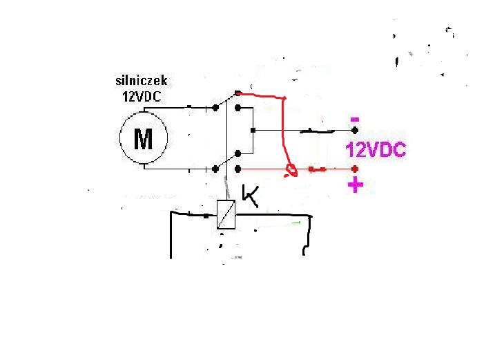

    Wiring diagram with 12VDC motor, relay PK1, and limit switches K1 and K2
    K1, K2 extremities.

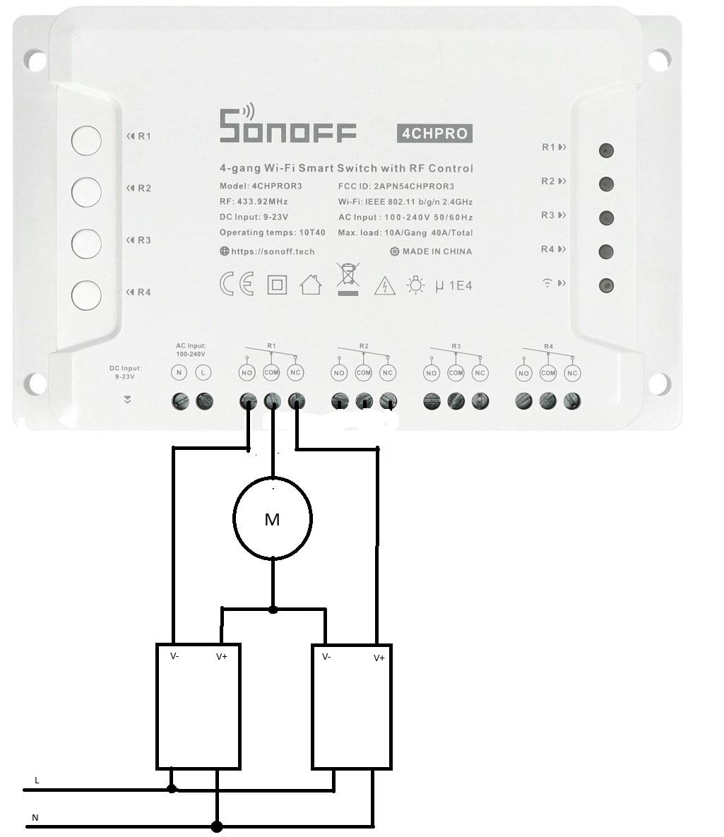

    Let's perhaps establish this further:
    - an actuator powered by a single power supply operates normally, and the problem lies only in controlling the direction of rotation by changing the polarity of the power supply to the actuator,
    - the actuator has built-in limit switches and when it reaches the end it stops, without drawing power from the power supply (and without overheating the motor).
    If 2x YES, you can use one NO-COM-NC contact from the Sonoff to change direction, but leave two power supplies.
    This will be a circuit similar in principle of operation to the output of an acoustic amplifier supplied with a symmetrical voltage.
    szczudlo wrote:
    There is a phase on the NC terminal
    There will only be a phase on either the NC or NO terminal if you connect it to COM, and you don't have to do that. The Sonoff itself doesn't give phase there.
    In the proposed arrangement, we connect the power supplies permanently to 230 V AC, and connect their outputs in series - the V+ of one connects to the V- of the other. We connect one actuator wire to this point.
    We connect the V- of the first to the NO terminal of the Sonoff and the V+ of the second to the NC terminal. We connect the COM terminal to the second motor lead - end.
    Connecting two 12 V power supplies to one 12 V actuator - how do I do it?Przekazn..2.jpg (140.02 kB)You must be logged in to download this attachment.
  • No short at the series supply midpoint

    This is quite an interesting solution, I will test it tomorrow and let you know how it works. Just won't there be a problem at the point where V- meets V+ from the different power supplies? Won't there be some kind of short circuit there?
    Series connection safe if outputs remain isolated
    #14 21699125
    stachu_l
    Posts: 2996
    Help: 480
    Rate: 1131
    szczudlo wrote:
    Only, won't there be a problem at the point where V- meets V+ from different power supplies? Won't there be some kind of short circuit there?
    The power supplies do not have a PE connector and rather for user safety reasons have galvanic isolation of the I/O so their outputs are not internally connected and can be treated as separate voltage sources. If you can connect batteries in series (voltage two 12 V batteries to make 24 V) then these power supplies can also be connected in series. Until you short these second V+ and V- terminals there will be no short circuit. I assume that the Sonoff has a switched contact which never connects NC and NO together. If such a moment occurs when switching then there will be a momentary short circuit.

    Thanks a lot, you have helped to solve the problem. With the help of your schematic the actuator works as I expected. Thank you again.
    Added after 4 [hours] 53 [minutes]:
    Actuator already mounted in the target location, everything works perfectly controlled by two 12v power supplies connected according to the schematic sent by stachu_I big thanks Stach.
    Big thanks also to user Dioda52 who took his time in private messages, solved the problem in different ways.
    Thanks also to everyone else for their willingness to help.
