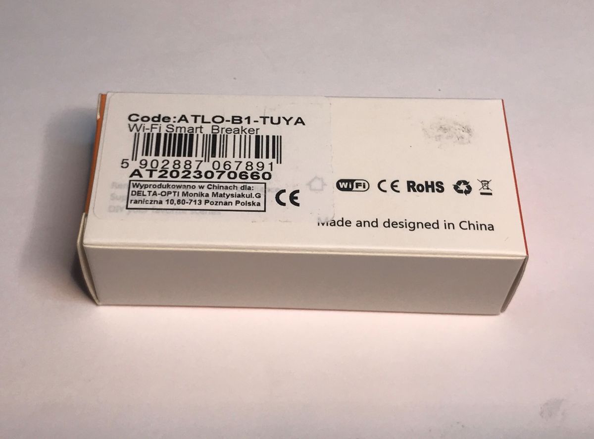

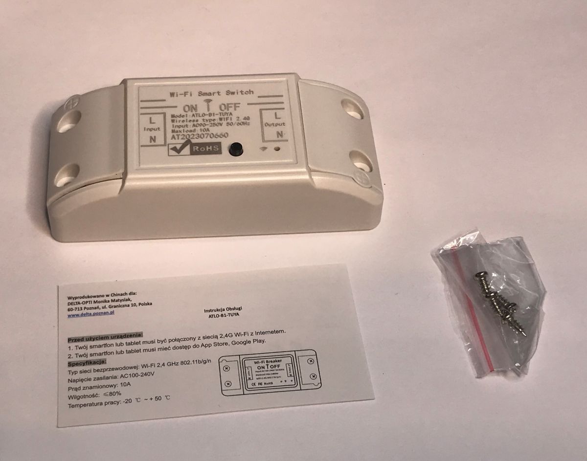

    Let's start with the packaging, the unit shown here I had from a reader, I changed the firmware for him on request throughout the set of devices.
    Box of WiFi Smart Switch for remote control. .
    Packaging of ATLO-B1-Tuya Wi-Fi relay. .
    You can see that the equipment was bought in our country, probably for a few tens of zlotys, although it would have been cheaper from China.
    Contents - they even gave screws for fixing:
    White Wi-Fi Smart Switch with instructions and a bag of screws. .
    Leaflet with user manual for ATLO-B1-Tuya WiFi relay. .
    Instruction card with ecological labels and certifications. .

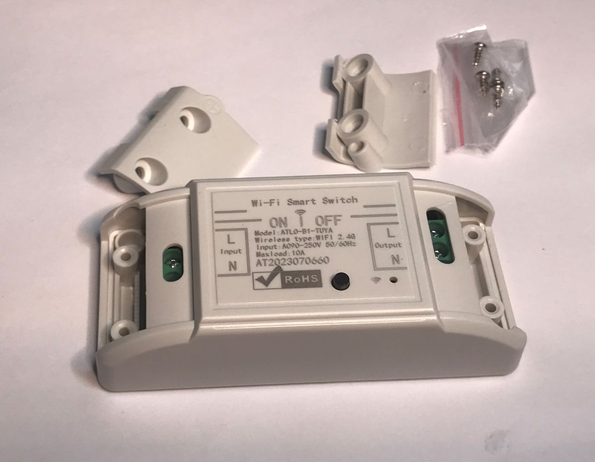

    Test with Tuya I skip, it's time to look inside and change the firmware.

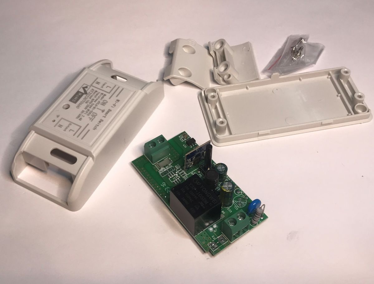

    White WiFi Smart Switch model ATLO-B1-Tuya with open casing parts. .
    Disassembled WiFi relay housing with visible PCB and accessories. .

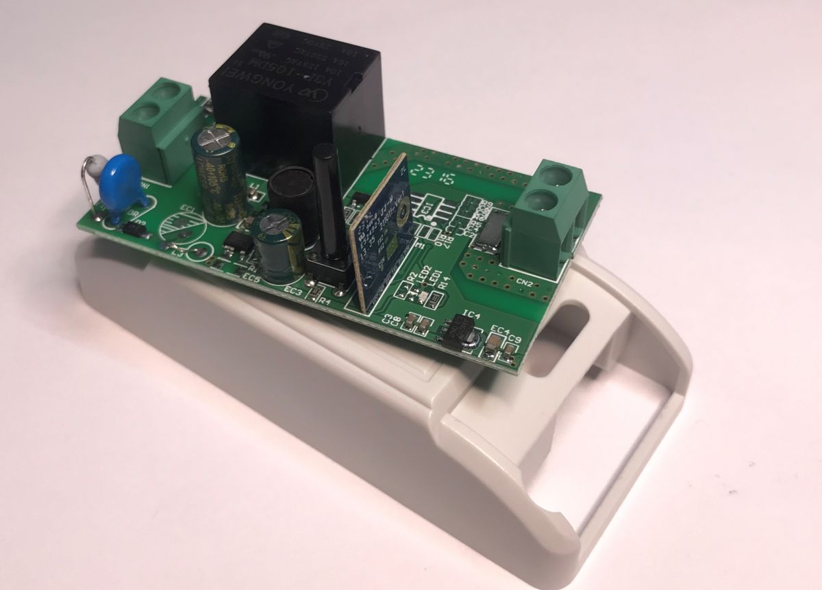

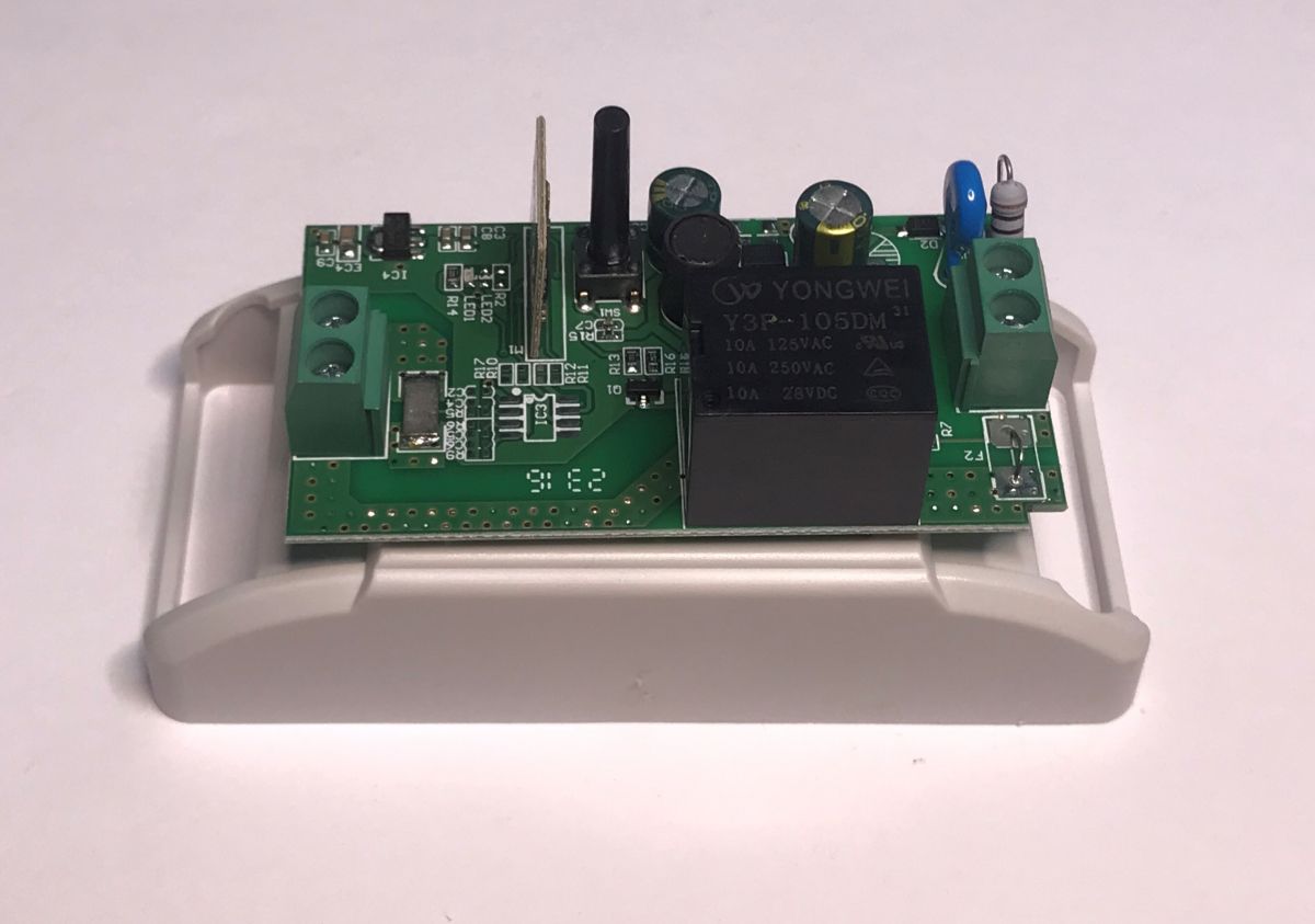

    Inside sits a relay that only cuts off one wire - assumed to be a phase, but you know, it depends how you connect. Apart from that, we have a non-isolated power supply (step down) and a 3.3V LDO regulator and WiFi module.
    PCB of a relay with electronic components on a white base. .
    Printed circuit board with electronic components of a WiFi relay on a white background. .
    Electronic circuit of ATLO-B1-Tuya relay on a white casing with visible electronic components. .

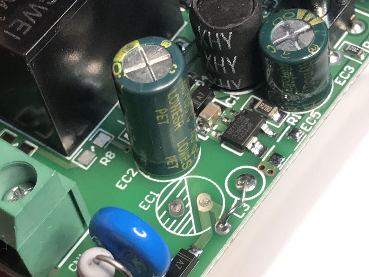

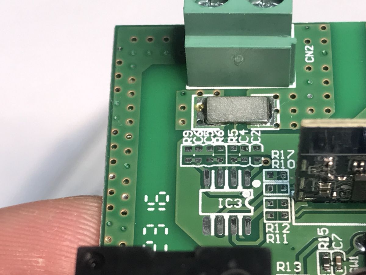

    The input to the inverter is protected by an F1 fuse, next to this we also have a varistor, and then an incomplete filter (the chokes are omitted - e.g. L3 is missing). In the plans there was also a fuse F2, the one from the phase going to the device, but it was omitted.
    Close-up of a relay circuit board with visible electronic components. .

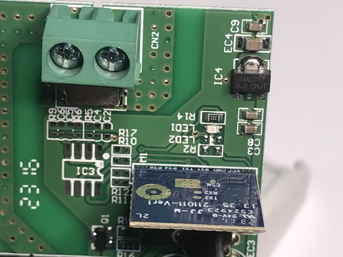

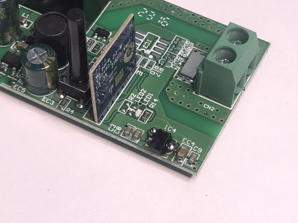

    The step-down converter itself (which converts these rectified 230V to 5V for the relay) is based on a BP2525. Separately further down we have the AMS1117-3.3V.
    Close-up of a PCB with a WiFi module. .

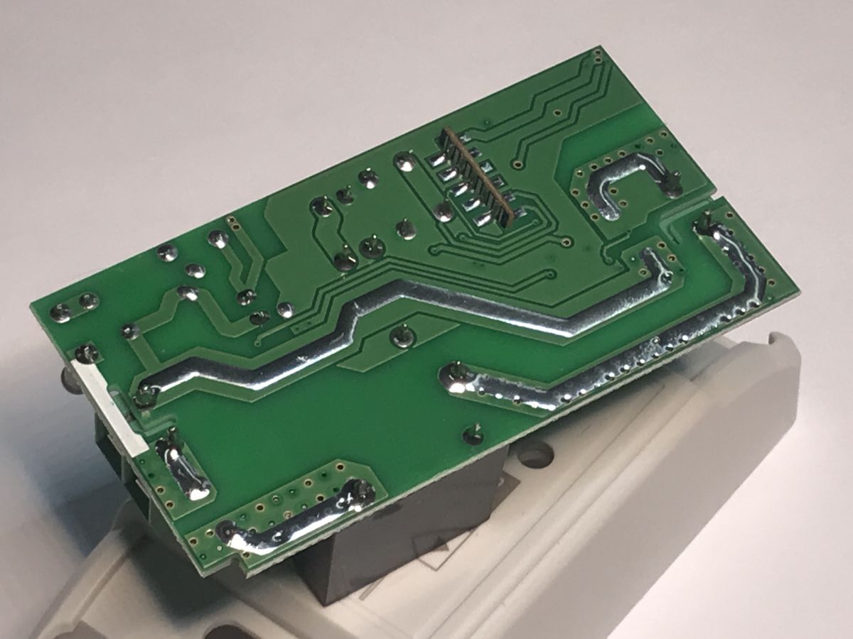

    There is still room on the board for the aforementioned BL0937 along with a resistor/bypass for current measurement.
    Close-up of a circuit board with component and port markings. .
    You can also see the bold current paths from 230V:
    Printed circuit board of a budget WiFi relay .

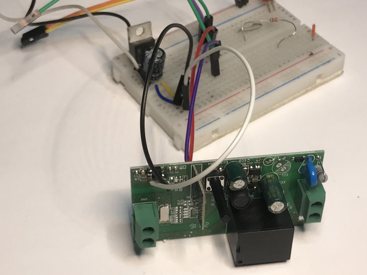

    The firmware change is done according to the instructions of our flasher:

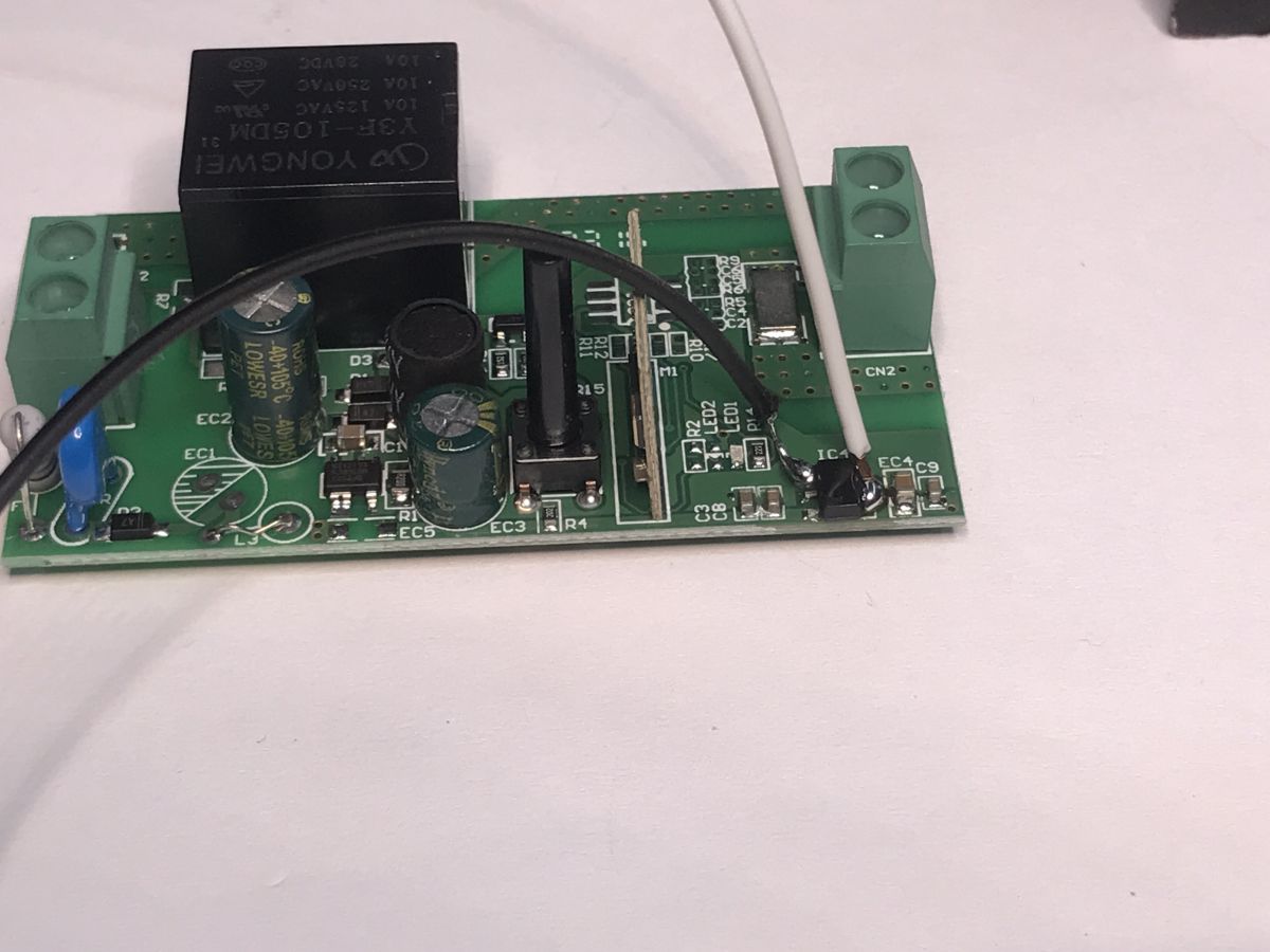

    We prepare a USB to UART converter as standard, on the other hand we don't need a 3.3V power supply/stabiliser as you can feed 5V to the input of the one on the board:
    WiFi relay board with electronic components and CB2S module. .
    Circuit board of a relay with electronic components. .
    You can't feed 5V into the CB2S power supply, because then you will damage it.

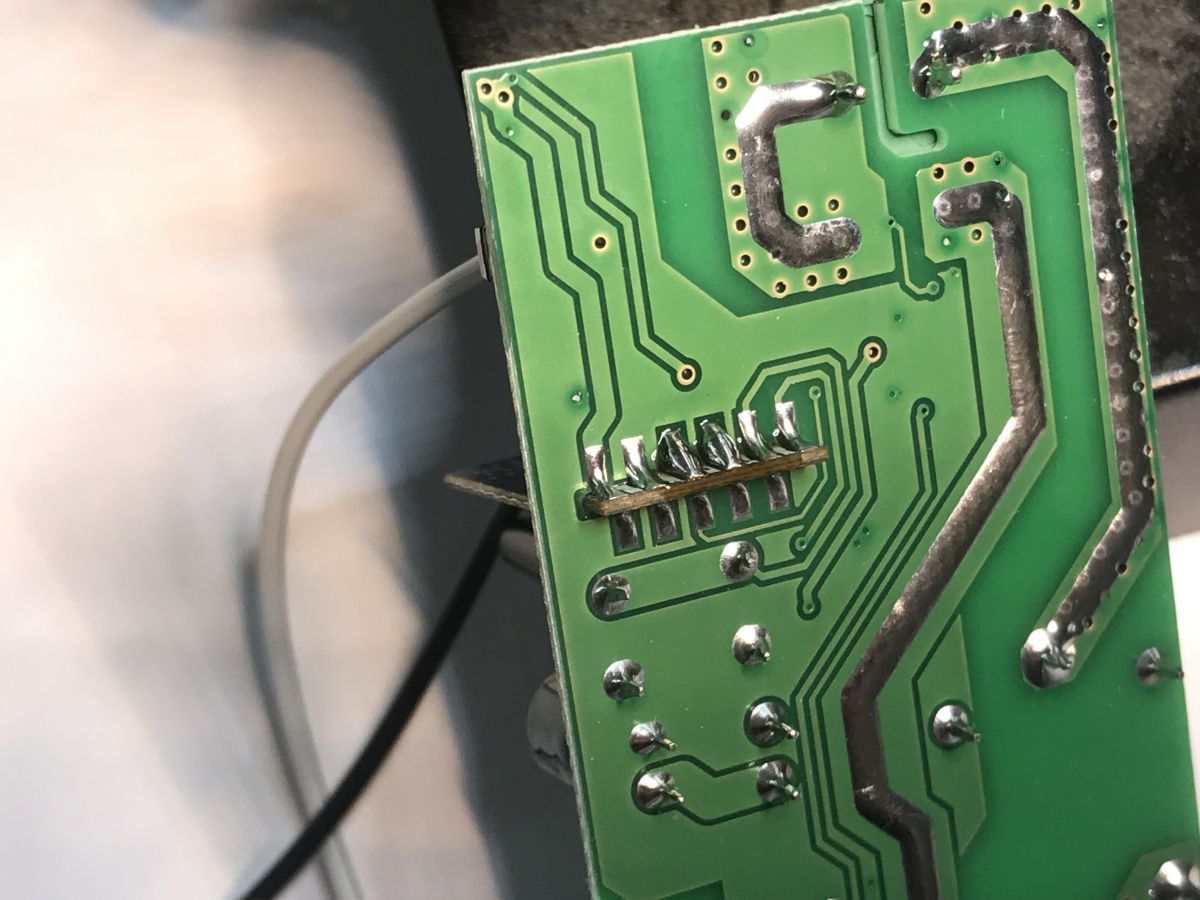

    We also need to add wires to the RX1 and TX1 pads from CB2S:
    PCB schematic with pin labels and dimensions for CB2S module. .
    I first apply flux, then add a bit of lead binder and solder the previously whitened wires too.
    Close-up of a circuit board with soldered wires. .
    A circuit board with electronic components and wires connected to a breadboard. .

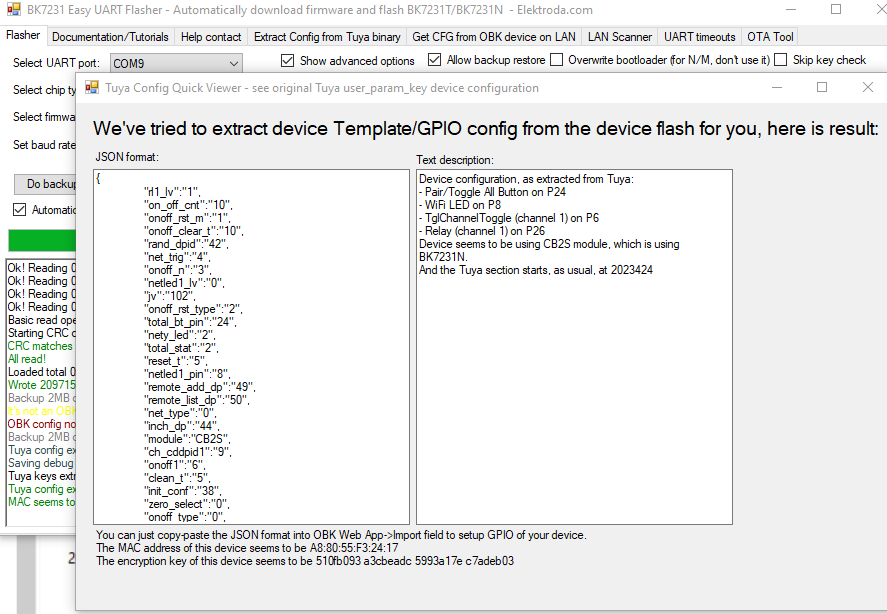

    Plug everything in, start the flash read in the flasher and do a power cycle, i.e. disconnect and connect the 5V power cable. The flasher should read the batch including the configuration:
    Screenshot of a tool for extracting Tuya device configuration. .
    JSON Tuya:
    OBK template:
    GPIO verbal description:
    Device seems to be using CB2S module, which is BK7231N chip.
    - Relay (channel 1) on P26
    - WiFi LED on P8
    - TglChannelToggle (channel 1) on P6
    - Pair/Toggle All Pin on P24
