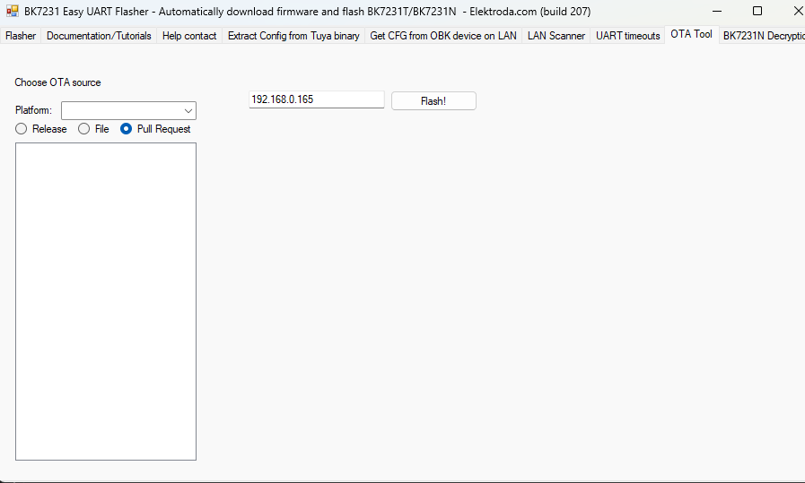

    Does this support OTA? I've put a spare socket onto the latest build version 1.18.245 yet when i try to downgrade the build or even change it to anything else I get a "Note: Selected OTA file variant "ota" does not match the current generic build." and it refuses to upgrade
  • #33 21803879
    Posts: 5038
    Help: 438
    Rate: 891
    the note should be in amber colour and the start ota button should still allow upgrade to proceed though.
    definitely using file with _ota.img?

  • #37 21803914
    gandi69
    Posts: 99
    >>21803879
    that does work yes if you just click start. My other sockets are on v1.91 so I cant do those without a manual reflash and I dont fancy turning the power off to those rings just yet
    Added after 5 [minutes]:
    >>21803896
    BK7231 Easy UART Flasher interface with IP field and Flash button
    This is all i see in easy flasher for OTA? I just assumed it never worked and did it via the web ui on each device

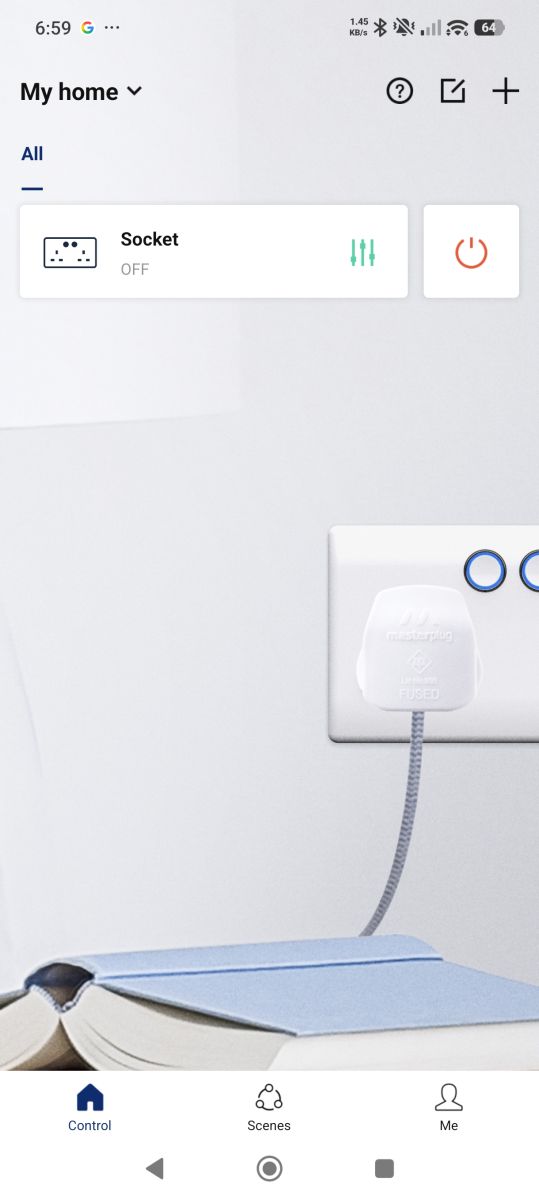

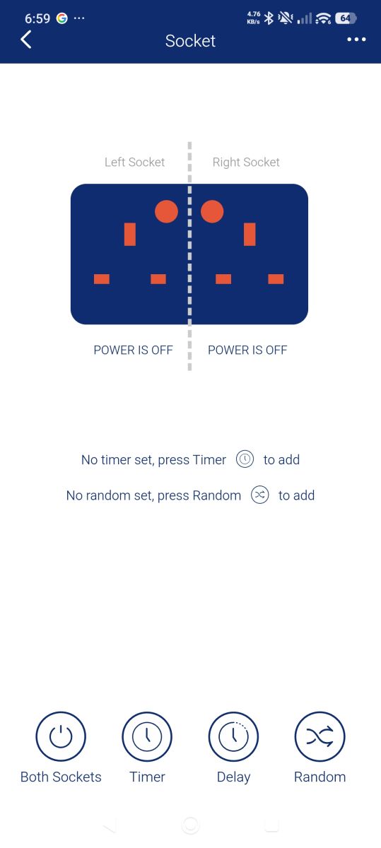

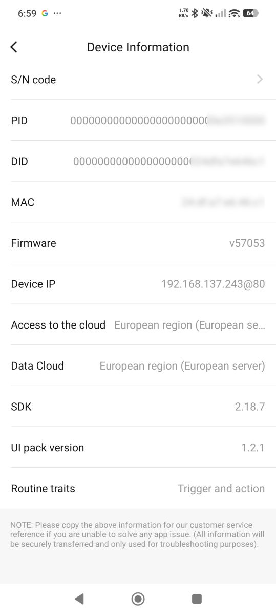

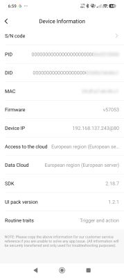

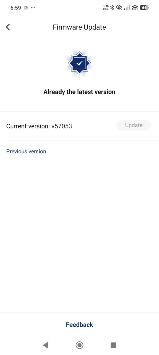

    @bertjones I forgot you sent me your 822/HC-01 RDA5981A backup in October. Here's the super-exciting boot log from it (921600, IO21 pull-up)
    pull-up IO4 to reset into AP mode. paired it with BG Home app
    Smart home app screen with power socket turned off and cable plugged in.App screen showing two remote-controlled sockets turned offFirmware update screen showing current version v57053 as the latest availableDevice information screen showing firmware, IP, cloud region, and software versions
