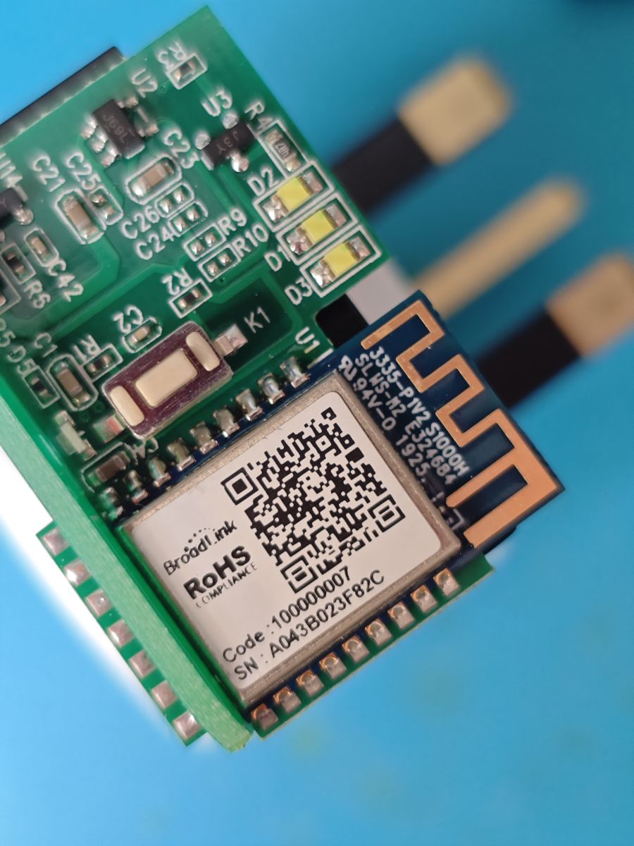

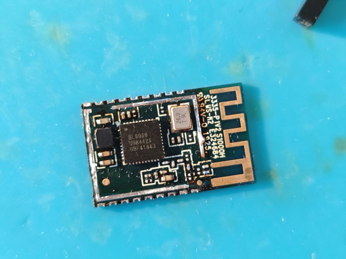

    Altirix

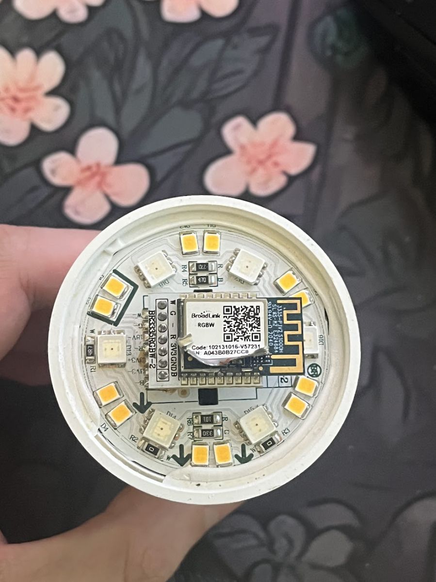

    I'm posting as there seems to be a very limited amount of info on this device and chip being used, A Broadlink BL3335-P, (carrier PCB says BR3335, the actual module has no part number)
    Close-up of a smart bulb interior showing LEDs and a Broadlink module.

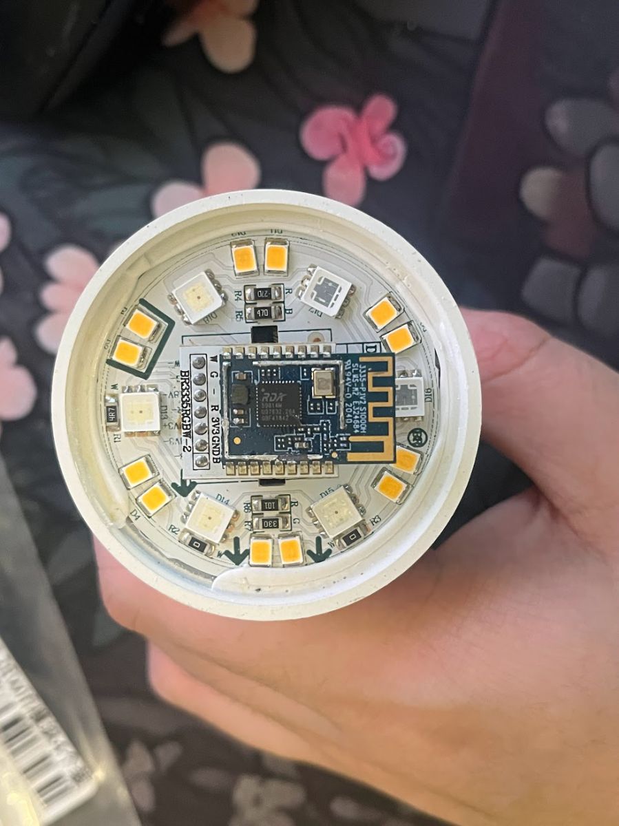

    Anyway I was curious as to what the actual controller was so as you can see I peeled the can off. this presents the RDA 5981AM.
    View of the inside of a smart bulb with an exposed RDA 5981AM module.
    Unfortunately I'm not exactly sure where the bulb was from, I've had it for a while and only recently took a look inside. It's most likely one off AliExpress and I'm pretty sure they switched to another controller now as I've ordered twice from the same store a few years later. There is no branding on the side of the bulb.
    Others seem to have got the same or similar boards such as https://diy.viktak.com/2020/05/broadlink-smart-bulb-conversion-to-open-source.html and were able to make a custom board for an esp as there's no project that supports the controller, likely due to it being obscure.
    If anyone wants to try and support this controller in OpenBeken or any others and would like to get anything off the device that would be useful in supporting you, feel free to message
  • Requesting datasheet, boot log, and GPIO markings

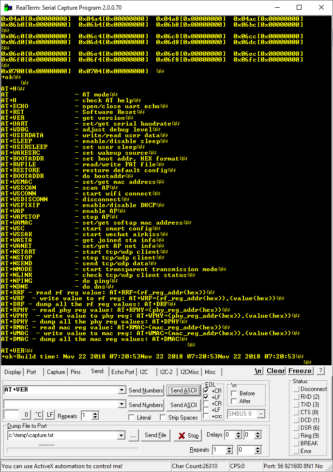

    Anyway, were you able to find a datasheet for this module or chip?
    Yes, seems the blog post states they were unable to find documentation (however they supposedly had a Broadlink BL3336T-P) there does seem to be documentation for the Broadlink BL3335-P and RDA 5981AM it's using.
    https://fccid.io/2ACDZ-BL3335-P/User-Manual/User-Manual-3825022.html
    https://github.com/RDA5981/RDA5981/blob/master/Datasheet/RDA5981AM DataSheet V1.5.pdf
    Did you attempt to take a boot log of this device? It could tell us which SDK was used.
    I have not, how would you recommend getting a boot log from one of these?
    Edit: could probs use an arduino as a usb to serial and connect to the rx and tx then power the board with 3.3v. and that should spit out a boot log?

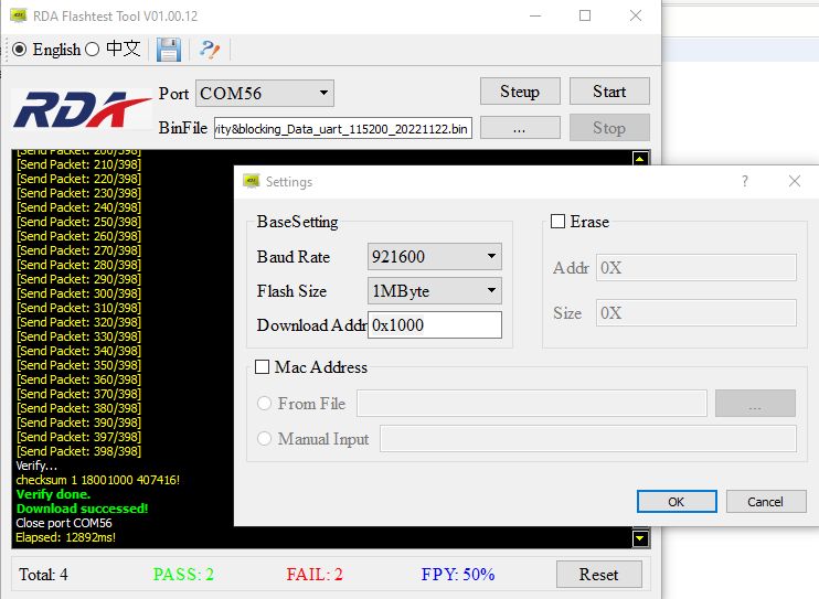

    #6 21479530
    Posts: 5214
    Help: 446
    Rate: 914

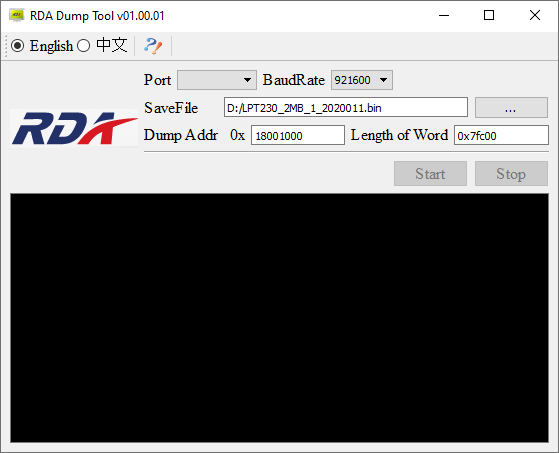

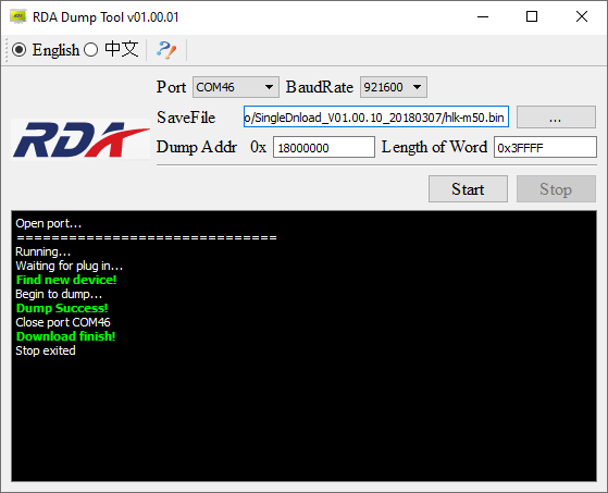

    I think I've nailed the correct starting address (includes BL) and length for 1mb flash on HLK-M50
    Screenshot of RDA Dump Tool version 1.00.01.
    Screenshot showing a hexadecimal code snippet and its decoded text.
    useful: https://github.com/ljalves/hfeasy
    without modification RDA Dump tool loads with these addresses set by Hi-Flying. These addresses result in a 2044kb file dump, which clearly shows HLK-M50 flash content repeated.
    RDA Dump Tool program for data dumping on a computer.
    Tool and dump will also land in FlashDumps and FlashTools GH
    • HLK-M50_RDA5981A.bin (1024 KB) You must be logged in to download this attachment.

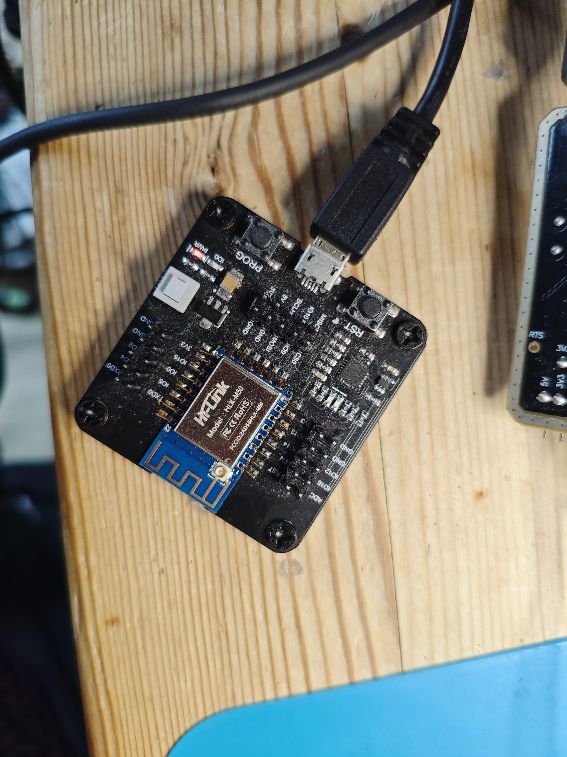

    and I've not seen any boot log output on either UART at any baud, no AP either. Only a small power spike at start to suggest it's doing anything
    Electronic module with a USB cable connected on a wooden table.

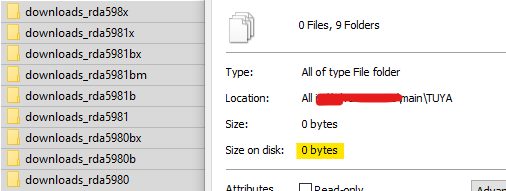

    RDA5981
    upper/lowercase
    then _major.minor 0.0-3.9 and _major.minor.build for 0.0.0->3.99.99
    then extensions .zip and .tar.gz upper and lowercase

  • #15 21637578
    Posts: 5214
    Help: 446
    Rate: 914
    re-ran with new major.minor and major.minor.build
    Empty folders named “downloads_rda” with size shown as 0 bytes

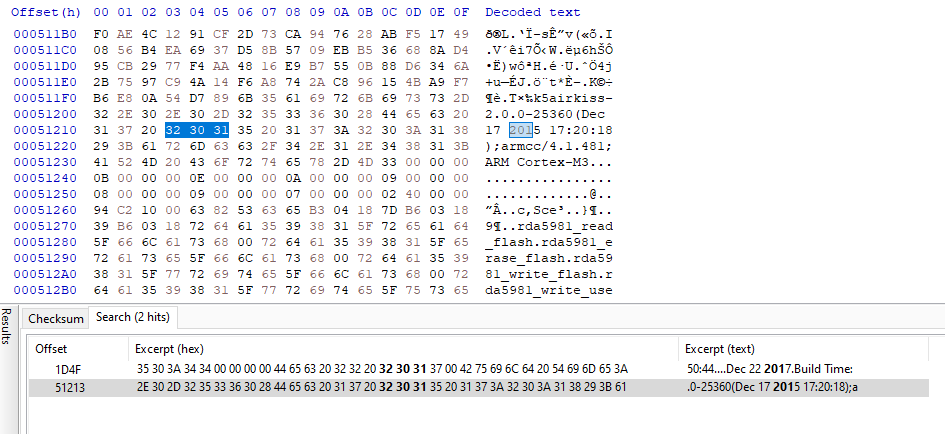

    insmod wrote:
    On csdn there are mentions of RDA5981_SDK_MbedOS515_V1.3.6 and RDA5981_SDK_MbedOS515_V2.0, but you cannot download them (china only site).
    (yes 1.3.5 not 1.3.6 - yet)
    • RDA5981_SDK开发手册-V1.1.3 AT指令集,MbedOS515_V1.3.5.rar (8.16 MB) You must be logged in to download this attachment.
    • RDA5981_SDK_MbedOS515_V2.0 新.rar (12.31 MB) You must be logged in to download this attachment.
    SDK changelog for RDA5981AM firmware updates

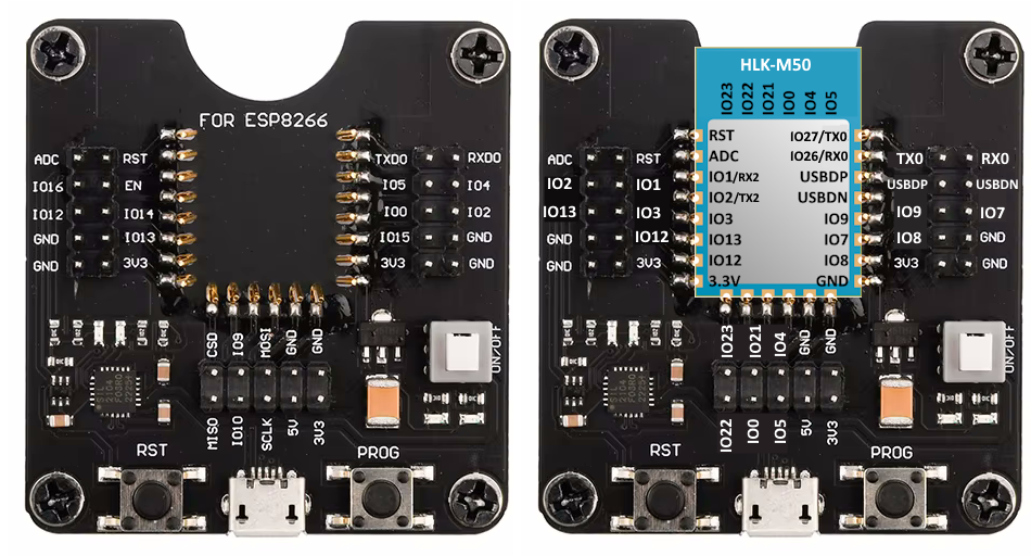

    #22 21697669
    Posts: 5214
    Help: 446
    Rate: 914
    I don't have a huge amount to report, but it is the case that P21 has be pulled high for the debug log to output
    HLK-M50 shipped firmware, P21 high, 921600 TX0/IO27
    Here's how HLK-M50 maps in my version of ESP adaptor
    Two breakout boards with labeled pins and connectors, one with HLK-M50 module installed.
    I flashed uarthut_V9_20231014_debugUart1.bin from the Hi-Flying ftp HF-LPX30_Compile\tools to 18001000
    RDA Flashtest Tool window with settings dialog and data transmission log.
    that boots. log's a bit more interesting
    if you watch the UART while it flashes:
    GUI tool flash log
    Spoiler:

    BL3335-P has been a bit of a disappointment so far:
    -no log out on any UART at any standard or many interim bauds.
    -IO27 outputs a load of odd characters in a boot-log kinda flow way, but nothing close to readable, ever
    -P21 is not routed out anywhere - may have to remove RF cover to try it (would have expected silence though instead of unreadable output)
    -No recognition of device by RDA Dump tool at any baud from either UART - BL3335-P is now fully de-soldered from plug in case of interference.
    -note: module does boot and wifi AP does show - plug/LEDs pairing mode look as it should - I have not tried pairing
    -yes I've searched for Tuya SDKs using variations of rda5991h

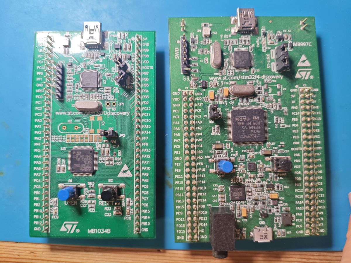

    SWD is reported to be an option by users here https://esp8266.ru/forum/threads/rda5981.2944/ but I have had no success with HLK-M50 or BL3335-P in trying. I even sought to try another J-Link which led to me converting these found discarded STM32 Discovery boards (at local recycling centre months ago) to J-Link from ST-Link - that was a bonus side-adventure but the newer firmware made no difference (2019 vs 2012 in clone)

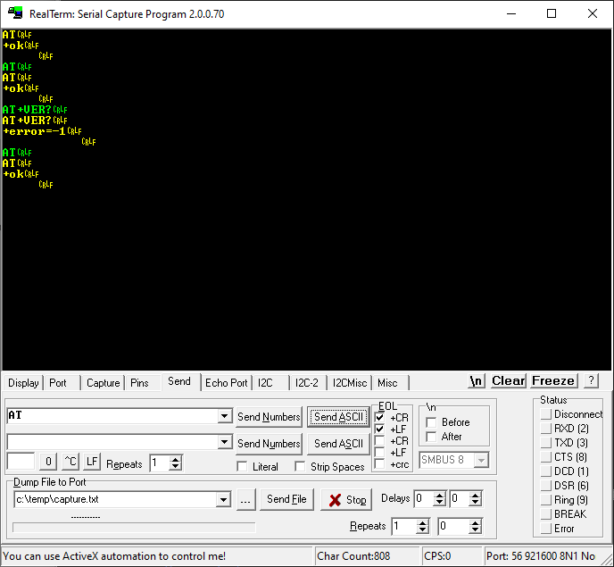

    insmod wrote:
    uartwifi is AT console.
    ah yes.
    921600 baud still and on IO26/IO27. AT ack with IO21 high
    Screenshot of RealTerm showing AT commands sent and responses from a serial device
    Added after 7 [minutes]:
    Screenshot of RealTerm with AT commands and serial port set to 921600 baud
    Added after 5 [hours] 50 [minutes]:
    well that's unexpected
    RDA 5981AM/Broadlink BL3335-P - Generic/nobrand 15W RGBW B22 Bulb - basic teardown
    maybe BL0908 is some internal designation for RDA5981

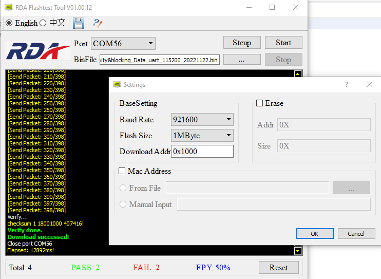

    https://github.com/divadiow/FlashDumps/commit/9e1458f98d0c2f97d0956df885668a6d5c56b583
    Added after 11 [minutes]:
    trimmed away 0x0-0x1000 from dump and flashed from 0x1000 on HLK-M50 = booting + AP

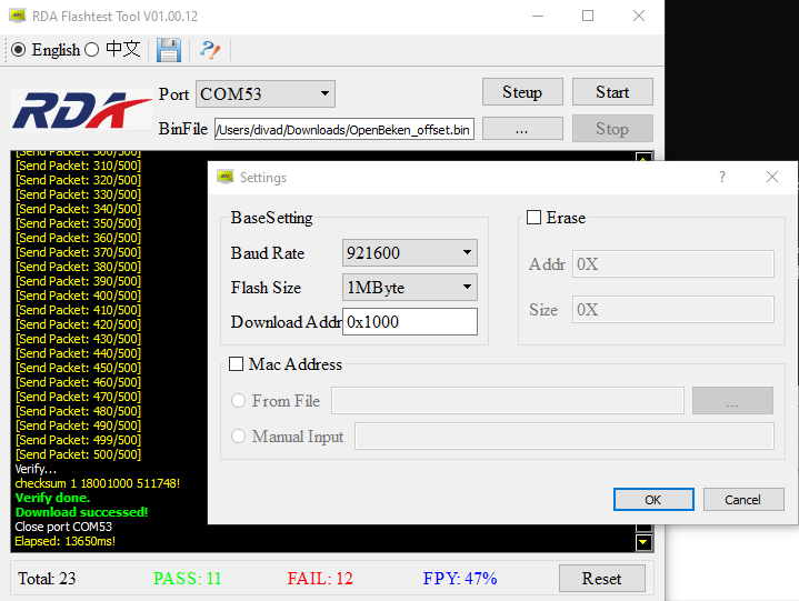

    OK. OpenBeken_offset.bin to 0x1000 will often not give output, apart from the BL bit, but when it does:
    RDA Flashtest Tool interface with settings window and success message visible
    insmod wrote:
    Possible that it's broken, if flash offset is not 0x{addr}, but 0x180{addr}
    not sure 100% I understand this bit. I've flashed both Openbeken.bin and Openbeken_offset.bin to 0x1000 and 0x18001000 in RDA Flashtest Tool but the above is the only signs of anything
    insmod wrote:
    Do flash erase, flash AT binary, connect to wifi and take a backup.
    will do. Also, I haven't quite understood from datasheets if it's safe to erase from 0x0 yet - do you know? I don't want a BK-T scenario without a working J-Link recovery option.
