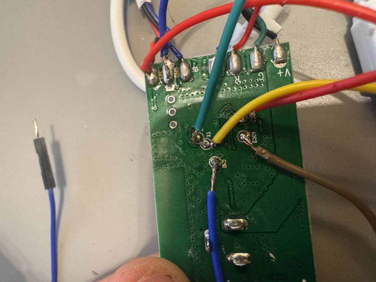

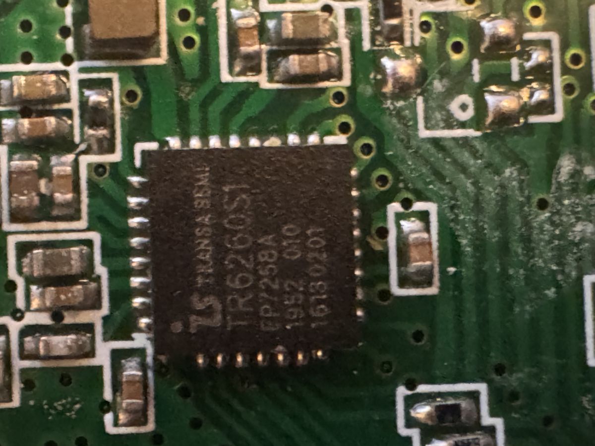

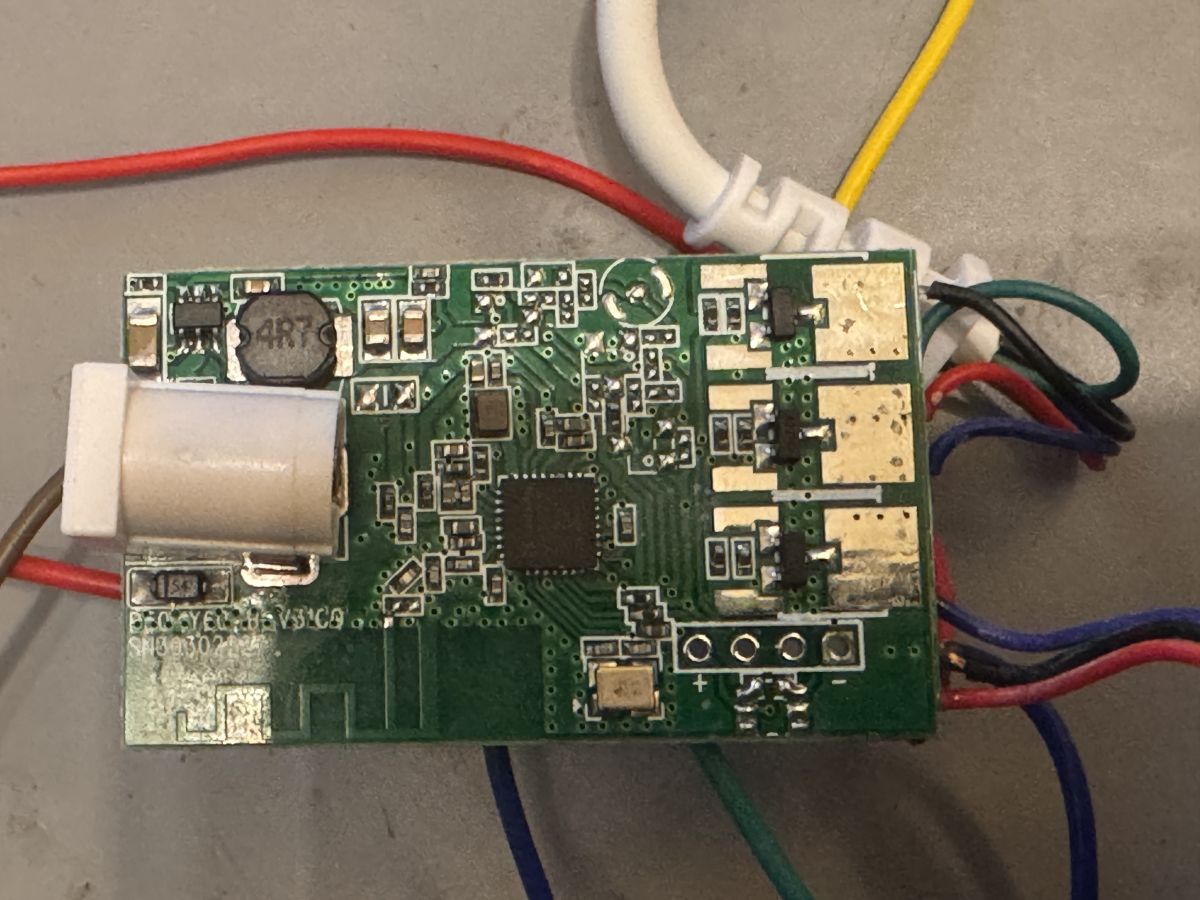

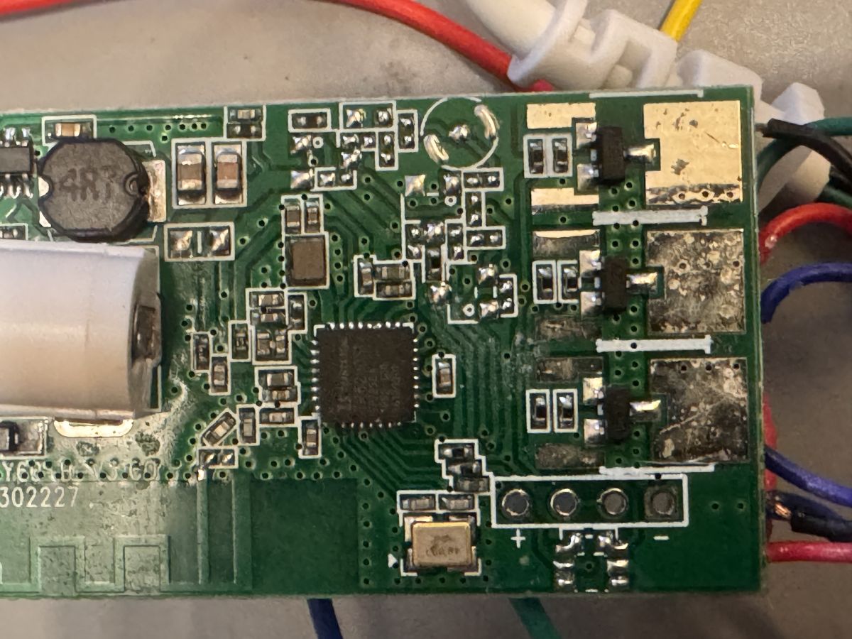

    Here are some images of the controller itself whilst flashing it earlier today.
    Close-up of TR6200S1 chip on green PCB with SMD components and visible solder pointsPCB with surface-mounted components and connected colored wiresPrinted circuit board with attached multicolored wiresClose-up of damaged PCB with burn marks and electronic components including transistors

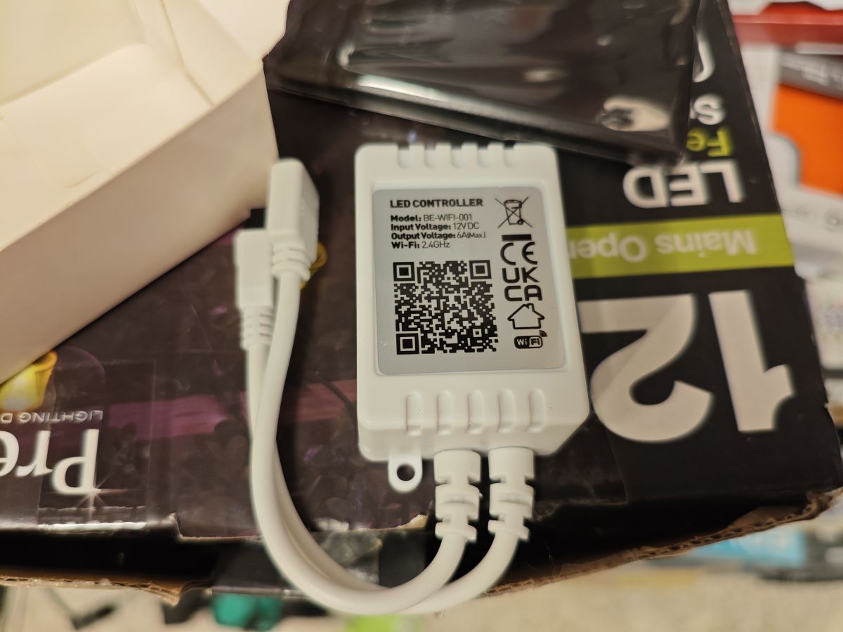

  • Request for packaging and case photos
    #13 21727141
    Posts: 5220
    Help: 449
    Rate: 918
    boot log from backup
    Added after 25 [minutes]:
    @gandi69 Not sure I can justify buying one of these at retail price from Home Bargains, if there are any left, but maybe packaging and device case pics would satisfy. Would you mind uploading some please for the record? :D

    Latest firmware fixed the issue. However, one unit has failed — board fried somehow! Not the best quality, these I fear...
    Added after 36 minutes:
    Wi-Fi RGB LED strip packaging with 150 LEDs, app control, and voice assistant support Packaging for these
    • OpenTR6260 PWM Support for Status RGB Strip with Tuya Compatibility IMG_4581.jpeg (1.53 MB) You must be logged in to download this attachment.
