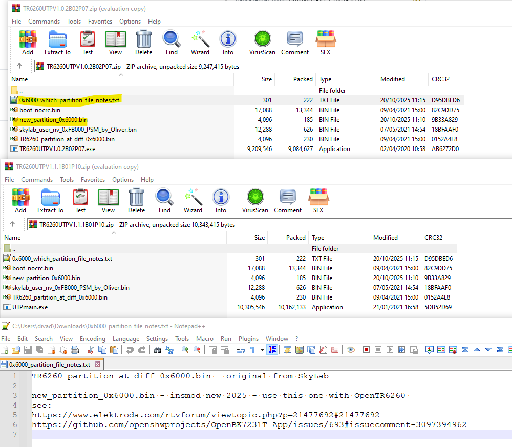

  • Added TR6260 partition file at 0x6000
    #31 21725879
    Posts: 5220
    Help: 449
    Rate: 918

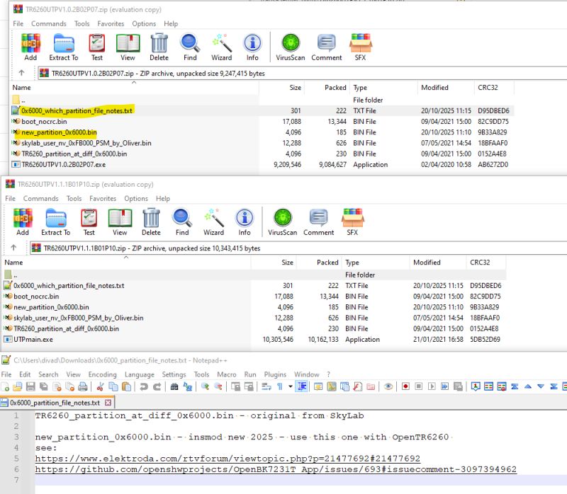

    File_2 : TR6260_partition_at_diff_0x6000.bin | Address: 0x6000
    new partition file added to each flash tool zip along with a note
    Screenshot of two ZIP archives with binary files and a note open in Notepad++
    https://github.com/openshwprojects/FlashTools/pull/12
    Added after 8 [minutes]:
    and maybe this line in post 1 could be changed to new file name?
  • Added second HLK-M20 dump and partition file rename

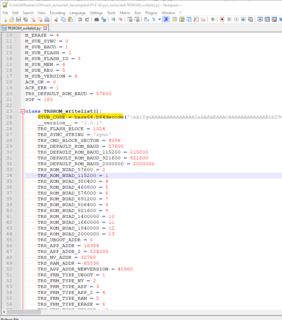

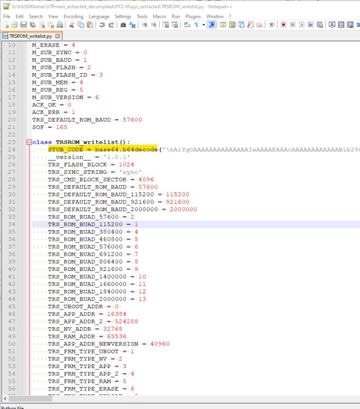

    TR flasher Python guts
    Screenshot of Python source code defining class TRSROM_writelist and constant values
    • UTPmainPython.zip (11.01 MB) You must be logged in to download this attachment.

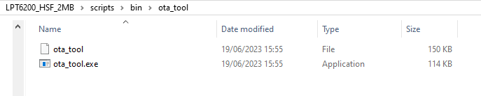

    Help: 449
    Rate: 918
    newer libs? anything else in there of interest? ota_tool looks the same as ECR6600?

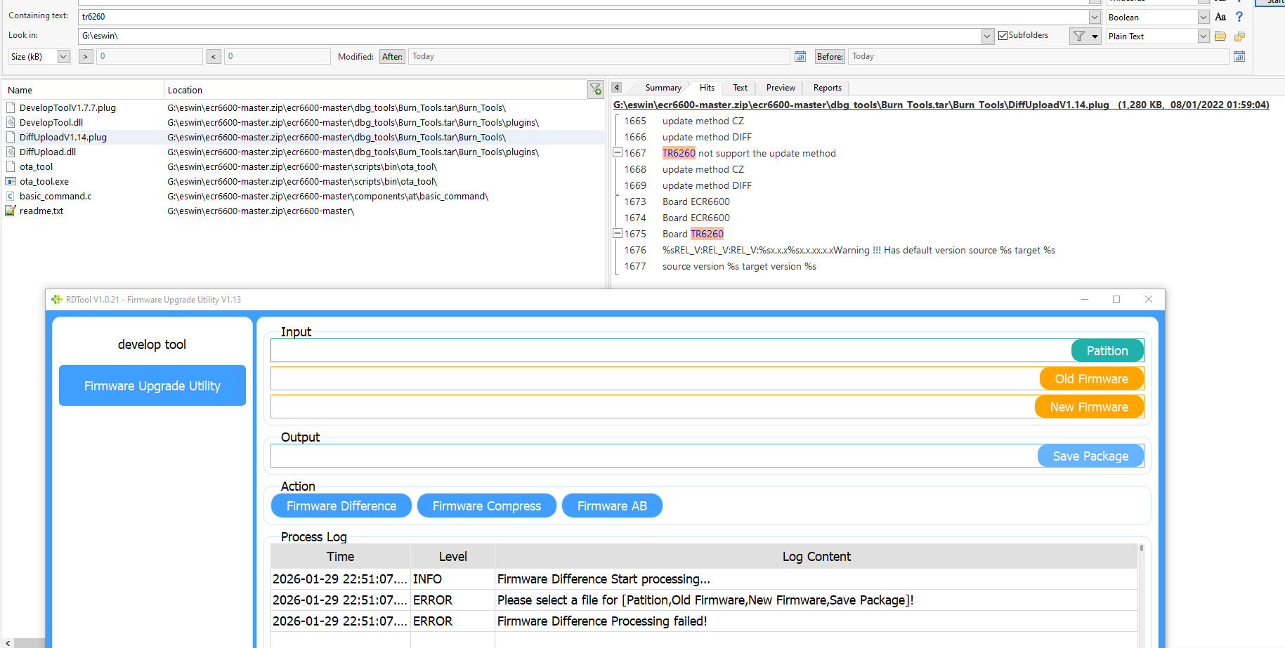

    >>21820385
    was all your ota stuff with ota_tool? just wondering if this has any use. there's tr6260 mention in the plugin for RDTool
    Screenshot of RDTool firmware utility and a file explorer showing TR6260 search

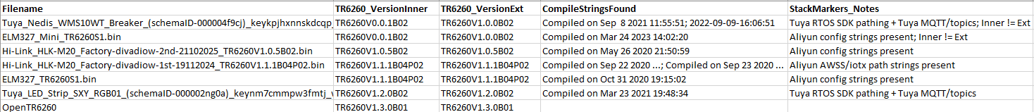

    TR6260 SDK versions we've seen
    Screenshot of a table listing BIN filenames, TR6260 versions, compile dates, and notes.
    we could add additional nv bits to OpenTR6260 to match? https://github.com/NonPIayerCharacter/OpenTR6260/pull/1
    No sign of version in a dump of OpenTR6260 currently
    • withsdkveropentr6260dumpbooted.bin (1 MB) You must be logged in to download this attachment.
  • #42 21841523
    insmod
    Posts: 1432
    Help: 168
    Rate: 455
    Is it really needed?
    And would it break existing configs?

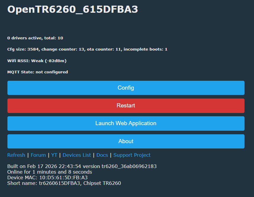

  • TR6260 OTA update succeeds with OpenTR6260 firmware
    #43 21841524
    Posts: 5220
    Help: 449
    Rate: 918
    nope. closed :)
    Added after 4 [hours] 43 [minutes]:
    OpenTR6260 status page with buttons: Config, Restart, Launch Web Application, and About.
    to see in action, use OpenTR6260_tr6260_8c58ec0735b3.bin as main flash then ota to OpenTR6260_tr6260_36ab06962183_ota.img
    ota_tool replacement https://github.com/divadiow/OpenBK7231T_App/b...99e00a3c1f91a4/tools/tr6260_ota_v1_builder.py
    posting here after first success. not done anything further. submodule contains other unrelated general stuff, not really reviewed, but I neglected to make new branch for ota-only testing. don't know what impact the changes to ota code have had, if any, on ota img success https://github.com/NonPIayerCharacter/OpenTR6...cdef0d85d66a42ced04aea1e866d5156bca6adf5f9a59
    • OpenTR6260_tr6260_36ab06962183_ota.img.rename.bin (6.69 KB) You must be logged in to download this attachment.
    • OpenTR6260_tr6260_8c58ec0735b3.bin (645.96 KB) You must be logged in to download this attachment.

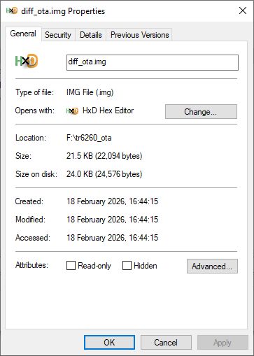

  • OTA update succeeds with OpenTR6260 v1.18.261
    #46 21842370
    Posts: 5220
    Help: 449
    Rate: 918
    damn :(

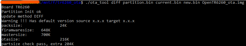

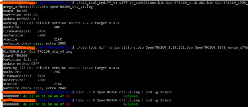

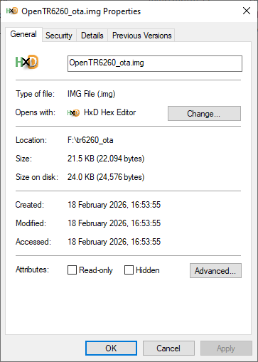

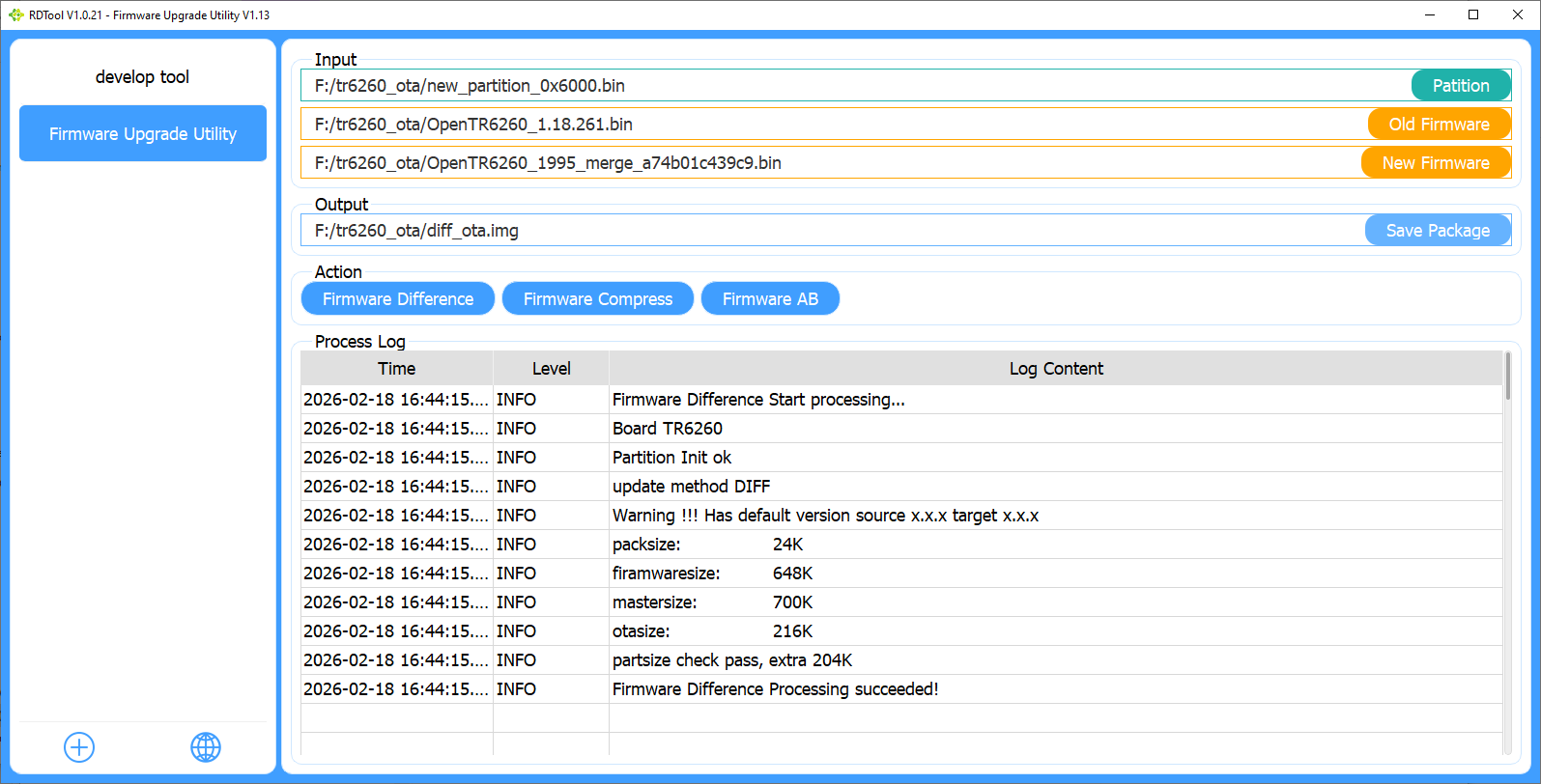

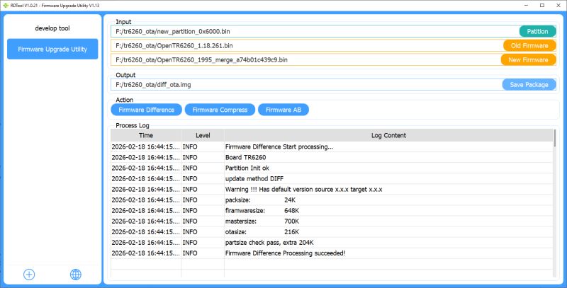

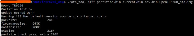

    and yet, with v3
    Screenshot of RDTool showing TR6260 firmware diff inputs, output path, and a process log
    Windows file properties window for diff_ota.img showing type, size, location, and timestamps.

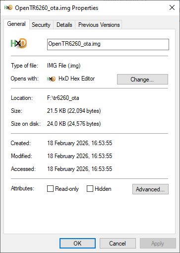

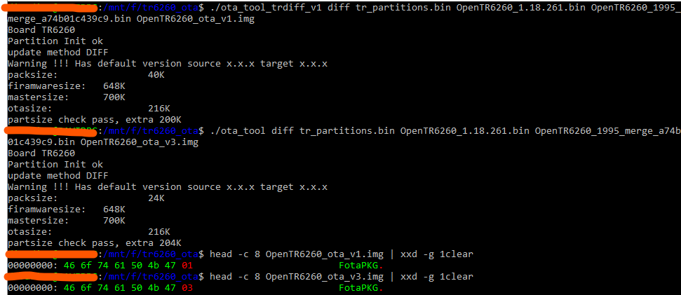

    Terminal screenshot showing ota_tool DIFF output and firmware package size values
    Windows file Properties window for OpenTR6260_ota.img showing type, location, size, and timestamps
    Added after 2 [hours] 46 [minutes]:
    OpenTR6260_1.18.261.bin -> a74b01c439c9
    with ota file OpenTR6260_ota_v1.img (39,872 bytes)

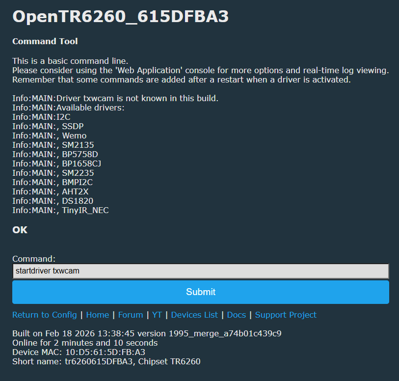

    Screenshot of OpenTR6260 showing available drivers and the command field “startdriver txwcam”.
    Code: Bash
    Terminal output with ota_tool diff commands and xxd header showing “FotaPKG”, with orange underlines highlighting lines
    • ota_tool_trdiff_v1.zip (50.11 KB) You must be logged in to download this attachment.
    • OpenTR6260_ota_v1.img.rename.bin (38.94 KB) You must be logged in to download this attachment.
  • Forcing TR6260 diff builds to use FotaPKG 01

    what/how/why:
    ota_tool
    Internal flow:
    1) Detect board type from first 4 bytes of *target* firmware:
    if u32 == 0x02262018 OR 0x48787032 -> board = ECR6600
    else -> board = TR6260
    (also enforces src/tgt board match for diff/ab)
    2) Parse infilelist/partition-config with board_type:
    sw_partition_config_init(infilelist, board_type)
    3) Validate method vs firmware header marker at offset 0x70 (ECR only):
    cmz (method 4): checks target[0x70] is one of 0x22/0x42
    diff (method 3/1): checks src[0x70] and tgt[0x70] are one of 0x22/0x42
    ab (method 2): checks src[0x70] and tgt[0x70] are 0x82
    4) Select packer by (board_type, method):
    TR6260:
    method 1 -> sw_pack_file_trdiff_package() -> writes FotaPKG + 0x01 (TR “v1” OTA)
    method 3 -> sw_pack_file_trdiff_package_new() -> writes FotaPKG + 0x03 (TR “v3” OTA)
    ECR6600:
    method 2 -> sw_pack_file_ab_create()
    method 4 -> sw_pack_file_ecrcmz_package()
    method 3 -> sw_pack_file_ecrdiff_package_new()
    method 1 -> sw_pack_file_ecrdiff_package() (older ECR diff path)
    Why TR6260 keeps getting “v3”:
    The original ota_tool hard-maps CLI "diff" -> method = 3, so TR6260 always goes through
    trdiff_package_new() and emits FotaPKG 03.
    What was changed to force TR “v1” pipeline:
    Patched one byte in main(): for CLI "diff", change method constant 0x03 -> 0x01
    (file offset 0x4f46 in ota_tool).
    Effect:
    - TR6260 "diff" now uses trdiff_package() and outputs FotaPKG 01 (v1 container)
    - ECR6600 "diff" also switches from ecrdiff_new() to ecrdiff_old() (method 1)

    Can you reverse sw_pack_file_trdiff_package?
  • #49 21842841
    Posts: 5220
    Help: 449
    Rate: 918
    yes. am trying to get a working Python version of sw_pack_file_trdiff_package for use without, or as well as, modified ota_tool

    RDTool's DiffUploadV1.14.plug can be extracted with
    Code: Python
    similar looking magic in DiffUpload.dll
    • DiffUploadV1.14_extracted.zip (767.76 KB) You must be logged in to download this attachment.

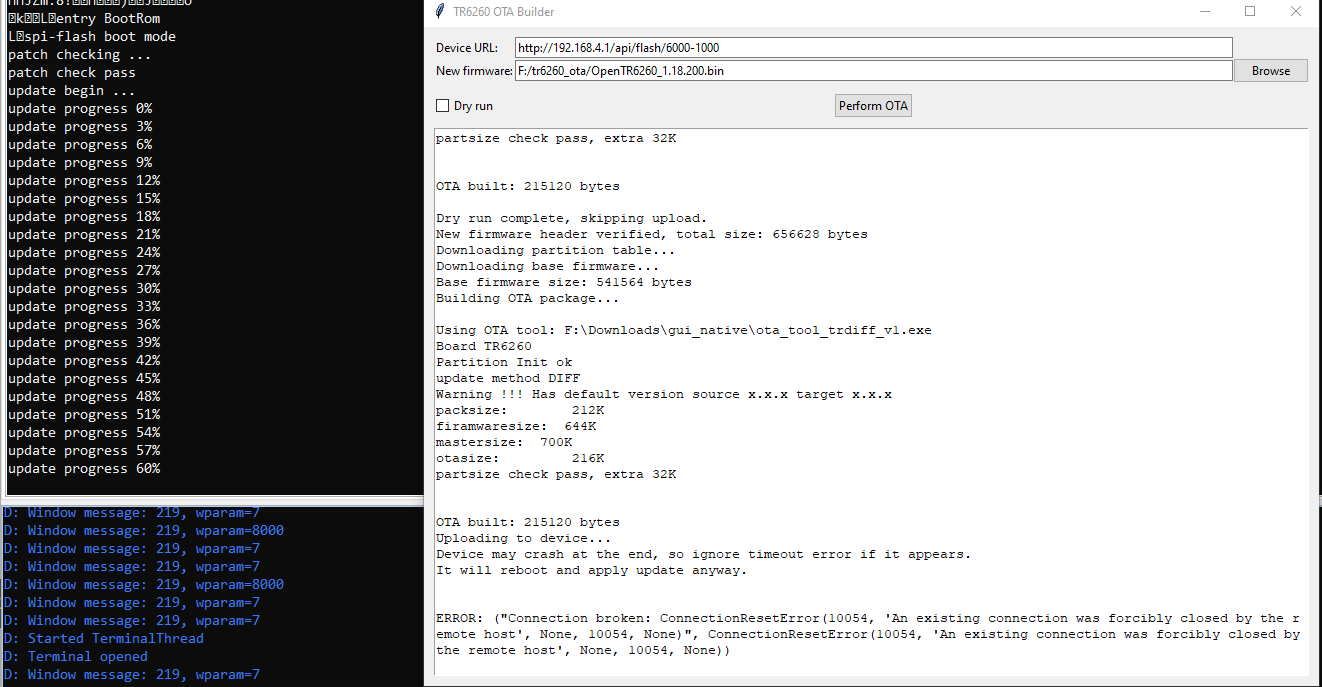

  • Corrupted OTA output can brick the device
    #54 21844134
    insmod
    Posts: 1432
    Help: 168
    Rate: 455
    Sometimes it produces corrupted (?) output, making device unbootable.
    1.18.60 to 1.18.200
    New firmware header verified, total size: 656628 bytes
    Downloading partition table...
    Downloading base firmware...
    Base firmware size: 541564 bytes
    Building OTA package...
    cpu1:     addr=0x7000 len=0xAF000
    data_ota: addr=0xB6000 len=0x36000
    old_fw: 541564 bytes, new_fw: 656628 bytes, chunks: 33
    [ 1/33] off=0x000000 old=0x5000 new=0x5000 patch=0x438 triples=   1 aligned
    [ 2/33] off=0x005000 old=0x5000 new=0x5000 patch=0x55D triples=   1 aligned
    [ 3/33] off=0x00A000 old=0x5000 new=0x5000 patch=0x413 triples=   1 aligned
    [ 4/33] off=0x00F000 old=0x5000 new=0x5000 patch=0x3F6 triples=   1 aligned
    [ 5/33] off=0x014000 old=0x5000 new=0x5000 patch=0x3CA triples=   1 aligned
    [ 6/33] off=0x019000 old=0x5000 new=0x5000 patch=0x347 triples=   1 aligned
    [ 7/33] off=0x01E000 old=0x5000 new=0x5000 patch=0x56F triples=   1 aligned
    [ 8/33] off=0x023000 old=0x5000 new=0x5000 patch=0x1B3 triples=   1 aligned
    [ 9/33] off=0x028000 old=0x5000 new=0x5000 patch=0x155 triples=   1 aligned
    [10/33] off=0x02D000 old=0x5000 new=0x5000 patch=0x1F0 triples=   1 aligned
    [11/33] off=0x032000 old=0x5000 new=0x5000 patch=0x4D2 triples=   1 aligned
    [12/33] off=0x037000 old=0x5000 new=0x5000 patch=0x1CC2 triples=  13 delta(a12,w256,s0.26)
    [13/33] off=0x03C000 old=0x5000 new=0x5000 patch=0x273D triples=  23 delta(a16,w256,s0.26)
    [14/33] off=0x041000 old=0x5000 new=0x5000 patch=0x1F16 triples=  19 delta(a12,w256,s0.26)
    [15/33] off=0x046000 old=0x5000 new=0x5000 patch=0x252D triples=  23 delta_deep(a8,w192,s0.18)
    [16/33] off=0x04B000 old=0x5000 new=0x5000 patch=0x3050 triples=   3 delta(a12,w256,s0.18)
    [17/33] off=0x050000 old=0x5000 new=0x5000 patch=0x1E0C triples=   6 delta(a16,w256,s0.18)
    [18/33] off=0x055000 old=0x5000 new=0x5000 patch=0x2D00 triples=   1 delta(a12,w256,s0.18)
    [19/33] off=0x05A000 old=0x5000 new=0x5000 patch=0x3150 triples=   1 delta(a12,w512,s0.18)
    [20/33] off=0x05F000 old=0x5000 new=0x5000 patch=0x2E2D triples=   1 delta(a12,w256,s0.18)
    [21/33] off=0x064000 old=0x5000 new=0x5000 patch=0x2D24 triples=   1 delta(a12,w256,s0.18)
    [22/33] off=0x069000 old=0x5000 new=0x5000 patch=0x33D7 triples=   1 delta(a12,w256,s0.18)
    [23/33] off=0x06E000 old=0x5000 new=0x5000 patch=0x2850 triples=   1 delta(a12,w256,s0.22)
    [24/33] off=0x073000 old=0x5000 new=0x5000 patch=0x1435 triples=   1 delta(a12,w256,s0.18)
    [25/33] off=0x078000 old=0x5000 new=0x5000 patch=0x187A triples=   1 delta(a12,w256,s0.18)
    [26/33] off=0x07D000 old=0x5000 new=0x5000 patch=0x2636 triples=   1 delta(a12,w256,s0.18)
    [27/33] off=0x082000 old=0x237C new=0x5000 patch=0x1DD0 triples=   1 delta(a12,w256,s0.18)
    [28/33] off=0x087000 old=0x0 new=0x5000 patch=0x22C8 triples=   1 aligned
    [29/33] off=0x08C000 old=0x0 new=0x5000 patch=0x1B06 triples=   1 aligned
    [30/33] off=0x091000 old=0x0 new=0x5000 patch=0x2301 triples=   1 aligned
    [31/33] off=0x096000 old=0x0 new=0x5000 patch=0x320E triples=   1 aligned
    [32/33] off=0x09B000 old=0x0 new=0x5000 patch=0x2785 triples=   1 aligned
    [33/33] off=0x0A0000 old=0x0 new=0x4F4 patch=0x2F3 triples=   1 aligned
    Wrote: C:\Users\-\AppData\Local\Temp\tmp_47sepu9\ota.img (217584 bytes) crc32=0x396DD450 build_time=2.23s
    OTA built: 217584 bytes
    Uploading to device...
    Device may crash at the end, so ignore timeout error if it appears.
    It will reboot and apply update anyway.
    ERROR: HTTPConnectionPool(host='192.168.1.217', port=80): Read timed out.
    patch checking ...
    patch check pass
    update begin ...
    update progress 0%
    update progress 3%
    update progress 6%
    update progress 9%
    update progress 12%
    update progress 15%
    update progress 18%
    update progress 21%
    update progress 24%
    update progress 27%
    update progress 30%
    update progress 33%
    update progress 36%
    update progress 39%
    update progress 42%
    update progress 45%
    update progress 48%
    update progress 51%
    update progress 54%
    update progress 57%
    update progress 60%
    update progress 63%
    update progress 66%
    update progress 69%
    update progress 72%
    update progress 75%
    update progress 78%
    update progress 81%

    Added after 16 [minutes]:
    Original tool produced a working patch, only 2464 bytes lighter.

    darn. confirmed. OK. will see what can be tweaked

    insmod wrote:
    ERROR: ('Connection aborted.', BadStatusLine('HTTP/1.1 -1 OK\n'))
    this is from log in tkinter gui?
  • Windows and x86_64 OTA tool adaptation
    #59 21844325
    insmod
    Posts: 1432
    Help: 168
    Rate: 455
    >>21844322
    Yep.
    Anyway, i've done the same thing to windows ota tool as you've done to linux one.
    Plus adapted gui tool to use it.
    But the limitation is that it's only windows and x86_64 linux. Can't ota from android for example.
    New firmware header verified, total size: 661312 bytes
    --- DRY RUN MODE ENABLED ---
    Firmware will not uploaded.
    Base firmware size: 662688 bytes
    Using OTA tool: C:\SourceCodes\OpenBK7231T_App\sdk\OpenTR6260\out\tr6260s1\standalone\ota_tool_trdiff_v1.exe
    Board TR6260
    Partition Init ok
    update method DIFF
    Warning !!! Has default version source x.x.x target x.x.x
    packsize:		 40K
    firamwaresize:	 648K
    mastersize:	 700K
    otasize:		 216K
    partsize check pass, extra 200K
    OTA built: 39600 bytes
    Dry run complete, skipping upload.
    Iike i said earlier, the ideal would be doing everything inside a browser

    Screenshot: console showing update progress and “TR6260 OTA Builder” window with logs
    Added after 4 [minutes]:
    oh this is better. im jumping between releases with ease now

3. Where can I download the TR6260 UTP flash tool, boot_nocrc.bin, and the partition files needed for OpenTR6260 flashing?
Download them from the FlashTools package linked in the thread. The UTP utility is not esptool, because TR6260 is not an ESP chip. The post points to the TransaSemi-ESWIN FlashTools repository and an alternate TR6260 resource pack, and it states that boot_nocrc.bin comes from the same zip as UTP. That same package also includes the partition binaries used at address 0x6000. [#21351236]
4. Which files and flash addresses should I use in UTP for TR6260 flashing, including boot_nocrc.bin, the partition binary at 0x6000, and the OpenTR6260 firmware at 0x7000?
Use three files in UTP: boot_nocrc.bin at 0x0000, the partition binary at 0x6000, and OpenTR6260_xxxx.bin at 0x7000. The flashing guide originally named new_partition_0x6000.bin, and a later thread update says a new partition filename was added to each FlashTools zip for the same 0x6000 slot. Do not rely on an old extra File_4 entry; the thread later says that advice needs revision. [#21725879]

10. What is the FotaPKG v1 versus v3 OTA format on TR6260, and how does ota_tool choose between the different TR6260 and ECR6600 packaging methods?
TR6260 uses two discussed diff OTA containers: FotaPKG 0x01 as “v1” and FotaPKG 0x03 as “v3”. A reverse-engineered summary in the thread says ota_tool detects the board from the target firmware header, then maps diff to method 3 by default. That makes TR6260 use sw_pack_file_trdiff_package_new() and emit FotaPKG v3. Patching one byte changed diff to method 1, forcing the older TR6260 v1 path instead. ECR6600 uses different packers for AB, CMZ, and diff modes. [#21842600]

15. How can I build and apply OTA updates for TR6260 with Python or ota_tool, and why do some OTA patches fail around 81% or produce an unbootable device?
You can build TR6260 OTA diffs with either patched ota_tool or later Python builders, but large version jumps remained fragile. One contributor reported successful Python-generated packages as small as 40,544 bytes, while another saw failures around 81% during updates such as 1.18.80 -> 1.18.261. The thread also records cases where a generated patch passed self-check yet left the device unbootable. The likely cause is package-format or compression edge cases, since the original tool produced a working patch only 2,464 bytes lighter than the failing Python one. [#21844134]
