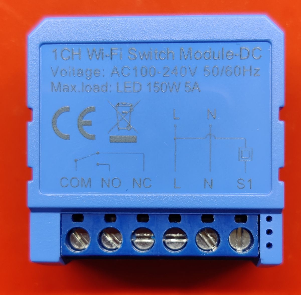

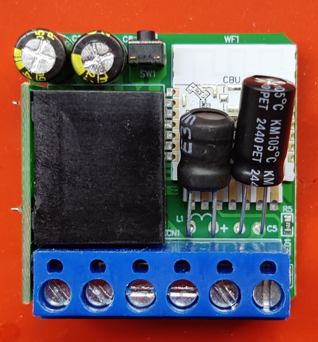

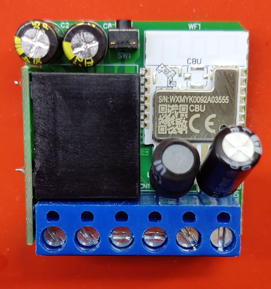

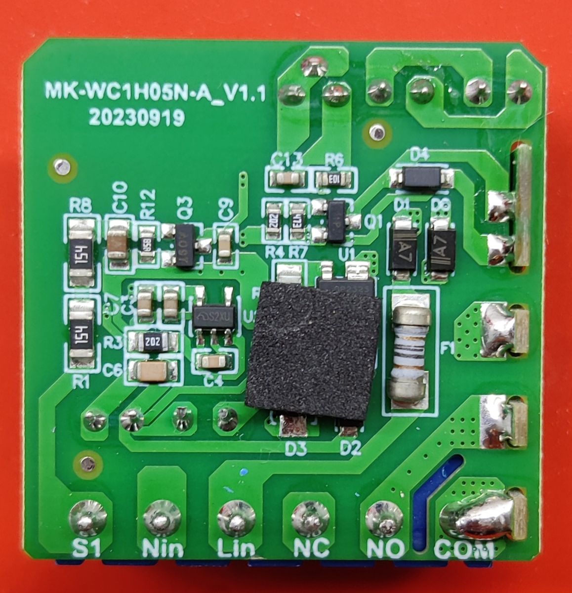

    New AVATTO Tuya module with dry contact just arrived.
    Aliexpress:
    AVATTO Tuya WiFi/ZigBee Smart Dry Contact Module DC 24-32V AC 100-240V Smart Home DIY MiNi Module Work for Alexa Google Home
    https://www.aliexpress.com/item/1005008742846993.html
    I can't find one described here, so I added info about them here.
    CBU module is inside. The same as other AVATTO modules.
    Blue Wi-Fi relay module with electrical labels and screw terminals
    Green PCB with electronic components and labeled terminal and part names.
    Wi-Fi module with relay and screw terminals on a red background
    Electronic module with relay, capacitors, and terminal block connector
    JSON
       "rl1_lv":"1",
       "on_off_cnt":"10",
       "onoff_rst_m":"1",
       "onoff_clear_t":"10",
       "rand_dpid":"42",
       "net_trig":"2",
       "onoff_n":"3",
       "netled1_lv":"0",
       "jv":"102",
       "onoff_rst_type":"2",
       "total_bt_pin":"8",
       "nety_led":"2",
       "total_stat":"0",
       "reset_t":"5",
       "netled1_pin":"6",
       "remote_add_dp":"49",
       "remote_list_dp":"50",
       "net_type":"0",
       "inch_dp":"44",
       "rf_width":"359",
       "module":"CBU",
       "ch_cddpid1":"9",
       "remote_io":"23",
       "onoff1":"14",
       "clean_t":"5",
       "init_conf":"38",
       "zero_select":"0",
       "onoff_type":"0",
       "series_ctrl":"0",
       "total_bt_lv":"0",
       "cyc_dpid":"43",
       "remote_select":"1",
       "ch_num":"1",
       "rl1_pin":"20",
       "netn_led":"2",
       "ch_dpid1":"1",
       "crc":"26"
    OBK Template:
      "vendor": "Tuya",
      "bDetailed": "0",
      "name": "AVATTO WiFi 1CH Smart Dry Contact Module",
      "model": "WSM16-DC-1",
      "chip": "BK7231N",
      "board": "TODO",
      "flags": "1088",
      "keywords": [
        "TODO",
        "TODO",
        "TODO"
      "pins": {
        "6": "WifiLED_n;0",
        "8": "Btn_Tgl_All;0",
        "14": "TglChanOnTgl;1",
        "20": "Rel;1"
      "command": "backlog PowerSave 1; startDriver NTP; ntp_timeZoneOfs 2:00;",
      "image": "https://obrazki.elektroda.pl/9295714800_1762116726.jpg",
      "wiki": "https://www.elektroda.com/rtvforum/viewtopic.php?p=21739607"
    Original Firmware:
    readResult...-19-47.bin (2 MB)You must be logged in to download this attachment.
    Backup boot log from BK7231N module
    #2 21739656
    Posts: 5220
    Help: 449
    Rate: 918
    boot log from backup
    Tuya list this is model WSM16-DC-1
    https://github.com/OpenBekenIOT/webapp/pull/234
