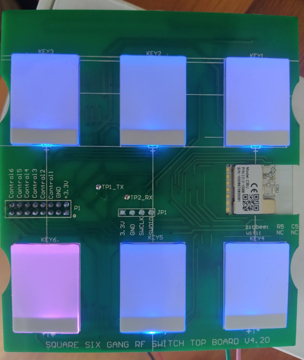

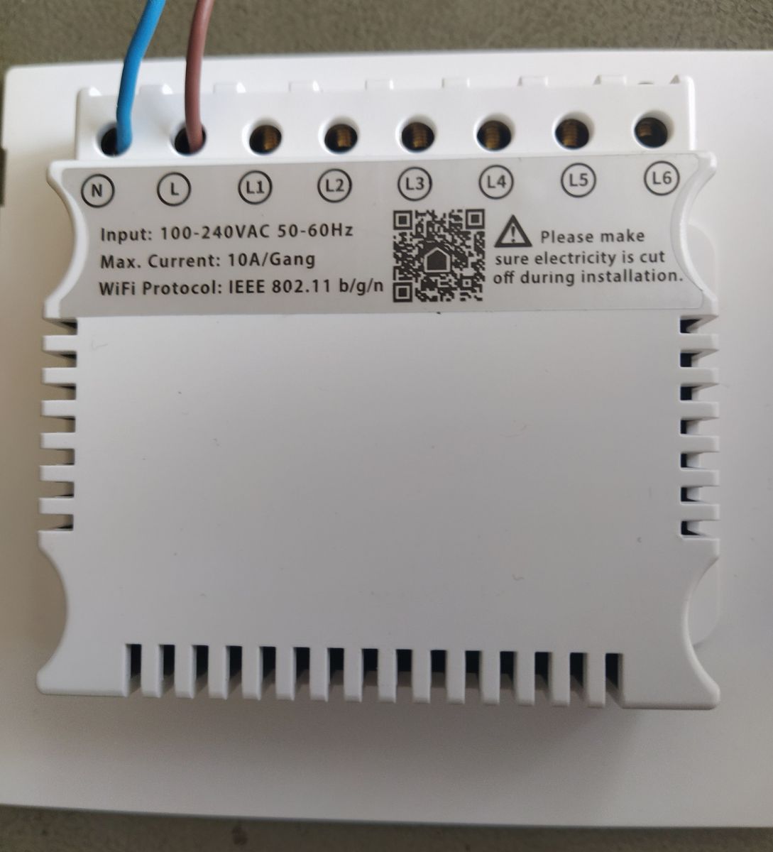

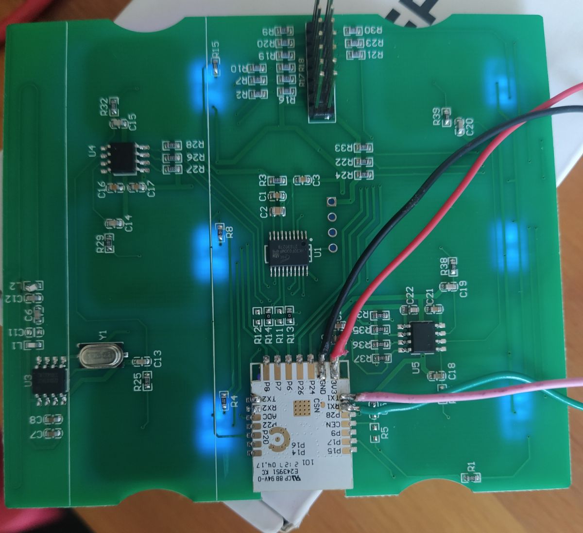

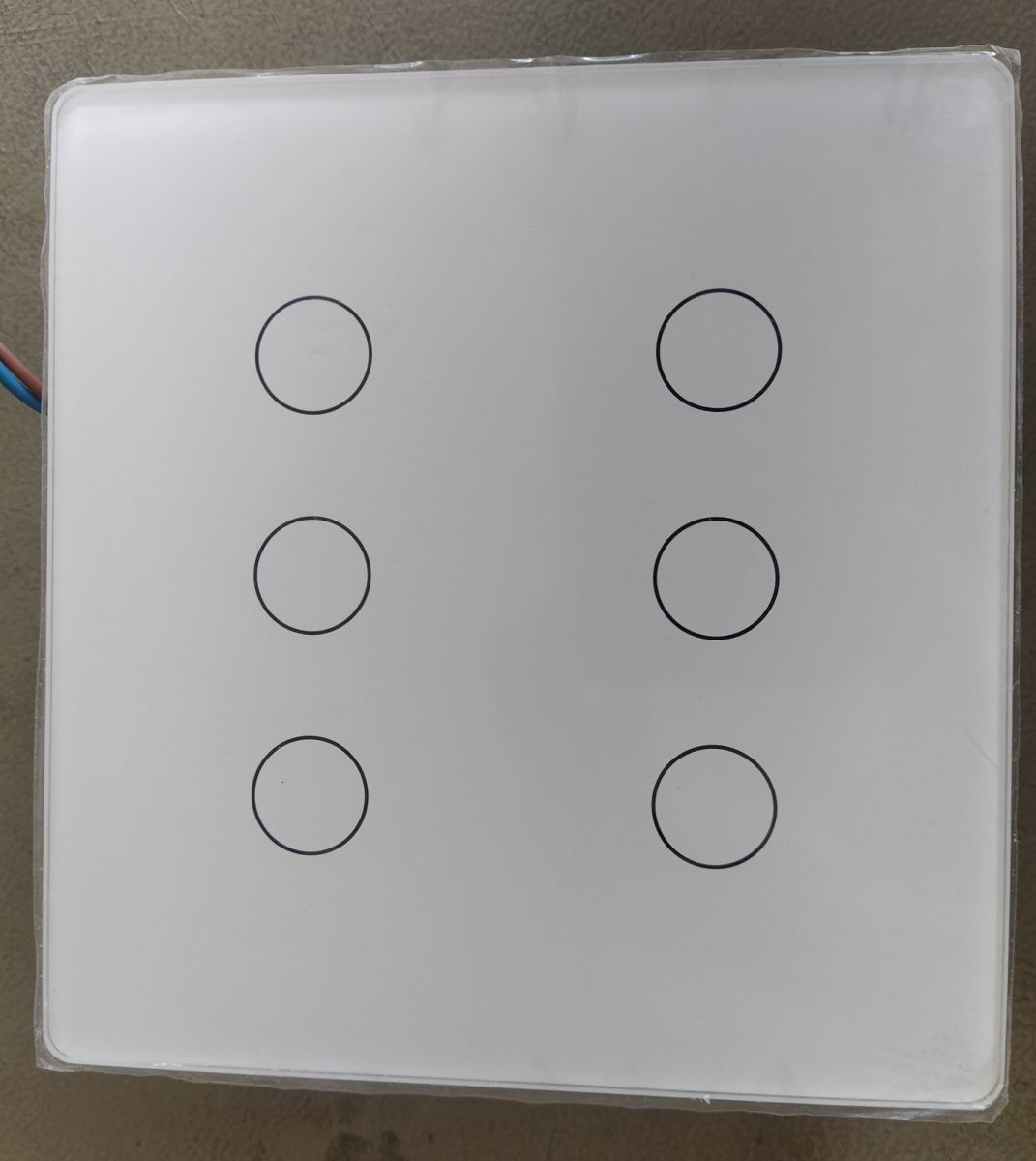

    This is a short teardown of the AVATTO Tuya Brazil 4x4 WiFi Wall Switch, 4/6 Gang Light Switch.
    This is available on AliExpress
    This is very similar to https://www.elektroda.com/rtvforum/topic3963972.html#20484235 but also has a backlight. I assume that this is just another channel.
    Disassembly is very easy, the glass front cover unclips and the two PCBs can be pulled apart.
    The front PCB has the touch sensors and CBU module and the rear PCB has all the power electronics.

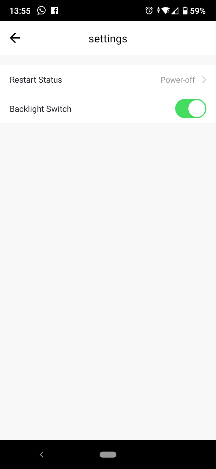

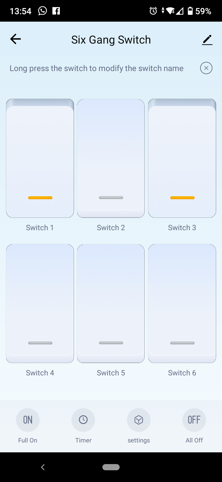

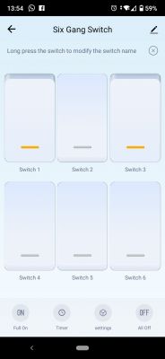

    The App looks like this and you can see the Backlight control.
    [BK7231N] [CBU] AVATTO Tuya Brazil 4x4 WiFi Wall Switch 4/6 Gang [BK7231N] [CBU] AVATTO Tuya Brazil 4x4 WiFi Wall Switch 4/6 Gang
    I have tried to sniff the comms between the [CBU] and the [HK32F030MF4P6] with no success. I am not sure what I am doing wrong. Maybe someone can point me in the correct direction. I am reluctant to flash the device until I know that I will be able to use it with OpenBK.

  • Suspected touch ICs and serial pin mapping on BK7231N board
    #5 20565974
    tomanyusers
    Posts: 34
    Hi
    There are no comms between the [CBU] and the [HK32F030MF4P6] via serial. It is however connected. The resistors R11-R14 are selectable between the first and second serial on the [CBU]. At the moment set to use the first (default) serial. There are no serial coms on either serial.
    There are also lines from P14 and P16 that are linked to the [HK32F030MF4P6]. Think there are the SPI pins.
    I'm using the pin symbols from Tuya Dev Docs
    The Tx and Rx are connected to Pins 13 and 14 on the [HK32F030MF4P6]
    The relays are also wired directly to the [CBU] on these pins P24,P26,P6,P7,P8,P28.
    I think the Wifi LED might be on P17 (Not confirmed)
    The ADC pin is also linked to the [HK32F030MF4P6]. Not sure why.
    Some of the other lines from the [CBU] also seem to link to the other IC's.
    P16 to U4 (Pin7)
    P9 to U5 (Pin7)
    U4 and U5 are unmarked. There are two of them I suspect that there are IC's responsible for touch sensing. Also Unconfirmed.
    I'm not sure how to proceed from here.

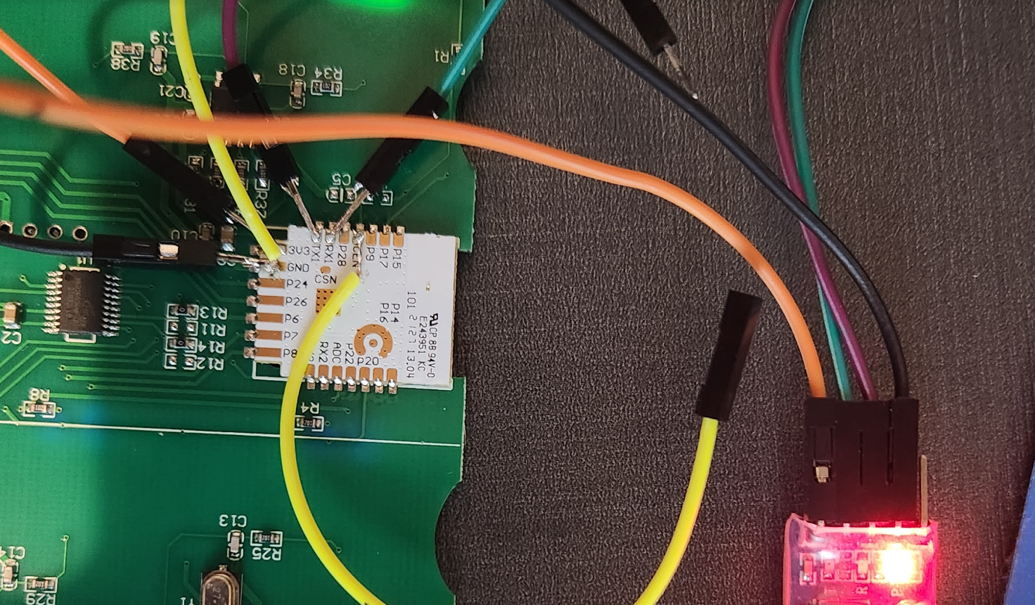

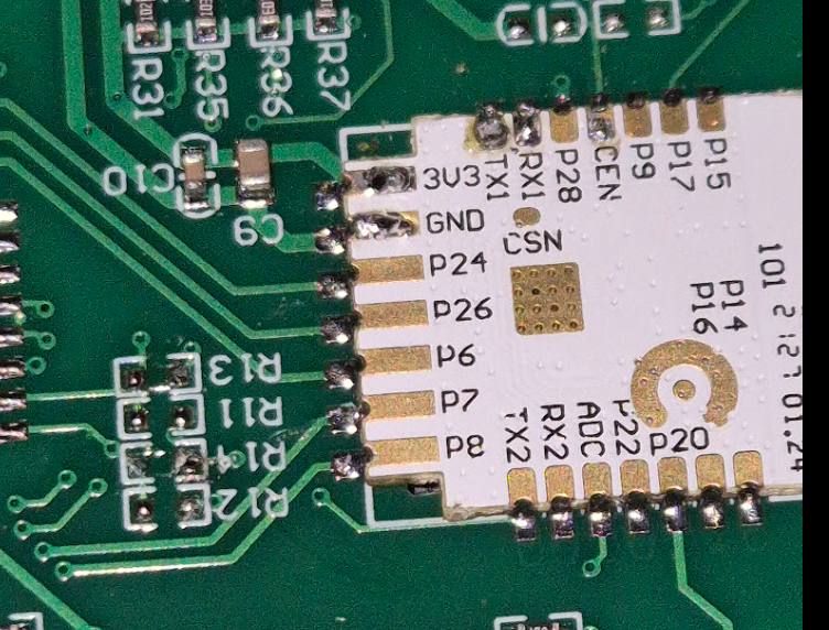

    Well, I gathered some courage and tried to read/flash my Avatto (CBU) to OpenBeken. I used the CEN and GND jumpers to try to put the CBU in flash mode. The soldering scheme is shown in the image below.
    Close-up of a circuit board with connected wires and a CBU chip.
    During this process, I confirmed what @tomanyusers said in the first message of this topic: it is not possible to read/write the CBU chip on the board. It might be possible if the chip is removed from the board, but I need to gather more courage to do that!
    Maybe @guilhermemaciel can give more details about his flashing process; this would help a lot!

    Maybe you can just cut the traces? Where are the RX1/TX1 traces going on the board? I can't see clearly on the photo, the wires are occluding that

    Hmm... it's not a photo problem; the traces are on the other side of the board, connecting TX1 and RX1 to R13 and R14. Those are really tiny traces, and I'm not comfortable cutting them. I tried to use a desoldering pump to break the connection between the CBU and the board on TX1/RX1, but without success. I think I need more equipment and much more skill with soldering. However, I really think that CBU is a piece of junk, so I bought an ESP8685-WROOM-06-H4 (ESP32-C3) to replace it. Of course, I'll be helped by a friend to do it! Before burning the CBU in a fire, I will try to flash it again, this time with it off the board.

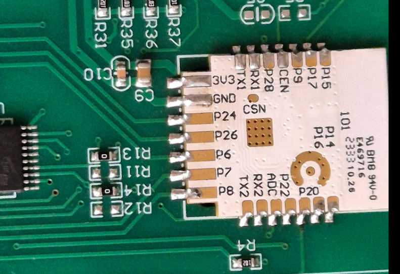

  • OpenBeken pinout and flashing notes for AVATTO switch
    #25 21209658
    arlindo
    Posts: 10
    Hi guys,
    I did some tests and I'm bringing back my findings to share with you:
    Firstly, it's not possible to swap the CBU chip for the ESP8685-WROOM-06-H4 with 100% compatibility, as I initially thought! These two chips have significant differences in their IO (and their positions), which makes it difficult to get them to work.
    Secondly, it was necessary to remove the CBU chip to reprogram it. In this case, there was no difficulty in flashing; OpenBeken works like a charm after flashing! As you can see in the figure, the R13 and R14 (which connect TX1 and RX1 to the HK32F030MF4P6) are zero-ohm resistors. What is the function of a zero-ohm resistor here? Is it just a jumper? If so, it can be removed for flashing and then reconnected with soldering afterward.
    Close-up of a PCB with an ESP8685-WROOM-06-H4 module and zero-ohm resistors R13 and R14.
    Finally, the CBU and OpenBeken work perfectly with the "AVATTO Tuya Brazil 4x4 WiFi Wall Switch 6 Gang," and the pin configuration is below (I'll share this on GitHub ASAP).

    The resistors on RX/TX traces are most likely just jumpers. It should work fine without them. As you said, it;s not possible to flash while the connection to TuyaMCU is present. That's why we either cut the traces (desolder resistors if possible) or desolder whole MCU/WiFi module.
  • #27 21210029
    arlindo
    Posts: 10
    I confirm that! I removed R13 and R14 in another device, flashed the firmware, and used soldering to reconnect the jumpers. Everything is working normally, but now with OpenBeken!
    Close-up of a printed circuit board with an attached module and visible soldering.
