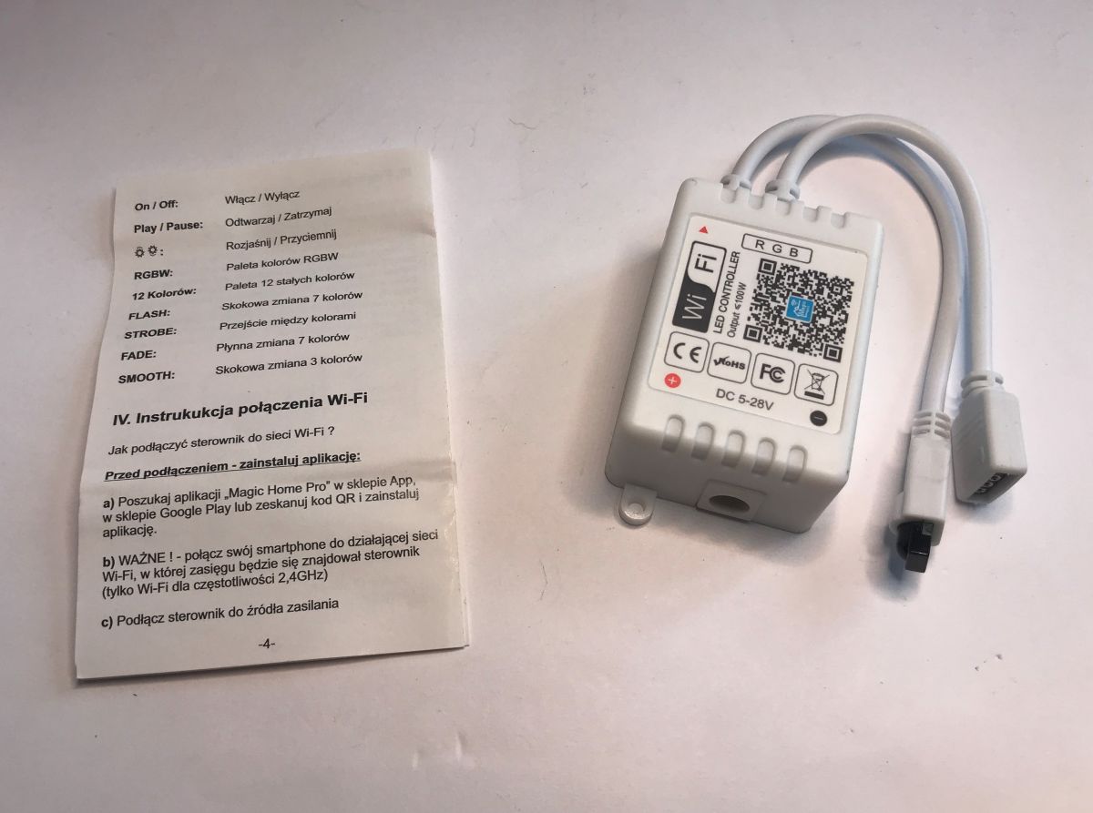

    The QR code on the device, however, explains everything - it leads to the aforementioned Magic Home app.
    Wi-Fi RGB LED controller with QR code and cables in an open box
    An IR remote control and instructions are also included.
    EC79900 LED controller with IR remote and manual on white background Wi-Fi LED controller and user manual with Magic Home setup instructions
    The instructions describe pairing the device with the manufacturer's app, this is of no use to me.
    User manual for RGB LED Wi-Fi/IR controller with 24-button remote control Magic Home controller manual showing pairing steps and two QR codes

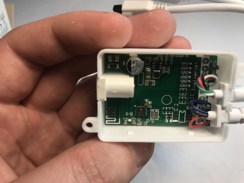

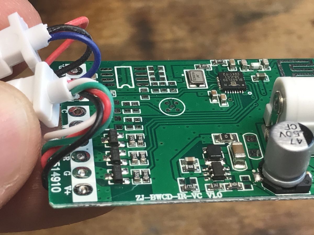

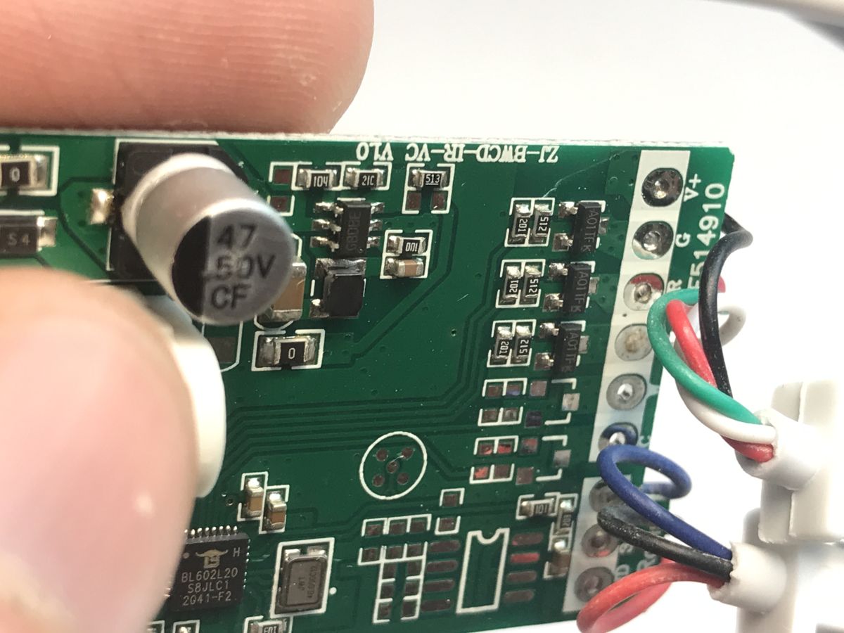

    Interior of EC79900
    Just lift the cover, it is on the hooks.
    Inside the EC79900 LED controller showing PCB with BL602 microcontroller

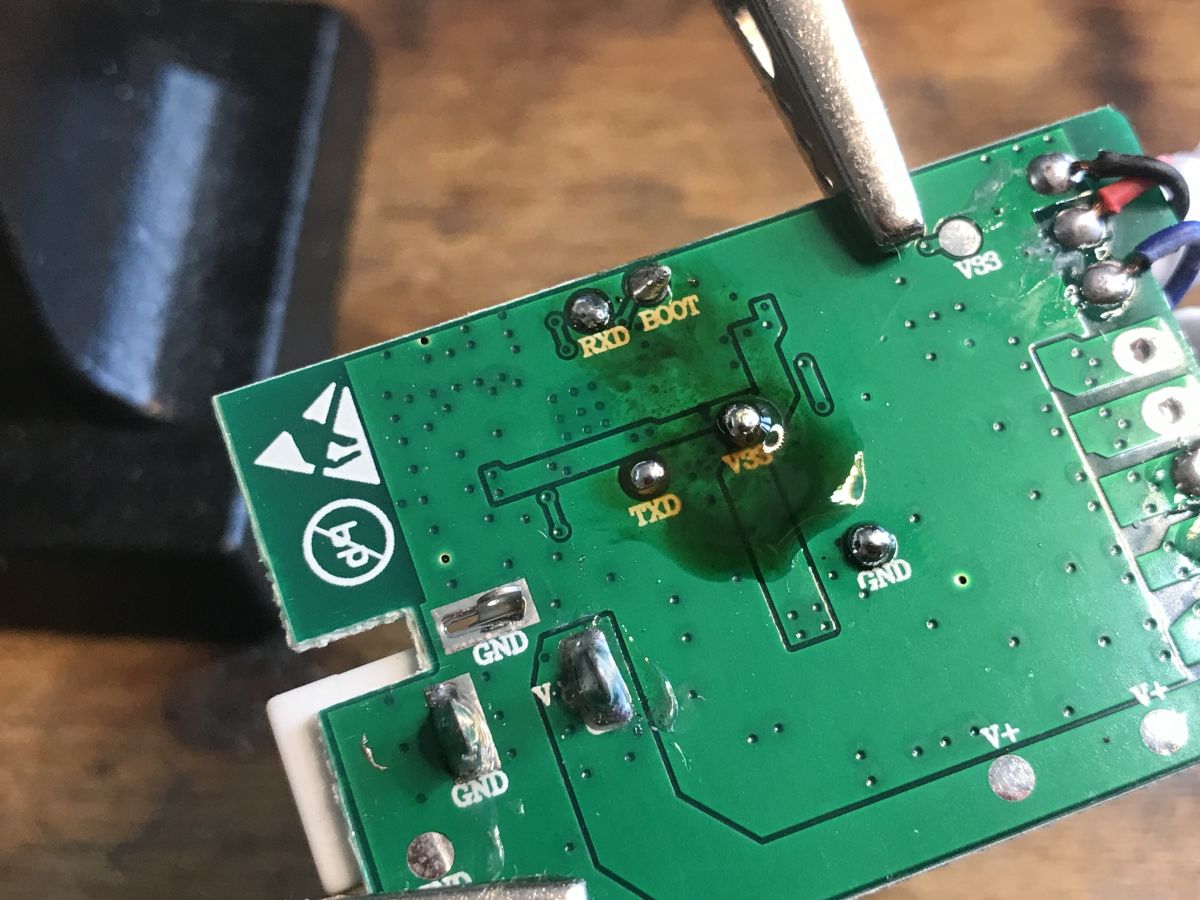

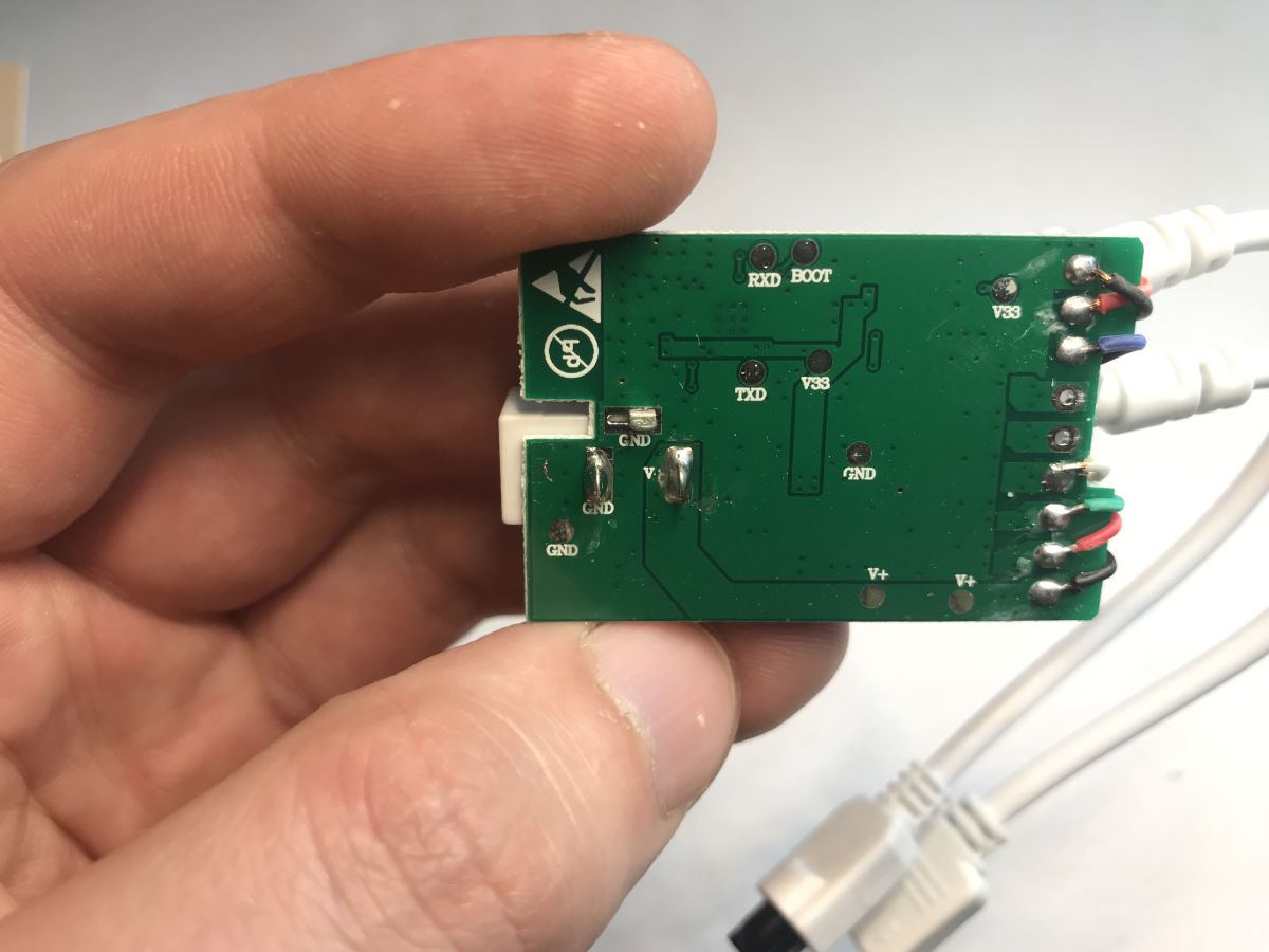

    On the bottom of the PCB are the pads for programming, that is the UART and the BOOT (bootloader start) signal. In addition, we also have the power supply.
    EC79900 LED controller PCB bottom with UART pads and labeled connections

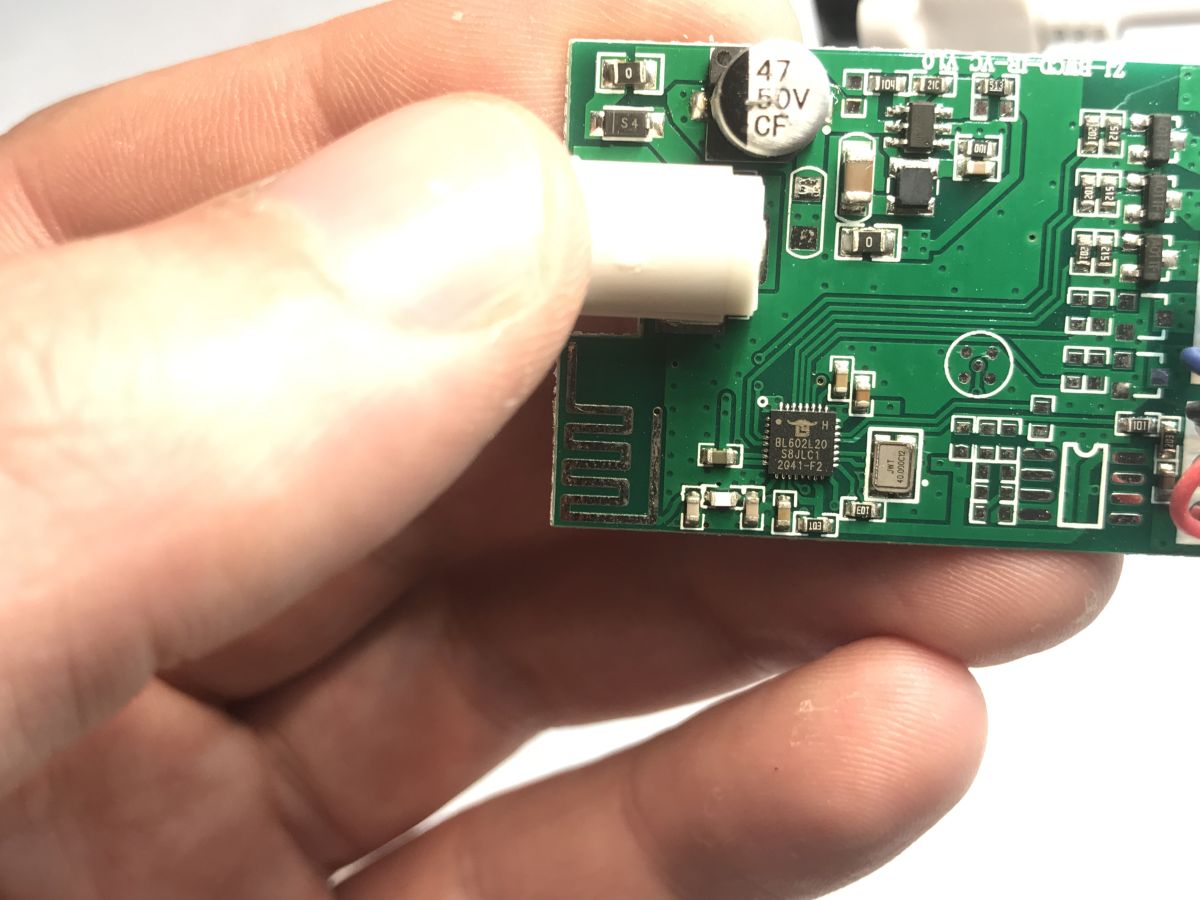

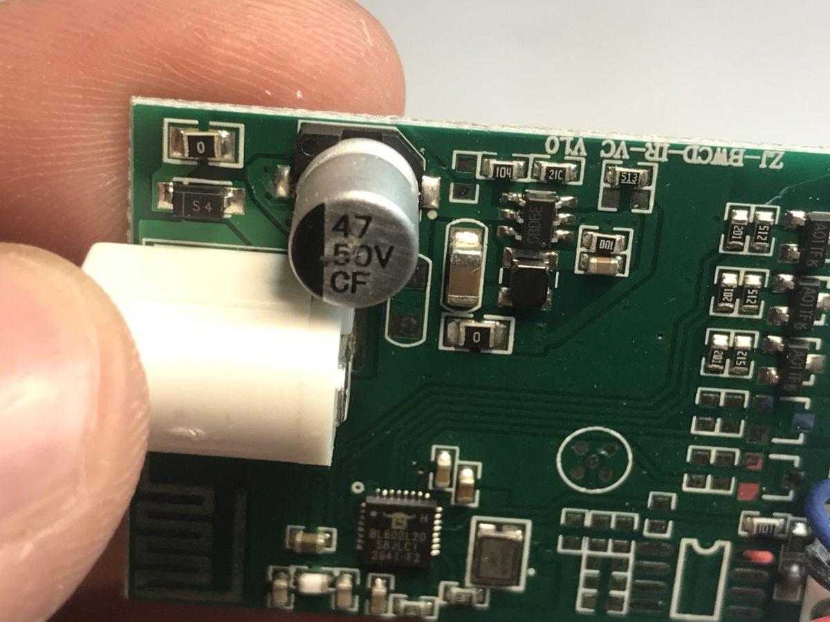

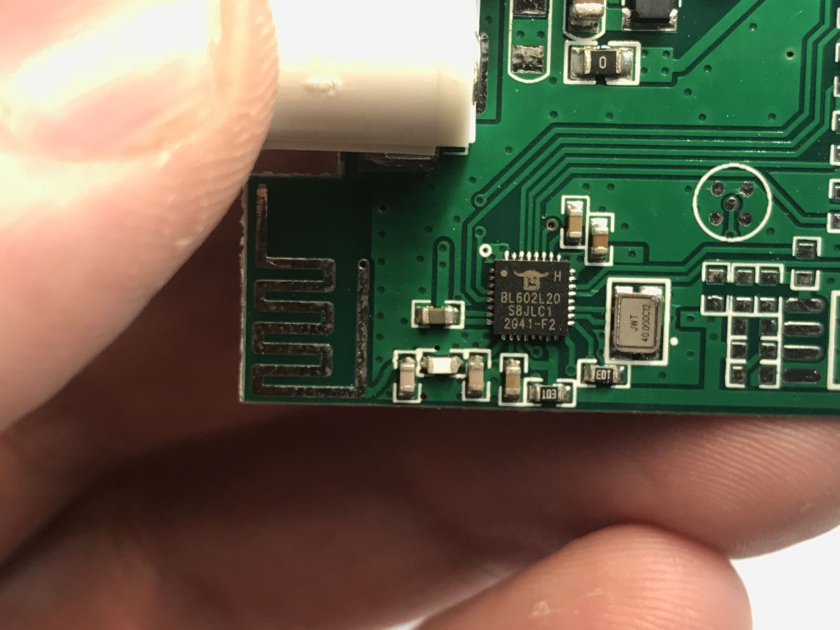

    The whole thing is supported by the aforementioned BL602 together with a quartz resonator. The antenna from the Wi-Fi is on the board. Next to it is a free slot for an RF chip (radio remote control receiver). In the power section there is a GBDBE step-down inverter, so that from 12 V for the bar we can get 3.3 V for the MCU. Three small transistors control the RGB colours, the PCB potentially supporting up to 5 channels - i.e. RGB and CCT.
    Close-up of a PCB with BL602 microcontroller and power components
    Additional images:
    Close-up of BL602L20 chip on a green PCB with printed Wi-Fi antenna. Close-up of PCB with BL602 microcontroller and connected colored wires. Close-up of EC79900 PCB with 47µF 50V capacitor and BL602 microcontroller visible
    PCB with BL602 microcontroller and RGB terminal connections Close-up of a PCB with BL602 microcontroller and connected RGB wires EC79900 PCB with RGB wires connected and BL602 microcontroller visible

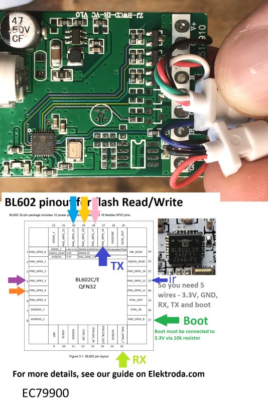

    The board is so simple that you can draw out the connections and apply them to the photo:
    Close-up of EC79900 PCB with BL602 microcontroller and UART pin labels

    We are whitewashing the pads:
    Bottom of EC79900 PCB showing UART and BOOT pads

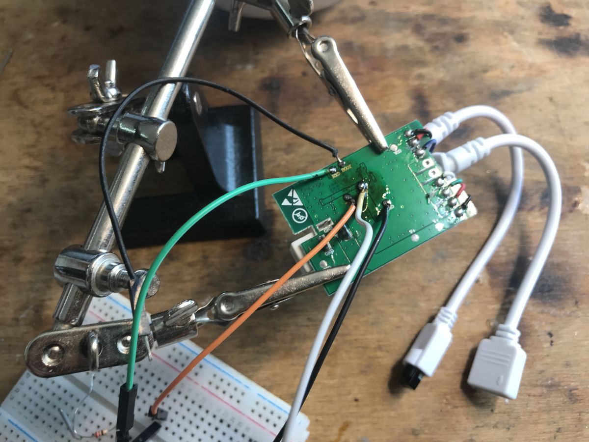

    We solder the cables:
    EC79900 LED controller with UART wires soldered for programming

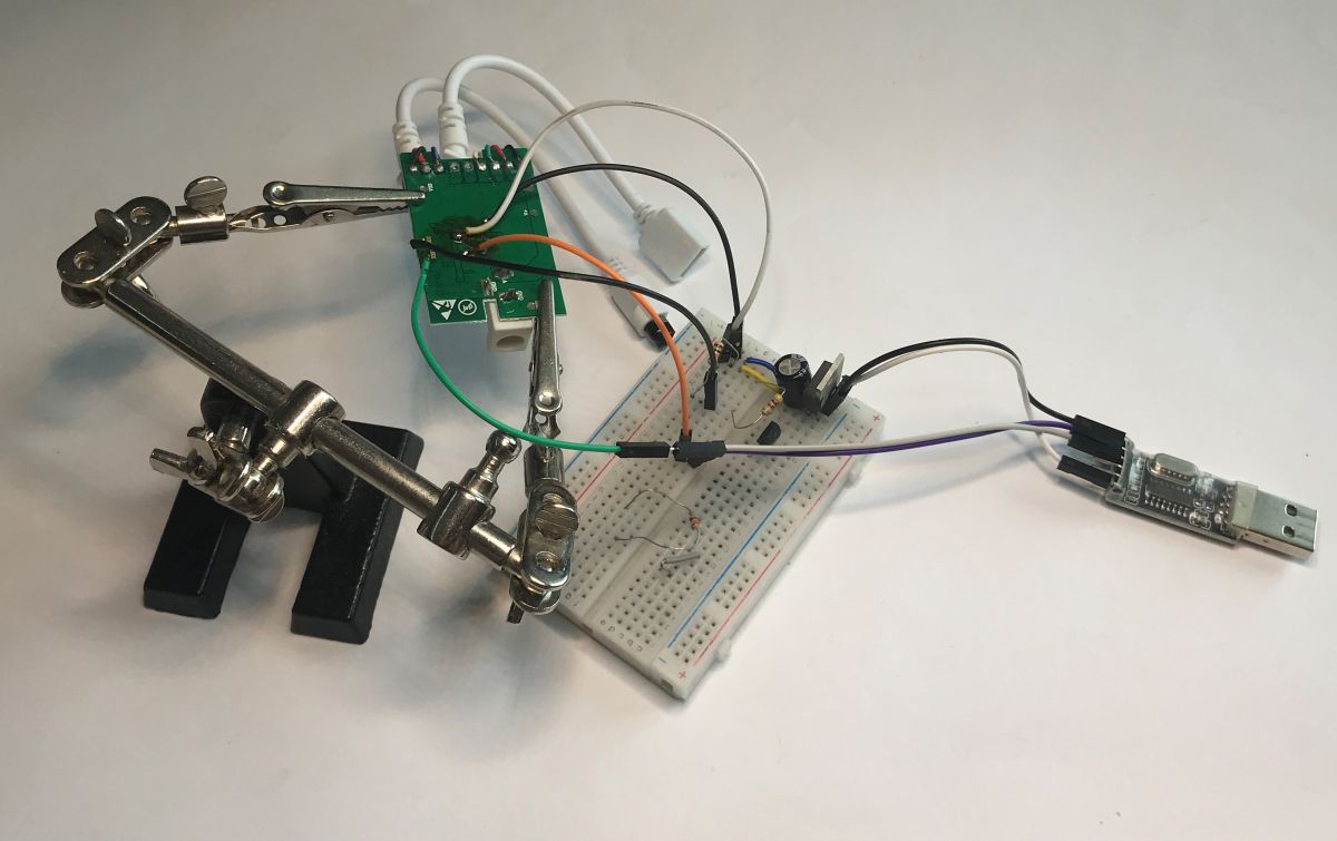

    The rest as in the indicated material - USB to UART converter and 3.3 V LDO:
    Flashing EC79900 board with BL602 via USB-UART adapter

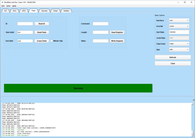

    I also backed up the firmware (MagicHome-EC79900-LedStrip-RGB-0x1FFFFF-fromBLDevCubev190):
    Screenshot of Bouffalo Lab Dev Cube 1.9.0 interface showing “Success” in green bar
    https://github.com/openshwprojects/FlashDumps/tree/main/IoT/BL602
    After programming, set the pins according to my spreadsheet. PWM is GPIO3, GPIO4 and GPIO21, optionally also GPIO20 and GPIO17 (depends on how many channels you have a version for) and GPIO12 is the IR receiver. The IR controller on the BL602 is a work in progress and is based on the IRremoteESP8266. When configuring IR events, you can follow the material on the BK7238:
