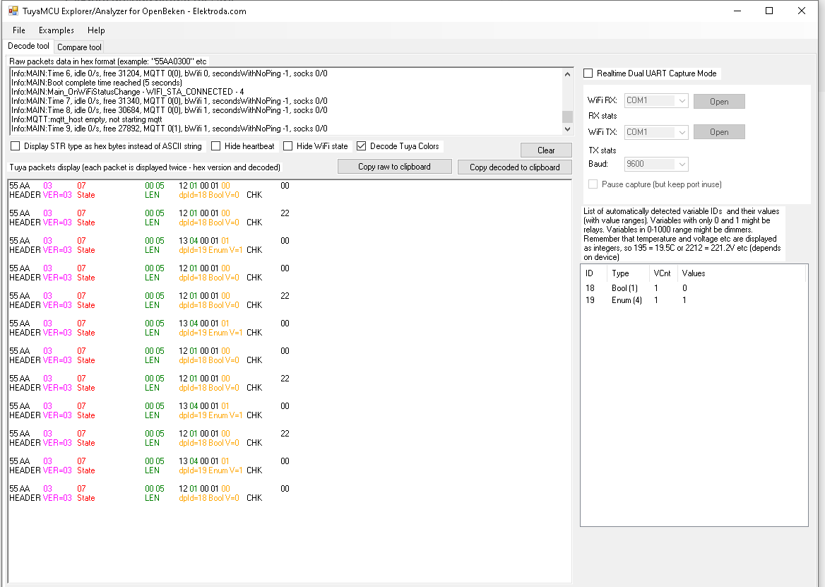

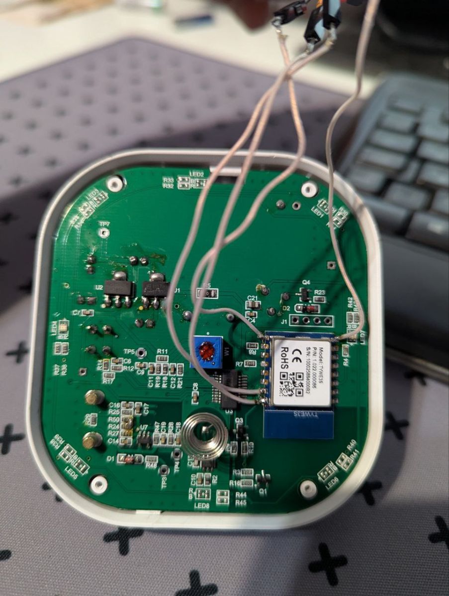

    Good afternoon!
    I bought a CO CH4 (gas) sensor for my boiler room a while ago.
    Here's the link to AliExpress.
    https://aliexpress.ru/item/1005009156680185.html
    The marking inside is SNT961W.
    Chip TYWE3S (ESP8266 2MB)
    I flashed the OpenBK, but after activating the TuyaMCU in autoexec, the sensor blinks blue twice, then purple, and beeps, repeating indefinitely. I think the TuyaMCU chip itself is rebooting. ESP works without rebooting.
    The same thing happened when I tried to restore the original firmware without filling all the bytes with zeros first.
    The logs that were running at that moment only show 2 dpID.
    You can see it in the screenshot.
    What do you recommend?
    I collected the dpID information from the original firmware.

    Screenshot of TuyaMCU Explorer/Analyzer with decoded hex and data packets
    Close-up of a circuit board with electronic components and connected wires

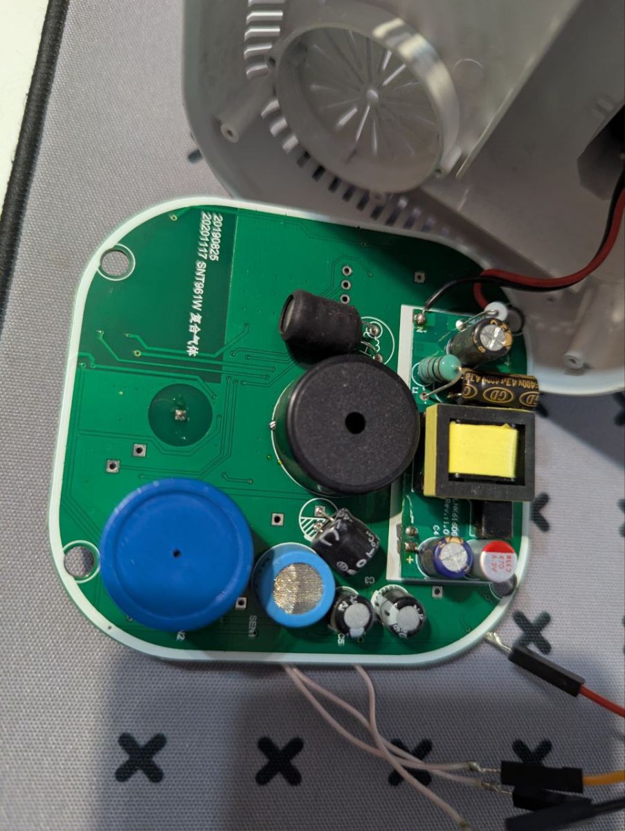

    Printed circuit board with electronic components and connected wires
    AI: Which exact version of OpenBK did you flash, and could you share your configuration settings (especially any changes made before enabling TuyaMCU)?
    Last versoin on github for ESP8266 chip
    AI: How are you activating TuyaMCU in your autoexec—could you provide the specific commands or configuration steps you used?
    // Start TuyaMCu driver
    startDriver TuyaMCU
    // Set baud (as key was 9600)
    tuyaMCU_setBaudRate 9600
    // If using MQTT comment out tuyaMcu_defWiFiState 4
    // waitFor MQTTState 1
    // Mappings [dpID] [varType] [tgChannel]
    // CO - map dpID 35, type var(2) to Ch 1
    setChannelLabel 1 "CO value"
    setChannelType 1 ReadOnly
    linkTuyaMCUOutputToChannel 35 2 1
    // co_state - map dpID 34, type enum(4) to Ch 2
    setChannelLabel 2 "CO state (1 Alarm, 0 Normal)"
    setChannelType 2 ReadOnly
    linkTuyaMCUOutputToChannel 34 4 2
    // Detected Gas" dpID 26, type var(2) to Ch 1
    setChannelLabel 3 "Gas value"
    setChannelType 3 ReadOnly
    linkTuyaMCUOutputToChannel 26 2 1
    // Gas Detection State - map dpID 25, type enum(4) to Ch 2
    setChannelLabel 4 "Gas detection state (1 Alarm, 0 Normal)"
    setChannelType 4 ReadOnly
    linkTuyaMCUOutputToChannel 25 4 2
    • Tuya_orig_gas_alarm_tywe3s_esp82XX.bin (2 MB) You must be logged in to download this attachment.

    Info:TuyaMCU:Consumed 120 unwanted non-header byte in Tuya MCU buffer
    Info:TuyaMCU:Skipped data (part) 03 00 00 00 41 01 B2 00 04 00 00 00 00 00 02 85 00 00 00 00 5F 00 5E 01 00 67 00 00 37 00 00 00 00 00 00 00 00 00 00 00 00 00 0F 7B 7B 03 01 00 FE 00 00 00 07 00 00 00 00 BC 01 40 AA 55 B4 FF 00 8A 00 00 00 00 72 02 9E 00 00 12 00 00 00 00 00 00 00 00 00
    Info:TuyaMCU:Consumed 38 unwanted non-header byte in Tuya MCU buffer
    Info:TuyaMCU:Skipped data (part) 00 00 00 00 00 00 03 00 00 FB 59 55 0F 00 00 00 00 00 04 00 80 03 0B 0D B7 05 00 15 1B 1B FF 00 03 00 00 00 00 FF
