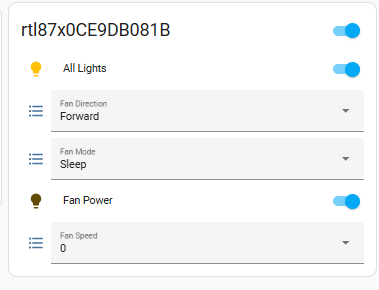

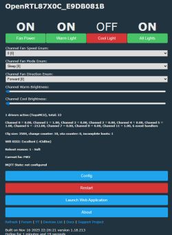

    I don't have the real thing of course but I did stick your autoexec into OpenRTL87x0C tester and I am not getting any web console access issues
    OpenRTL87X0C web interface showing fan and light status controls
    Control panel for device rtl87x0CE9DB081B with lights and fan enabled
  • #3 21754486
    jeremysalwen
    >>21754415
    Thank you. I figured out that it was old configuration that I needed to clear out using ClearIO. I thought rebooting would clear everything not in my autoexec.bat, so I was confused.
    Do you have suggestions of how to make it appear properly in Home Assistant as a single light fan?

    Added after 5 [hours] 50 [minutes]:
    Okay, I got it working good enough as a virtual light. The only thing that is not totally great is that brightness changes from the remote are not reflected in openbeken/homeassistant (although color temperature changes, aka the power states of the two leds, are). I had to use a manual homeassistant mqtt configuration

    alias DoSyncVirtualFromPhysical backlog setChannel 13 ($CH6+$CH8)/2; setChannel 12 1000*$CH8/($CH6+$CH8);
    alias SyncVirtualFromPhysical backlog if $CH6!=0||$CH8!=0 then DoSyncVirtualFromPhysical else "setChannel 13 0"
    # Virtual light handlers
    # Any change of Brightness or CT should recompute mix
    addEventHandler OnChannelChange 12 RecalcCCT
    addEventHandler OnChannelChange 13 RecalcCCT
    # When All Lights is turned ON, turn both lights ON
    AddChangeHandler Channel11 == 1 backlog SetChannel 5 1;SetChannel 7 1
    # When All Lights is turned OFF, turn both lights OFF
    AddChangeHandler Channel11 == 0 backlog SetChannel 5 0;SetChannel 7 0
    # Keep virtual Light in sync with PHYSICAL Tuya switches
    # (so local MCU buttons still affect CH11 state)
    # If either individual light is turned ON, set master Light = ON
    AddChangeHandler Channel5 == 1 SetChannel 11 1
    AddChangeHandler Channel7 == 1 SetChannel 11 1
    # If a light is turned OFF, and BOTH are now OFF, set master Light = OFF
    AddChangeHandler Channel5 == 0 if $CH5==0&&$CH7==0 then SetChannel 11 0
    # You can also enable this if you want symmetrical behaviour:
    AddChangeHandler Channel7 == 0 if $CH5==0&&$CH7==0 then SetChannel 11 0
    # Initial sync at boot
    if $CH5!=0||$CH7!=0 then SetChannel 11 1
    HomeAssistant Configuration:
    mqtt:
    fan:
    - name: "Living Room Fan 1"
    unique_id: "livingroomfan1.fan"
    state_topic: "livingroomfan1/1/get"
    command_topic: "livingroomfan1/1/set"
    payload_on: "1"
    payload_off: "0"
    availability_topic: "livingroomfan1/connected"
    payload_available: "online"
    payload_not_available: "offline"
    qos: 1
    retain: true
    # ---- Speed as percentage mapped to Enum 0..10 on Channel 2 ----
    percentage_state_topic: "livingroomfan1/2/get"
    percentage_command_topic: "livingroomfan1/2/set"
    # Home Assistant UI is 0–100%, Tuya speed is 0–10
    speed_range_min: 1
    speed_range_max: 100
    percentage_value_template: >
    {# MQTT payload (channel 2) is 0..10, convert to 0..100% #}
    {% set s = value | int %}
    {{ (s * 100 / 10) | round(0) }}
    percentage_command_template: >
    {# HA sends 0..100%, convert back to 0..10 enum #}
    {% set p = value | int %}
    {% if p <= 0 %}
    0
    {% elif p >= 100 %}
    10
    {% else %}
    {{ (p * 10 / 100) | round(0) }}
    {% endif %}
    # ---- Direction (Channel 4: 0=Forward, 1=Reverse) ----
    direction_state_topic: "livingroomfan1/4/get"
    direction_command_topic: "livingroomfan1/4/set"
    direction_value_template: >
    {% if value | int == 1 %}
    reverse
    {% else %}
    forward
    {% endif %}
    direction_command_template: >
    {% if value == 'reverse' %}
    1
    {% else %}
    0
    {% endif %}
    # ---- Modes mapped to your Fan Mode enum on Channel 3 ----
    # CH3: 0:Sleep 1:Normal 2:Nature
    preset_modes:
    - sleep
    - normal
    - nature
    preset_mode_state_topic: "livingroomfan1/3/get"
    preset_mode_command_topic: "livingroomfan1/3/set"
    preset_mode_value_template: >
    {% set v = value | int %}
    {% if v == 0 %}
    sleep
    {% elif v == 1 %}
    normal
    {% elif v == 2 %}
    nature
    {% else %}
    normal
    {% endif %}
    preset_mode_command_template: >
    {% if value == 'sleep' %}
    0
    {% elif value == 'normal' %}
    1
    {% elif value == 'nature' %}
    2
    {% else %}
    1
    {% endif %}
    device:
    identifiers: ["livingroomfan1"]
    manufacturer: "OpenBeken"
    model: "Tuya Fan (BK7231)"
    configuration_url: "http://192.168.1.213/index"
    light:
    - name: "Living Room Fan 1 Light"
    unique_id: "livingroomfan1.light"
    # Master power (Channel 11)
    state_topic: "livingroomfan1/11/get"
    command_topic: "livingroomfan1/11/set"
    payload_on: "1"
    payload_off: "0"
    qos: 1
    retain: true
    # --- Brightness (Channel 13: 0..1000) <-> 0..255 in HA ---
    brightness_state_topic: "livingroomfan1/13/get"
    brightness_command_topic: "livingroomfan1/13/set"
    brightness_value_template: >
    {# 0..1000 (OBK) -> 0..255 (HA) #}
    {{ (v * 255 / 1000) | round(0) }}
    brightness_command_template: >
    {# 0..255 (HA) -> 0..1000 (OBK) #}
    {% set b = value | int %}
    {% if b <= 0 %}
    0
    {% elif b >= 255 %}
    1000
    {% else %}
    {{ (b * 1000 / 255) | round(0) }}
    {% endif %}
    # --- Color temperature: Channel 12 (0..1000 warm->cool) ---
    # Map to mired range ~2700K..6500K
    color_temp_state_topic: "livingroomfan1/12/get"
    color_temp_command_topic: "livingroomfan1/12/set"
    # These should match the range you want in HA
    min_mireds: 153 # ~6500K (cool)
    max_mireds: 370 # ~2700K (warm)
    color_temp_value_template: >
    {# 0..1000 (0=warm,1000=cool) -> mireds (370..153) #}
    {% set min_m = 153 %}
    {% set max_m = 370 %}
    {% set v_clamped = [1000, [0, v] | max] | min %}
    {{ (max_m - (v_clamped * (max_m - min_m) / 1000)) | round(0) }}
    color_temp_command_template: >
    {# mireds (370..153) -> 0..1000 (0=warm,1000=cool) #}
    {% set m = value | int %}
    {% set m_clamped = [max_m, [min_m, m] | max] | min %}
    {{ ((max_m - m_clamped) * 1000 / (max_m - min_m)) | round(0) }}
    # Optional: same device grouping as the fan
    device:
