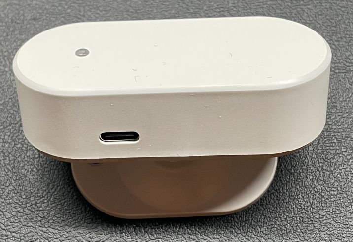

    Tuya 24GHz radar sensor with Wi-Fi
    model: ZG-205WB
    Source: i.e. https://de.aliexpress.com/item/1005005904142527.html

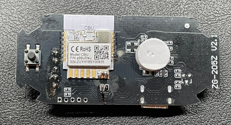

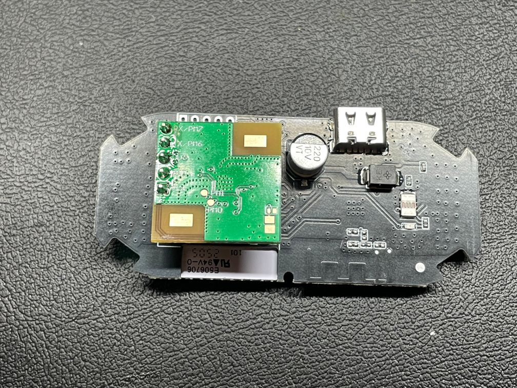

    The radar sensor is made by Tuya-module CBU.
    All needed pins are accessible. You can flash it without dismounting the module.
    White Tuya ZG-205WB radar sensor with USB-C port on dark textured surface
    Tuya ZG-205WB radar sensor module with CBU board and USB connector visible
    Radar module ZG-205Z V2.1 with Tuya CBU chip on black textured surface
    There are only the TX and RX pins used.
    All communication is serial with the Tuya coprocessor.
    Note: If you power it with 3.3 V direct on CBU - the Tuya coprocessor does not work.
    I do not use HA but IP-Symcon. That is why I cannot say anything about HA-integration.
