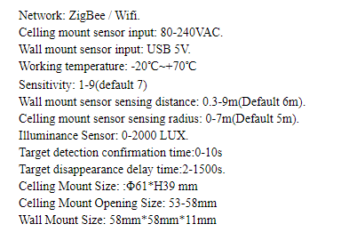

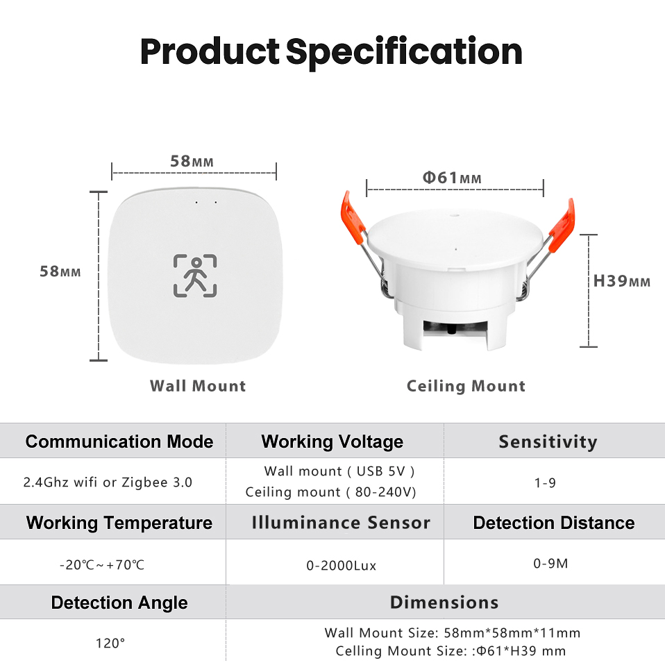

    Here is the product specification. Power is from 5V, the product offers motion detection in the range of distance set by the user, as well as performs lighting measurement:
    Radar with WiFi - TuyaMCU, OpenBeken, own configuration page hosted on the devic
    Dimensions and promotional graphics:

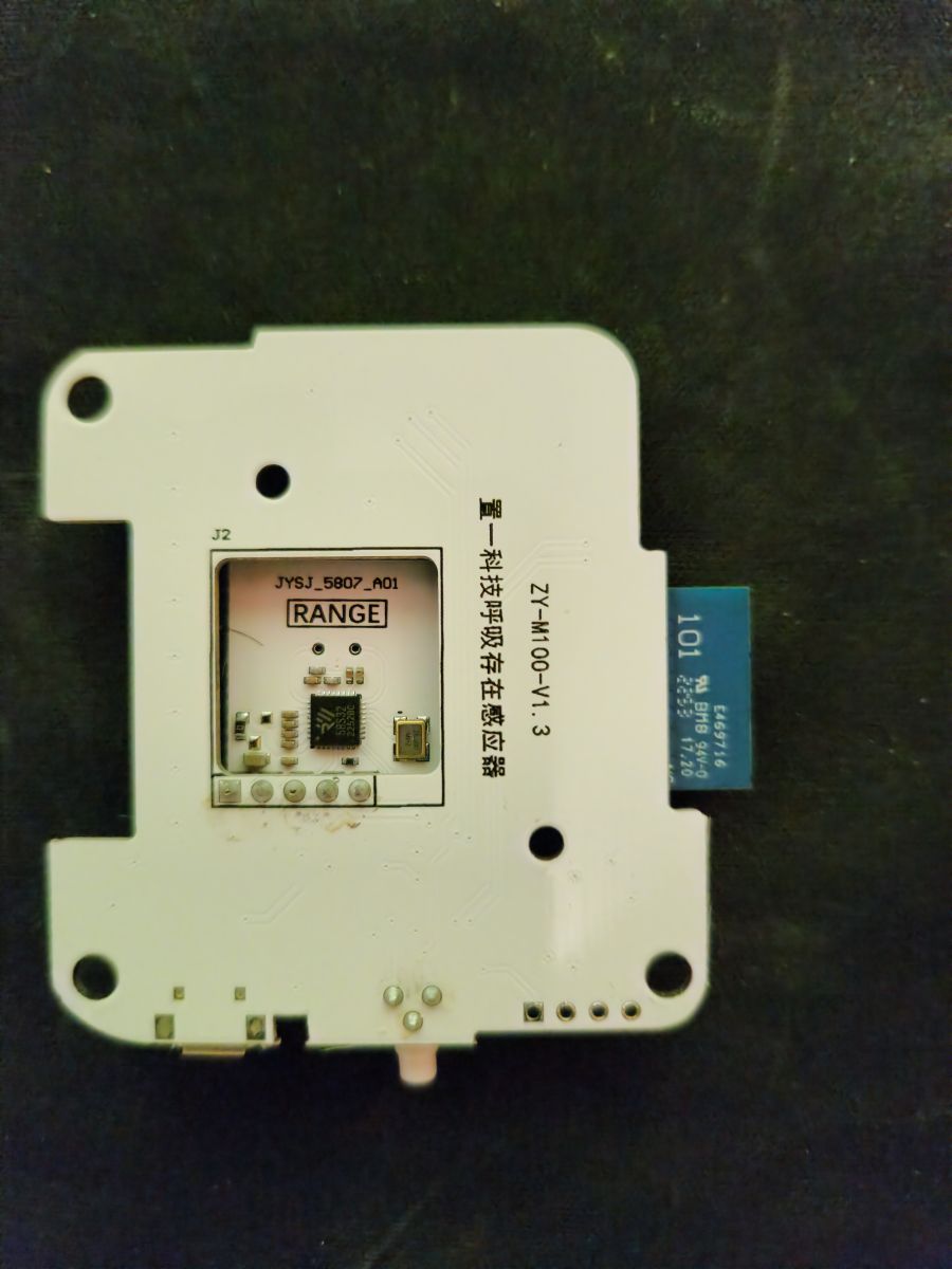

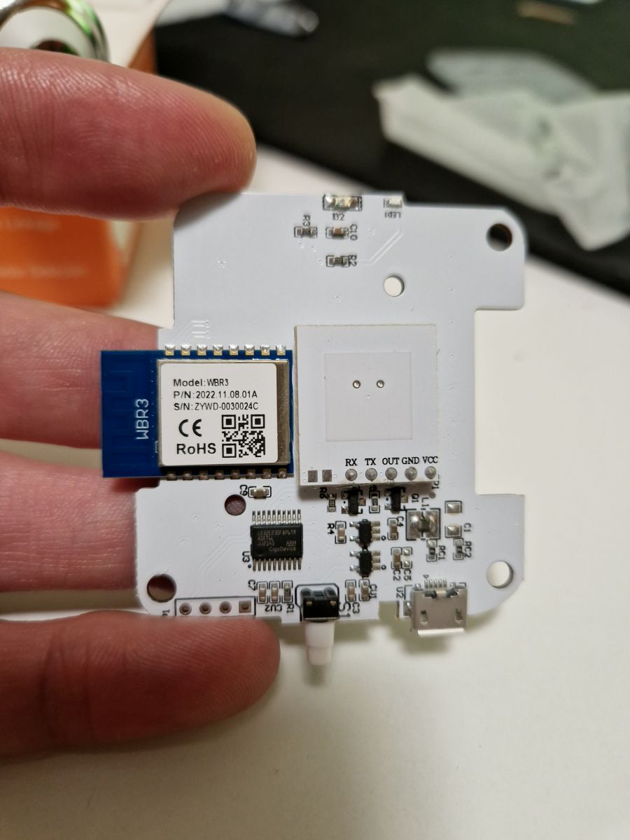

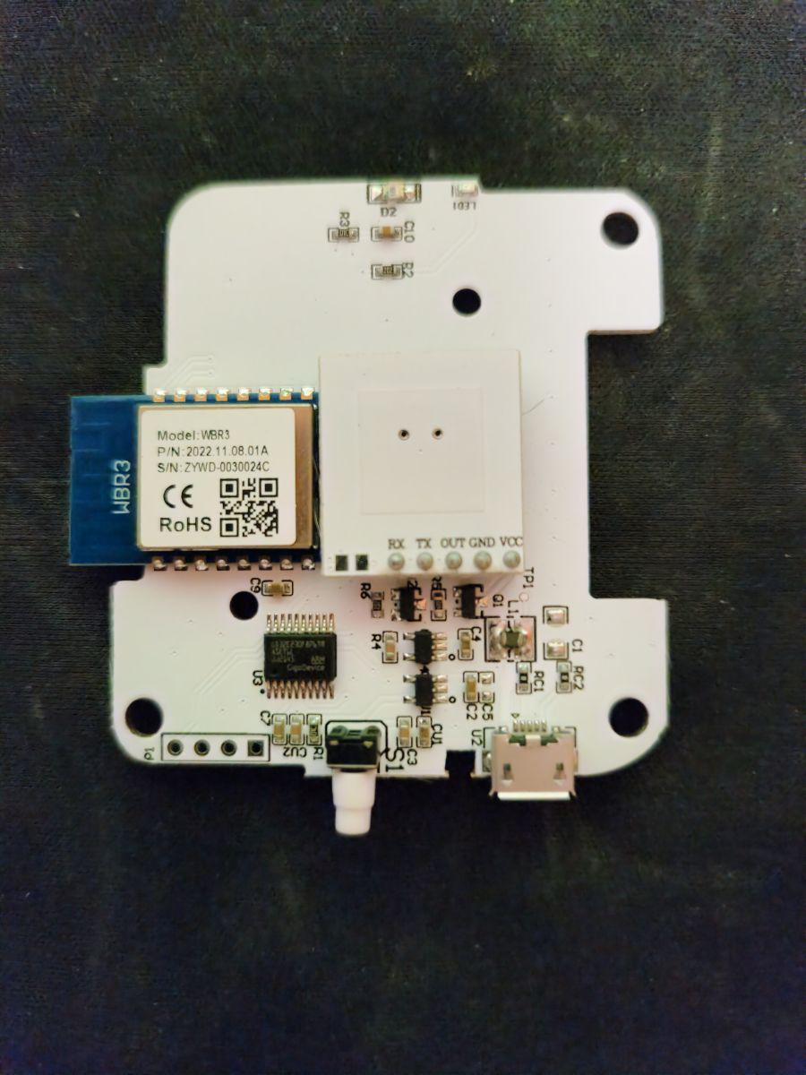

    The contents of the package, inside
    We look at what we got. The housing is held on the catches.

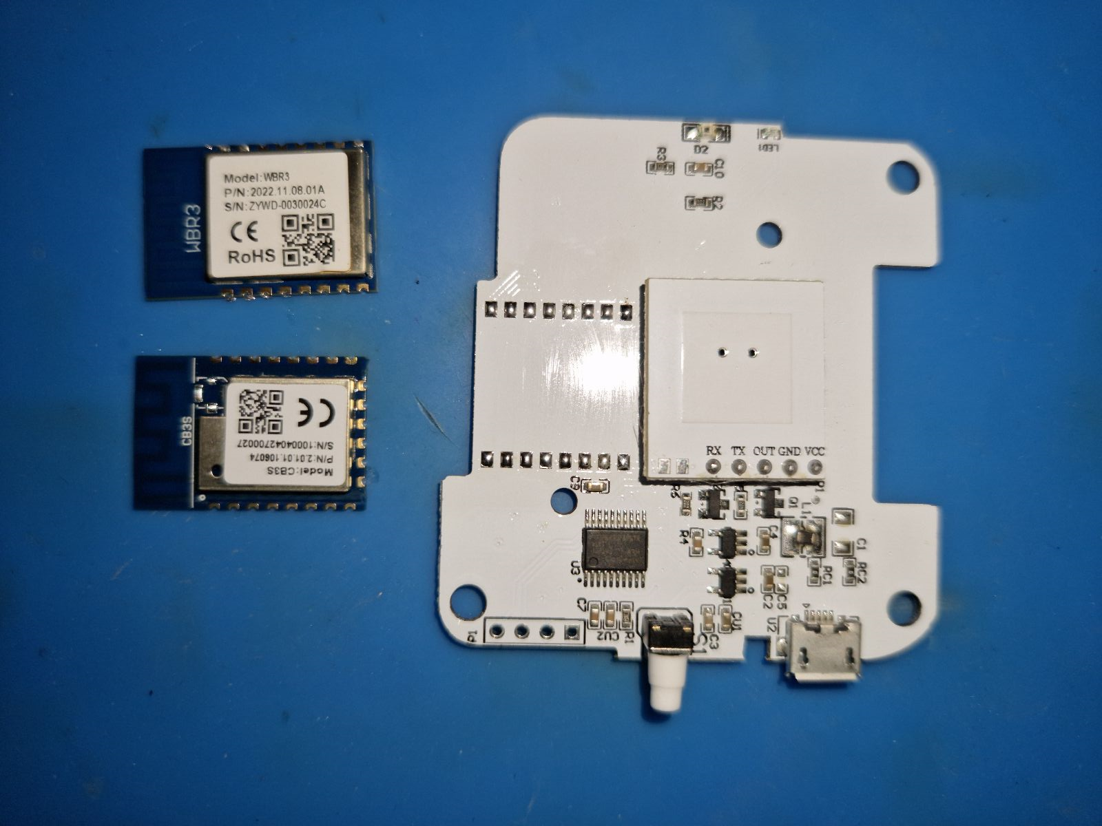

    It turns out that this is a device based on TuyaMCU and a WiFi module, the support of which is still in progress. Does this mean this topic is about to end?
    Radar with WiFi - TuyaMCU, OpenBeken, own configuration page hosted on the devic Radar with WiFi - TuyaMCU, OpenBeken, own configuration page hosted on the devic Radar with WiFi - TuyaMCU, OpenBeken, own configuration page hosted on the devic
    Nothing more wrong! This is a device based on TuyaMCU, so at the beginning you can capture their UART communication packets. I discussed it in the topic about the TuyaMCU analyzer:

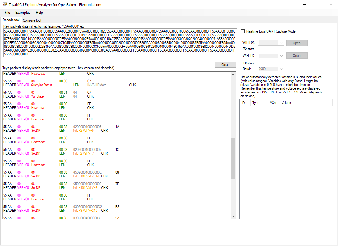

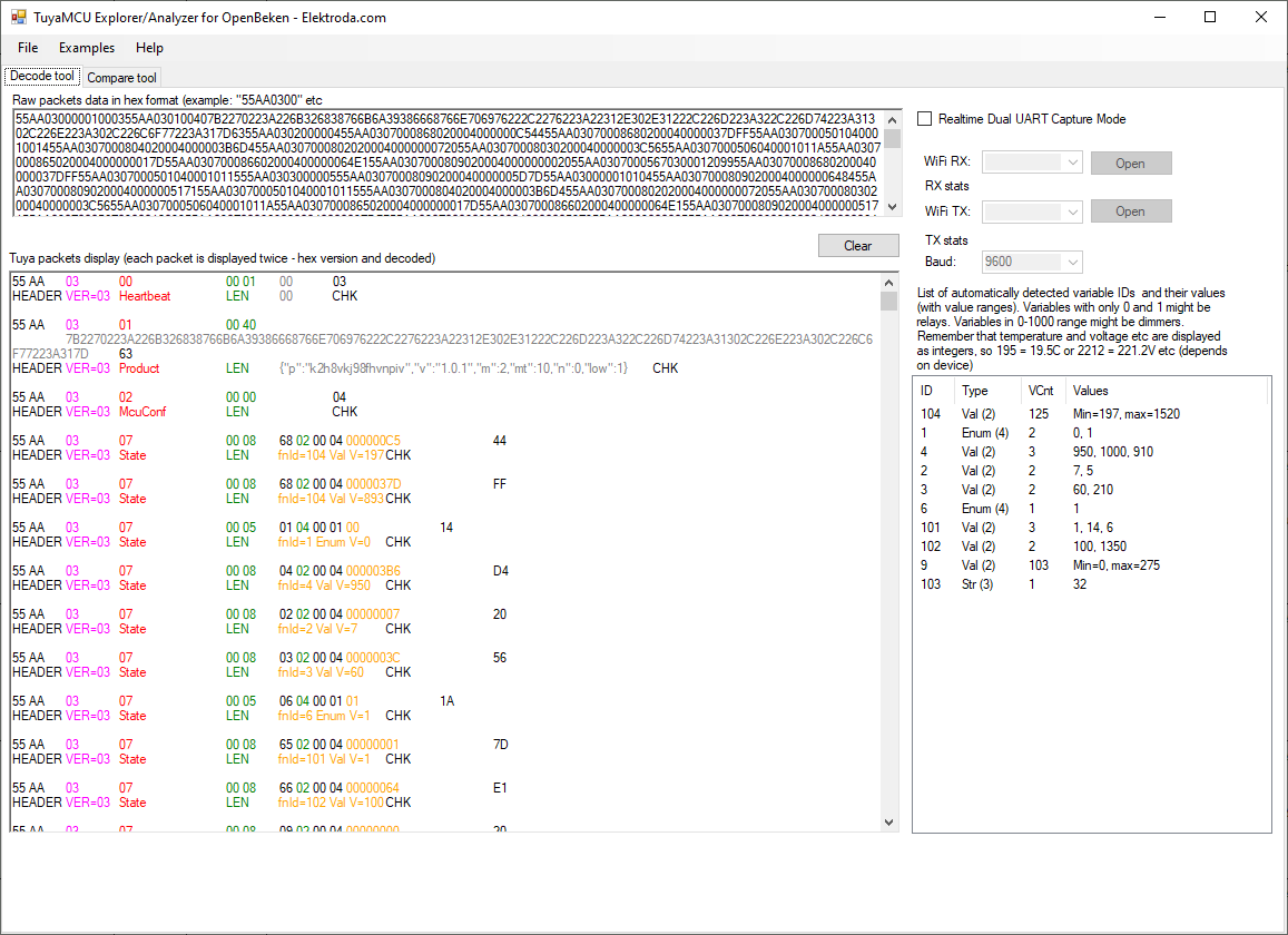

    TuyaMCU communication
    So we do packet capture. We connect the mass and RX of the USB to UART converter operating in 3.3V mode first to the TX of the WiFi module, and then to the RX and save the sent data. Baud is usually 9600, but here it was different - 115200 was used here, which can also be found in some Tuya devices.
    Here is the collected data, first what the MCU sends to the WiFi module:
    Here we see the MCU check in first with the product code in JSON:
    and then a lot of variables with different dpIDs, the meaning of which we are yet to learn. Here we have the variables that the MCU sends to us, i.e. measurements.
    In turn, the packets sent by the WiFi module to the MCU look like this:
    Here we have the variables that the WiFi module sends to the MCU. These are the operating parameters of the device, e.g. radar sensitivity is sent here.
    A short analysis and tests with the Tuya application show us what is what. We just switched options in the app and watched what changed. We watched what the UART shows and what the application shows. Here are the roles of each dpID:
    - 1 presence alarm
    - 2 radar sensitivity
    - 3 mine spotting distance (unless in cm)
    - 4 max detection distance (unless as cm)
    - 6 self test (0 or 1)
    - 9 detected distance to move (unless in cm)
    - 101 detection delay (the unit is tenths of a second, so 10 means 1 sec and 5 means 0.5 sec)
    - 102 presence with delay (similar to presence but turns off after delay)
    - 103 debug CLI flag (default 32)
    - 104 light sensor reading
    These roles can also be derived from the Tuya API, but we didn't use this approach here.
    I put full communication dumps on the analyzer repository:
    https://github.com/openshwprojects/TuyaMCUAna...mmit/9a7a87fde797d56b29095d9218910384c0b84b1c

    The WiFi module encountered inside is not yet supported, but manufacturers often use it interchangeably with TYWE3S (ESP8266, rather in the past) and CB3S and WB3S (BK7231). So you can try to replace the module and test TuyaMCU support in OpenBeken. This will give us a little more information on how this device works, and show us if TuyaMCU support in OBK can handle quite unusual equipment.
    So - hot air in motion and we solder CB3S with the already uploaded one in place OBK :
    Then configure TuyaMCU in OpenBeken. In the autoexec.bat script, we map the dpID of variables from TuyaMCU to OpenBeken channels and set their types. It is necessary that the system knows how to display them on the GUI and how to send them to Home Assistant, also with the automatic Discovery of the device.
    We place the script in the LIttleFS file system via Web App.

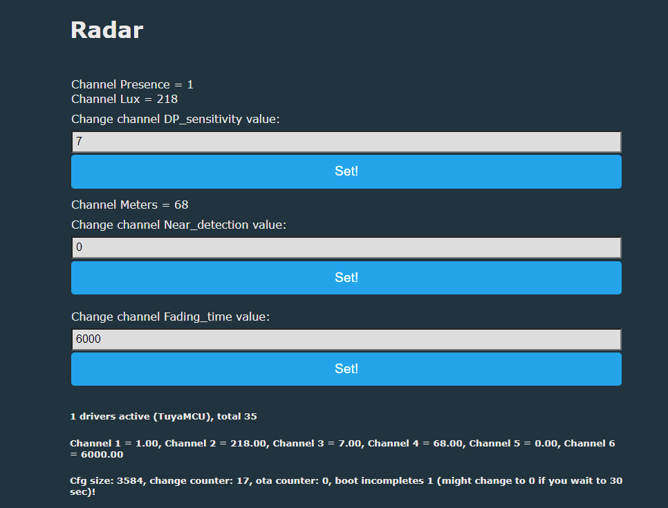

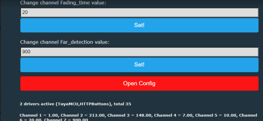

    Here is the result:
    The GUI doesn't look very good, we're going to improve it a bit...

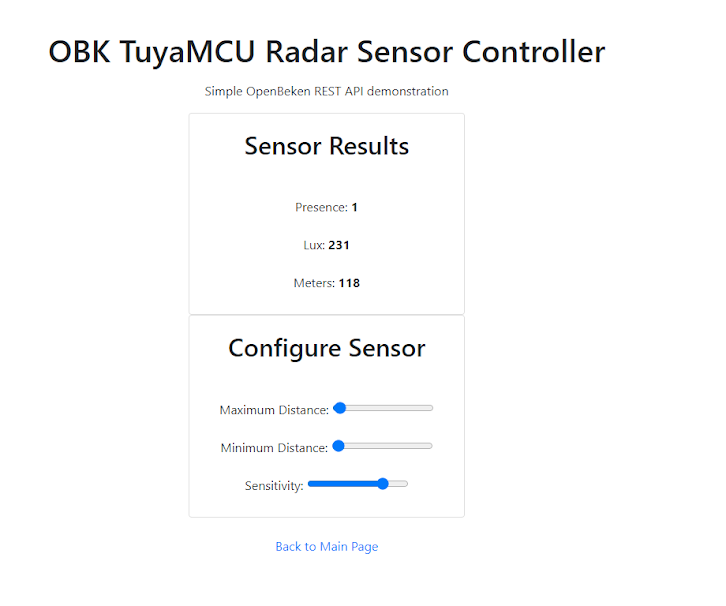

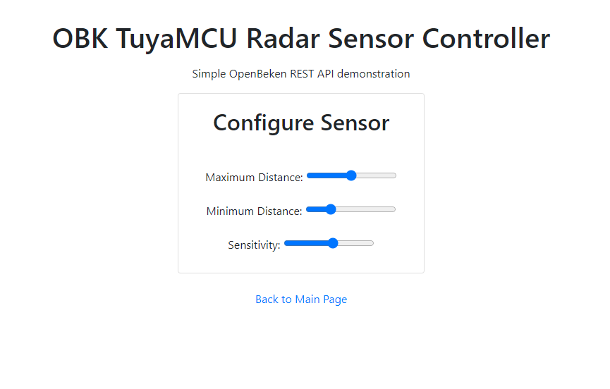

    Own configuration page
    The device can already work with Home Assistant, but we haven't mapped the entire manufacturer's GUI yet. So you can go a step further. OpenBeken firmware does not have the ability to customize the channels from the main panel to the specific needs of this device, so normally there would be a problem with setting nice sliders with appropriate ranges and descriptions, but LittleFS and the REST interface come to the rescue here.
    OpenBeken allows us to create our own mini device page, written in HTML and Javascript, hosted on the WiFi device itself and communicating with the main firmware via a REST interface, without refreshing the page.
    This was presented in the topic below (English and Polish versions):
    https://www.elektroda.pl/rtvforum/topic3971355.html
    https://www.elektroda.com/rtvforum/topic3971355.html
    Demo repository:
    https://github.com/openshwprojects/OpenBekenRESTDemo
    Here, too, I thought it would be worth doing something like this. This resulted in the page linked below:
    https://github.com/openshwprojects/OpenBekenR.../main/examples/TuyaMCU_RadarSensorConfig.html
    Then I developed the website to show readings from the sensor:
    https://github.com/openshwprojects/OpenBekenR...ples/TuyaMCU_RadarSensorConfigAndResults.html
    Let's analyze how this site works.
    A page is one file - an HTML document with embedded Javascript. The page doesn't reload all the way, just the script refreshes parts of it in the background. The site includes Bootstrap styles and helper scripts to have any aesthetic appeal. In the HTML itself, sliders and fields with measurement results are also created:
    Code: HTML, XML
    These sliders have onChange events hooked, i.e. they trigger the script when the user changes the setting.
    At the moment of changing the value of the slider, the common function setting the OpenBeken channel is called, because in OBK channels can contain any value, a channel is like a variable:
    Code: Javascript
    setChannel itself is shared and uses fetchto send to OBK changing the value of the variable (channel):
    Code: Javascript
    That would be all if you didn't need to know the initial state of the parameters. That is, what we download once when opening the page. This is done in window.onload and then in interval every now and then (to refresh changes that came from outside):
    Code: Javascript
    And the fetching function itself:
    Code: Javascript
    The function refreshes both parameters that can be edited and read-only values (current distance measurement result, etc.).

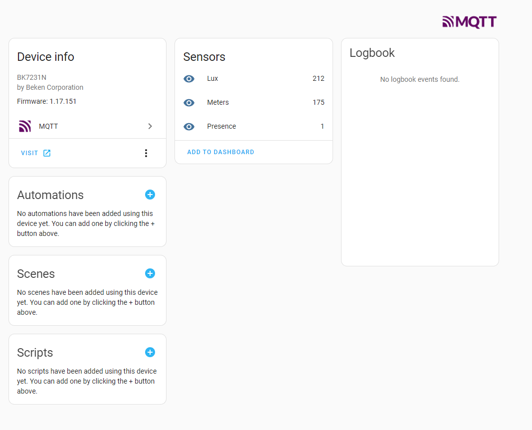

    Connecting to Home Assistant
    OpenBeken supports Home Assistant Discovery, so the device can be easily connected to HA and track its status there and create automations.
    (distance value above does not have corrected unit yet)
    Then we create automations in HA just like for any other device.

    At the moment, I have no opportunity to analyze it deeper, but I think that I gave you a starting point for further exploration.

    I managed to translate it with some online converter. It turns out that it does not detect a "static" person, but small movements - it can detect head tilt, hand waving, hand raising, turning around, moving a mobile phone, flipping a book.
    It seems that both versions of the device are recognized by zigbee2mqtt: link and link

    Good job with the translation. I would only gently point out that the versions of the device recognized by zigbee2mqtt are Zigbee versions, not versions with WiFi, such as the one I analyzed here with my friend @DeDaMrAz. If you want to have versions for Zigbee, make sure when ordering which type of product you are ordering.
