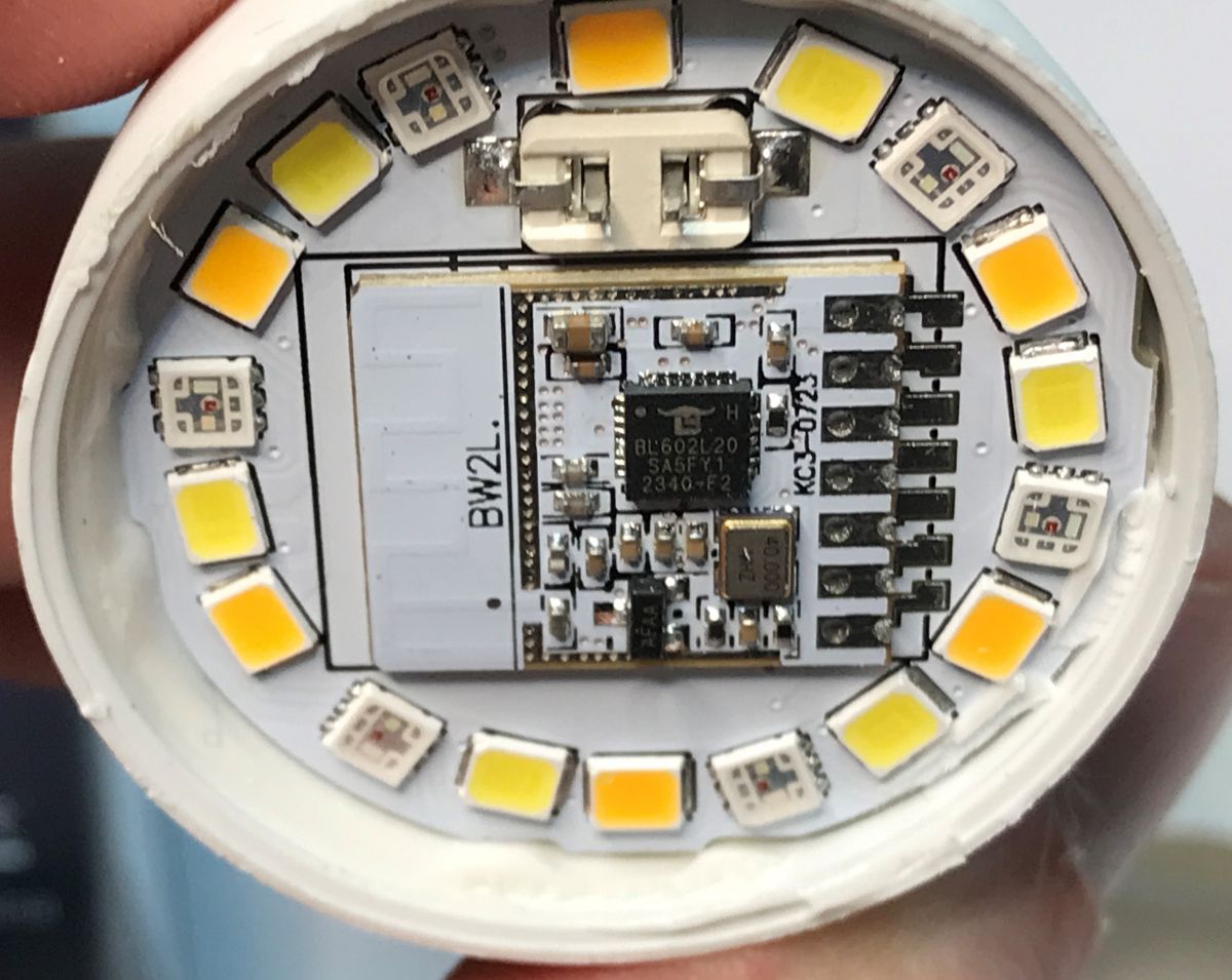

    eWeLink RGBCW LED bulbs series is often using BW2L WiFi module based on BL602 chip. Those bulbs are easy to disassemble, although flash pins are only accessible on the back side of the module, it has to be desoldered before flashing. Here I will show you how you can do it step by step, so the bulb can be run free from the cloud and paired with Home Assistant.

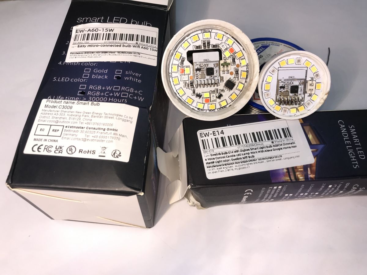

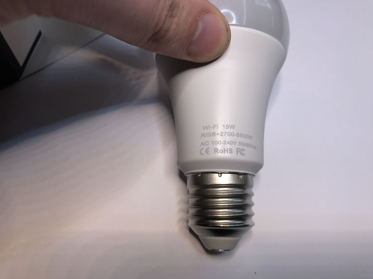

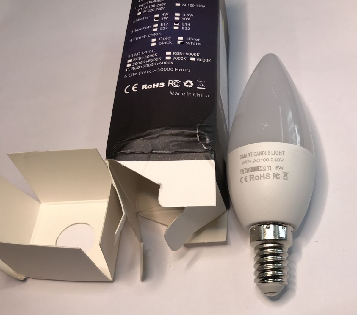

    The bulb models are EW-A60-15W and EW-E14, the first one is using E27 format.
    They are also marked as C3009, but this is meaningless, because also Tuya bulbs are using the same marking. Even the one with LN882H:
    Two LED bulb boxes with labels and barcodes.
    Smart bulb model C3009 packaging.
    A person holding a disassembled LED lighting module, revealing the interior with electronics.
    So, to sum up:
    - model name "EW-" prefix (as in eWeLink) is important
    - C3009 is also used by Tuya and can be ignored
    - this guide is specifically for BW2L eWeLink lamps
    It's time to unpack one and flash it:
    Box of LED candle-shaped light bulbs.
    Box of smart candle LED lights on a white background.
    Smart bulb packaging with product information.
    Smart candle light bulb and its packaging.

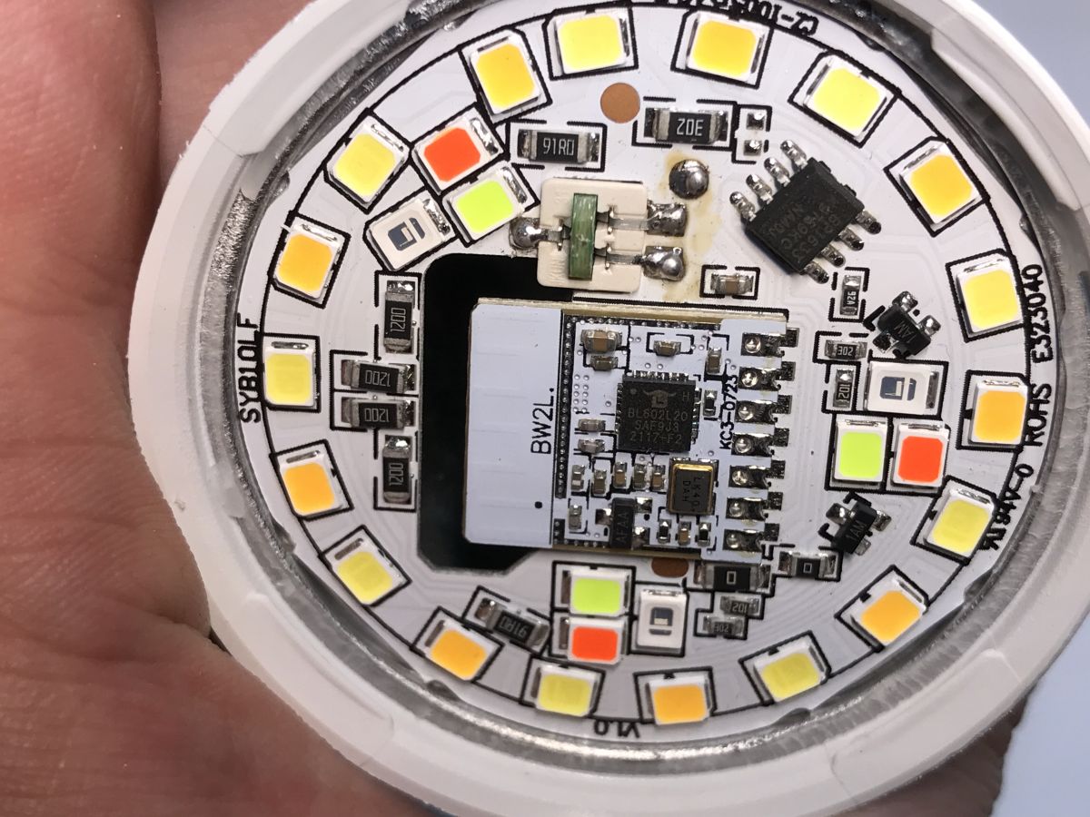

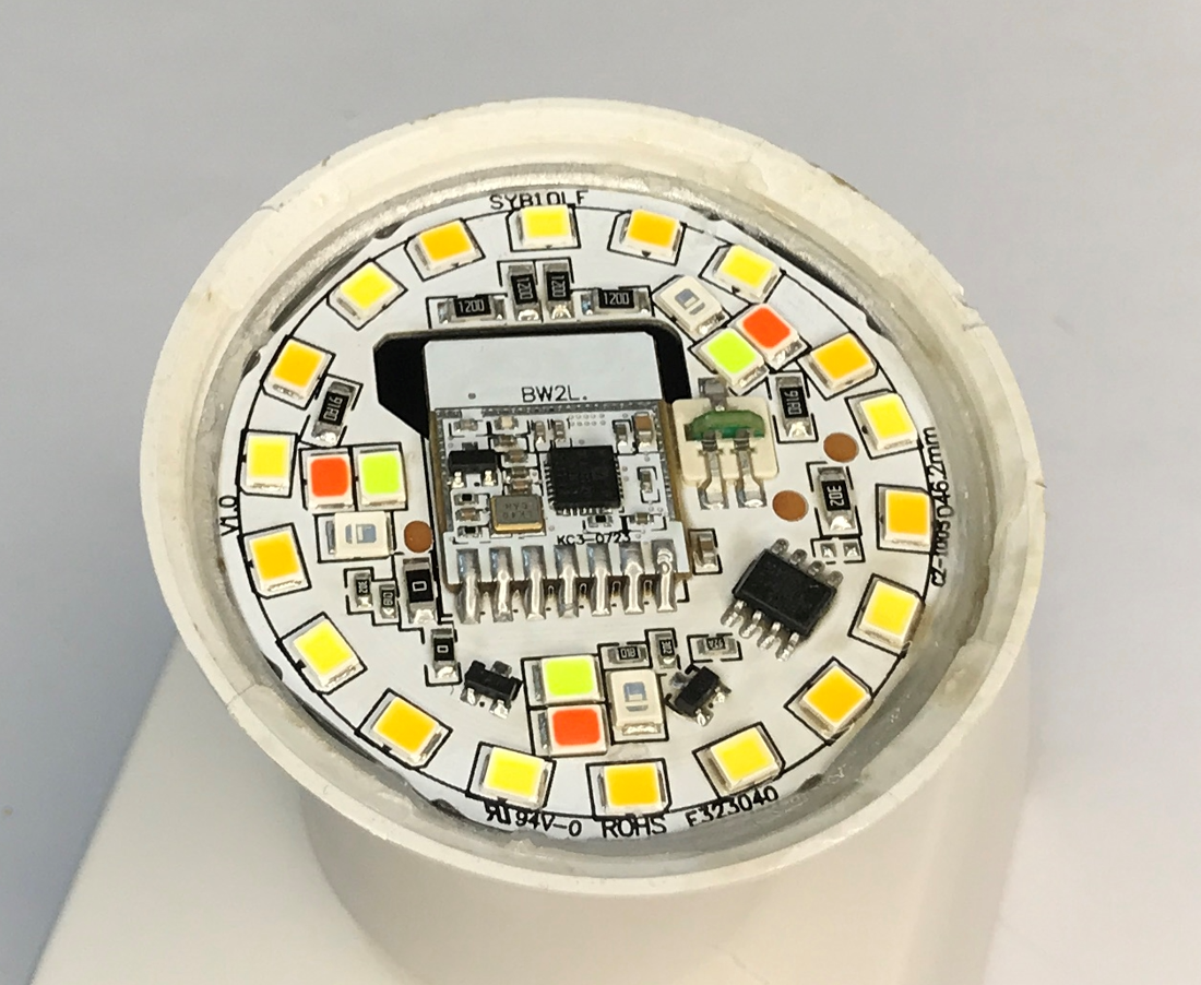

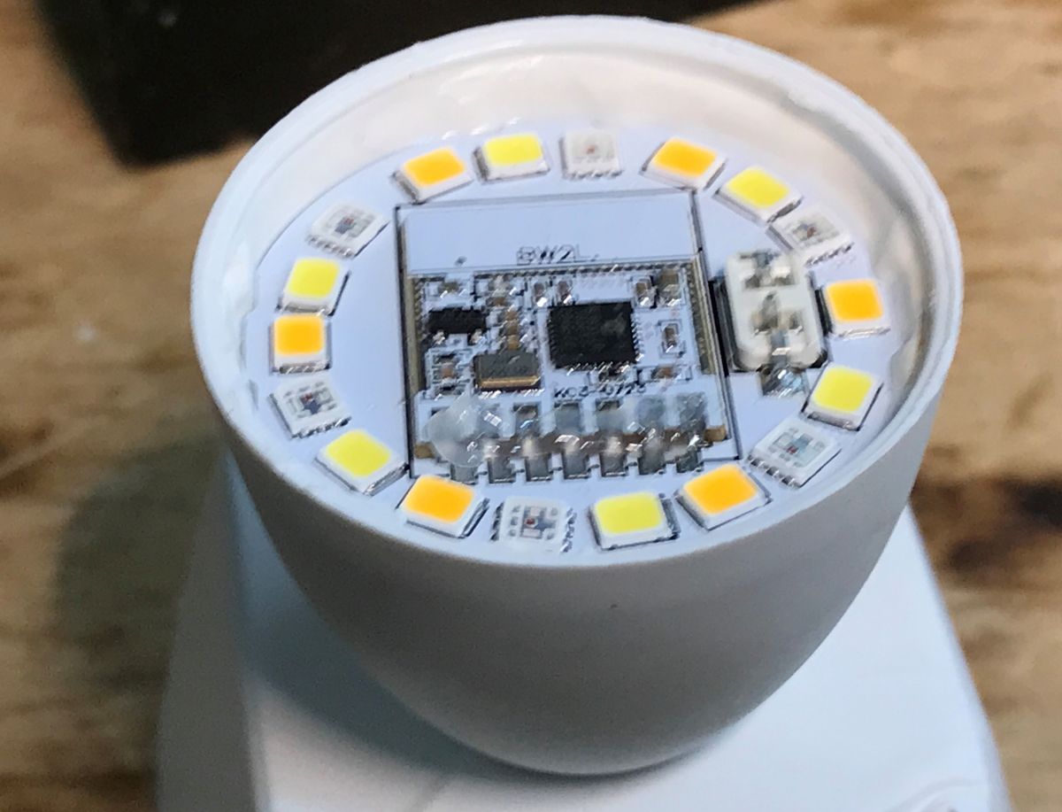

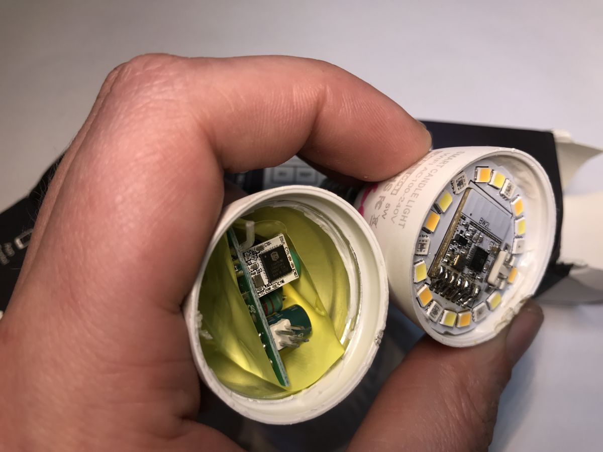

    Initial teardown

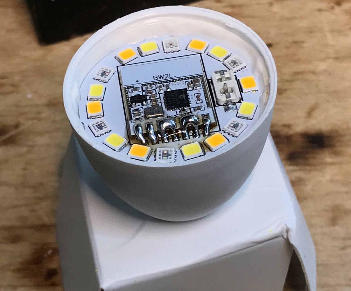

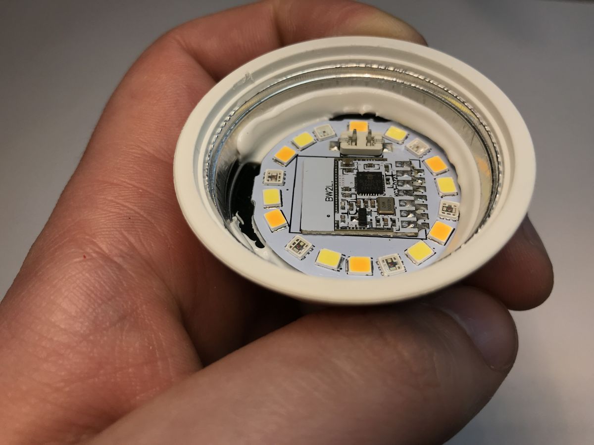

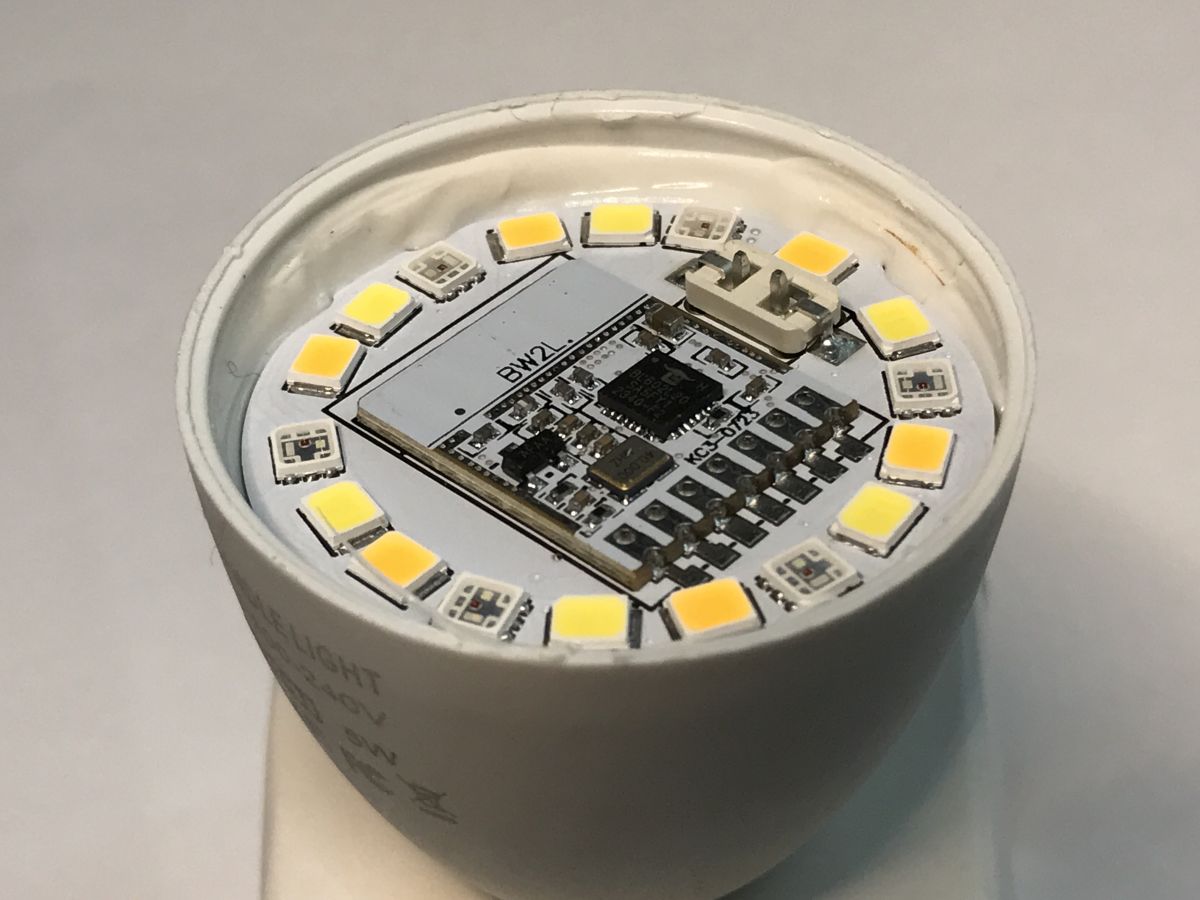

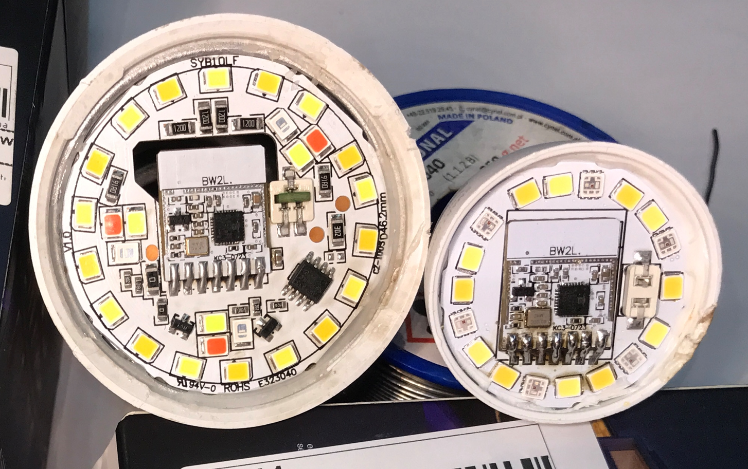

    You only need to remove the dome. The WiFi module is on the LEDs board. You can pry the dome with flat screwdriver.
    Interior of an LED bulb with a visible printed circuit board.
    Electronic circuit with LEDs and a chip.

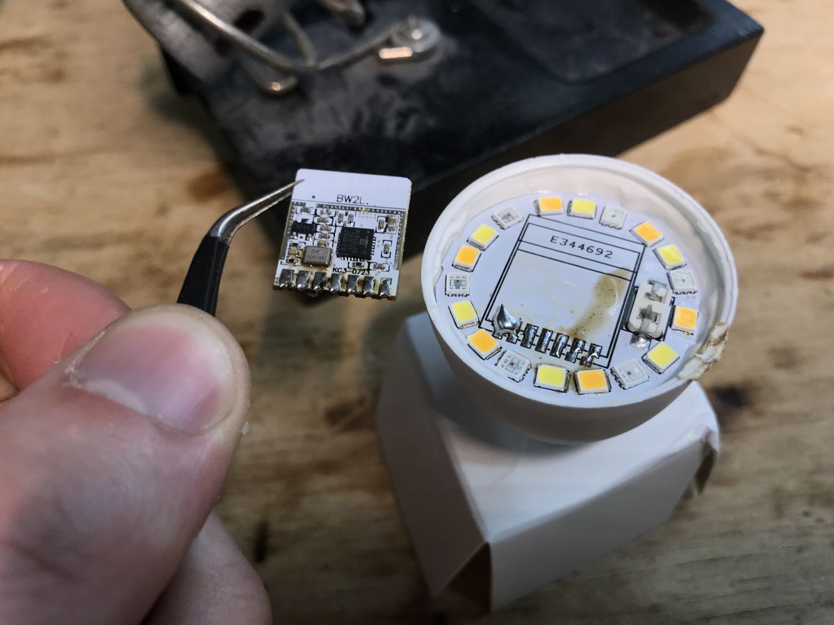

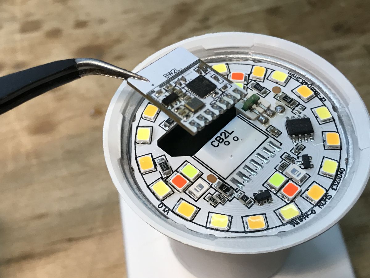

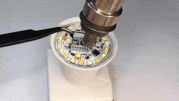

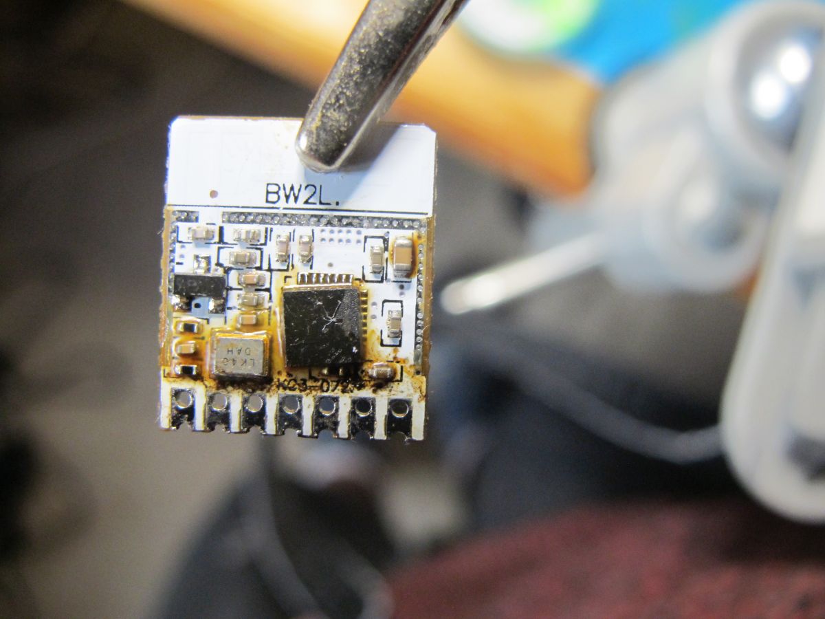

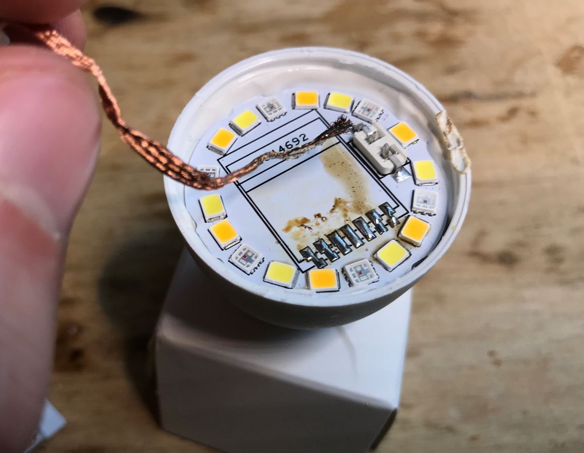

    Desoldering module

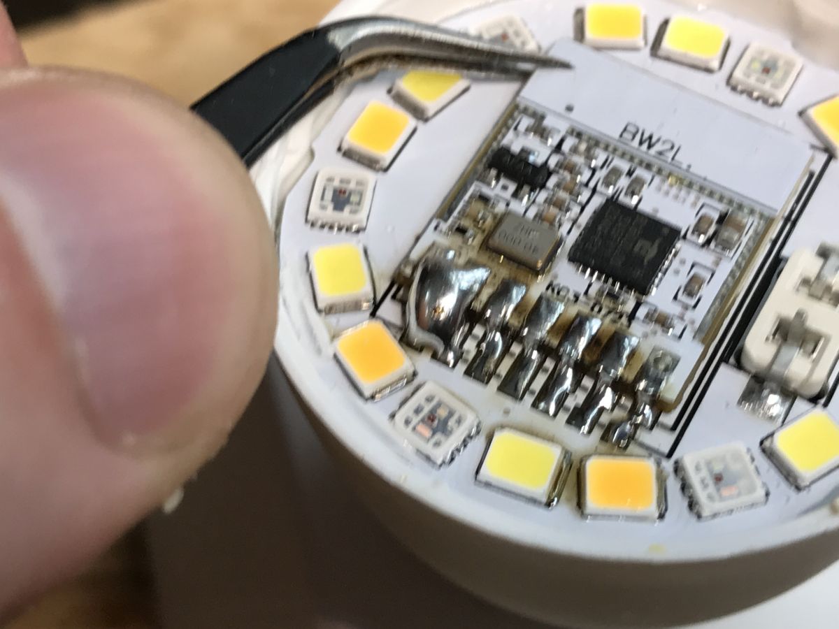

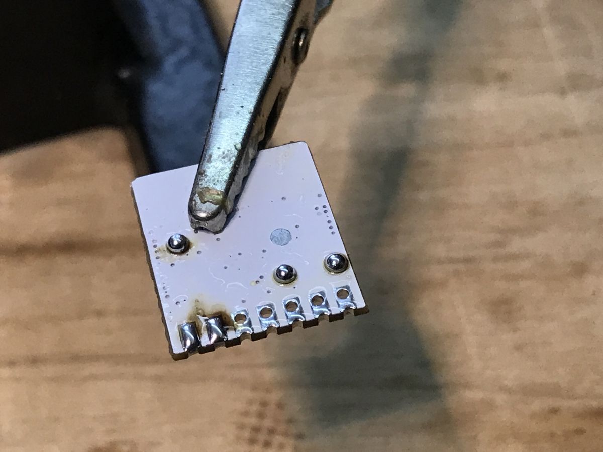

    Module flashing pins are on the back, so you need to desolder it. There are two methods.
    - hot air method - recommended. Just add flux and heat up pads and lift the module once solder melts:
    Soldering tool used to repair an LED circuit.
    - "tricky" method - if you add flux to the pads, and then add some leaded (Pb) solder, you can heat them up together until module is loose and can be easily removed
    Close-up of an LED bulb interior with visible diodes and circuit.
    Round circuit board with LEDs and electronic components on a white surface.
    Close-up of an LED board with LEDs and electronic components, and tweezers held nearby.
    Electronic circuit board in tweezers next to an LED bulb.
    For both methods, remember to clear later the pads with some solder wick:
    Close-up of a damaged LED board with visible diodes and a wire.

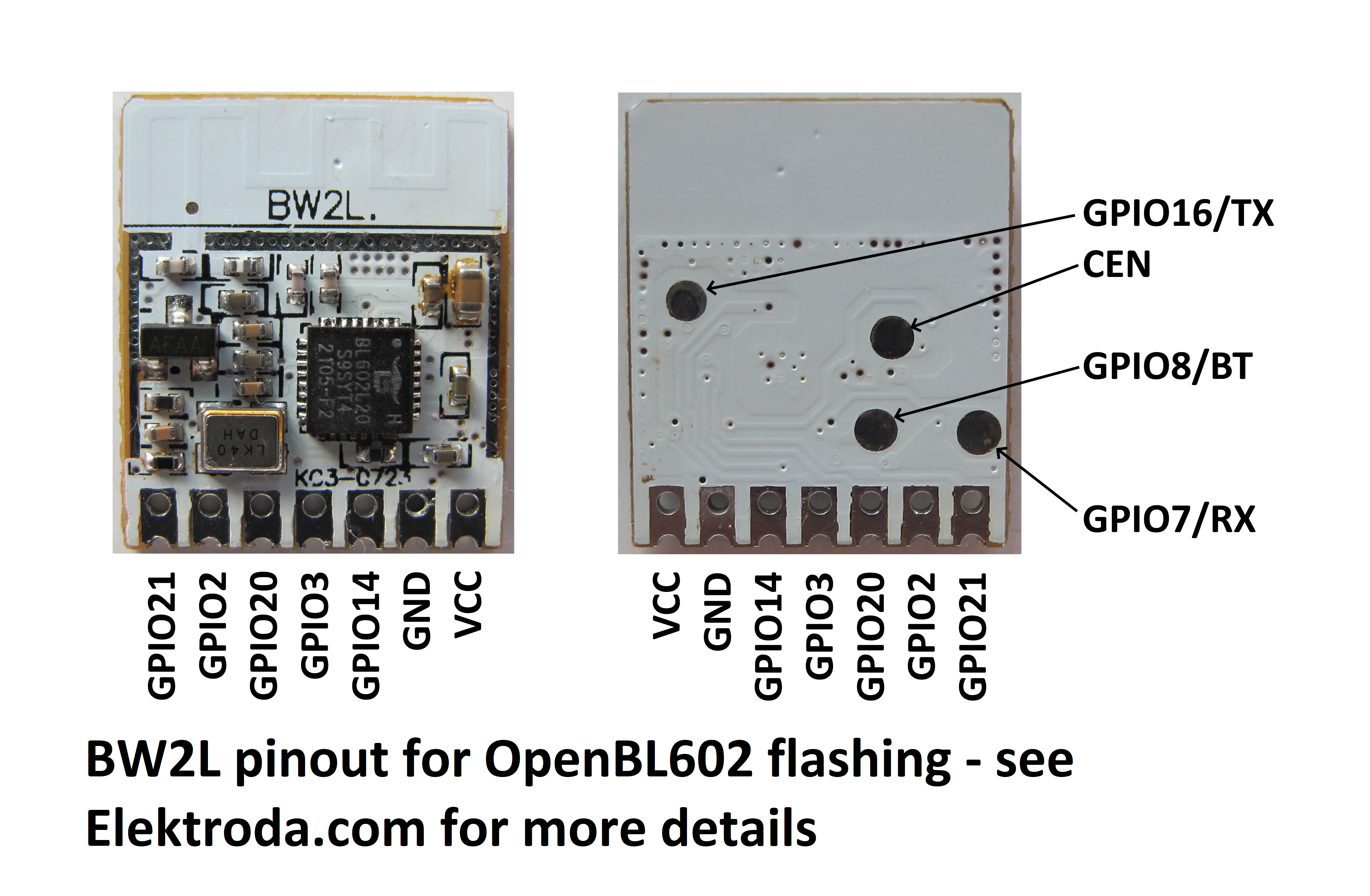

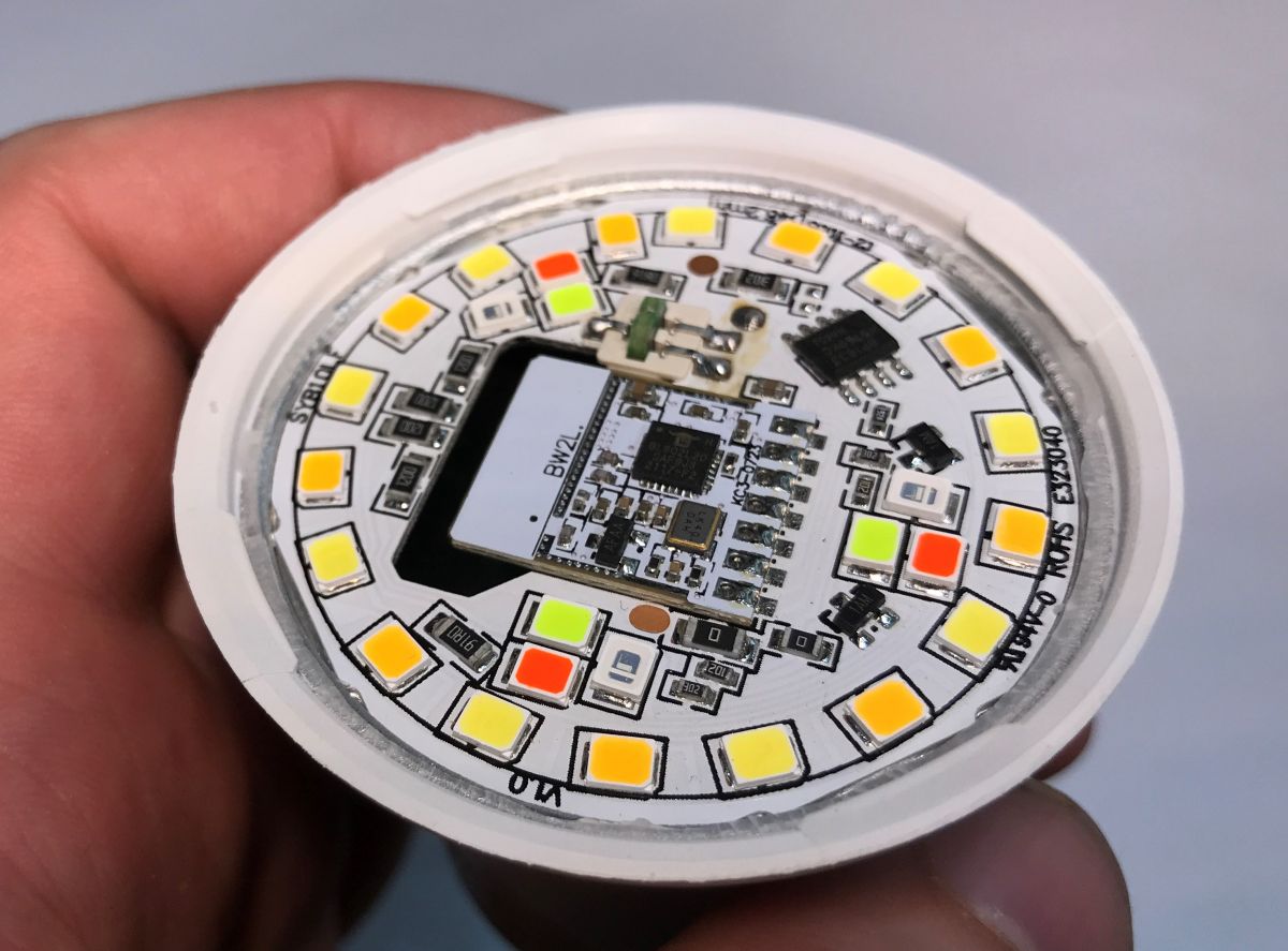

    BW2L pinout
    BW2L pinout is shown on this image made by @divadiow :
    Front and back view of the BW2L module with labeled pins for OpenBL602 programming.
    As you can see, required flashing pads are on the back, that's why we're desoldering it.

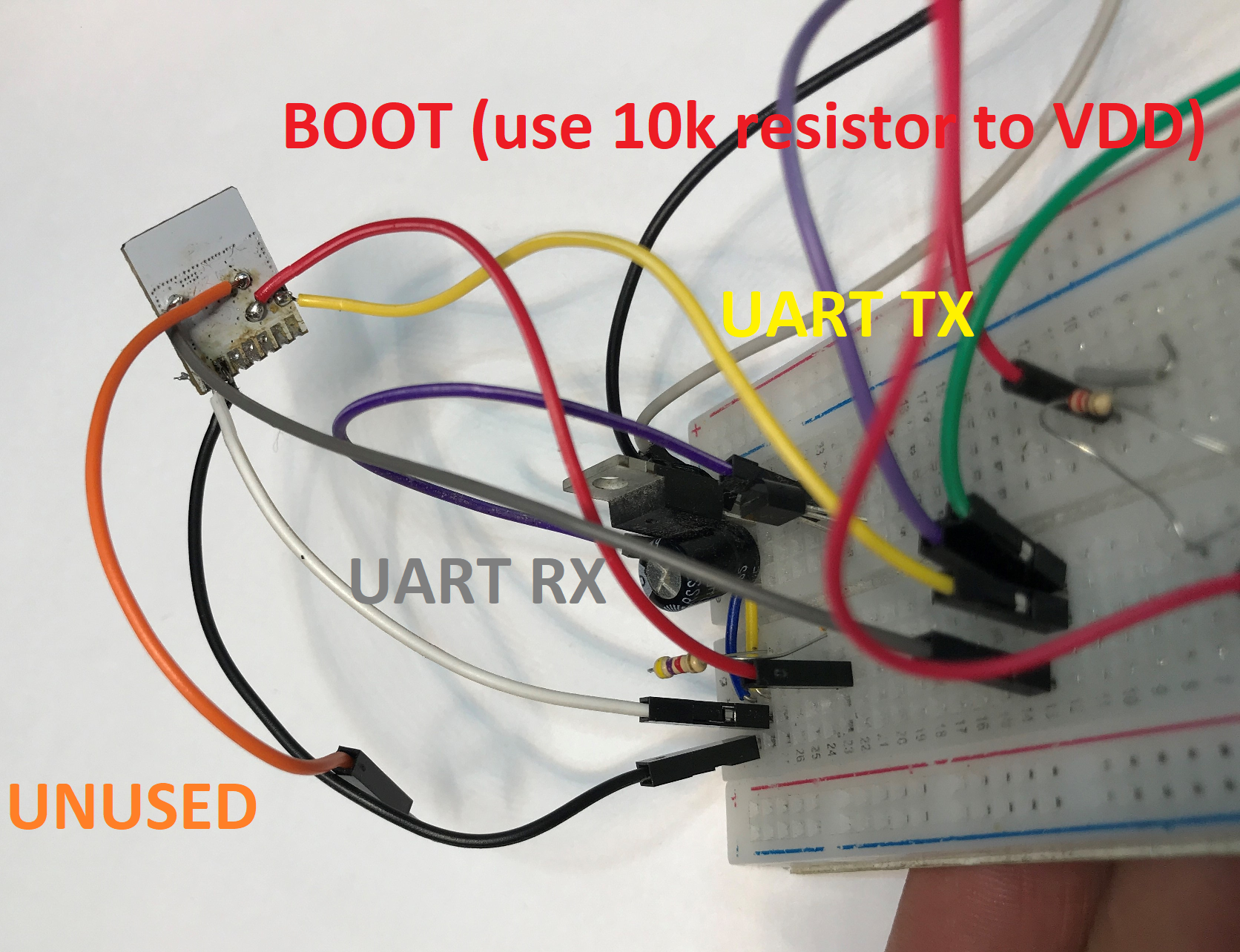

    Flashing the module

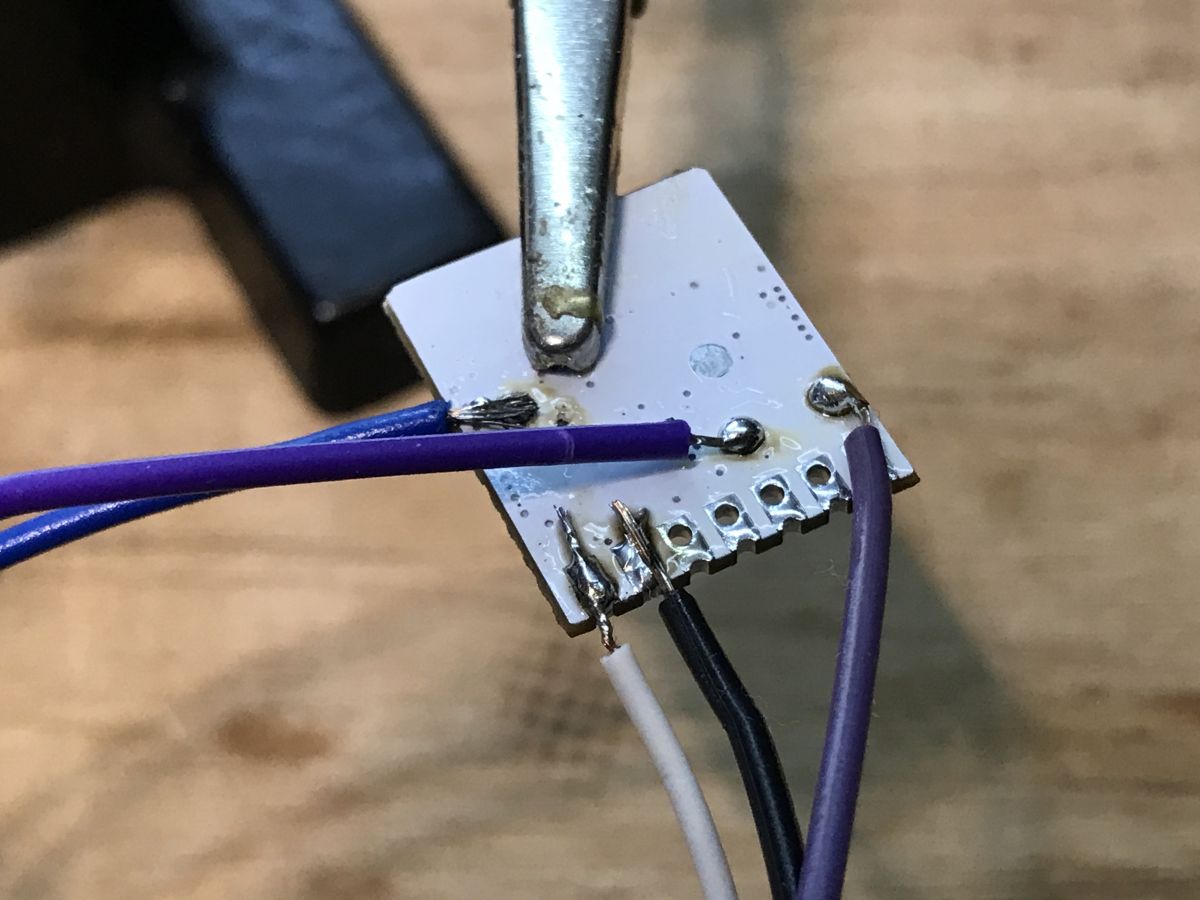

    First you need to solder wires. Tin the pads, also tin the wires, then solder them together. For more connection details, refer to our latest BL602 flashing guide:
    [ENGLISH] How to read and backup flash of BL602/BL702/etc device with BLDevCube? Burning tutorial, pinout
    [POLISH] How to read and backup flash of BL602/BL702/etc device with BLDevCube? Burning tutorial, pinout
    Our firmware can be downloaded there:
    For the backside pad roles, see BW2L pinout or my image below:
    Breadboard with connected wires and labels for BOOT, UART TX, UART RX, and UNUSED ports.

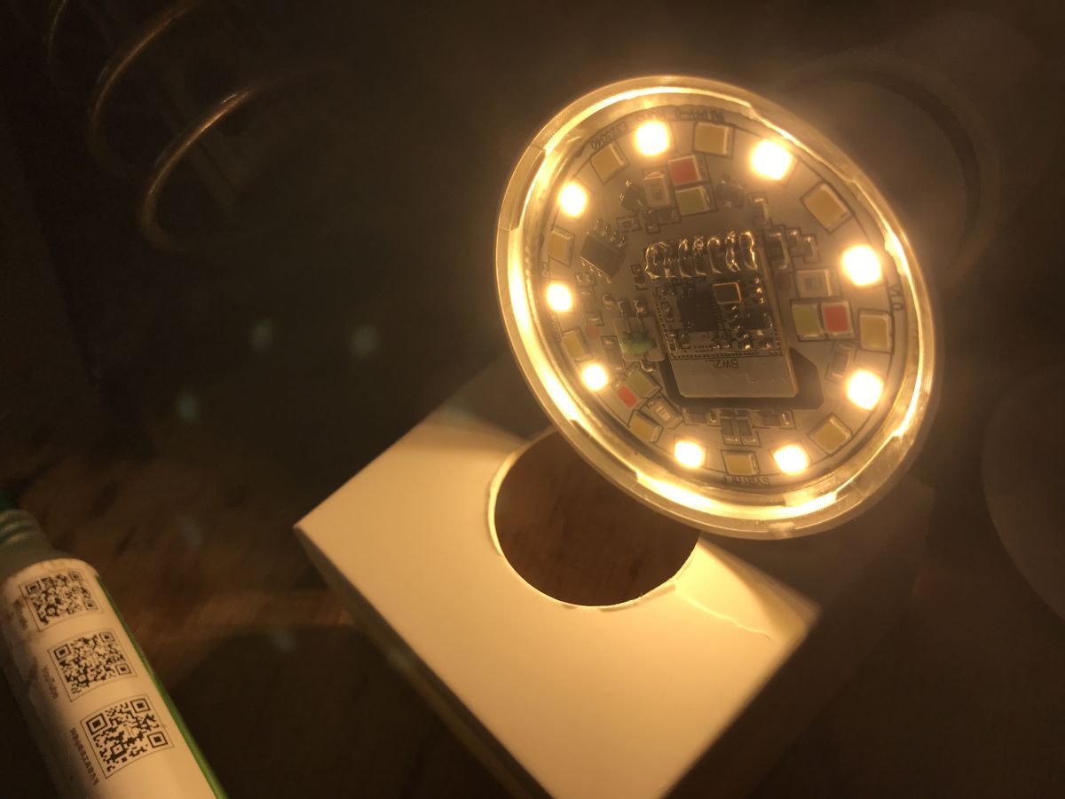

    Once you flash the module, make sure that BL602 access point appears before soldering it back in the bulb.

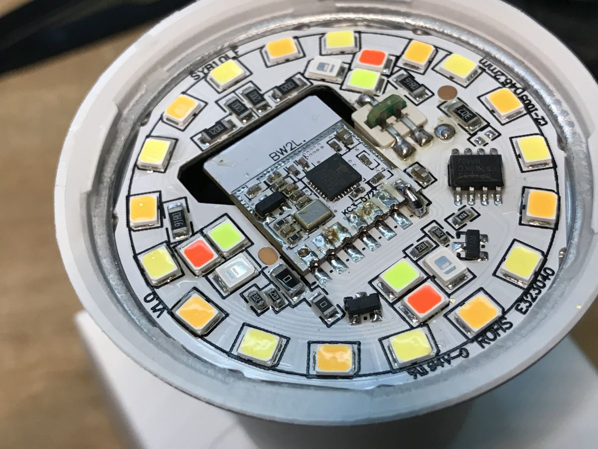

    Soldering module back to bulb
    Soldering module back may be a bit harder than usual, because the LED plate is able to dissipate large amounts of heat. That's how LEDs are cooled. Still, with some Pb solder (leaded solder has lower melting point) and flux it's still possible to do it. Try to heat each pad for a longer moment and apply solder. That's how it turned out for me:
    Close-up of an LED module with electronic components on a white PCB.
    Make sure to check for shorts, especially on VDD and GND!

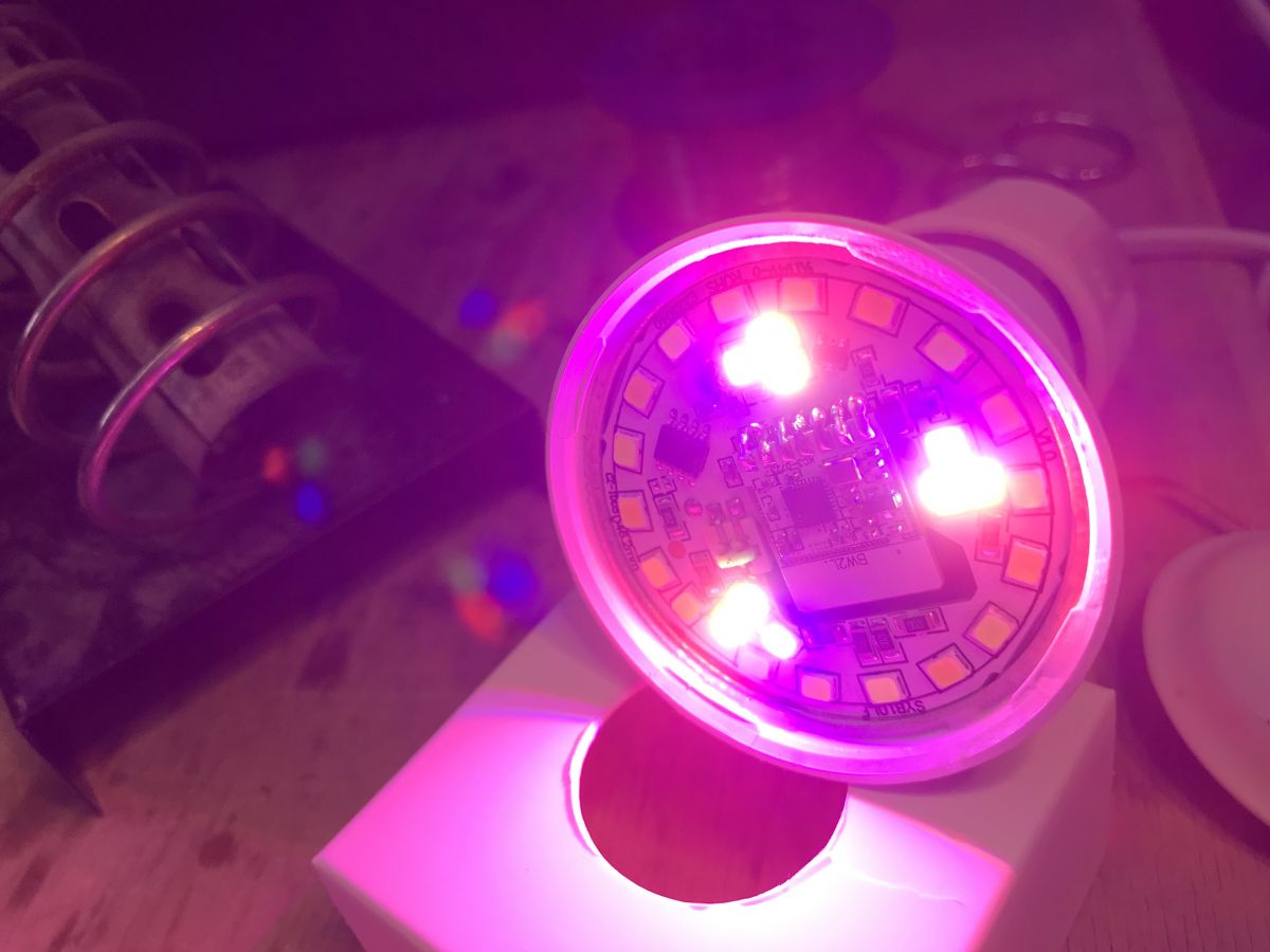

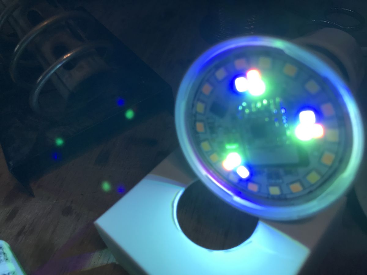

    Final result
    Here's short presentation of working bulb:
    Full RGBCW controls are working.

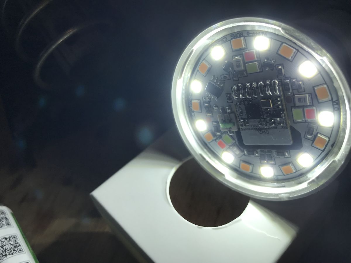

    what a crazy coincidence, I got an EW-A60-15W recently too ;)

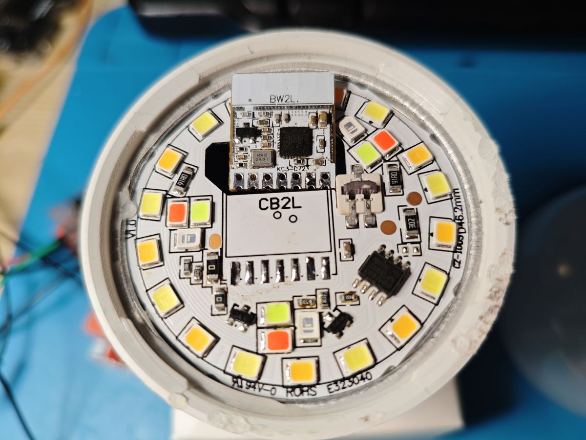

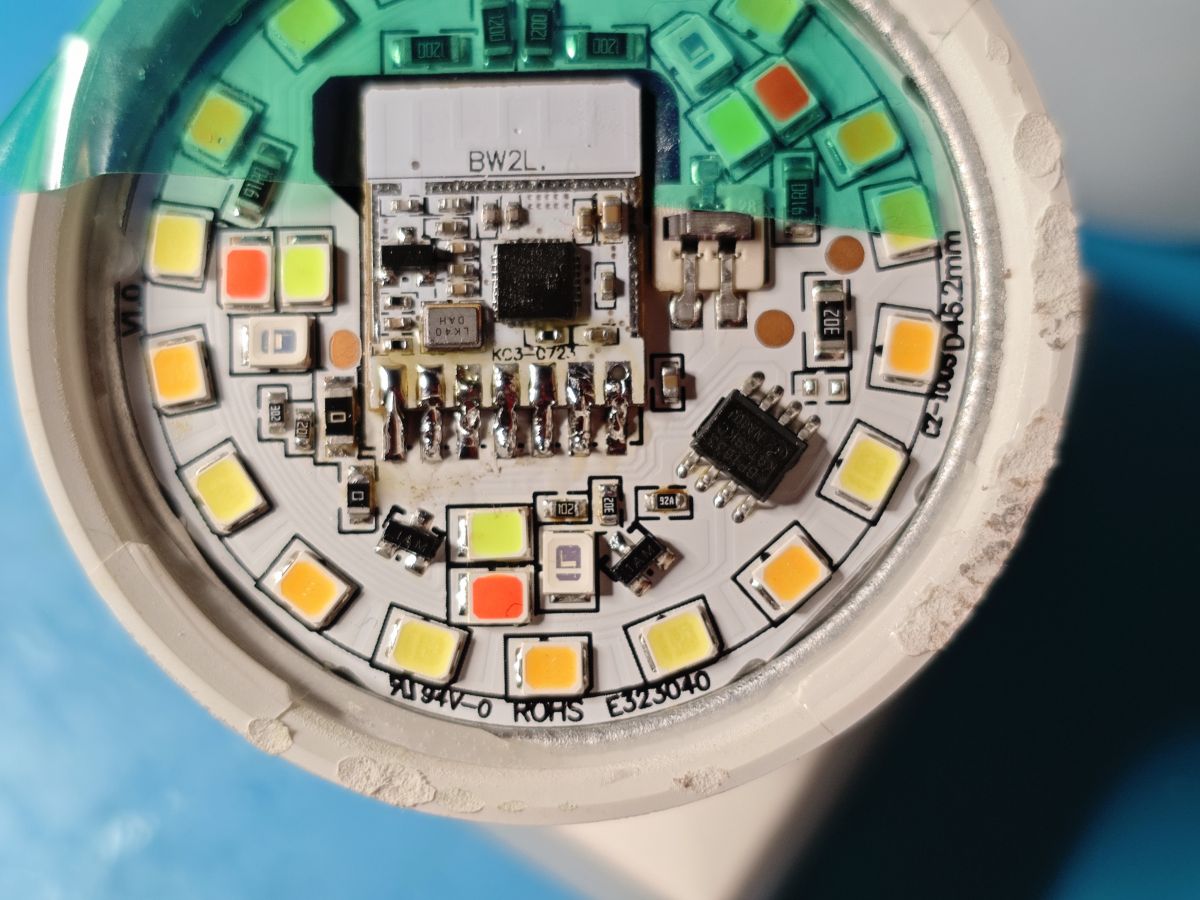

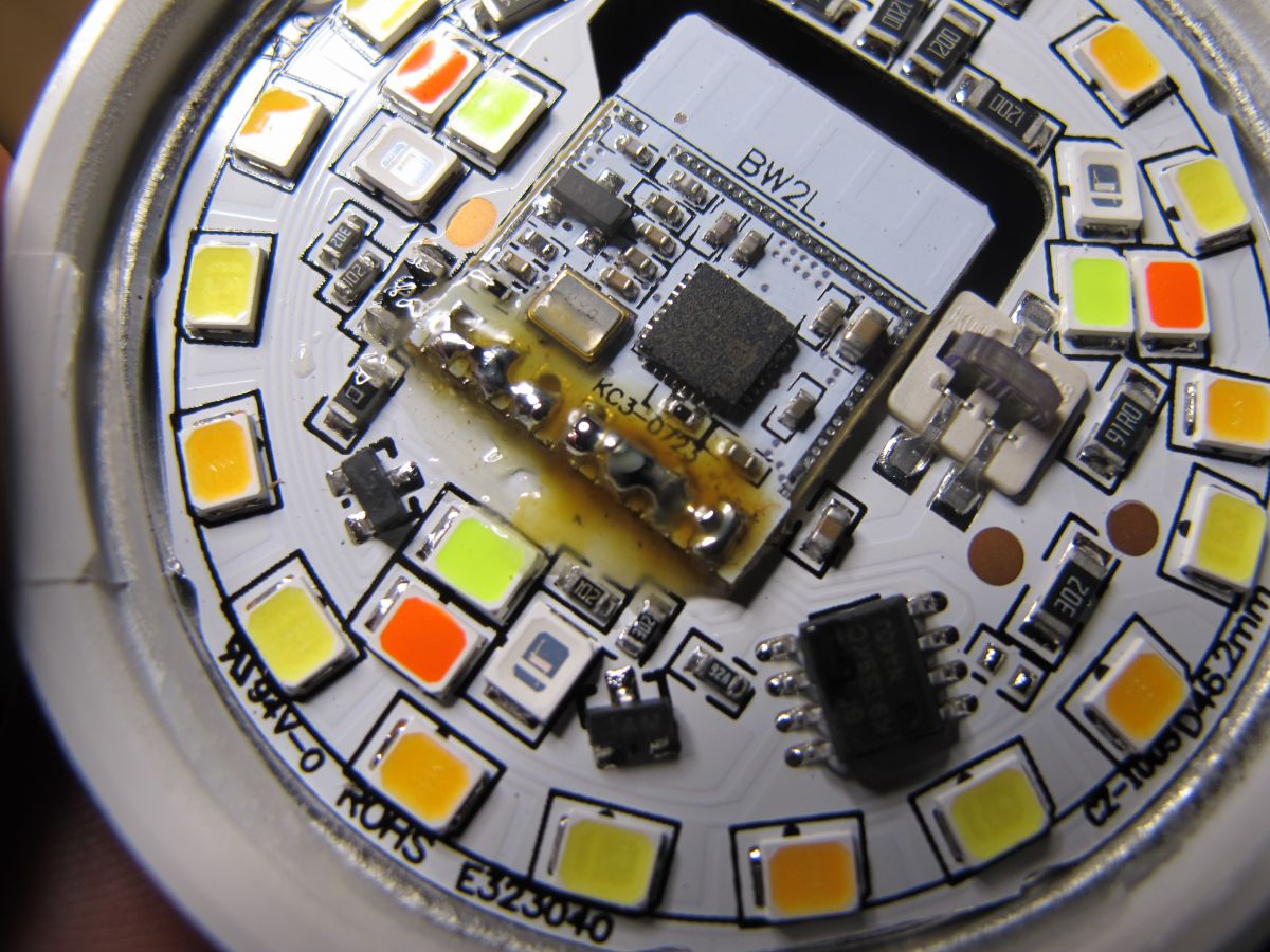

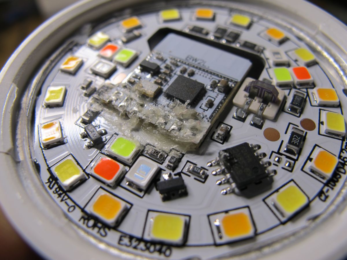

    This was the cause of a little pain for me because I couldn't seem to get the hot air temp right for it to free, even with additional pb solder, which itself didn't seem to want to behave.
    Interior of an LED bulb with visible diodes and electronic components. Electronic circuit board with LED light sources on a printed circuit board. Round LED panel with a green protective filter.
    It taking too long should have been a warning - I blew the BL602 out of place 😮
    Electronic module with small components and BW2L marking.
    Managed to refloat and sort it. It still booted into factory, could be dumped and OpenBeken/OpenBL602 flashed.
    Ready to solder back:
    Close-up of a circuit board with LEDs arranged in a circular pattern.
    Yes, I know it's messy and the module should be further down onto the contacts
    Inside view of an LED lamp showing diodes and electronic circuitry.
    Added a bit of tape to stop it falling inside.

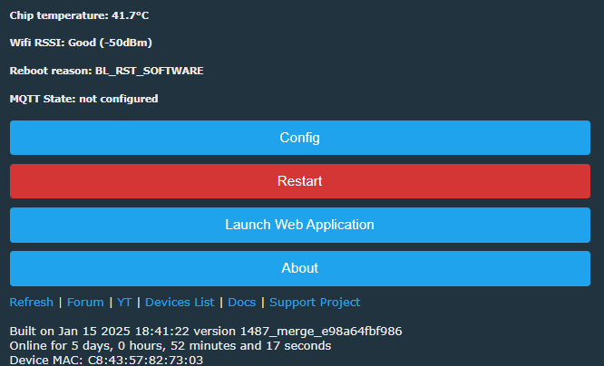

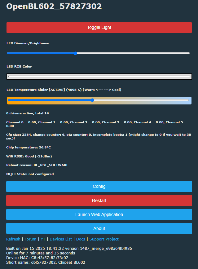

    I also went with @miegapele's new BL602 SDK build to see if it behaves itself
    https://github.com/openshwprojects/OpenBK7231T_App/actions/runs/12794858548?pr=1487
    User interface of the OpenBL602 device with controls for adjusting LED light.

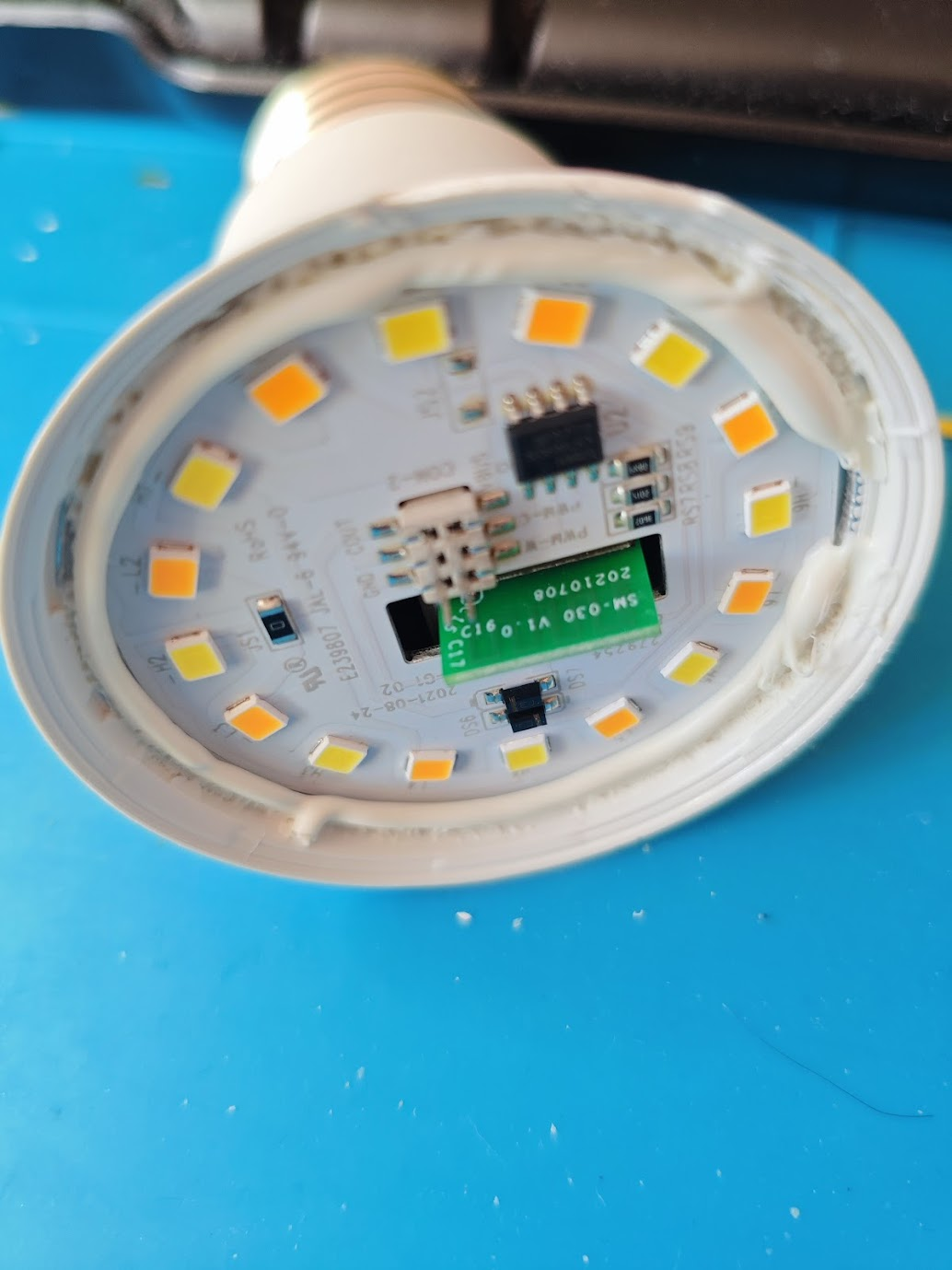

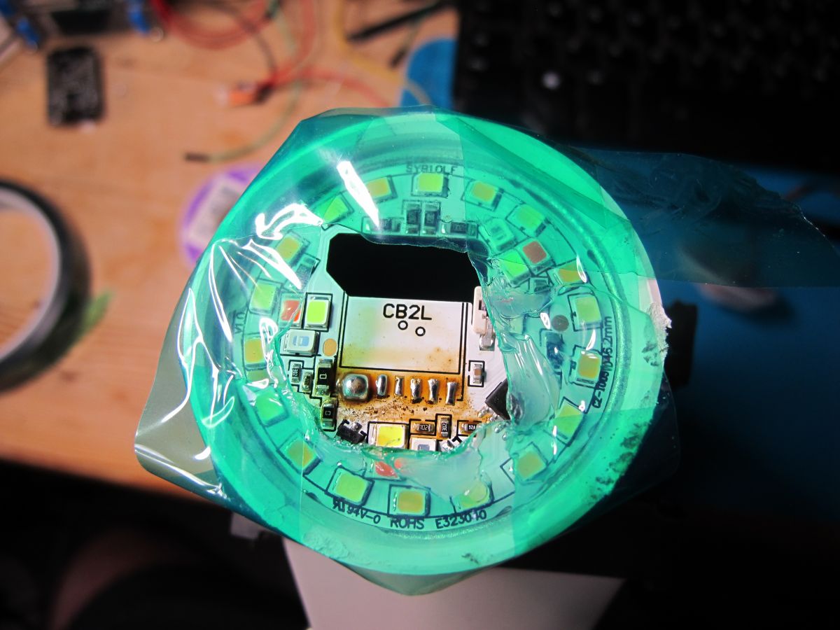

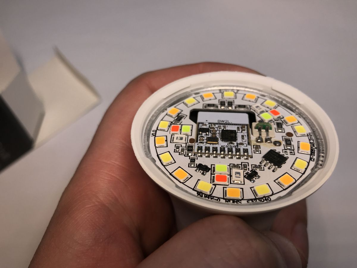

  • Board marked CB2L suggests a Beken chip design
    #3 21475980
    Posts: 14795
    Rate: 12953
    Which hot air station do you use?

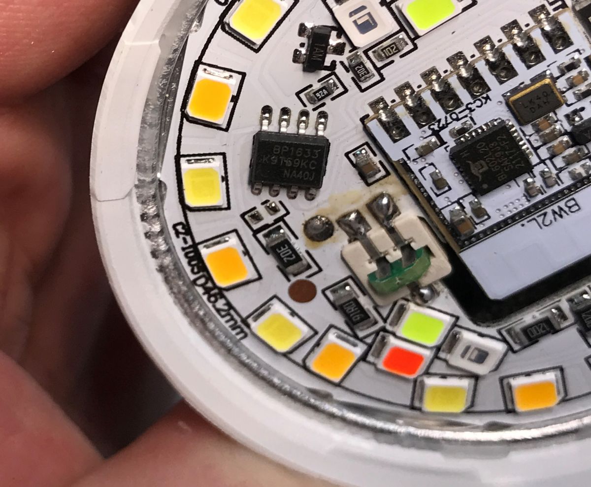

    I've also had some issues due to, as said in first topic, the good heat dissipation of those boards. Even with soldering back the module, I had to clear up solder bridges several times as well.
    Is this BL602 new SDK mod ready to merge? I really need some help with testing that.
    I think I will try to order futher eWeLink bulbs, just to confirm if other models are also using the same design (BW2L on the top LEDs board).
    PS: Interesting thing that I forgot to mention - the board is marked "CB2L", so it used to be a Beken chip...
    the basic 858D type. but I made a pb sausage before that and probably added too much additional solder. Should have stopped and wicked some off before hot air.
    I haven't done much/any testing. I did think @miegapele wasn't happy with stability, but I just saw this https://github.com/openshwprojects/OpenBK7231T_App/pull/1487#issuecomment-2593723977
    seems to be a template bulb (packaging included) for quite a few variants. I've a matter bulb waiting to be posted about in a proper thread that is the same, but had a UAM022 Beken module and "CB2L" underneath too. This one: https://www.elektroda.com/rtvforum/topic4032988-30.html#21231617
    Edit: hmm
    might not get it back together again but it would be interesting to see what eWeLink do with GU10s I guess.

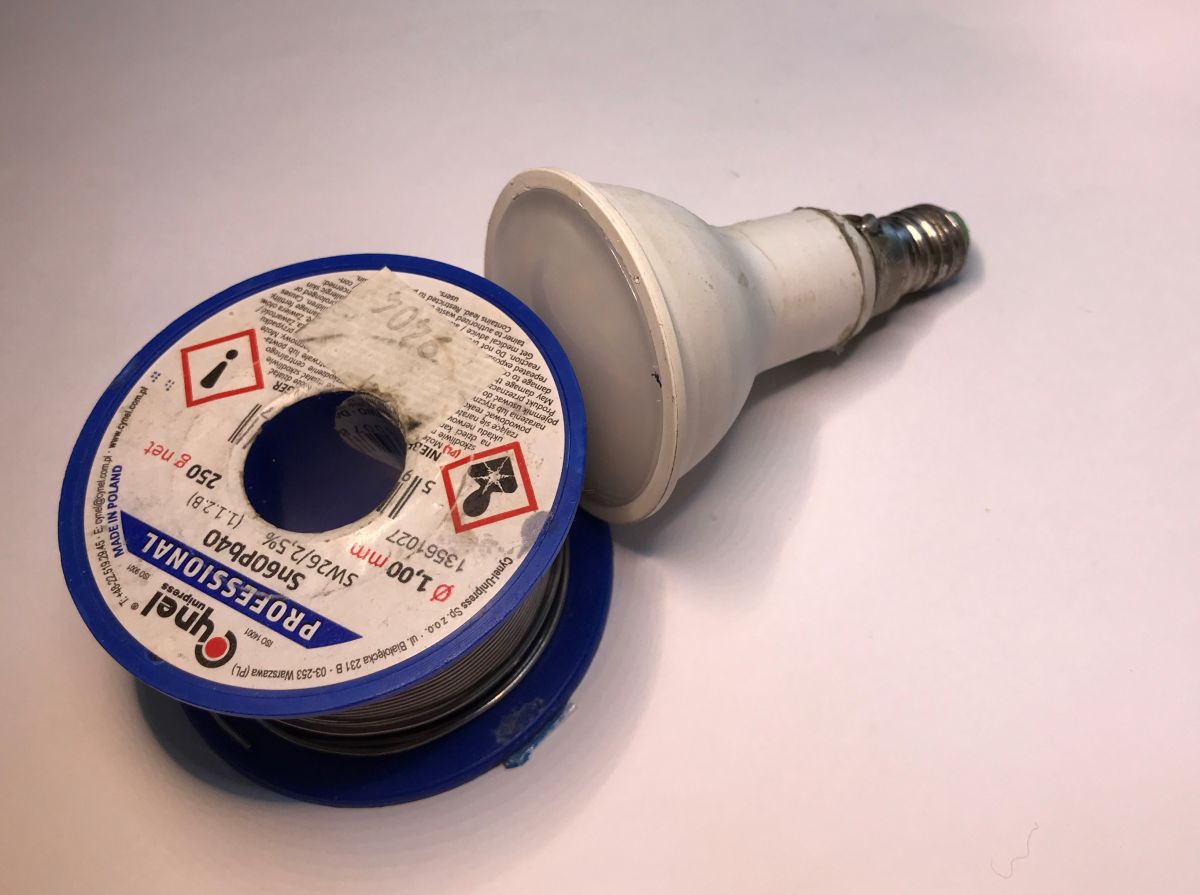

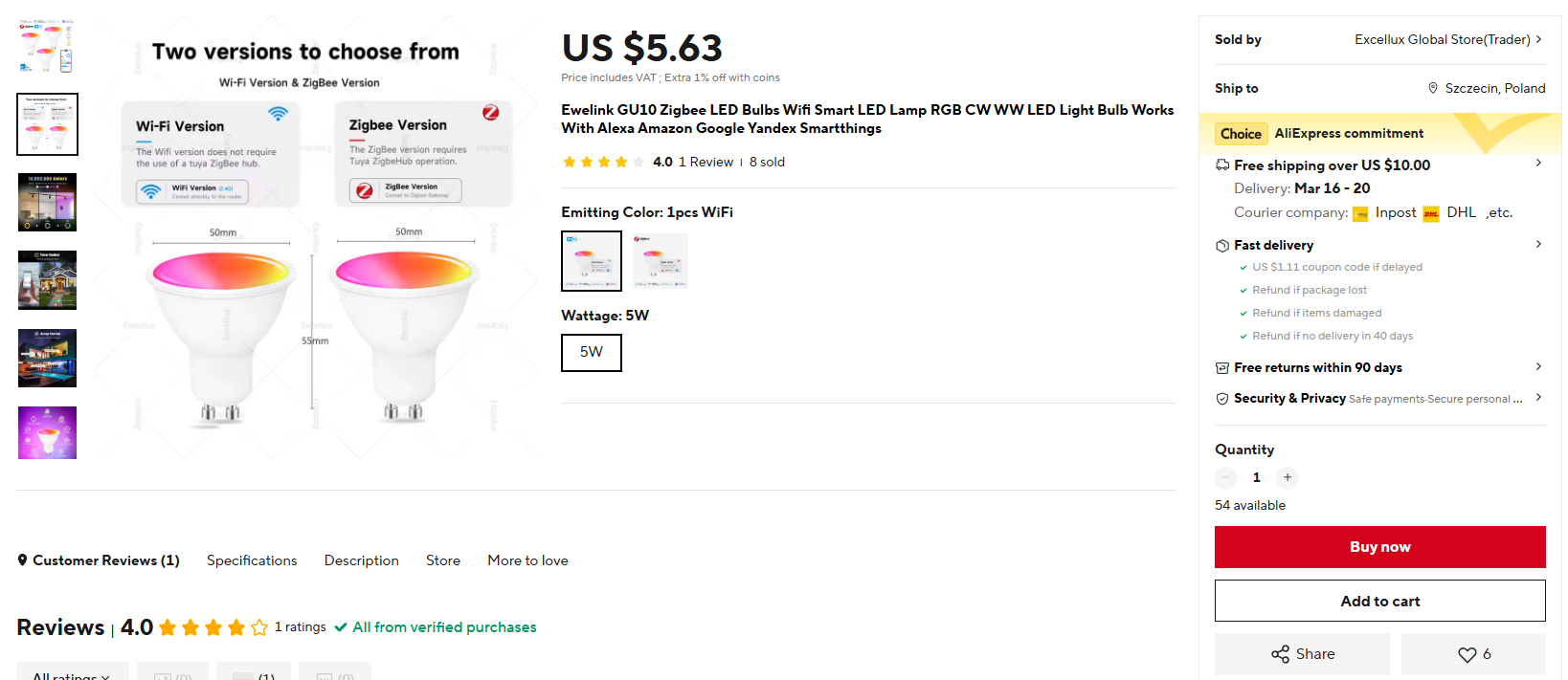

    I've ordered this GU10 eWeLink and I already have one Tuya GU10 waiting for teardown. So we'll be able to make a comparison.
    I am not worried about putting them back together. In case of the previous GU10 bulb I converted, I have managed to get it working with E14 base:
    A soldering wire spool with wire next to an LED bulb on a table.
    Still, I wouldn't recommend doing such modification to anyone...

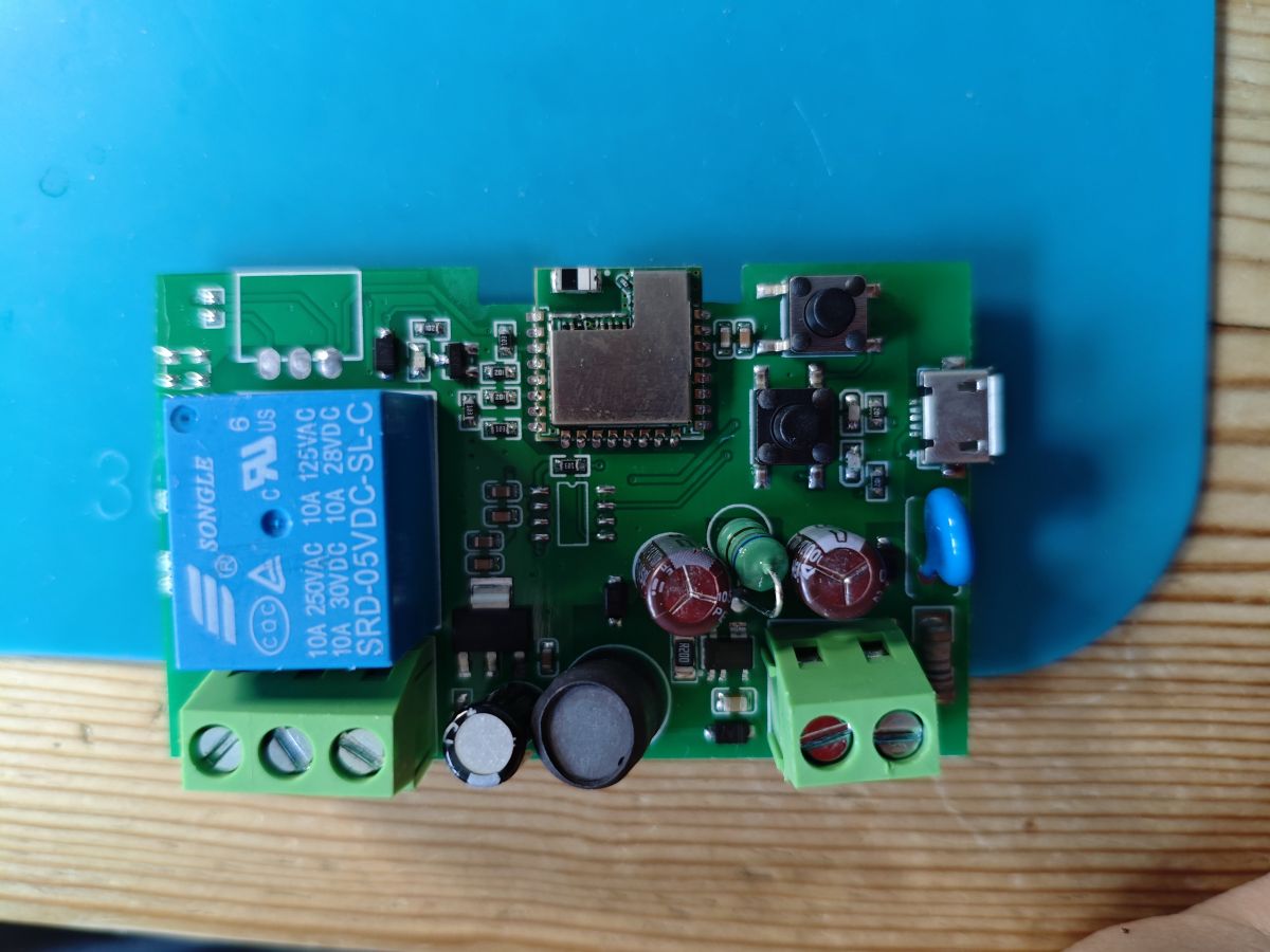

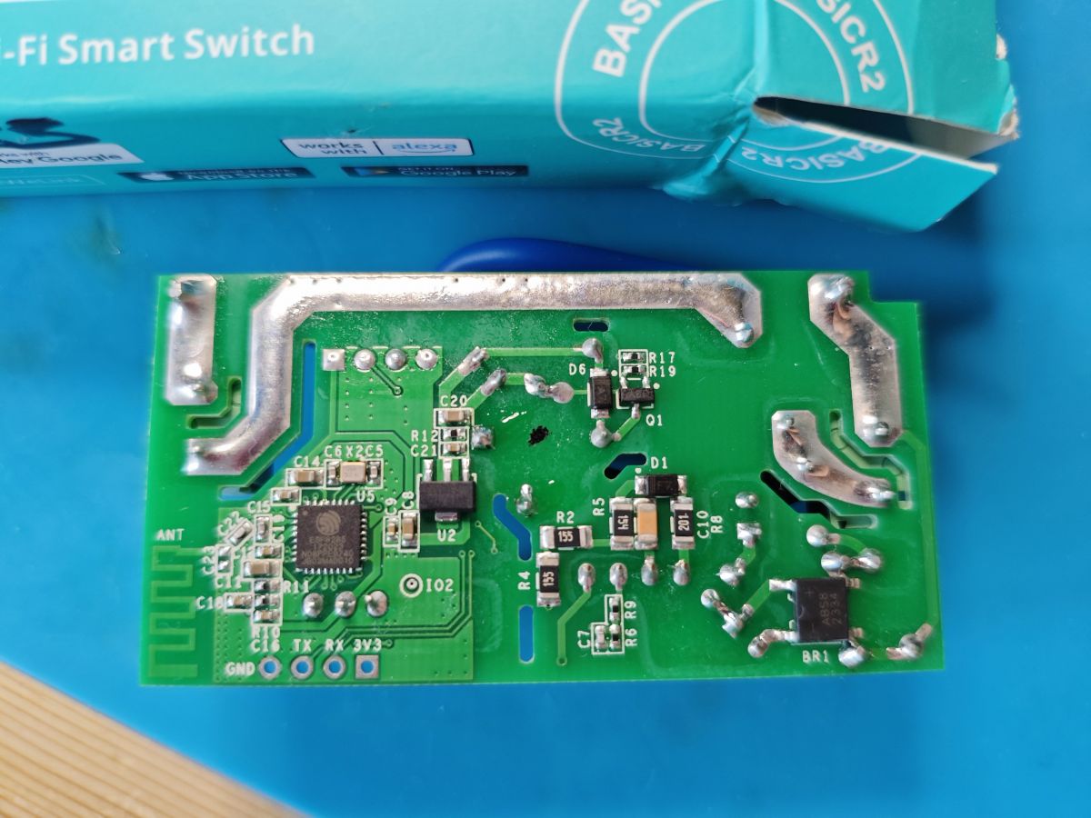

  • Identified ESP8285 modules in SONOFF switches
    #9 21477982
    Posts: 5236
    Help: 450
    Rate: 920

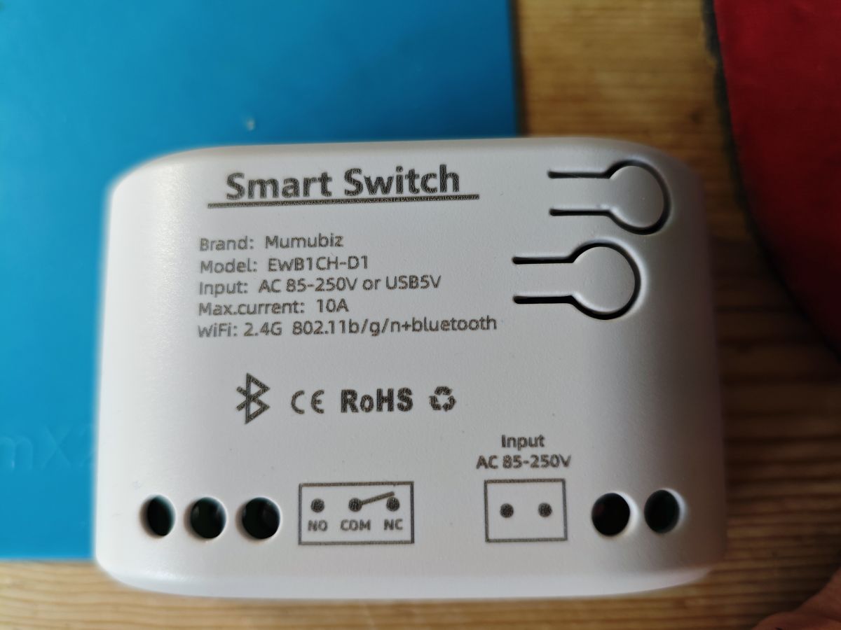

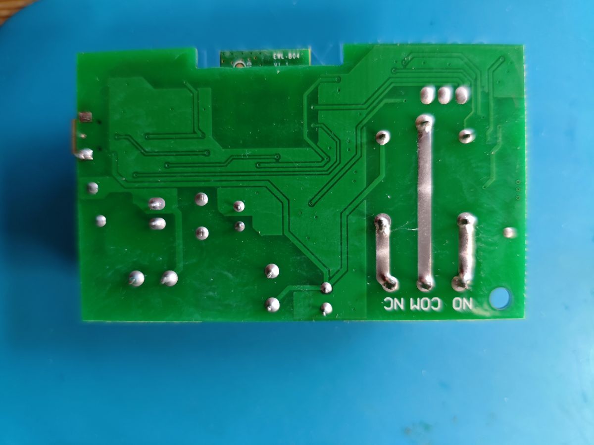

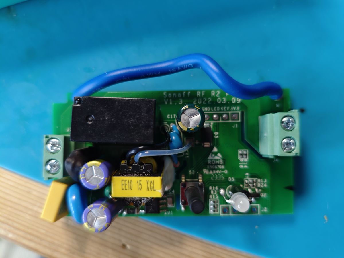

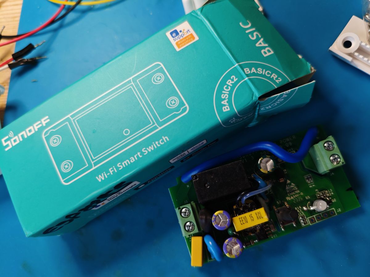

    I've these two. Not bulbs tho either
    SONOFF/eWeLink basic breaker ESP8285
    Printed circuit board of a Wi-Fi smart switch. Printed circuit board with electronic components and a blue wire. Box and module of Sonoff BasicR2 Wi-Fi Smart Switch.
    and this ESP8285 85V-250V/USB5V switch - EWB1CH-D1 - PSF-B04 module which I think I've seen on other things + Tasmota site
    Label with barcode on a package. Green printed circuit board with traces and soldered points. Relay on a green circuit board on a blue mat. Smart switch by Mumubiz, model EWB1CH-D1.

    @divadiow my GU10 eWeLink bulb should be here relatively soon, but the question now is, what to order next? Are there any other types of eWeLink bulbs that I can check?

    Circular printed circuit board with LED lights.
    Close-up of the interior of a circular printed circuit board with multiple LEDs and electronic components.
    Electronic module with LEDs and integrated circuits.
    LED board and an adjacent electronic module held by tweezers.
    A clamp holding a small electronic board with several soldered connections.
    PCB with soldered wires.
    Circuit board with LEDs and electronic components
    Close-up of a glowing LED light with visible electronic components on the circuit board.
    Round circuit board with LEDs emitting bright light.
    Close-up of a colorful LED diode with bright light spots.
    A glowing LED emitting purple light with visible electronic circuitry in a socket.
    If you want, you can also compare now this new flash dump with second E27 piece.

    GU10 eWeLink bulb arrived, last time to place your bets - do you think it will be BW2L @divadiow ?
  • #19 21486364
    Posts: 5236
    Help: 450
    Rate: 920
    I'm sticking to ESP
  • #20 21486388
    Posts: 14795
    Rate: 12953
    EW-GU10-E , also marked as C3009
    LEDs and electronic circuit inside an LED bulb held in a hand.
    It has BW2L. Looks like a perfect GU10 bulb for flashing without full disassembly/
    https://github.com/openshwprojects/FlashDumps/commit/6117519977bc88973b96d85f57b494d8f4810623
  • #21 21486414
    Posts: 5236
    Help: 450
    Rate: 920
    oh nice. the ultimate GU10 for conversion.
    Added after 4 [minutes]:
    I wonder if it uses the same firmware as the other two variants 🤔🤔🤔
  • #22 21486426
    Posts: 14795
    Rate: 12953
    The mentioned GPIO template works well on all eWeLink BW2L bulbs I've found so far.

  • The thread also identifies newer non-bulb eWeLink hardware with ESP parts, including an ESP8285 85V–250V / USB5V switch, alongside discussion of newer BL602 and Beken designs. [#21477982]

Why does the board under some eWeLink BW2L bulbs say CB2L, and what does that imply about earlier Beken-based variants?
It implies the hardware platform may have been reused from earlier Beken-oriented designs. The author notes an “interesting thing” that the board is marked CB2L, then comments that it “used to be a Beken chip.” A later reply expands that idea, saying the same bulb template and packaging appear across several variants, including one with a UAM022 Beken module. So the CB2L marking suggests board-family reuse, not a guarantee of the actual module currently fitted. [#21476028]
