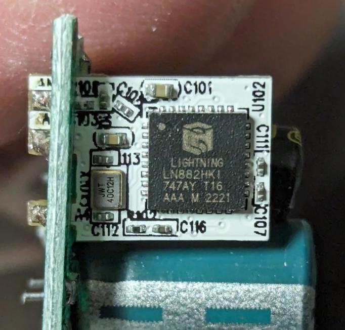

  • A GU10 RGBCW bulb uses a very tiny LN882HKI module with a BP5758 driver and works with OpenBeken for cloud-free Home Assistant control.
  • The module exposes UART logging on B8 (TX1) at 921600 baud and flashing on A3/A2 with A9 tied to GND for boot mode.
  • A backup with LN882H_Flash_Dumper.py COM3 saved 0x0200000 bytes, and flashing OpenLN882H_1.17.586.bin completed in about 4 seconds at 2000000 baud.
  • Two GPIOs control the BP5758D: A0 as CLK and A1 as DAT, and BP5758D_Map 2 1 0 3 4 fixed the red/blue swap.
  • WiFi was weak when the module was flashed off-board without the antenna board, and the OBK web status later showed internal temperatures above 100°C when lit.
  • LN882HKI module with labeled pins.

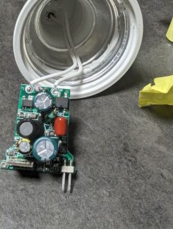

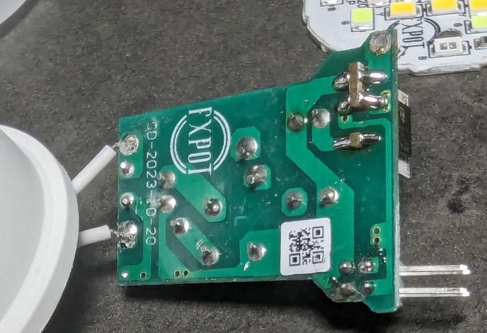

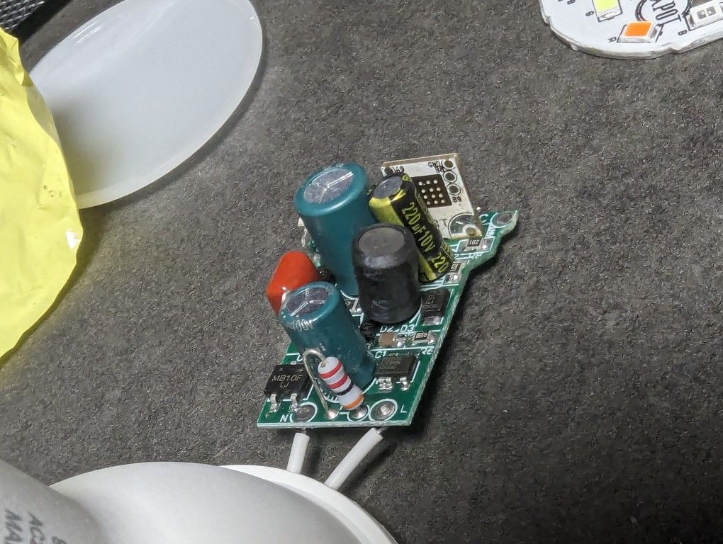

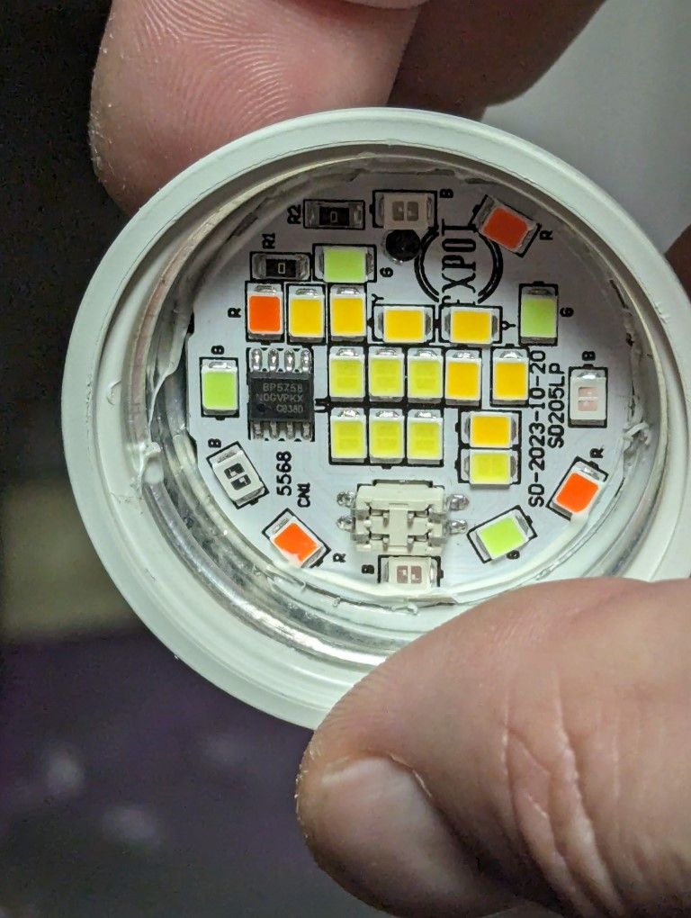

    This is a teardown GU10 RGBCW Bulb with new VERY tiny LN882HKI module, which I've never seen before. Obviously, this device is also supported by OpenBeken, so you can free it from the cloud and use with Home Assistant. Here are the details...

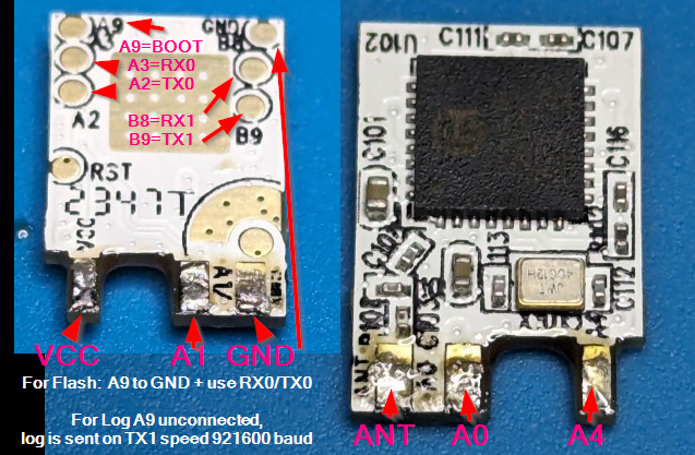

    Pin connections for LOG
    VCC <- 3V3
    GND <- GND
    B8 (TX1) -> RX (log is using baudrate 921600)
    Pin connections for backup and flash
    VCC <- 3V3
    GND <- GND
    A3 (RX0) <- TX
    A2 (TX0) -> RX
    A9 -> GND

    I had problems with the WiFi connection, because the antenna is on the power supply board, and I flashed it as just the module itself (meaning without the antenna). I had to put the module close (1m) to the WiFi AP to make it working. After soldering module later back into the power supply board, the WiFi worked normally.

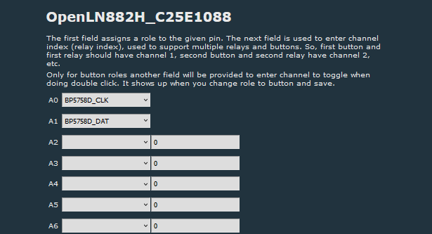

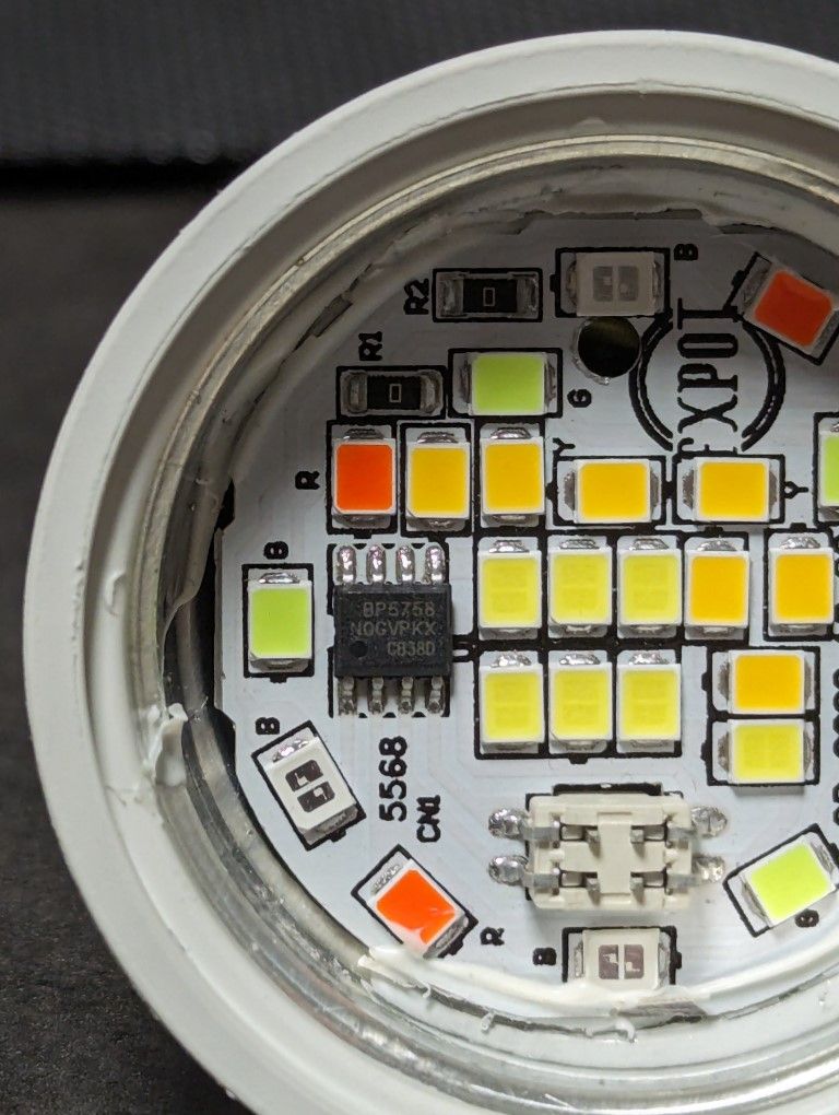

    Bulb has just two active pins to rule the BP5758.
    I've discovered this:
    A0 - BP5758D_CLK
    A1 - BP5758D_DAT

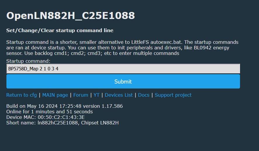

    Last thing was to change color map, because red was blue a blue was red.
    I've added OBK Startup command to solve it:

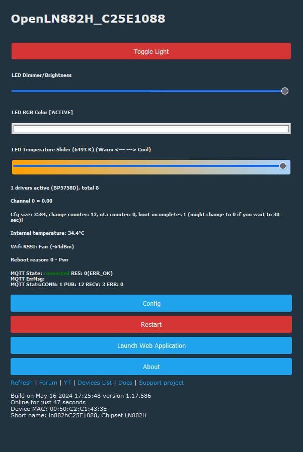

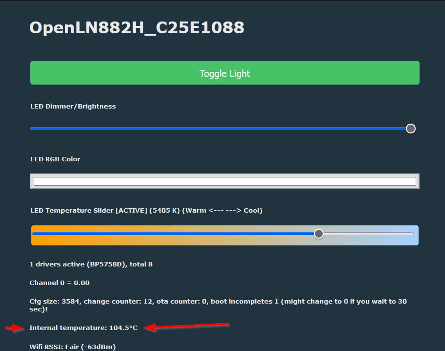

    Everything OK, the bulb is working OK. The only strange thing is, that the internal temperature (on OBK module web status) is over 100°C, when the light is on.
    Screenshot of the OpenLN882H user interface featuring LED brightness/dimmer slider, RGB color, LED temperature slider, internal temperature information, and WiFi signal strength.
    Here the OBK web and config:
    User interface of the OpenLN882H module configuration for a bulb.
    OpenBeken interface with startup settings for module Pin configuration in the OpenBeken panel for the OpenLN882H module.

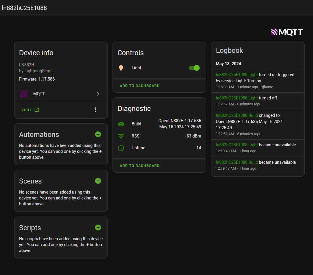

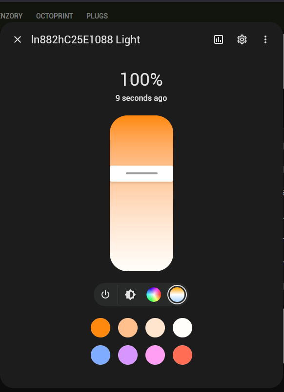

    Here the HASS:
    Configuration panel for LN882H module with MQTT and event log. User interface for GU10 light control with LN882HKI module.

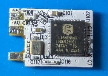

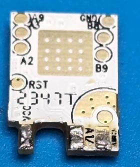

    Here the pinout:

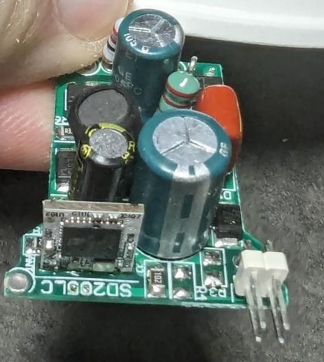

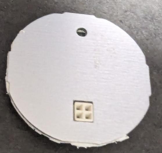

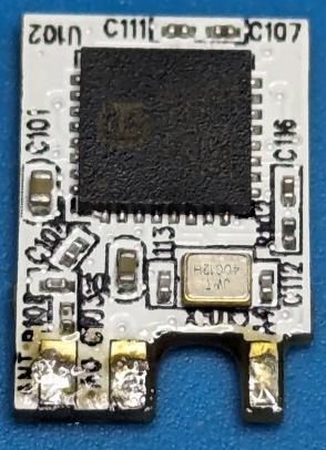

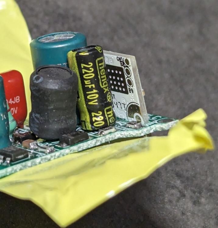

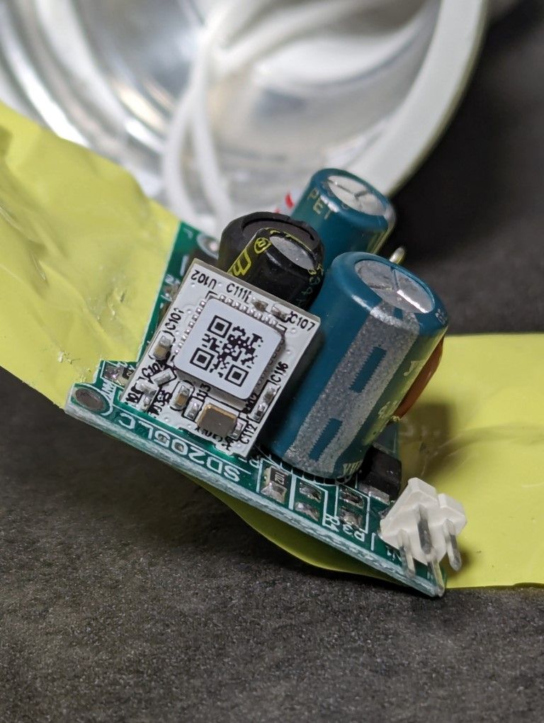

    And finally the module pictures:
    Image of a round electronic module board with a small connector in the center. Printed circuit board module LN882HKI with electronic components. Close-up of a small electronic module on a circuit board with various components. Close-up of an electronic module with visible pins and prints on a green board. Electronic module of the GU10 bulb with visible components. Open GU10 RGB bulb with visible electronic module. Close-up of the control module for a GU10 LED bulb. Interior of a GU10 LED bulb showing LED diodes and BP5758 module. LN882HKI module on a blue background Close-up of LN882HKI module on a white printed circuit board. LN882HKI module on a blue background, showing solder points and pin labels. Close-up of LN882HKI module on a circuit board. Electronic module with capacitors on yellow insulating tape Close-up of the LN882HKI electronic module on a GU10 bulb circuit board with electronic components.

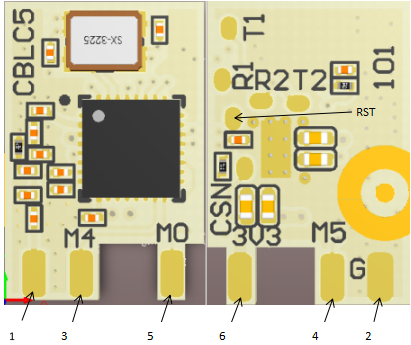

    Thank you for sharing. The used module seems similiar to CBLC5. Maybe it's an LN882HKI version of that?
    Here is original CBLC5:
    Close-up of CBLC5 module with component labels.
    I agree, it looks like. Its pinout compatible. Unfortunately, I couldn't find anything on the module, what would appear to be a type. There is only a date on the QR code - 202401090239F. I couldn't even find similar anywhere on the net (LN882).

    Strange behavior:
    The module displays a high temperature even when the light is off. After 5 minutes the OBK shows an internal temperature of about 65°C and stay within that range - it's not OK, it should be much lower.
    After turning on, the temperature raises to 105°C in 3 minutes, and after a next few minutes it stop responding to requests. The bulb continues to glow as it was set.

    There are few things that can be done to reduce the heating of your module:
    - first of all, you can enable PowerSave 1 in short startup command or in (if supported) LittleFS file autoexec.bat
    - then you can also tune the currents of BP5758 driver, maybe factory settings were using a lower current limit? Look up the command BP5758D_Current in our documentation
    - finally, keep in mind that all those modern LED bulbs are designed in such a way that overheating is expected, they do it to shorten the lifespan of the LEDs. I think you can easily benefit by just slightly lowering the drive current below the threshold set by the manufacturer. That way your LEDs will really be able to last longer.
  • #5 21086836
    max4elektroda
    Posts: 758
    Help: 49
    Rate: 189
    The high temperature is a known problem, the module itself gets quite hot, the surrounding (especially with heating LEDs) will make it even hotter.
    You probably should try if powerSave 2 is an option for you, maybe first try as user command.
    It should reduce the temperature significantly, but makes WiFi a bit unsteady.
    But a sometimes slow WiFi is probably better than no WiFi...

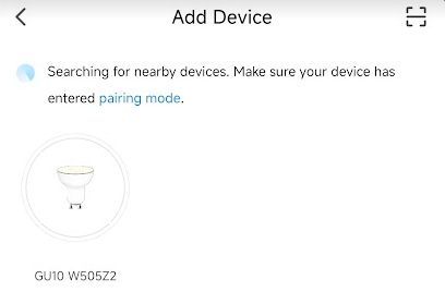

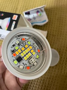

    #13 21281623
    Posts: 5212
    Help: 446
    Rate: 914
    annoyingly this GU10 variant has the same model number as the E14 candle version. Here is template for devicelist:
    Add device screen in app searching for GU10 W505Z2 bulb.
    Interior of a GU10 LED bulb with visible diodes and components on a circuit board.

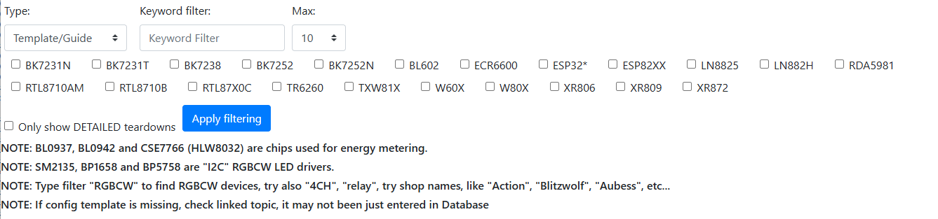

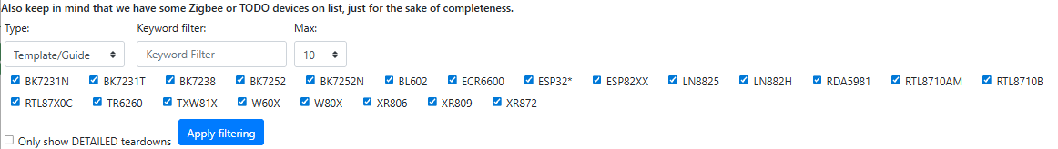

  • Add clear-all platform filters and move apply button
    #16 21917021
    Posts: 5212
    Help: 446
    Rate: 914
    Very nice idea, thank you, merged. What can we add next?

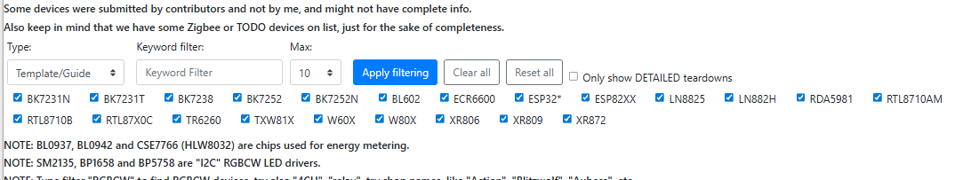

    loads probably. generally with web app or the devicelist?
    maybe I should finish: https://github.com/OpenBekenIOT/webapp/pull/261
    it needs a clear-all option for the platform checkboxes. also, does the
    Apply filtering
    button location look a little awkward?
    Filtering panel with platform checkboxes and an “Apply filtering” button
    Added after 1 [hours] 47 [minutes]:
    how about..?

  • #17 21918864
    Posts: 5212
    Help: 446
    Rate: 914
    thanks for merges. the checkbox filtering was OK but this behaves more like one would expect: https://github.com/OpenBekenIOT/webapp/pull/284
    choose one platform -> apply filtering -> get results for that one platform. true whitelisting. added OTHER checkbox for entries that aren't covered by checkboxes. reset all button also now includes resetting 'max' filter to 10.

  • Reported internal temperature reached about 65°C after 5 minutes with the light off and about 105°C within 3 minutes after turning it on. [#21086538]

Why does the OpenBeken web interface show the LN882H internal temperature going above 100°C in this GU10 bulb?
The reading goes above 100°C because the LN882H module already runs hot, and the enclosed GU10 bulb adds heat from nearby LEDs and the driver board. One report showed about 65°C after 5 minutes even with the light off, then about 105°C within 3 minutes after turning the lamp on. After several more minutes, the module stopped responding to requests while the bulb kept its last light state. That behavior points to thermal stress inside the compact bulb enclosure rather than a normal room-temperature operating state. [#21086538]

How do I set up the BP5758D pins and color mapping for this GU10 bulb when red and blue are swapped?
Set A0 as BP5758D_CLK, set A1 as BP5758D_DAT, and add BP5758D_Map 2 1 0 3 4 to startup. The bulb uses only two active control pins for the BP5758D driver. After flashing, the lamp worked, but red and blue were reversed until that mapping command was added. The same pin assignment also appears in the posted OpenBeken JSON template for this device. [#21086397]

What is LN882HKI, and how is it related to LN882H, CBLC5, or WBLC5-style modules?
"LN882HKI" is a tiny Wi-Fi module based on the LN882H platform, used as a CBLC5- or WBLC5-style drop-in form factor in compact smart bulbs. The thread describes it as a new, very small module and notes that its pinout appears compatible with CBLC5. Another contributor explicitly compared it to original CBLC5 hardware, and a later device entry listed the bulb’s chip as LN882H with keywords including ln882hki. [#21281623]

Where can I find documentation, device templates, or known device entries for LN882HKI-based bulbs in OpenBeken?
Use the Elektroda forum search first, then the OpenBeken device list and its published template entry. The thread points to a forum search query for LN882HKI, the OpenBeken web device list, and a later JSON template for a 220v 9W GU10 RGB+CW+WW Bulb model W505Z2. That template includes LN882H, BP5758D pin mapping, keywords like ln882hki, and a linked wiki page for the device. [#21281623]

How do the physical dimensions and pin compatibility of ESP8684-WROOM-07 compare with CBLC5 or LN882HKI modules for bulb retrofits?
ESP8684-WROOM-07 matches the CBLC5-style footprint closely enough for this retrofit. The thread cites Tuya dimensions for CBLC5 as 8.5±0.35 mm × 12.7±0.35 mm × 2.6±0.15 mm and Espressif dimensions for ESP8684-WROOM-07 as 8.5±0.2 mm × 12.7±0.2 mm × 2.6±0.2 mm. A contributor also said the tiny LN882HKI module appears pinout compatible with CBLC5. That makes the ESP8684 replacement mechanically realistic in the same GU10 bulb class. [#21204836]
