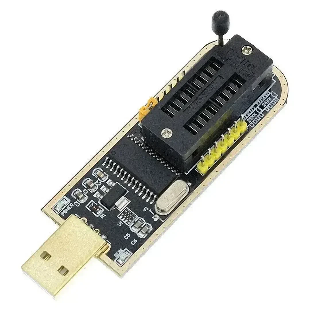

    He programs through this programmer. Do you think it gives it too little current to fire it up?
    I'll have to find a 3.3V stabiliser somewhere on the board then. ;(

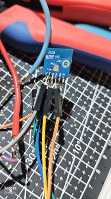

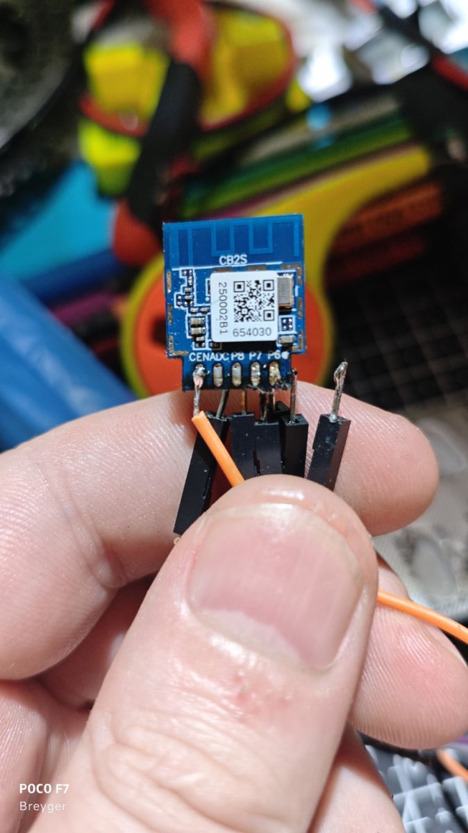

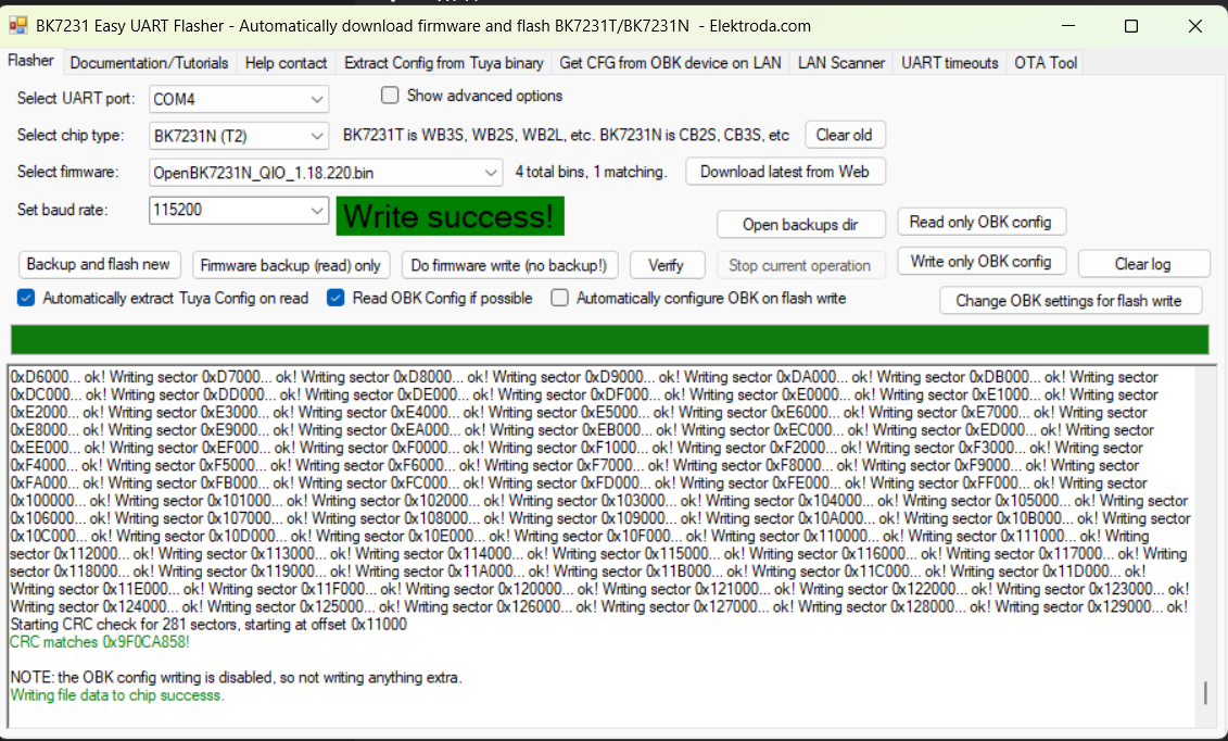

    Still nothing. It installs as shown in the screenshot. I also tried with the U, M etc tip but then it shows errors.
    I powered it with a lab power supply, gave it 3.3V and 1A but it doesn't even eat 0.01A.
    What am I doing wrong? ;(
    PS. There are no shorts on the pins. It just looks like this in the picture.

    CH341 has an AMS1117-3.3V on the LDO board.
    At this point you can do two things:
    1. peel off the sticker, is it definitely a BK7231N or maybe a BK7231M? There have been cases like this
    2. This is what the log shows on the UART under TX2 at 115200 baud?
    It would also help a lot if you posted a 2MB copy of the original batch, then we could see if it runs on a normal CB2S

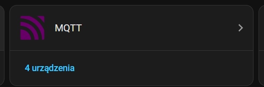

    E.g. video 2, 1:00 minute of the video. i have no such thing as a configuration in the MQTT add-on. I have something like this:
    MQTT panel with icon and 4 devices text on dark background
    MQTT add-on interface showing device list and Mosquitto broker

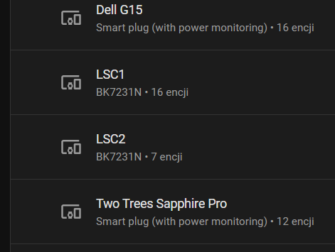

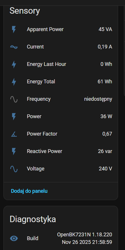

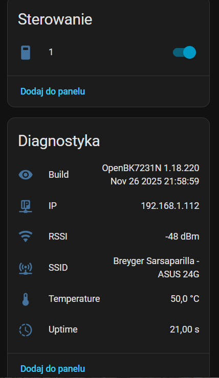

    Why do I have 16 entities together with energy in LSC1, while LSC2 has 7 entities and none with energy (energy, I mean sensors)? I've checked everything I think, and it seems that everything is configured the same. What to check?
    Smart plug devices list showing different entity counts, two with 16 and one with 7.
    Sensor and diagnostics panel of OpenBK7231N with displayed energy metrics
    OpenBK7231N diagnostics panel showing network info and device temperature
    Home Assistant discovery requires energy measurement enabled first

    And I see, HA has changed the interface for downloading the MQTT password. So much for this being a rather independent piece of configuration and on top of that it is rather basic, one can assume that the user rather knows himself how to retrieve his broker's bearing beforehand.... i will think about possibly recording a newer version of the video.
    And the socket itself sees the energy measurement? HA Discovery has to be done with that measurement on, if you do Discovery first and then turn the measurement on, HA won't see it.
  • HA MQTT discovery requires energy measurement enabled first
    #12 21770143
    artin.bruyen
    Posts: 339
    Help: 13
    Rate: 130
    As I see it, HA has changed the interface for retrieving the MQTT password. So much for this being a rather independent configuration item and on top of that it is rather basic, one can assume that the user rather knows himself how to retrieve his broker's bearing beforehand.... i will think about possibly recording a newer version of the video.
    And the socket itself sees the energy measurement? HA Discovery needs to be done with that measurement on, if you do Discovery first and then turn the measurement on, HA won't see it.
    Thanks. They appeared on their own, probably HA must have "thought of something".
