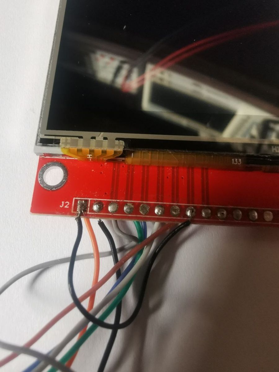

    I have an ESP32 DevKit v1 and an LCD display with ILI9486 when connected this way:
    #define ILI9486_DRIVER
    #define TFT_MISO 19
    #define TFT_MOSI 23
    #define TFT_SCLK 18
    #define TFT_CS 15
    #define TFT_DC 2
    #define TFT_RST 4
    #define TFT_BL 21 // or 3.3V
    #define SPI_FREQUENCY 27000000
    Unfortunately a white screen all the time , what could be the reason for this are you able to help.
    Many thanks in advance

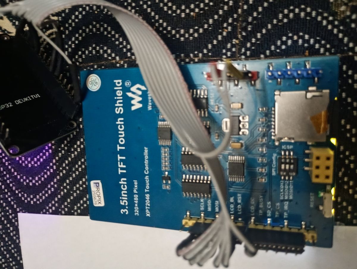

    I have this display3.5 TFT Touch Shield module with XPT2046 controller connected to ESP32 Devkit v1
  • Suggest testing the display on an Arduino Uno first
    #2 21775591
    gps79
    Level 37  
    Posts: 2212
    Help: 495
    Rate: 798
    It is not known whether the problem is on the hardware or software side. It is also not known if the display works, so I would suggest running some simple demo program under "best" conditions, i.e. with 5 V power and I/O and on a popular platform; e.g. Arduino Uno.
    https://www.waveshare.com/wiki/3.5inch_TFT_Touch_Shield
    Once you know that the display is working (the backlighting of the screen is not proof of this), then you can swap the microcontroller, library, etc.
    I would also add that for any analysis the information presented so far is not enough. You don't know what the wiring diagram is, how everything is powered, what the program looks like and what it is compiled with.

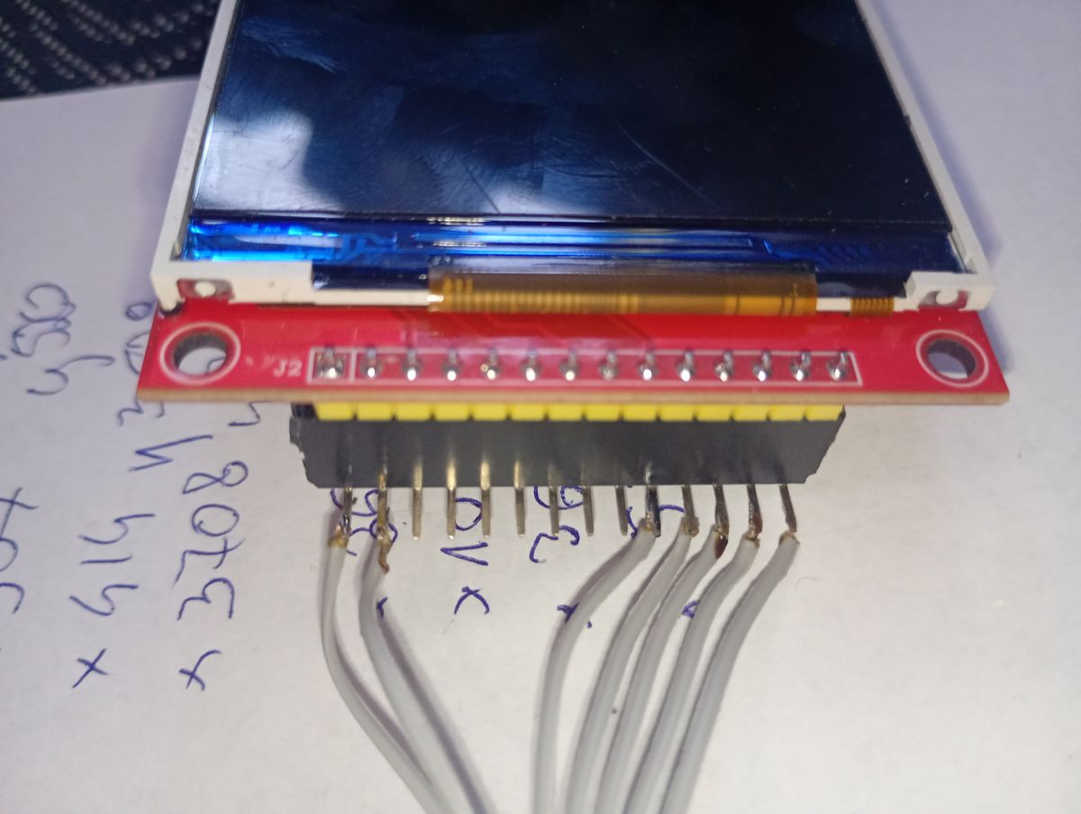

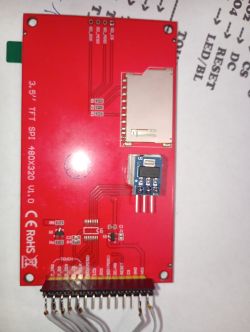

    I have a question if this display has touch because I plug it in and something doesn't workBack of 3.5-inch TFT display with labeled pins and microSD card slot visible
  • #17 21789995
    inot
    Posts: 3619
    Help: 449
    Rate: 818
    It can be seen that the U2 integrated circuit is missing.
  • #18 21789996
    darex120
    Posts: 1117
    Rate: 62
    So as I thought, there isn't one, and such a circuit if I add one, the touch will work?
  • #19 21790002
    inot
    Posts: 3619
    Help: 449
    Rate: 818
    It is not known what kind of integrated circuit it is. It would be necessary to compare with similar displays.
  • #20 21790021

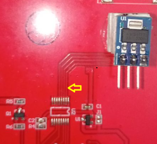

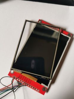

    Good question but I think soLCD display module with gray signal wires soldered to pin header
  • #23 21790267
    inot
    Posts: 3619
    Help: 449
    Rate: 818
    If this missing IC acts as a touch, these 4 tracks should be connected to the foil.

  • #26 21791685
    efi222
    Level 22  
    Posts: 779
    Help: 12
    Rate: 1220
    >>21790159
    This display does not have a touch panel.
    With "touch" it looks like the one below.
    Close-up of an LCD screen with attached touch panel and soldered wires
    This is a fairly rigid 'pane' glued edge-to-edge to the screen
    Display module with a separate touch panel placed loosely on top
  • #27 21791760
    inot
    Posts: 3619
    Help: 449
    Rate: 818
    Well, all explained. Hence the absence of this IC on the board.
