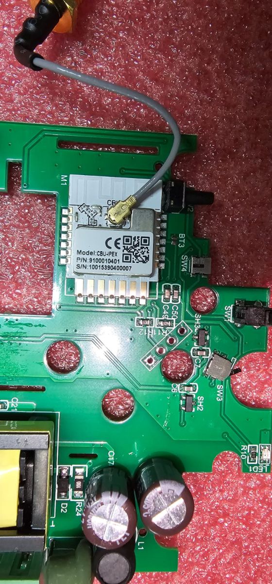

    Module: BK7231N - CBU-IPEX
    Photos:
    Smart circuit breaker with Wi-Fi module and external antenna CBUI-PEX wireless module on green PCB with attached antenna cable
    Connection: https://developer.tuya.com/en/docs/iot/cbuipex-module-datasheet?id=Kaedsyurckrhu
    You can access CBU by removing rivets with a drill.

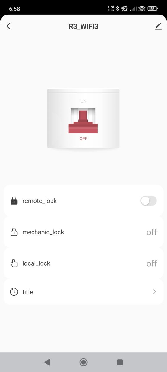

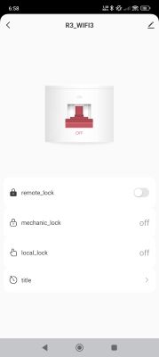

    boot log from dump w/TuyaMCU emulation using product key 1bnccnulaqx6xerl from dump
    dpIDs/schema
    App screen showing R3_WIFI3 smart switch turned off and lock options disabled

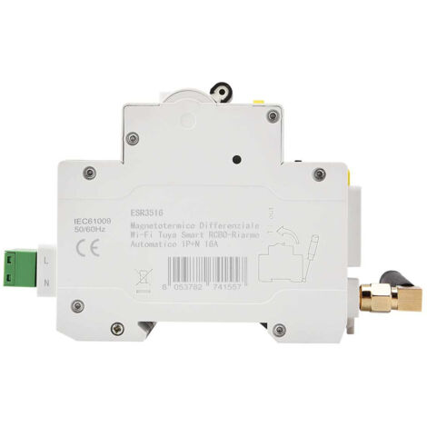

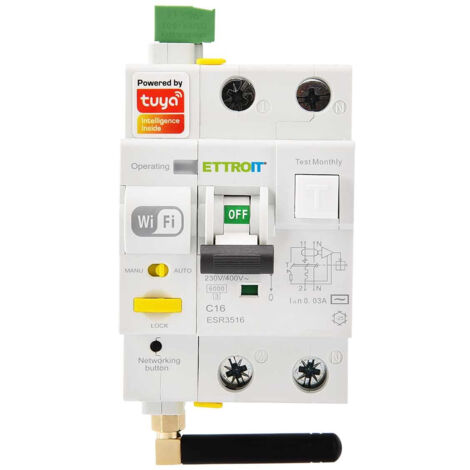

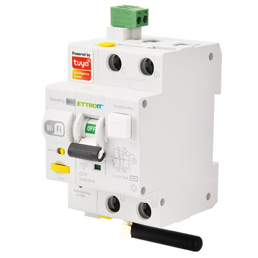

    Extra device photos:
    Residual current circuit breaker with Wi-Fi and test buttonWi-Fi differential circuit breaker with technical label and connectors
