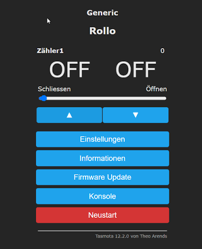

    Objective:
    To make a two relay control for controlling a roller shutter.
    Requirements:
    Control via local monostable two-touch buttons (i.e. usually "bell with two buttons" up/down).
    And control via the web page of the switch itself.
    Up, Down and SUWAK button!
    (Following an analogy with how it worked in Tasmota)
    General logic:
    Pressing the Up button turns on relay R1 for time T (or T-Te).
    Pressing the Down button turns on relay R2 for time T (or T-Te).
    If the Down button has been pressed and the time of the previous driving has not ended, then:
    a) at the previous control Down - stop the roller shutter (switch off all relays), save the current value from time T as Te.
    b) at the previous control Up - switch off the relay, wait for the stop time Tz, start the control Down for the appropriate time from the current position.
    Similarly, the other way round.
    I would very much like to be able to control the slider (slider bar) via www of the device itself.
    That is to say, you change the position and the roller shutter moves up accordingly
    That is, to achieve an action in analogy with Tasmot's Shutter.
    Something like this:
    Screenshot of Tasmota web panel for shutter control with buttons and slider
    I fail to configure so that there is this slider.
    Or has anyone already figured this out?
    Please help and support with this roller shutter control. Thank you in advance.
