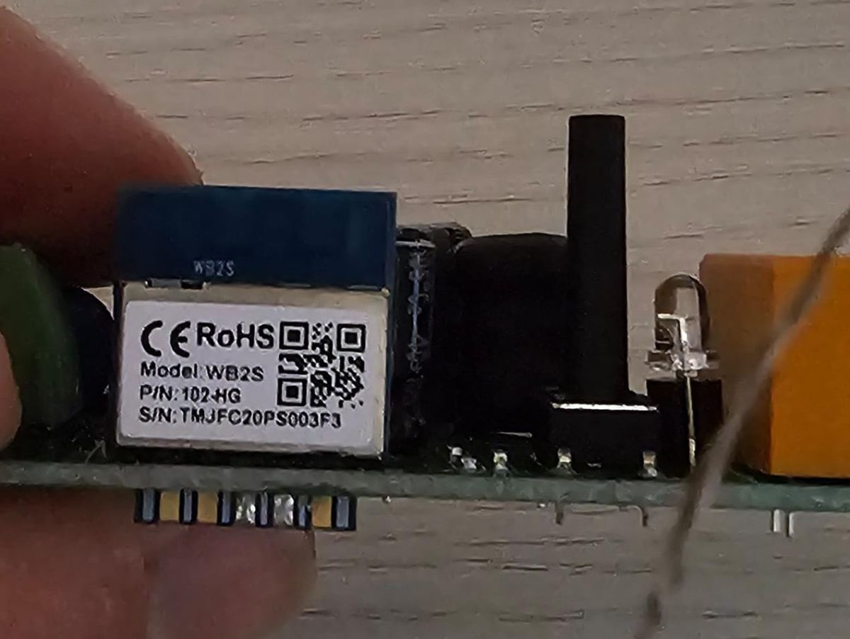

MOES MS-102 Garage Opener With WB2S BK7231T
lamero345 543 5
  • #1 21782674
    lamero345
    Posts: 33
    Name: MOES MS-102 Garage Door OPENER
    URL: https://www.aliexpress.com/item/33020999004.html
    Module: BK7231T - WB2S
    Photos:
    Moes Wi-Fi Smart Garage Door Opener module on light wooden surface WB2S communication module on PCB with CE marking and visible QR code

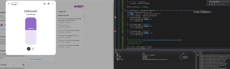

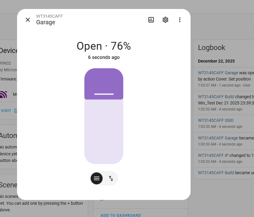

    Any ideas what should a dedicated garage door driver provide? A logic to send a pulse and display door in HA?
    I am doing Shutters driver now, and once I finish, I may do a garage door driver as well.
    Garage device UI showing unknown status, with Visual Studio debugger on the right
    App interface showing garage WT3145CAFF is open at 76%
