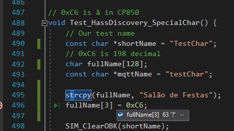

    I added a self test but I am confused:
    Code: C / C++
    It seems to pass as is already.
    https://github.com/openshwprojects/OpenBK7231T_App/pull/1934
    Or maybe it got saved as ?
    Yes it did, retrying.
    Screenshot of C code in an editor modifying a character array with ASCII values
    Added after 24 [minutes]:
    This passes:
    Code: C / C++
    Maybe it breaks because I can't have special char there?
    Code: C / C++

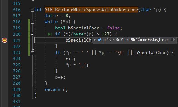

    SO it would mean:
    - we already can have special chars in quotes ids list for HA
    - but we can't use them (obviously) in internal entity names, so i need to prune them
    Added after 11 [minutes]:
    I probably could patch STR_ReplaceWhiteSpacesWithUnderscore to prune those characters
    Added after 16 [minutes]:
    Like this:
    MQTT Not add item with Accents in "Configure Names" Configuration
    and then rename command to "sanitize"

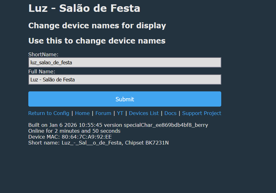

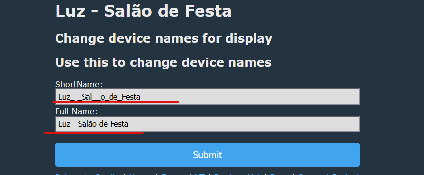

  • #11 21800909
    tadeu1
    Posts: 83
    >>21800497
    Thumbnail with photo icon and text “Luz_-_Sal_o_de_Festa BK7231N • 9 entidades”
    Device name change form with error in the ShortName field
    Now it's working.
    Device name change panel showing Luz - Salão de Festa
    Text on dark background with “luz_salao_de_festa” and details “BK7231N • 9 entidades”
  • #12 21800943
    Posts: 14770
    Rate: 12913
    So, it's okay now? Is it ready to merge? I see short name got corrected, but short name is used for MQTT, I don't think there is a way around it. Long name is for display, I think.
  • #13 21801040
    tadeu1
    Posts: 83
    I just put the character in the short name to test. No one wants to use an accent there (I hope); the full name is OK. Tks
