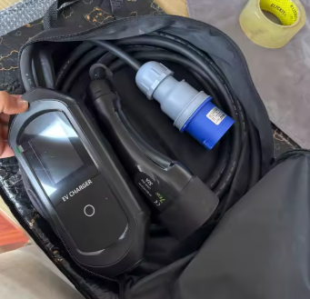

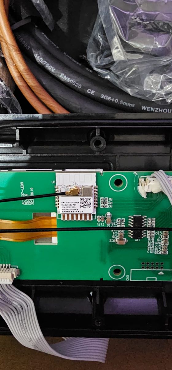

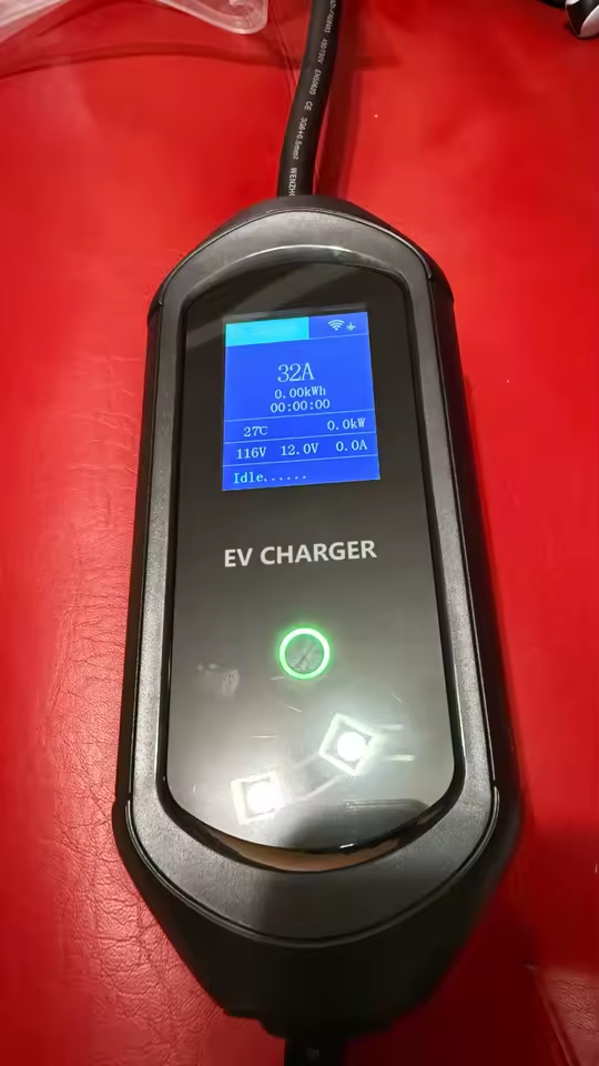

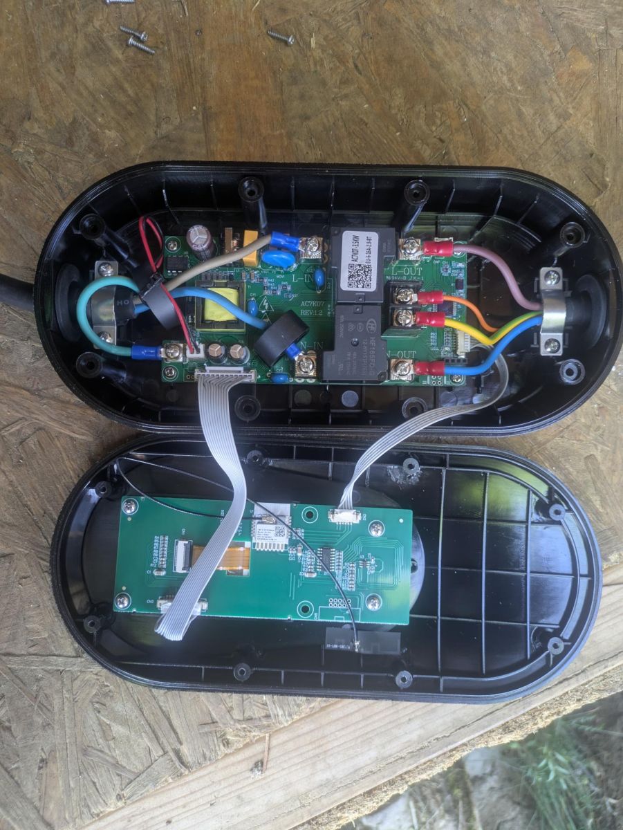

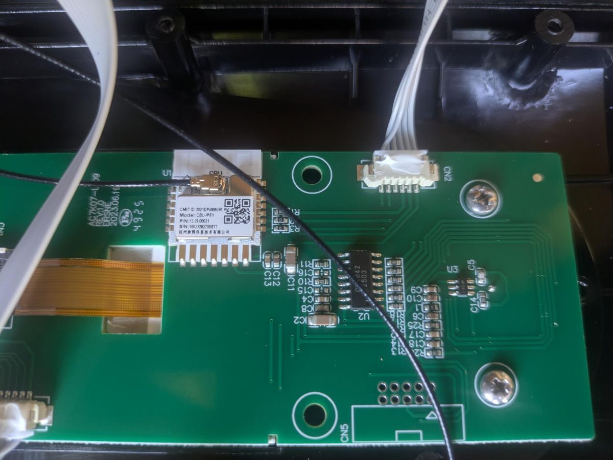

    lamero345
    Posts: 33
    Name: AFYEEV 32A 7.2KW Type2 Type1EV
    URL: https://www.aliexpress.com/item/1005007587878624.html
    Module: BK7231N - CBU-IPEX
    Photos:
    EV charger 32A with LCD screen, Wi-Fi support, connectors Type1, Type2, GB/T
    Printed circuit board with communication module and connected wires
    Connection: https://developer.tuya.com/en/docs/iot/cbuipex-module-datasheet?id=Kaedsyurckrhu

  • Asking whether OBK has been configured already
    #2 21800825
    Posts: 14770
    Rate: 12913
    Thanks for sharing! I rarely see CBU with antenna. I guess long range really matters there!
    Here is a bit more information about this device that I've found on the Aliexpress page:
    AFYEEV 32A 7.2KW EV Charger Type2/Type1 with BK7231N-CBU-IPEX Module Info
    Have you tried configuring OBK already?

    TuyaOS boot log from BK7231N backup
    #5 21801058
    Posts: 5220
    Help: 449
    Rate: 918
    boot log from that backup. TMDA/pk:dsmsam7xpb3ht7rl

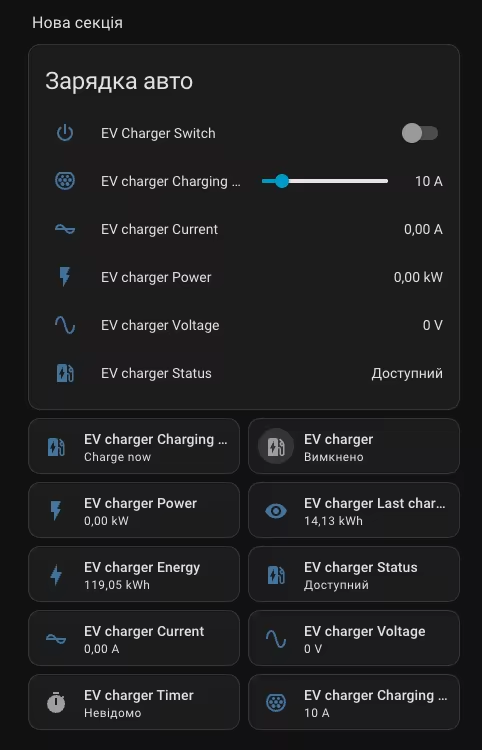

  • Local Tuya limits charge current to preset values
    #9 21926473
    julienc
    I have this Afyeev charger and finally got it to work with local Tuya (a real pain in the ass to get there with SmartLife and Tuya cloud)... This is so frustrating when open standards exist!
    Any feedback on this ESPHome/OpenBeken/Tasmota flash?
    Sorry if these are dumb questions, but can the flashing be accomplished without desoldering/soldering on this device?
    Using SmartLife, Tuya cloud, Local Tuya, or TinyTuya, I couldn't set the DPS 4 charge_cur_set to something else than 6 A, 8 A, 10 A, 13 A, or 16 A (if I inject another value, it is not changed), although the config states it could be set with 1 A steps. Is there any hope that the charge current could be set to 5 A or 7 A after flashing?
    It would be great to be able to use my solar surplus to charge the car...
    Thanks a lot for your work and info sharing!

    Hmm ok, can you check what kind of WiFi module do you have in your charger? Just open a case and take some photo? Because as it happens, I actually seem to have one charger at hand...
    Maybe I could try to perform some tests on my side, maybe dpIDs are matching?
  • #13 21929315
    julienc
    Hi,
    Sorry for the delay, here are 2 pics of the WiFi card (CBU-IPEX P/N 13 29/00021 CMIT ID 2021DP4906M). Looks very much like the one from OP.
    AFYEEV 32A 7.2KW EV Charger Type2/Type1 with BK7231N-CBU-IPEX Module Info AFYEEV 32A 7.2KW EV Charger Type2/Type1 with BK7231N-CBU-IPEX Module Info
    Thanks for investigating this!
