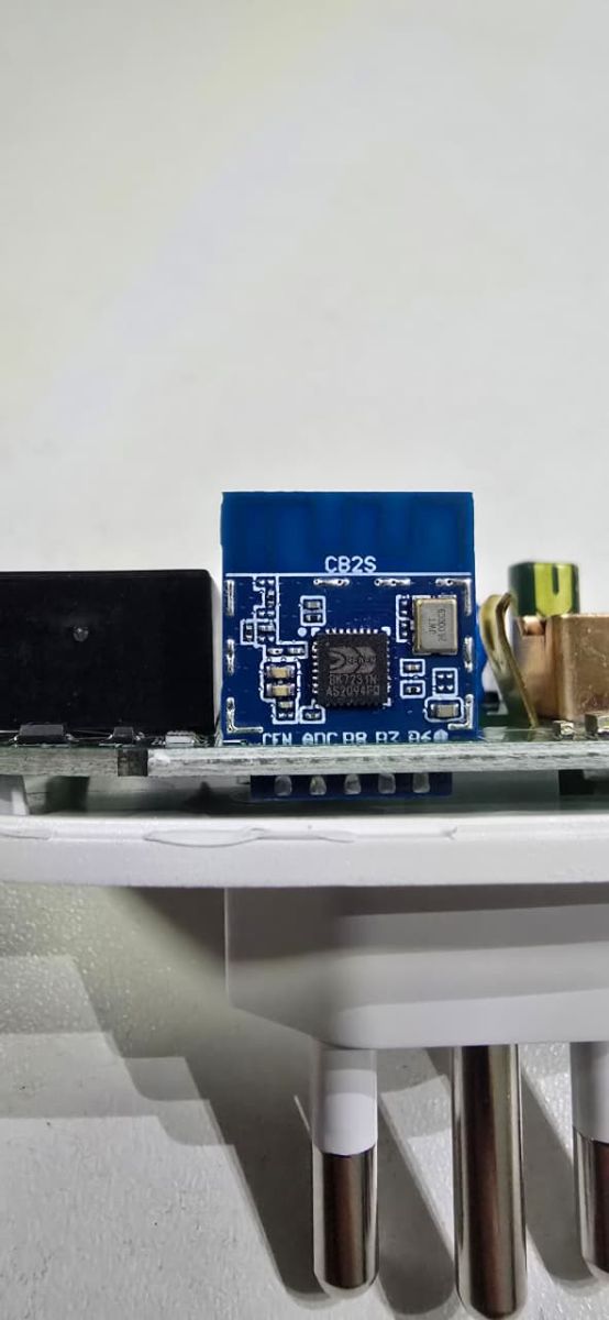

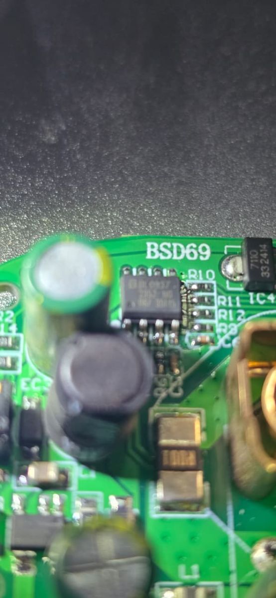

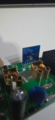

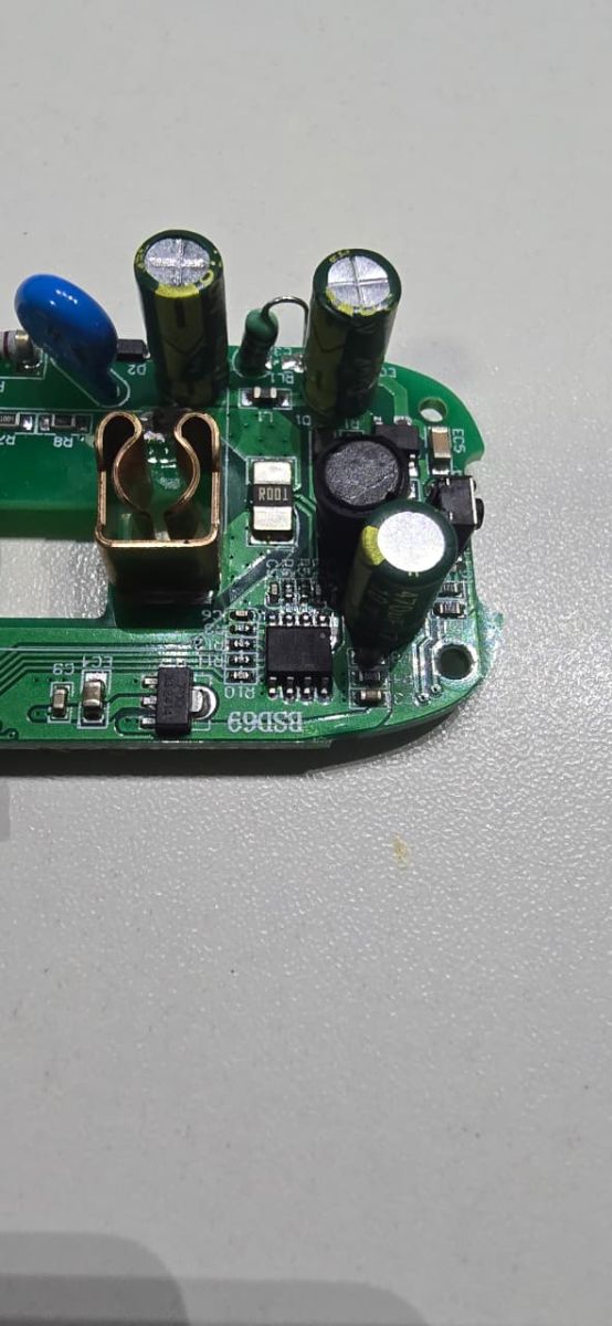

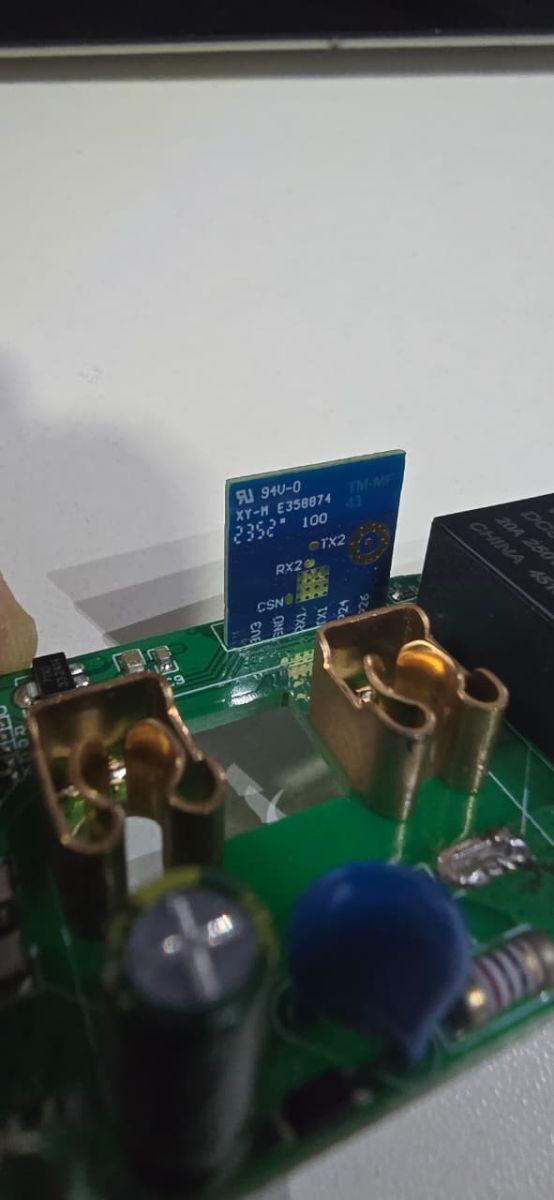

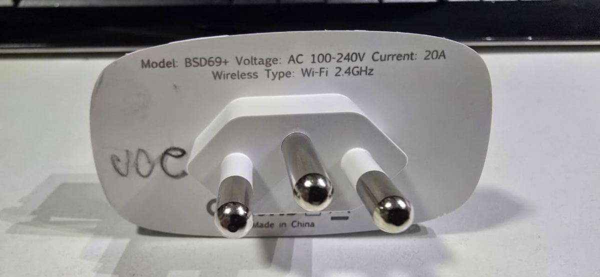

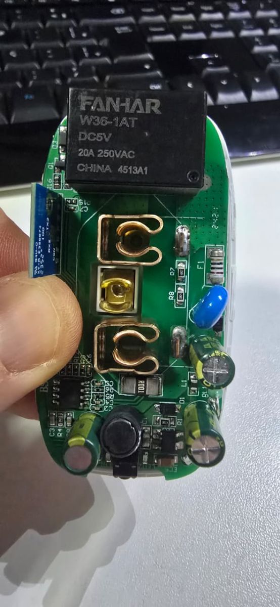

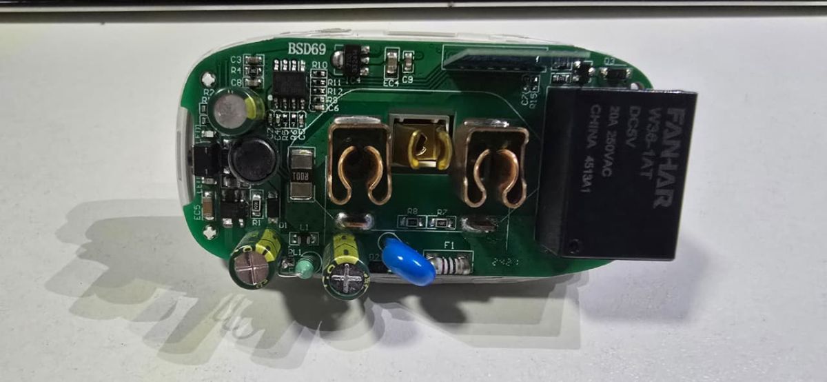

    Flashing a Power Outlet AESSY BK7231N CB2S 20A
    Flashing using this post
    https://www.elektroda.com/rtvforum/topic4057500.html
    https://www.elektroda.com/rtvforum/topic3951016.html
    Aliexpress link
    https://pt.aliexpress.com/item/1005007540020229.html
    Smart Wi-Fi plug with power monitoring function, supports 16A and 20A current
    CB2S module on a circuit board inside an electrical device Printed circuit board with capacitors, inductor, and electronic components XY-M electronic module on green PCB with components and connectors Printed circuit board with FANHAR relay and various electronic components Close-up of green PCB labeled BSD69 with visible electronic components. Three-pin power plug with technical specifications printed on the back. Top view of an electronic device interior with relay and components labeled FANHAR

    I'm guessing it's some custom firmware with pin assignment hard-coded but I'd be curious to know if the attached Easy Flasher finds any assignments. The JSON side will of the extraction tab will have more in it, but not necessarily anything useful.
    • BK7231GUIFlashTool (12).zip (960.14 KB) You must be logged in to download this attachment.
  • Original firmware configuration and pin mapping extracted
    #3 21803169
    tadeu1
    Posts: 83
    attached the original fw
    using yout tool
