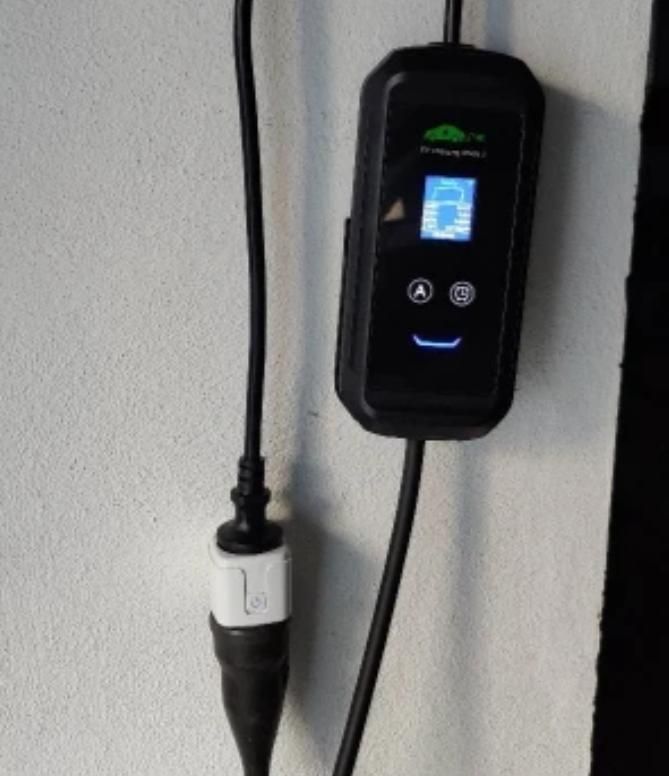

    Feyree type 2 EV charger, 7.6KW, 1 phase, 32A with dynamic load balancing. EV charger housing with exposed red reset button and specification plate. Contents of EV charger box with manuals and accessories.
    The goal for me was to be able to adjust the amps/power from MQTT or home assistant while EV charging is in progress. This can be done with OpenBeken.

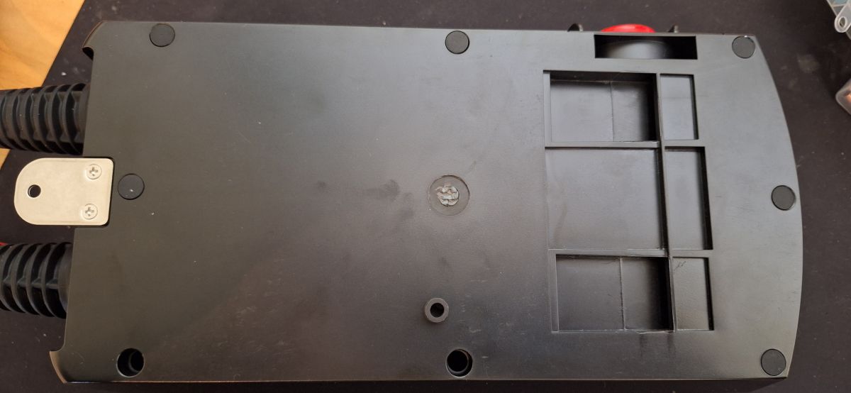

    Opening
    Easy to open, with 8 screws covered by rubber seals.  There was no warranty/security seal.
    View of the bottom part of a black EV charger casing with cables on the side.

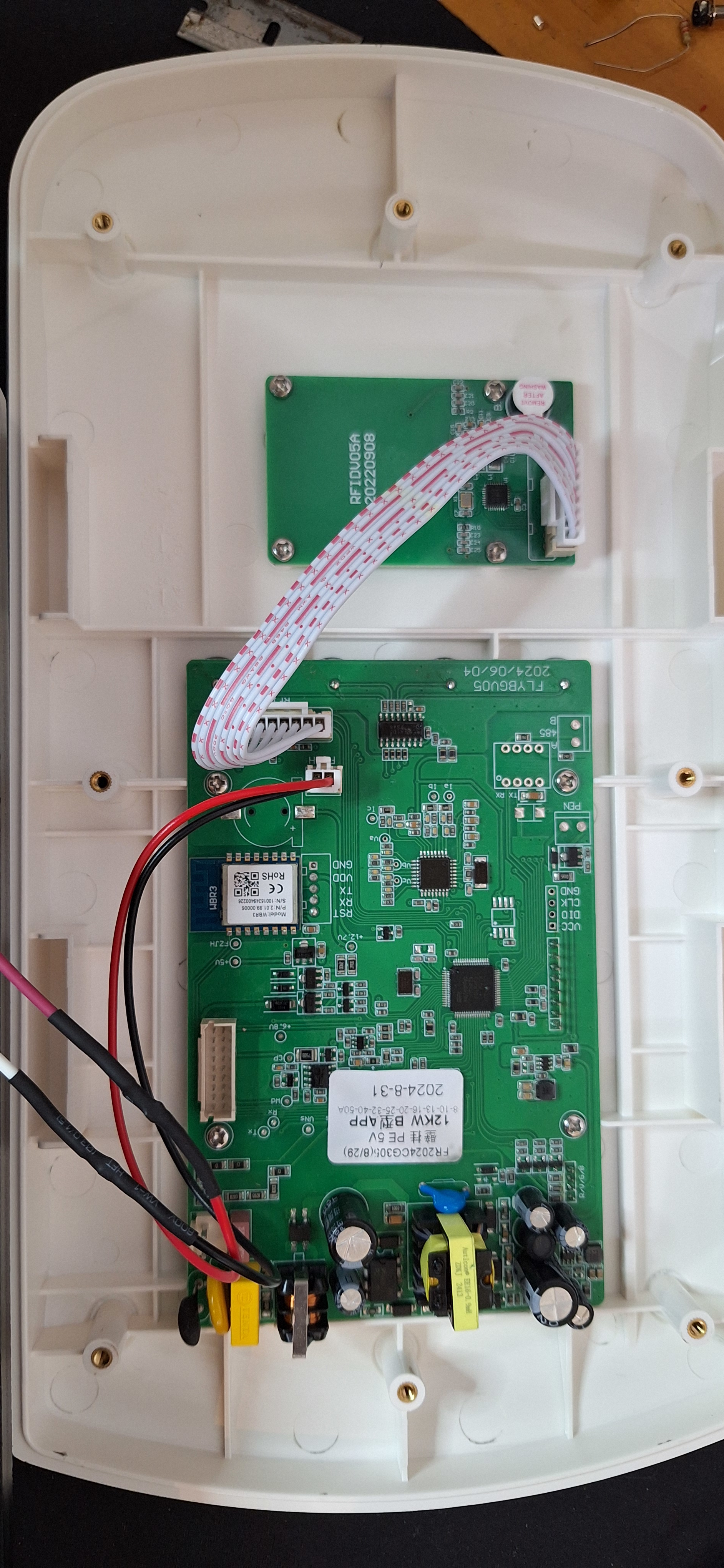

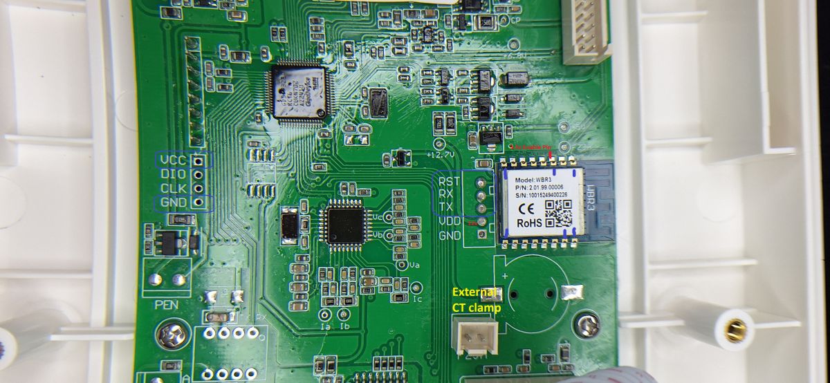

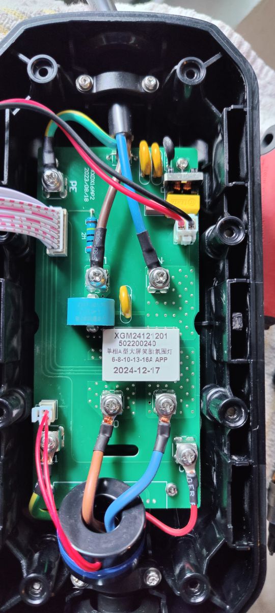

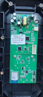

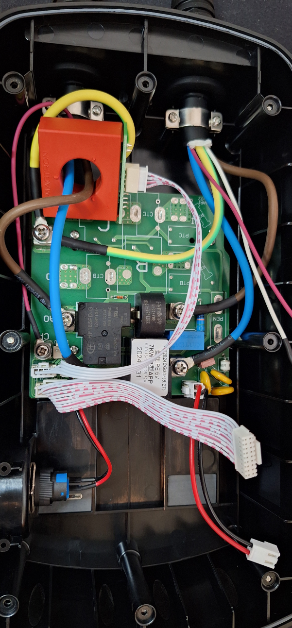

    Device Overview

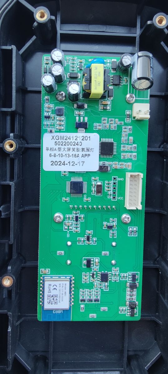

    This particular charger is 240v, 32a single phase.  It also has a secondary CT clamp on the input wiring end that can be extended to a distribution board.

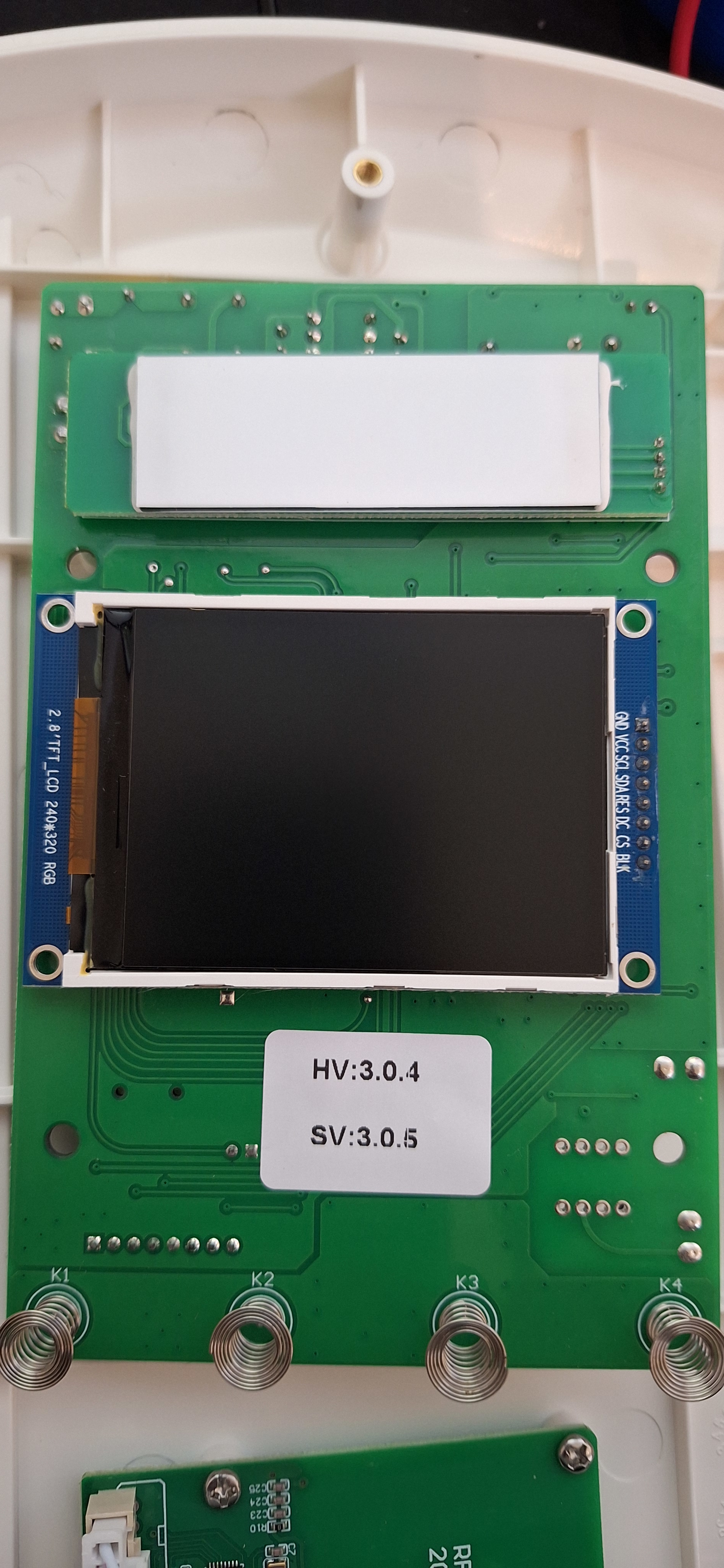

    It consists of two main boards, the electrical relays (black), and the logic controller (white).  The Logic controller had buttons and TFT screen on the other side.  The device is advertised with RCD type B, but if it exists, likely implemented electronically.  I have a dedicated RCD type B prior to this charger.
    Interior of an EV charger with visible cables and circuit board Interior of an opened EV charger with visible electronic components. Interior view of the Feyree Dynamic Load Balancing EV charger, showing the PCB with TFT display and software version labels.

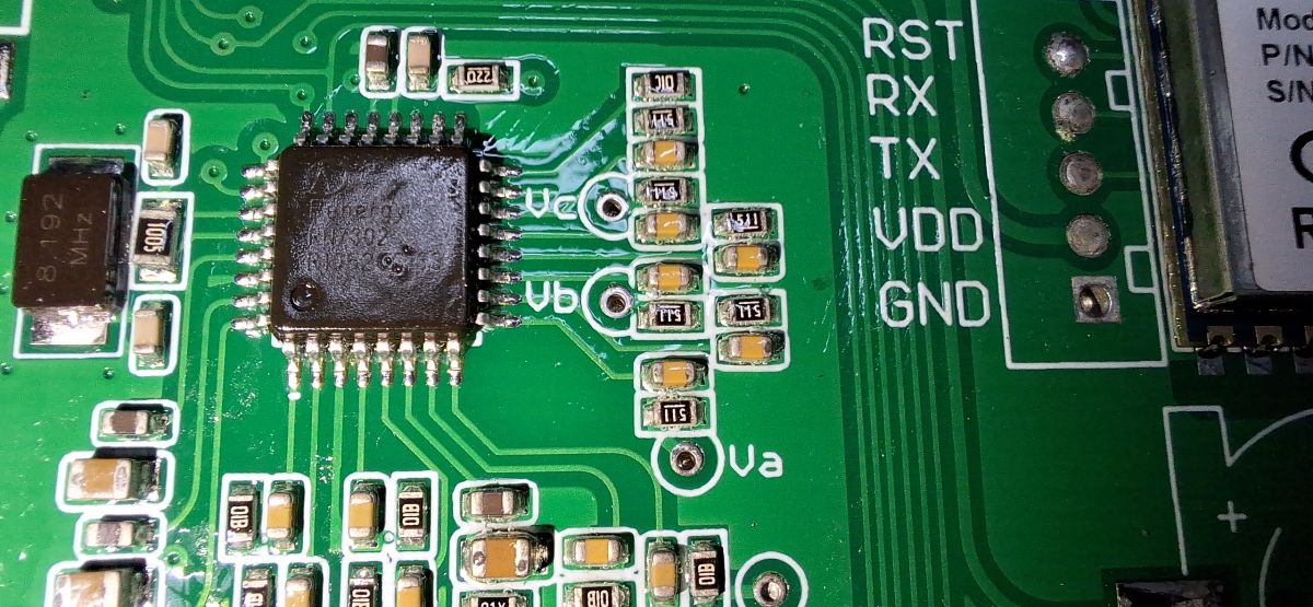

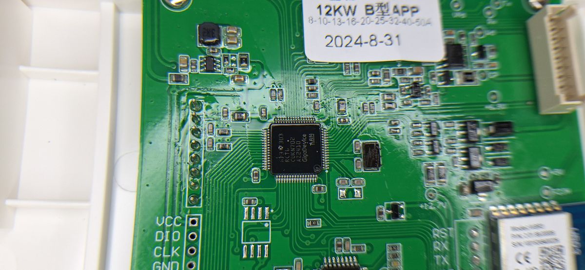

    The EV charger is run by a GigaDevice GD32F303RCT6
    Close-up of a PCB from an EV charger showing a microchip and label 12KW B APP.
    RN7302 metering chip.
    Electronic circuit board with markings RST, RX, TX, VDD, GND, and various soldered components

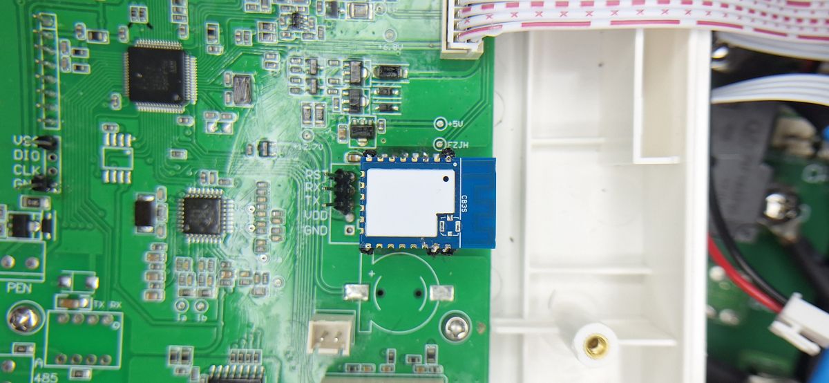

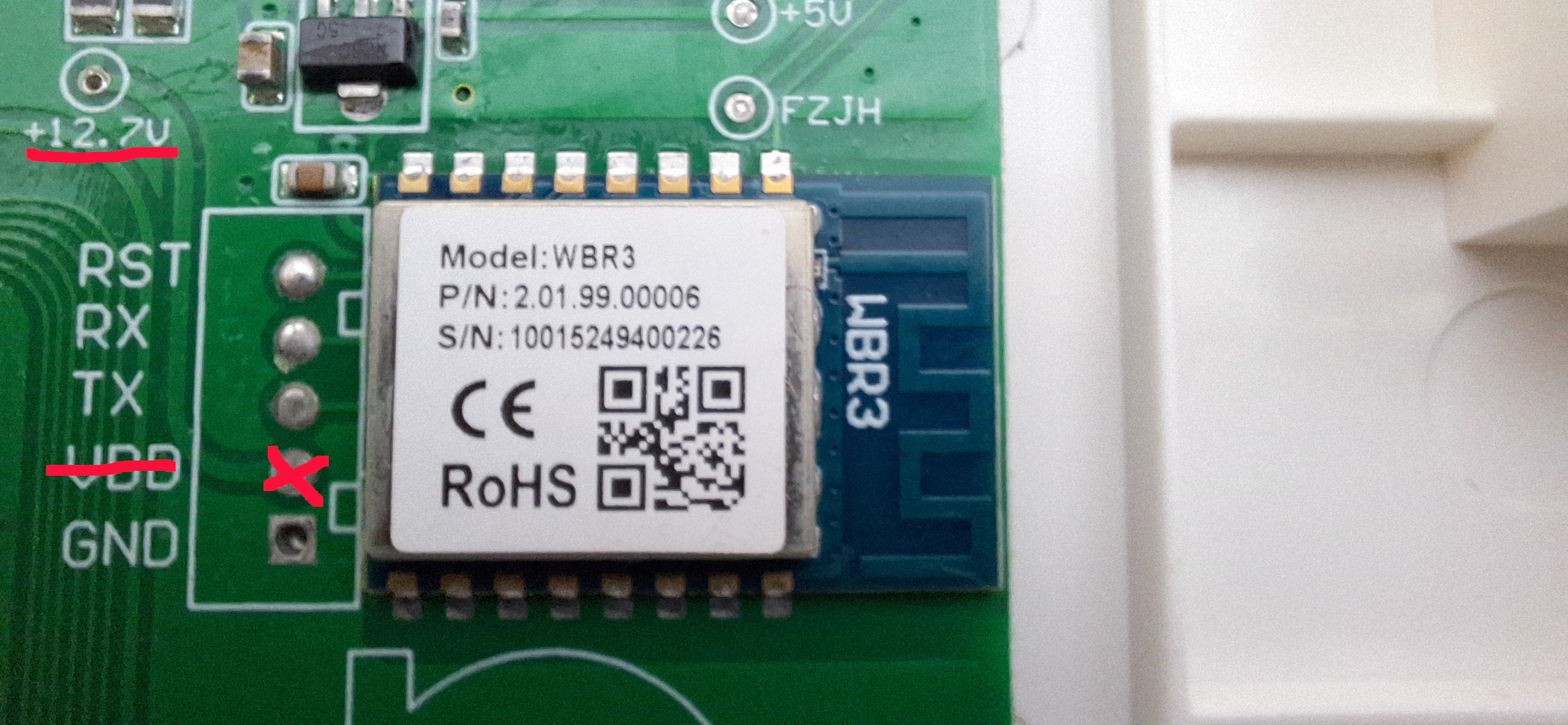

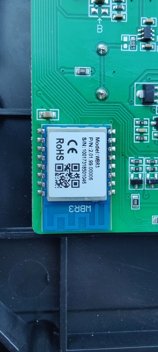

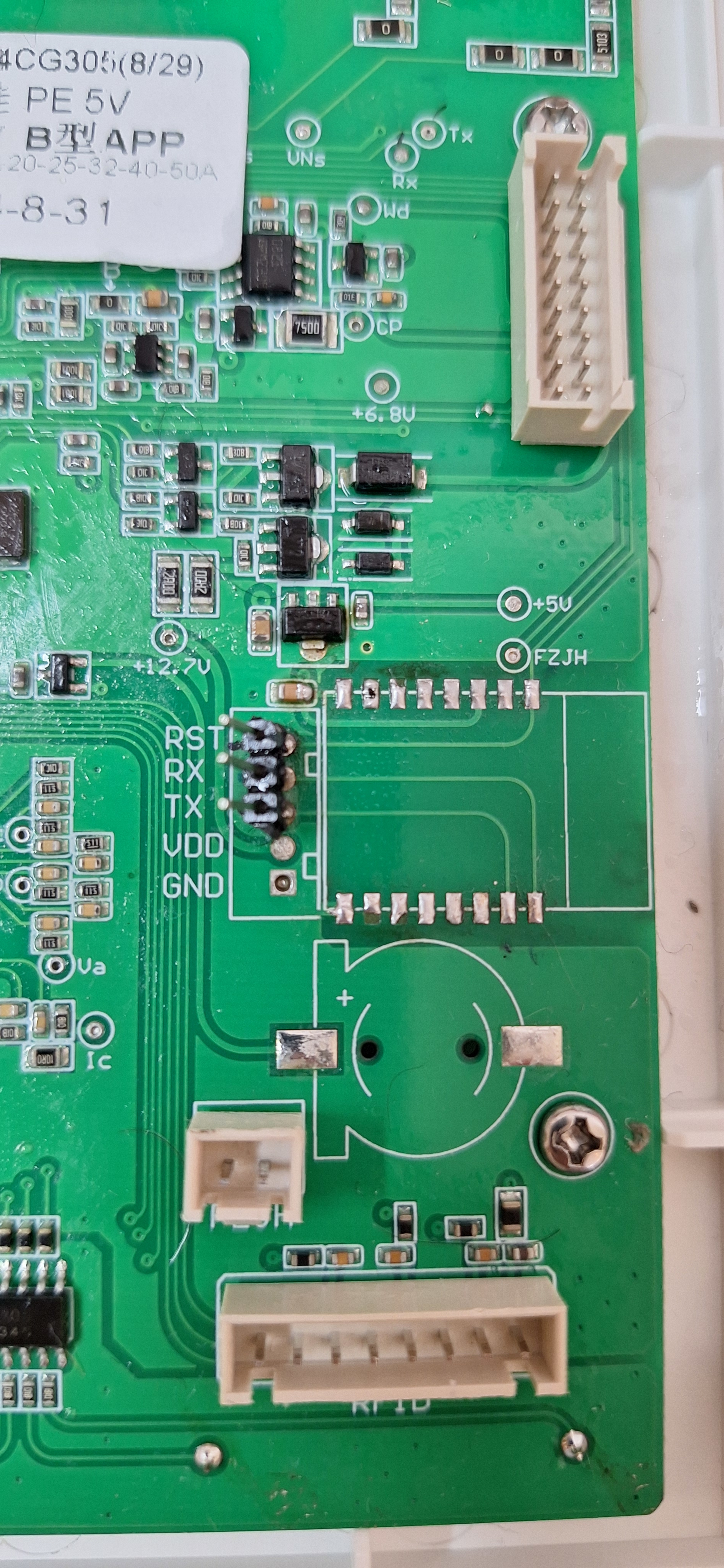

    WBR3 Pins
    The logic board has a WBR3 Tuya chip, which was not supported by OpenBeken at the time of writing, but mostly pin compatible with others like CB3S. The now supported WBR3 flash process requires lifting the chip anyway, so replacing with a CB3S is probably still quicker if you have one around, otherwise follow the WBR3 flash process.
    There is a nice looking header for accessing RX,TX, RST and GND of the WBR3, but be wary of the 12v on the VDD - Do NOT use this VDD point.
    WBR3 module on a board with pin labels.
    EV charger circuit board with visible electronic components and WBR3 Tuya module.

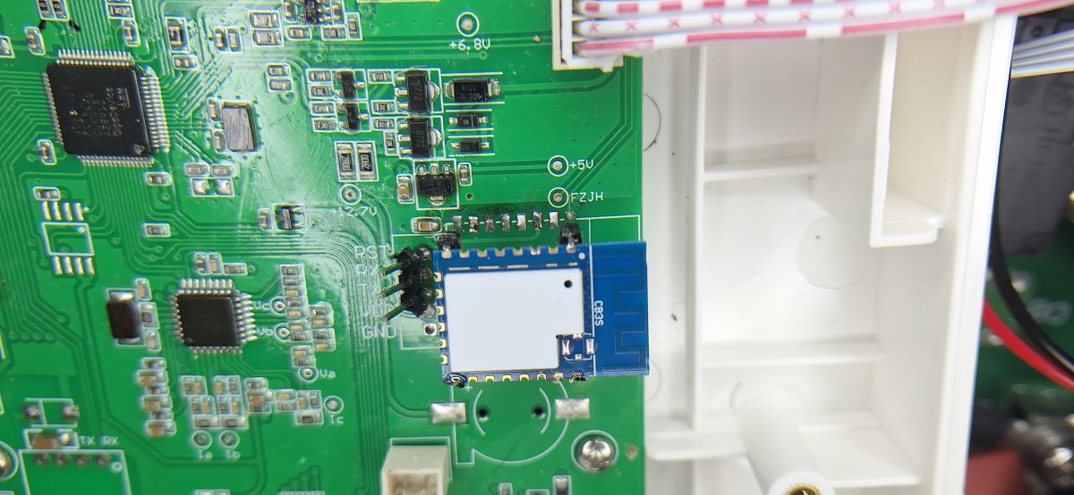

    Replacing The WBR3 with CB3S
    There are only 6 pins connected to the WBR3; GND, VCC, RX, TX, RST, and EN.  EN (Pin3) has 3.3v applied for Enable (for ESP) - make sure you replace it with a chip that can handle 3.3v on PIN3, or cut the trace. I cut the trace for my purposes.
    Traces visible with the WBR3 removed:
      Photo of a printed circuit board with labels: RST, RX, TX, VDD, GND, and connectors.
    I chose to replace with a CB3S pre-flashed with OpenBeken since it is mostly pin compatible and I had a few spare.  Though I destroyed a WB3S in the process - I suspect because of the 3.3v Enable pin.  I made a dirty pin header so I could quickly replace chips, Since I was capturing and testing, .  If anyone knows of a nice test frame intermediate board that could be soldered on top, let me know!
    Circuit board layout with a CB3S module on a green electronic board. Electronic circuit board with mounted CB3S module.

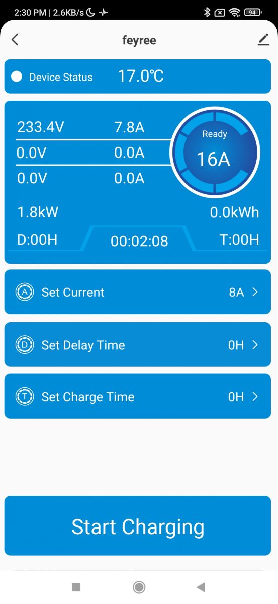

    Tuya App and TuyaMCU Capture and Configuration
    !!!IMPORTANT!!!
    Do not attempt to flash or connect to RX/TX for capturing while on mains power without isolated power at every level.  I used a isolated inverter, isolated USB adapter, and  laptop running on battery for capturing.

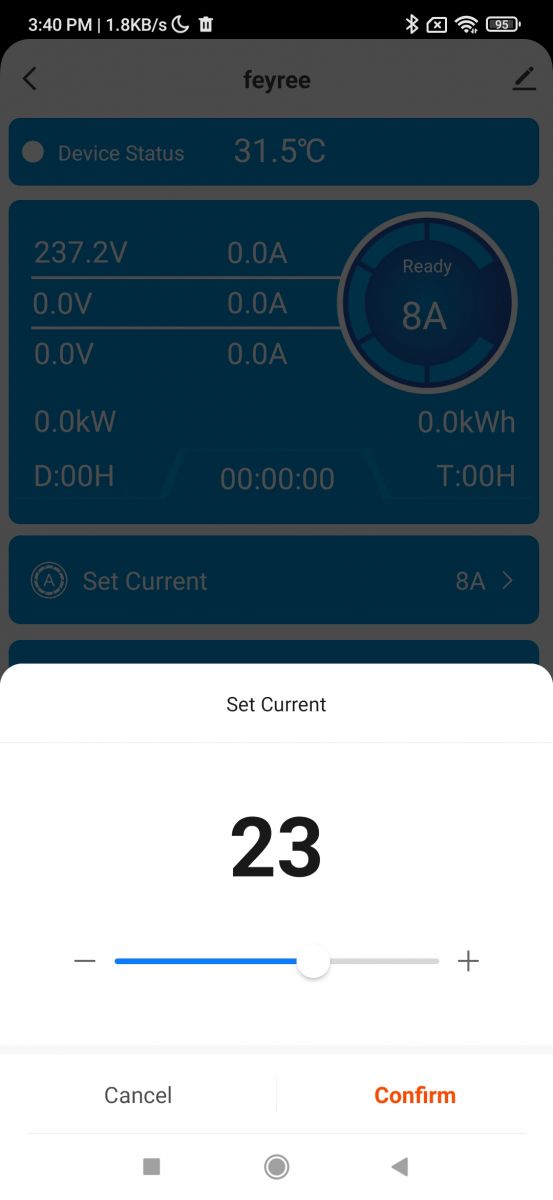

    Example of the parameters in in the Tuya App, and adjusting the Charge Amps.
    Tuya app display showing EV charger status and settings. EV charger app interface showing charging parameters.

    Observation about the CT Clamp:
    The external CT clamp meant for import smoothing does not appear to be integrated with the TuyaMCU communications from the capture, even though the dpId data model makes reference to it.  Even so, it's not entirely clear how the CT balancing is meant to work in conjunction with the app.  For me this is not a issue, as I want to control the Amps via OpenBeken+MQTT and I'm not using the external CT clamp.  Power consumption from EV charging is tracked independently by an internal sensor.
    Observations about setting amp limit on dpID 115:
    Through the Tuya app and screen, the minimum is 8 amps.  However, through TuyaMCU, this can be set as low as 6amps on my EV.  However, after a session set to 6 amp and unplugging and plugging back in to start a new charge session, this resets to 20.   This value is full integer only, no floats.

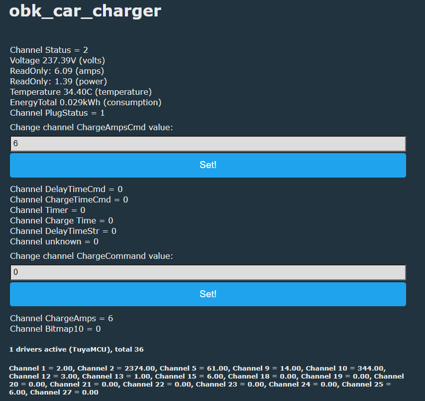

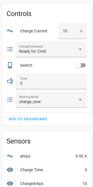

    OpenBeken Configuration
    OpenBeken user interface for EV car charger with channel values.
    config json - there are no pins, just basic startup command.  The rest is in the autoexec.bat below
    autoexec.bat
    Below are the autoexec mappings I've settled on.  So far I can do what I set out to do, which is turn on the charging with dpID 124=0 and setting the charging amps with dpID 115.
    Note about some fields:
    * String types from TuyaMCU; There does not appear to be a setChannelType compatible with linkTuyaMCUOutputToChannel [id] str [ch]. i.e. channels can't handle string types. I experimented with linkTuyaMCUOutputToChannel MQTT  which does pass the string through to MQTT, but appears to be just for testing. The strings do appear in /cm?cmnd=DP if the TuyaMCU flag 47 is used.

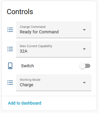

    Updated to use Enum Types with SetChannelEnum from this PR
    now with SetChannelEnum we can map tuyaMCU enum types all the way to homeassistant via discovery. That makes initialising charging much easier.  This is what it looks like:
    [WBR3] Feyree EV Charger teardown with adjustable charging via TuyaMCU [WBR3] Feyree EV Charger teardown with adjustable charging via TuyaMCU [WBR3] Feyree EV Charger teardown with adjustable charging via TuyaMCU

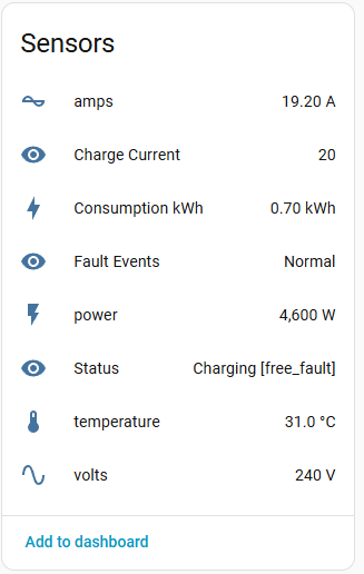

    Note the quirks from the MCU, this is charging at 20A with max capability set to 32A.  When set to 32A, the 16a field is not used (but does update between 1-16 if you change the 32A field).  Also, the 'Charge Command' always goes back to 'Ready for Command' state after accepting a command.  And the 'Switch' seems to not make any difference.

    addEventHandler OnChannelChange 24 tuyaMcu_sendQueryState
    Update: Now that OBK supports Enums Channel types, it is no longer necessary to use mqtt mappings in home assistant below. OBK will populate the mappings on home assistant for you, after performing discovery. Simply use the SetChannelEnum in the autoexec.bat in the original post.
    Original content for the record:
    In home assistant, I map the OBK MQTT to a select template to make it appear nicer, here is an example:
    # in mqtt: context (i.e. mqtt: !include mqtt.yaml)
    - select:
        unique_id: "obk_car_charger_sensor_24"
        state_topic: "obk_car_charger/24/get"
        command_topic: "obk_car_charger/24/set"
        options:
            [ "Charge", "Stop", "Ready for Cmd","Waiting", "Not Ready", "255"]

  • dpID 124 charge command and state mapping
    #15 21600955
    hojnikb
    Posts: 45
    stonacek wrote:
    >>21599952
    In order start the charge, you will need (at minimum) to send the charge command (0) on dpID 124. Depending on the current state of the charger, you may also need to first;
    * set the change method to 'charge now' (0) on dpID 14 (to override any timers)
    * send the stop charge command (1) on dpID 124. (to terminate any existing sessions)
    As a note: when dpID 124 is updated, it always reverts back to 'ready' (2) after the command has been executed. For this reason I use an event handler in OBK autoexec.bat to pick up this change.

    Thank you! Could you help me setup this custom template? Not very well versed in editing yamls.
    Is it not possible to implement this at the openbeken levels, so no edits would be required by homeassistant? Or is just a quirky behaviour of this particular tuya device?
  • #16 21601343
    stonacek
    Posts: 23
    Rate: 7
    >>21600955
    The last time I looked into it, OpenBeken did not have tidy methods for mapping values for MQTT, which I think is understandable given the project goals (and storage limitations). Home Assistant is better suited. I'll PM you with some high level guidance.
    Update: OpenBeken now supports enum types, so no mappings are required in homeassistant.

    My problem with these chargers is their low sensitivity to capture Wi-Fi.
    I'm about to open a charger to see if it's possible to change the antenna or even install an ESP to control the device.
    Wall-mounted EV charger with LCD screen and connected power cable
    at same spot ev charger lost connection and smart plug RSSI (50%, -75 dBm) works with no problem.
  • Low Wi-Fi sensitivity suggests antenna or ESP32 retrofit
    #18 21634970
    hojnikb
    Posts: 45
    at same spot ev charger lost connectio and smart plug RSSI (50%, -75 dBm) works with no problem.
    I have the same issues. I have one wall behind the EVSE and Wi-Fi router and already the Wi-Fi signal is really bad.
    I bought Ethernet equipped ESP32 board. I'm assuming it should work, given that ESP32 is supported by openbeken. Maybe OP can shed some light into this.
  • #19 21635201
    voodoopt
    Posts: 30
    PCB board with WB3S module, capacitors, and XGM2412|201 label WB3 Wi-Fi module on a green PCB with clear labeling and visible blue antenna Interior view of enclosure with PCB and connected power wires.
    So it seems like this module is easily changeable, right?
    The question is, if I have a poor Wi-Fi signal, wouldn't it be worth replacing it with an ESP12?
    "product_id": "7bvgooyjhiua1yyq",
  • #20 21648622

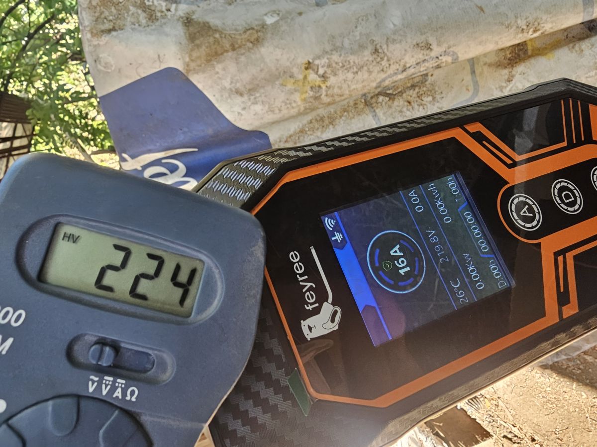

    tvnenov
    Feyree charger display shows 219.8 V while the meter reads 224 V.
    I have 7kw singlephase feyree charger , but it read 5volt lower than input voltage on plug , is this normal . I measure witout load and with 20a load 5volt on both ?

    >>21635201
    If it's similar to the charger I described, you could replace the WBR3 it with anything that can control the TuyaMCU using the dpIDs above. You'd need to align the pins accordingly, but I don't think it would be too difficult since it's only 4-5 pins (depending if desired chip needs an enable pin).

    I know it's been a while - but starting from 1.18.194, OBK supports Enum types that pass through the options to Home Assistant. You no longer need the MQTT templates in HA! Just update the autoexec.bat with the SetChannelEnum (I updated in the original post with these changes) and run Home Assistant discovery.
    https://github.com/openshwprojects/OpenBK7231T_App/releases/tag/1.18.194
  • Home Assistant enum support removes MQTT templates

    No need to use the mqtt.yaml method any longer... Now that enums channel types via SetChannelEnum are supported in the latest OBK, just reference the autoexec.bat in the original post. SetChannelEnum will build out selection options in Home Assistant on discovery. If you have old config, you may need to delete the MQTT device in HA and run discovery in the OBK config to clear any old config.

    I recently bought this charger again, but this time the 3-phase version. To my surprise, it only uses one measuring split-core transformer.
    How would one tackle the issue with asymmetric phase load? Because manual states that you should use transformer on the L1 phase.
    But let's say you have a 3-phase car and L3 phase is way more loaded; given that this EVSE has no idea what is happening on that phase, the system will get overloaded as a result.
  • OpenBeken can replace the CT clamp for current control
    #28 21754538
    stonacek
    Posts: 23
    Rate: 7
    >>21754359
    I assume you're referring to the CT clamp that is meant to go in the distribution board to dynamically adjust the current for import control. I personally just sent that one to the bin because the main benefit of putting OpenBeken on these devices is that you can then have OpenBeken or Home Assistant adjust the current for you based on better information. I prefer to dynamically adjust the current based on measurements coming from a smart meter at the distribution board. I suspect this would address your concerns about having enough detail to determine if a phase is overloaded. See my note about the CT clamp in the OP.
    You should post some pictures - it might be useful for others to have pictures of the internals of three phase model.
  • Built-in load balancing preferred over HASS control
    #29 21754842
    hojnikb
    Posts: 45
    stonacek wrote:
    >>21754359
    Yep, I've meant CT clamp.
    Actually, I've found that this feature works really great on the 1ph feyree I have. Never lets me down and always works flawlessly.
    Doing load balancing via HASS would work, but there are many more failure points to consider here. Firstly, there's current measurement for the whole house, that can either fail or lose connection sometimes. HASS server could stop working or be down. And lastly, feyree could lose connection and not get the latest update on current limiting.
    The last point is especially problematic, because it tends to lose connection quite regularly, at least that's what I've found on mine.
    So yeah, I'd like to keep the built-in load balancing. Ironically, to make this work as best as I could, I'd have to select the most loaded phase, which in turn would cause the feyree to limit the current to the car the most 🤡
